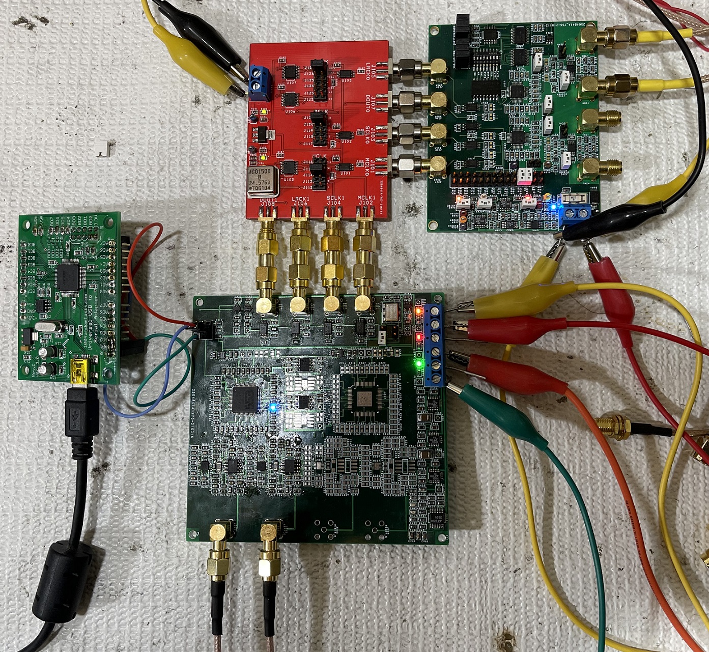

Until I'll sort out the "hump" issue, here's everything together: ADC, clock generator, DAC in a digital loop (so analog in, analog out). THD @1KHz is about -118dB (0.00013%), THD+N @1KHz is about -113dB, both in a 20KHz bandwidth, both are minimum values and measured without any extra filters in the analog paths. Pretty much in line with what I was expecting to start with...
One small surprise was that running the DAC synchronously with the ADC (that is, using the MCLK generated by the clock generator to clock both the ADC and the DAC) vs. running the DAC from it's own Si570 clock @50MHz doesn't make a iota of a difference. Both clocks are locking just fine, no difference in measurements. Intuitively (never thought about in depth) I was expecting the synchronous operation to be at least slightly better, at least in term of noise, but nothing, zip, nada.
I don't think the hump has anything to do with the common mode distortions. We can speculate until the cows come home, but I guess only ESS could clarify, unfortunately they have no incentive to even admit their chips have a design blunder inside. I am surprised that their team of "golden ears" they claim to use to feed back in the design process didn't catch this issue during the extensive listening sessions :rofl:.
I'll put everything in an analog loop (digital in, digital out) ASAP and be back with the results, I would not expect much of a difference, though.
P.S. I edited the name of the original post #1 to better reflect the content, don't know if it's possible to change the thread name accordingly, and if so, how.
