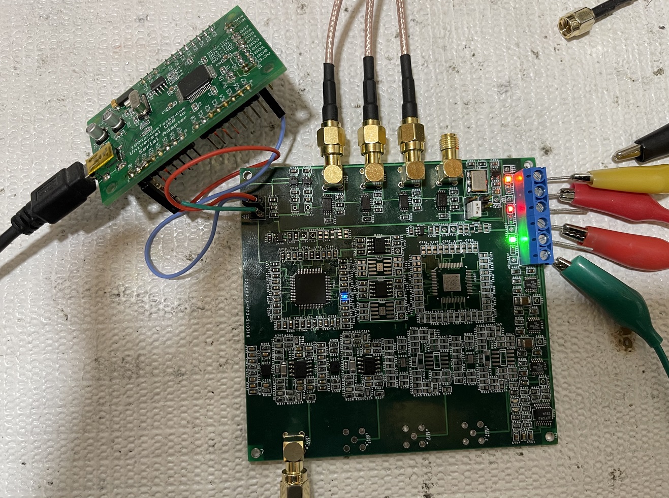

I'm surprised by the power consumption of the DAC chip, that seems excessive to say the least. 4 watts per ES9038PRO? The datasheet suggests just over a watt from a 5V rail for 'note 1' conditions? Ie 222mA consumption.
It is not 4W for the chip, this is the total power for one channel. 2.5W is the ES chip + regulators + digital buffers + Si570 oscillator, the rest is for the balanced I/V stages ( 2 x OPA1622 duals plus 2 x OPA1611). And this is @100MHz, the data sheet specifies the currents intake @40MHz. There are blurbs on the Internet that @100MHz the current intake increases significantly, hence my #464 question about.

Yeah, sorry, brain fart here. Bit 0 is indeed the R/W so 0x90 is in fact 0x48 with a 0 appended at the right, 0x48 = 1001000 0x90 = 1001 0000. Makes some sense now, although this way of specifying the I2C address is still BS in my book. When I read "address" I expect the address not some weird construction than includes an extra unrelated (to the address) bit.
Ref. power consumption, I just tested, at XIN/8 (12.5MHz) the current intake on +5V drops at 228mA (from 480mA @100MHz). At XIN/2 (50MHz, close to the DS specification) current intake is 340mA. Subtract the some 80mA used by the digital buffers and the Si570 and get 260mA for the ES chip (all voltages) which is reasonably aligned with the data sheet (220mA @40MHz).

This is going to be a gigantic mess... I cannot write to regs 38-41 what I would like to (or reading is wrong). I am writing to all registers 38-41 the same (use Input 3 for both L/R, this is mono mode, stereo mode is disabled, autoconfig for inputs is disabled)
write_to(reg, b'\x33')
and get back when reading the registers:
Reg 0x38: bytearray(b'3')
Reg 0x39: bytearray(b'3')
Reg 0x40: bytearray(b'\xa8')
Reg 0x41: bytearray(b'\x01')
Which is completely bollocks. However, the output is fine! Aaarrgghh... must take a break, this is too frustrating.

Expired before editing. The strange thing is that registers 37 and 38 (and all the other registers I am R/W-ing) are taking the 0x33 value (0x33=b'3') however 40 and 41 do not. They have the values:
Reg 40: 0xA8
Reg 41: 0x01
and after overwriting with 0x33 they come up with exactly the same values, like the write never happened. These values don't make any sense according to the DS, they are supposed to be 0x54 and 0x76 by default, wtf?
The even weirder thing is:
- 0xA8 that I'm reading from 0x40 is the default 0x54 value (according to the DS), circular shifted left 1 bit
- 0x01 that I'm reading from 0x41 is the default 0x76 value (according to the DS), circular shifted left 1 bit, and complemented (????)
So again, WTF? And why can't I write new values? I understand fighting the beast is part of the game, so please allow me venting for the time being... I'll eventually figure it out.
