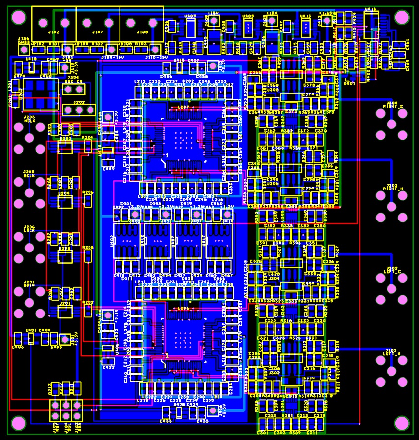

Thanks, I didn't catch the p. 5 foot note and, as a result, in the layout above I included separate power supplies for digital 1.2V. Once I get the boards tomorrow, I have to avoid populating those extra power supplies, otherwise they will collide with the 1.2V analog supplies (if the pins are internally connected). Yes, I am aware of the 1.3V requirement for running @100MHz, thank you.

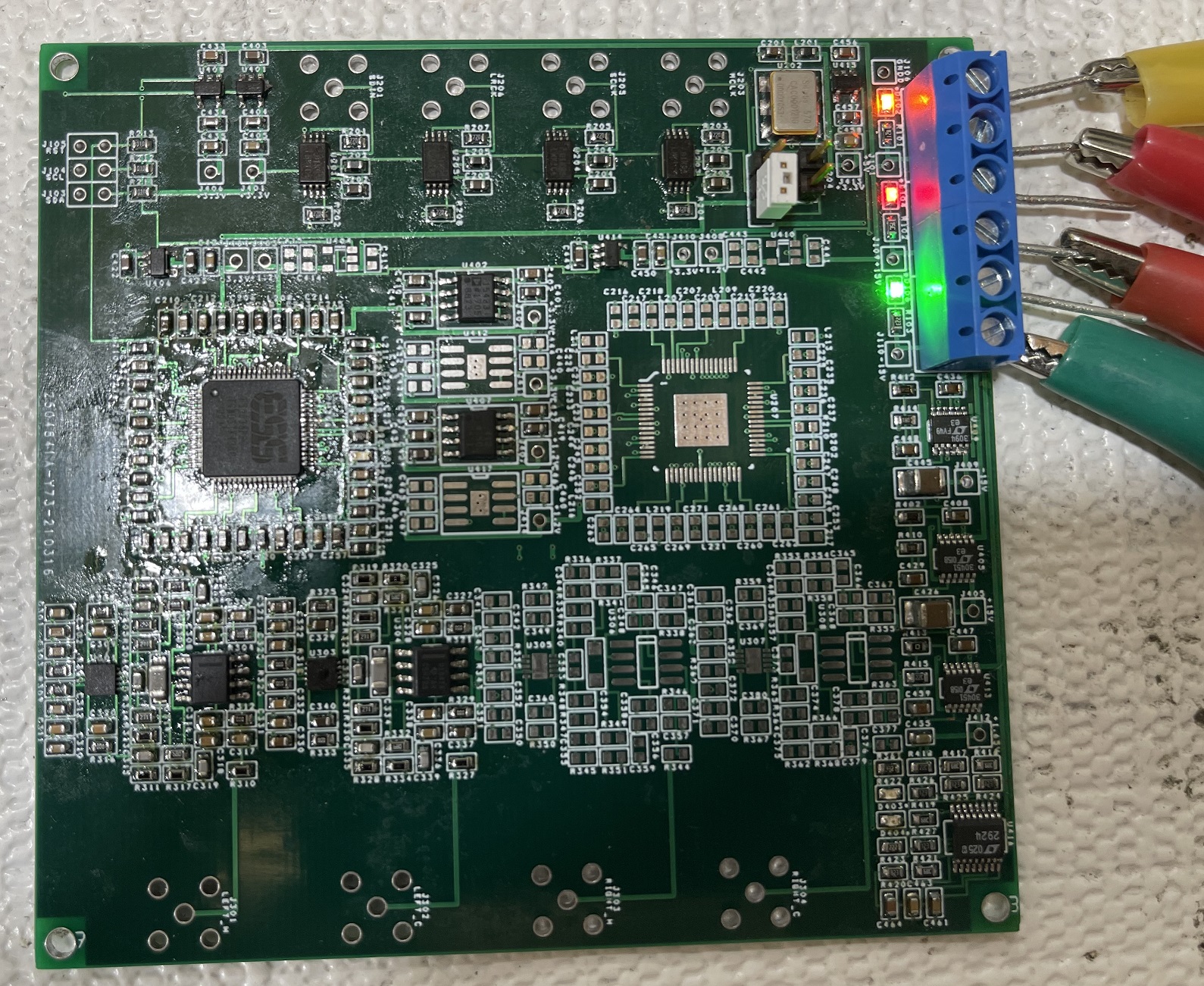

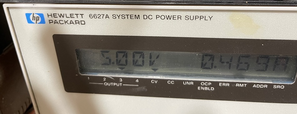

DAC is coming up, one half (one channel) only, for testing purposes. OMG, this monster is power hungry... @100MHz clock sucks half an amp from the 5V supply (post regulated to 3.3V and 1.2V). And this is with idle outputs, nu current drawn in the I/V. Measured the peak current at the I/V (+/-15V) by cutting the clock, is 170mA meaning 120mAeff. I'm afraid I underestimated the power dissipation... it's 5W for the 5V plus 3.5W from +/-15V total of 8.5W for both channels. That's a power amplifier, not a DAC...

Well, it’s actually two DACs, but still a lot of power, 4W per DAC (including the regulators).
Never thought about 90 degrees traces, it was the most natural (to me) style. I never use autoroute, the result was always a disaster (or I don’t know how to use the tool), everything is 100% manual routing. I use 45 degrees only when forced by spacing.
Already revised the board, to include a top layer ground copper pour (to help with cooling) and a few other minor changes.
For now, starting testing, using a FT2232H USB/I2C adapter, and the pyftdi library, to program the ESS9038 registers and the Si570 clock.

Ah, makes sense now on the traces. Do you use Cadence or KiCad? I'd guess it's not Altium since you have to manually change to get 90 degree corners. Not that it matters.
New board layout sent to fab, with extra top layer copper pour (ground connected) to help with cooling. Small fixes and changes (removed the 1.2V digital power supplies, separated the Si570 power supply from the ES9038PRO oscillator power supply, added small circuit to the LTC2924, to signal the end of power sequencing cycle), general layout cleanup. Hopefully it's the last iteration, price for 10 pcs. 4 layers boards is cheaper than the DHL shipping to Canada, but the total 10 days to wait until delivery is in general booooring. Not in this particular case, I need to do the measurements and start the software dev.
