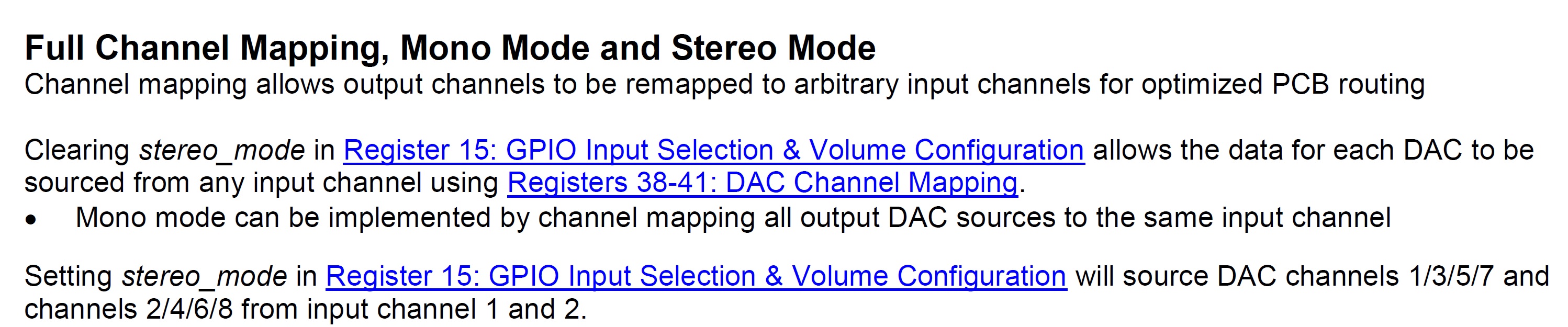

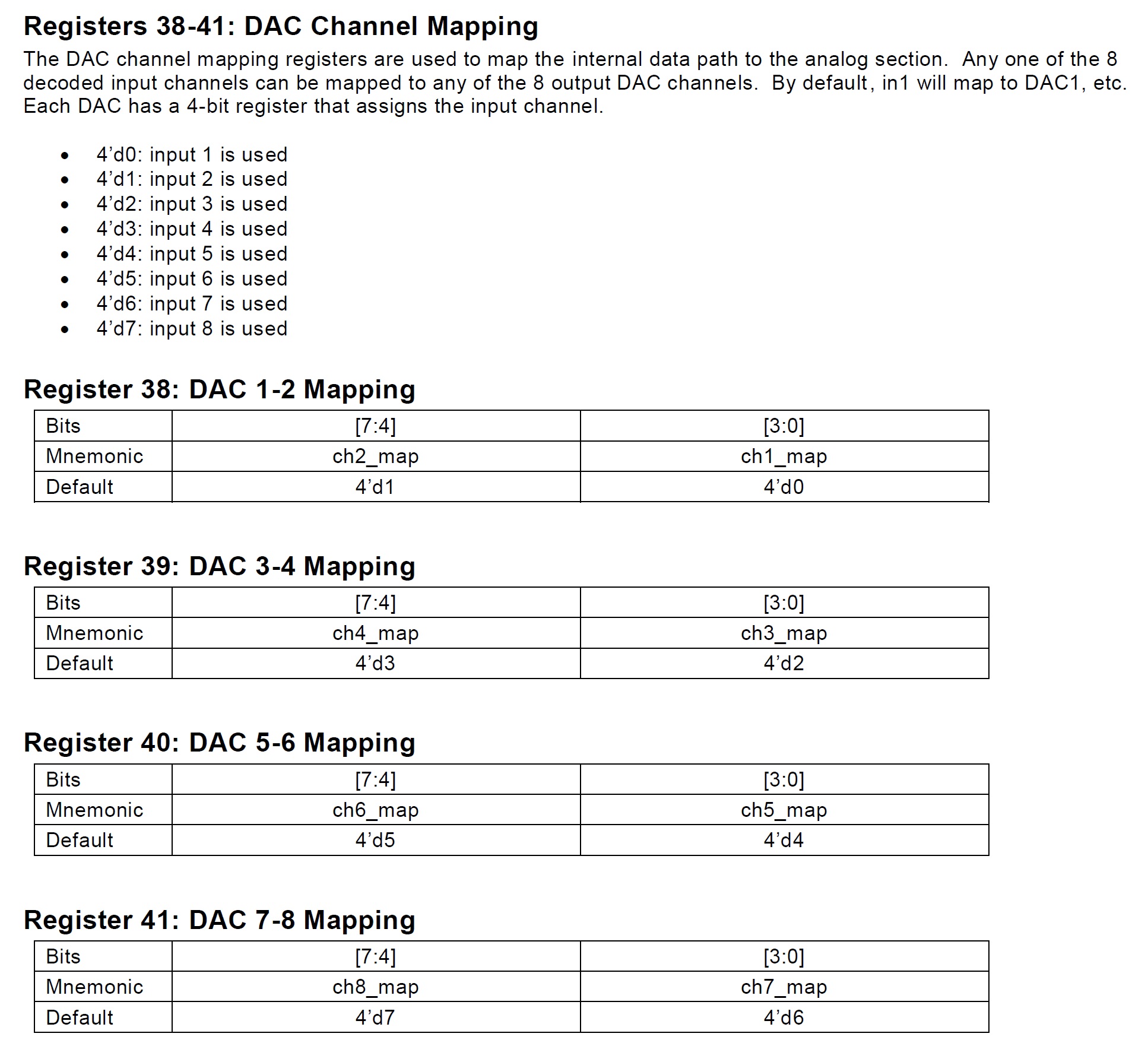

I'm totally confused by the ES9038PRO datasheet. They use the concept of "channel" to identify the 8 digital inputs, the L/R in the PCM stream and also the 8 DAC analog outputs.
So how does one map one of the L or R channels in the PCM stream to all (8) DACs, to get a mono output?
According to the datasheet, register 15 has to get the stereo bit cleared, then registers 38-41 are used to map digital inputs to DACs. But in PCM mode only digital inputs 2,3,4,5 are available (making a total of 8 digital channels) while input 1 reserved for the LRCK. So assuming I am using digital input 2 carrying the PCM L/R channels how do I map all 8 DACs to the same L (or R) digital channel only? Unless I'm missing something, the 38-41 registers documentation talks only about assigning one or more DACs to one full digital input (carrying both L/R for PCM).
To use 9038Pro for stereo, you have 2 options:
1) Set bit2 in reg #15, you will have 1,3,5,7 outputs at the one channel and 2,4,6,8 at another.
2) Do not set bit 2 in reg #15, and than adjust registers #38-41 as you want, using only 0 or 1 in each their low and high 4 bits.
For example:
#38 = 0x00
#39 = 0x00
#40 = 0x11
#41 = 0x11
With this, outputs 1,2,3,4 will be one channel and outputs 5,6,7,8 - another.
P.S. But I think that the 1st option is optimal for PCB layout.
For volume control, if you do not need to control the balance between L and R - you can set bit 1 in reg #15, and than make both channels volume control by changing only reg #16.
For example:
#38 = 0x00
#39 = 0x00
#40 = 0x11
#41 = 0x11

Sorry, I missed that you wants MONO.
For MONO - do not set bit2 in reg #15, then set all register #38-41 in one chip to zero (0x00) and to 0x11 in the second chip.
Thanks, but this doesn't match with the datasheet. First, setting all registers to 0x00 means "map input1" and 0x11 means "map input2" on all DACs. But the datasheet says that "input1" and "input2" refer to the digital inputs (2...5 for PCM) so something is off here. I would expect to have a way to specify through a bitmap in the registers a) the digital input and b) the L/R channel in that input, which doesn't appear to be possible (unless I'm missing something), hence my confusion.
Why?
Yes, exactly!
Not clear what you mean.
Considering PCM only:
Chip have 4 I2S data lines, 2 channels each, named as DATA2, DATA3, DATA4 and DATA5.
By default, DATA2 - CH1 and CH2 (this line used in stereo).
DATA3 - CH3 and CH4
DATA4 - CH5 and CH6
DATA5 - CH7 and CH8.
As you have only 2 channel stereo, you have only DATA2 (CH1 and CH2).
I2S bus (WCLK, BCLK, DATA) going to both chips.
You need to set all the DAC's output of the 1st chip, to use CH1, setting all registers 38-41 to 0x00.
The 2nd chip you have to set to use CH2 (38-41 = 0x11).
P.S. I understood you point - they used the word "input" instead of the word "channel" in the registers description, and you think that this is related to spdif inputs.
What to do, this is ESS, not TI or AD, and of course not Microchip (the best DS I ever seen, before I stopped to used them, 10 years ago).
And it is good that this is 9038, as I remember, 9018's datasheet had much more errors and typos.
You mean slightly worse in terms of THD?
Actually, having seen QA-Matts posts about the prototype QA 402 with PCM4220 driven by an analog oscillator, the PCM also seems to have stellar THD performance (HD2 at -128 dB for +6 dBV input), and unlike the AK5374A, it degrades more gracefully near full scale. What remains is a lowish noise corner:
Sneak Peek: The QA402 - #24 by matt - QuantAsylum Forum
Yes, AK5572 is slightly worse (about 2 dB) in terms of THD. THD+N in particular @1KHz is better by the same amount, but this is not really relevant due to noise shaping in the AK5572.
The guy(s) who decided to implement noise shaping for audio in order to feed the SNR war (since there is no real benefit in doing this, beyond the numbers in the datasheet) should be hanged in public.
Yes, that's exactly my confusion. So you are saying that in PCM mode "channel 1" and "channel 2" are L/R on digital input 2, right? Then "channel 3" and "channel 4" are L/R on digital input 2, etc...
Thanks!
You are welcome.
