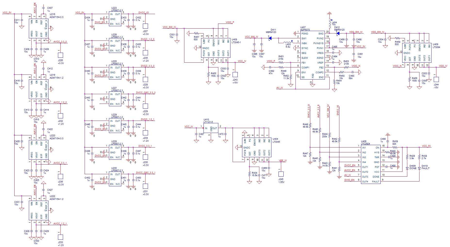

Since Mouser updated the delivery of ESS DACs to 03/13, and AKM is dead for the foreseeble future, ES9038PRO it is.
I've started by designing the power supply, with some extra feature: feeding from USB 5V only (using a boost switcher) switcher tracking for the IV stage +/-15V to minimize dissipation, and power sequencing (per the ES9038PRO datasheet). Schematic is attached. Currently designing a 2 layer board, it will be separate from the DAC board to minimize chances to rework a big expensive 4 layers board. In the final version I would expect each regulator to be close to the pin(s) it is feeding.

Not that you must, but JLCPCB is pretty cheap for 4 layers now, same with OSH Park.
Unfortunately JLCPCB started charging extra for any board with vias that are smaller than 0.4mm (imagine using .4mm vias for a board with 0.5mm pitch ICs). And the charge a lot, the price of a 3x4" 4 layers pretty much doubles. Still worth for a final board, but as long as it's in development is an useless expense.
Well that’s unfortunate. I hadn’t noticed that.
How about LT8582 as boost/inverter? Available output current would be higher (500mA) although not from USB. I've used LT3471 before but haven't tried VIOC.
It's another possibility, the decision for the ADP5070 part was strictly related to it's TSSOP outline availability. I have no problems soldering DFNs, but at least in the development stages TSSOPs are much more convenient.
The ADP5070 inverter switch is 0.6A which I would think it will be enough to feed the IV stages, but just in case there is the 1.2A version, pin to pin compatible, the ADP5071.
