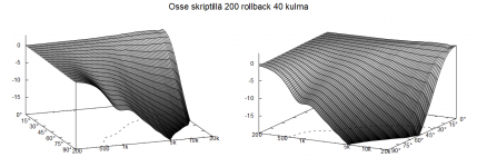

Is there a way to manipulate roundover (angle) in ATH script with R-OSSE definition?
The new plot visualizes the on-axis ripple nicely which seems to be edge diffraction on a freestanding waveguide and visible for example with ST260. Rolling over the mouth edge bit more than 180 degrees would get rid of it.
Here some quick tests with old OS-SE definition I had stashed where increasing rollback from 180 to 220 degrees pretty much removes the on-axis ripple sa well as cleans the whole listening window some:
Trade-off that happens with OS-SE script rollback angle manipulation seems to be more interference on lower frequencies. I suspect short circular arc extending the R-OSSE generated profile would work nice, remove the on-axis ripple without affecting too much on the low frequencies. I'm not sure how I could add such rollback extension to the ABEC project files? Perhaps 30 degree arc whose radius is half wavelength of the ripple might work. For ST260 on-axis ripple around >5kHz this makes arc radius of ~3cm or so.

the new "waterfall" style graph is really nice.
edit. sorry the last image label is wrong but I'm too lazy to modify it 😀 Filenames have the rollback angle.
Yea, I've noticed as well. There is a way already - it's possible to extend the parametric curve beyond t = 1.
See this graph and the parameter "tmax" (all the way down): https://www.desmos.com/calculator/xx3ymrpufi
Just set "tmax = <someting>" in your R-OSSE definition.
