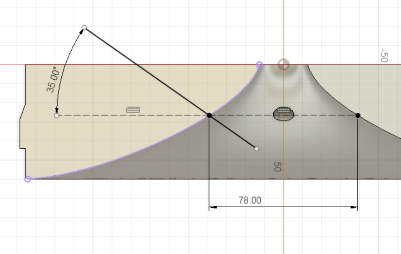

@SubTweeter I suspect your 4.4kHz issue might be a radial cavity mode in the midrange chamber. 4.4kHz is about 78mm at 343 m/s, which seems suspiciously close to the 3" of the driver.
No joke I just loaded the old CAD file out of curiosity to check how far I spaced them apart and it's exactly 78mmI suspect your 4.4kHz issue might be a radial cavity mode in the midrange chamber. 4.4kHz is about 78mm at 343 m/s, which seems suspiciously close to the 3" of the driver.
EDIT: the black line at 35 degrees is the centerline the 12mm port not shown
I can't physically bring the drivers any closer to the throat entry. If i rotated the port perpendicular to the driver it woudl be too far out to stay within 1/4 length of the xover frequencywhy is the exit of the mid drivers at an almost/apparent 45 deg exit angle??
I was thinking about the 4 cavities directly infront of the mid cone. Your tap seems to be at about 1/2 the radius though, so it might not be picking up that fundamental mode too much.Actually now that I think about what you are saying thhe 78mm spacing is probably unrelated

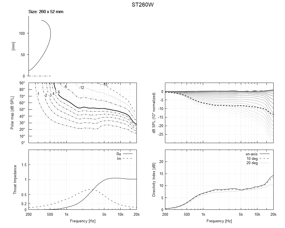

ST260W (https://a360.co/3ChrOc5)
STL+STEP: https://at-horns.eu/ext/ST260W_STL+STEP.zip
I'm only not sure about the screws.
(It probably could have been a little smaller, something like 220 mm would still work fine.)
220 mm version: https://at-horns.eu/ext/ST220W_STL+STEP.zip

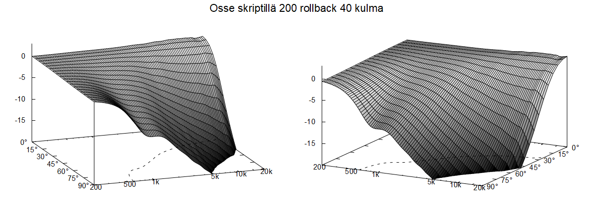

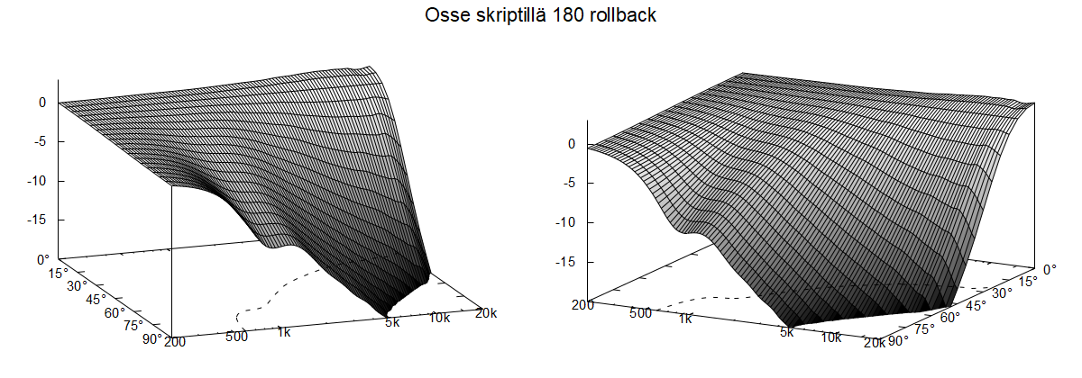

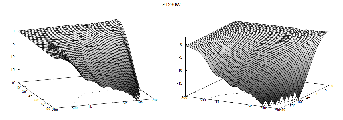

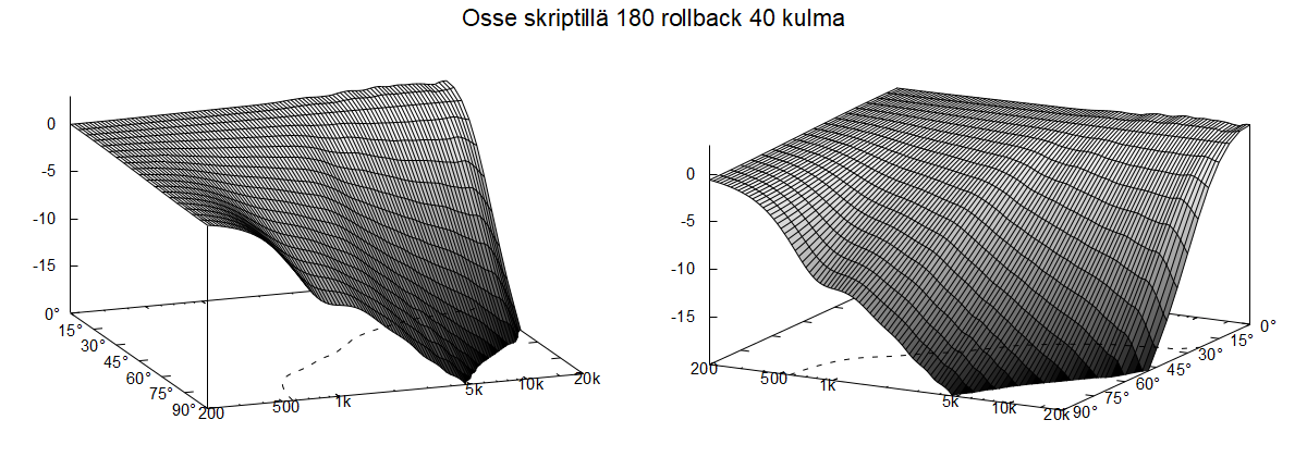

Is there a way to manipulate roundover (angle) in ATH script with R-OSSE definition?
The new plot visualizes the on-axis ripple nicely which seems to be edge diffraction on a freestanding waveguide and visible for example with ST260. Rolling over the mouth edge bit more than 180 degrees would get rid of it.
Here some quick tests with old OS-SE definition I had stashed where increasing rollback from 180 to 220 degrees pretty much removes the on-axis ripple sa well as cleans the whole listening window some:
Trade-off that happens with OS-SE script rollback angle manipulation seems to be more interference on lower frequencies. I suspect short circular arc extending the R-OSSE generated profile would work nice, remove the on-axis ripple without affecting too much on the low frequencies. I'm not sure how I could add such rollback extension to the ABEC project files? Perhaps 30 degree arc whose radius is half wavelength of the ripple might work. For ST260 on-axis ripple around >5kHz this makes arc radius of ~3cm or so.
edit. sorry the last image label is wrong but I'm too lazy to modify it Filenames have the rollback angle.

Yea, I've noticed as well. There is a way already - it's possible to extend the parametric curve beyond t = 1.
See this graph and the parameter "tmax" (all the way down): https://www.desmos.com/calculator/xx3ymrpufi
Just set "tmax = <someting>" in your R-OSSE definition.
