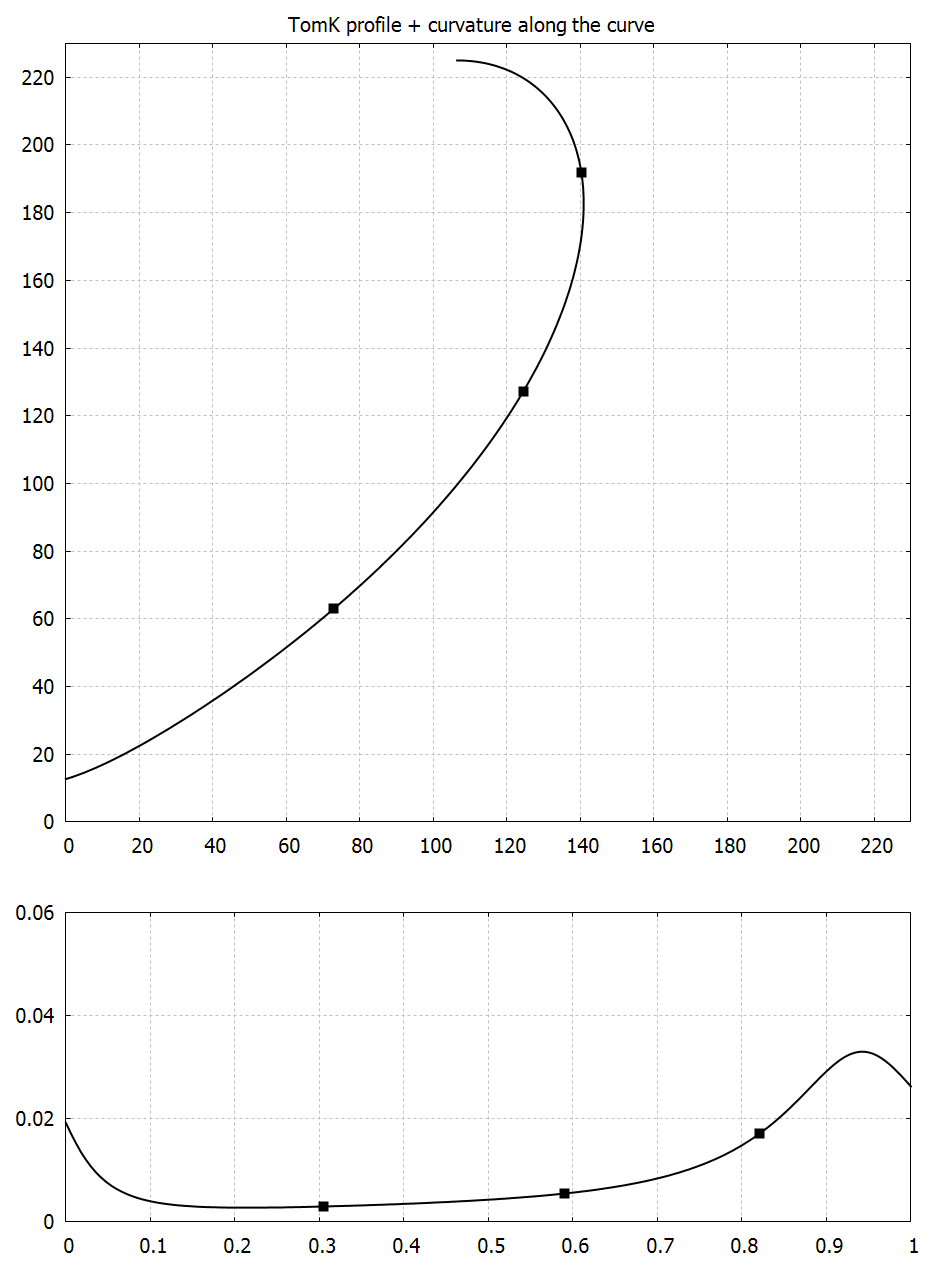

Thanks! Got it, so basically just monitor the curve and adjust until it fits.

Yes, because you want a one single curve all the way through - one smooth curvature progression. No extensions with abruptly changing curvatures.Got it, so basically just monitor the curve and adjust until it fits.

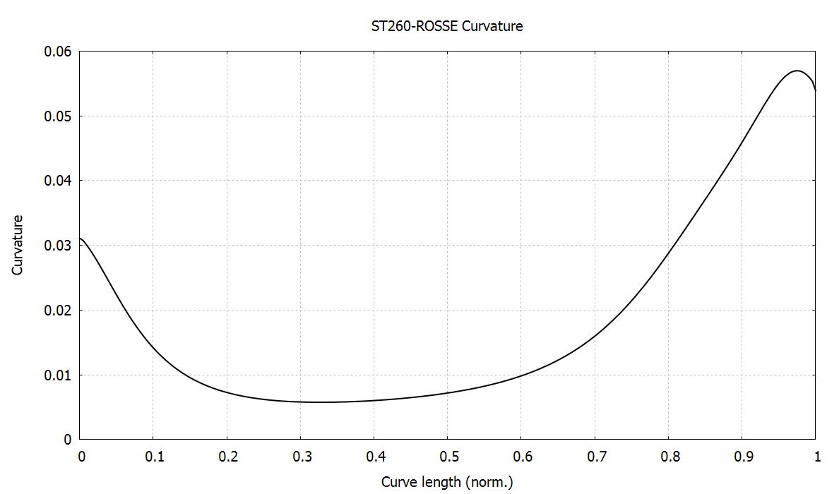

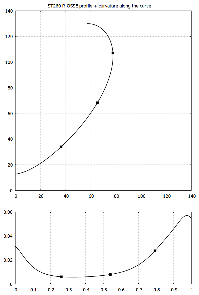

I am VERY interested in the accompanying text explaining the importance of the curvature and how the OS minimizes it.BTW, this is the curvature of the ST260 R-OSSE version, curvature [mm^-1] along the curve -

I can only split it into two parts - 1) "the importance of the curvature" and 2) "how the OS minimizes it".I am VERY interested in the accompanying text explaining the importance of the curvature and how the OS minimizes it.
I've done my homework, but just don't get it...
1) The importance of smooth curvature comes from experience, it's purely empiric on my part.
2) I have no clue, I don't know what it would even mean, how it would be defined.
Obvisouly, for any practical horn we need the curvature to rise towards the termination, otherwise the device would either terminate abruptly or never. I can only say that this rise needs to be gradual (as shown) -
Here the idea is to connect a decreasing curvature near the throat (that's the OS feature) to an increasing curvature towards the mouth with something smooth enough.
Perhaps someone could try to construct a waveguide the other way around - first draw a curvature curve (a free smooth spline?) and then calculate the corresponding profile curve. Although I'm not sure it would help to come up with something noticeably better than what we already have. There's already very little left for improvement 🙂

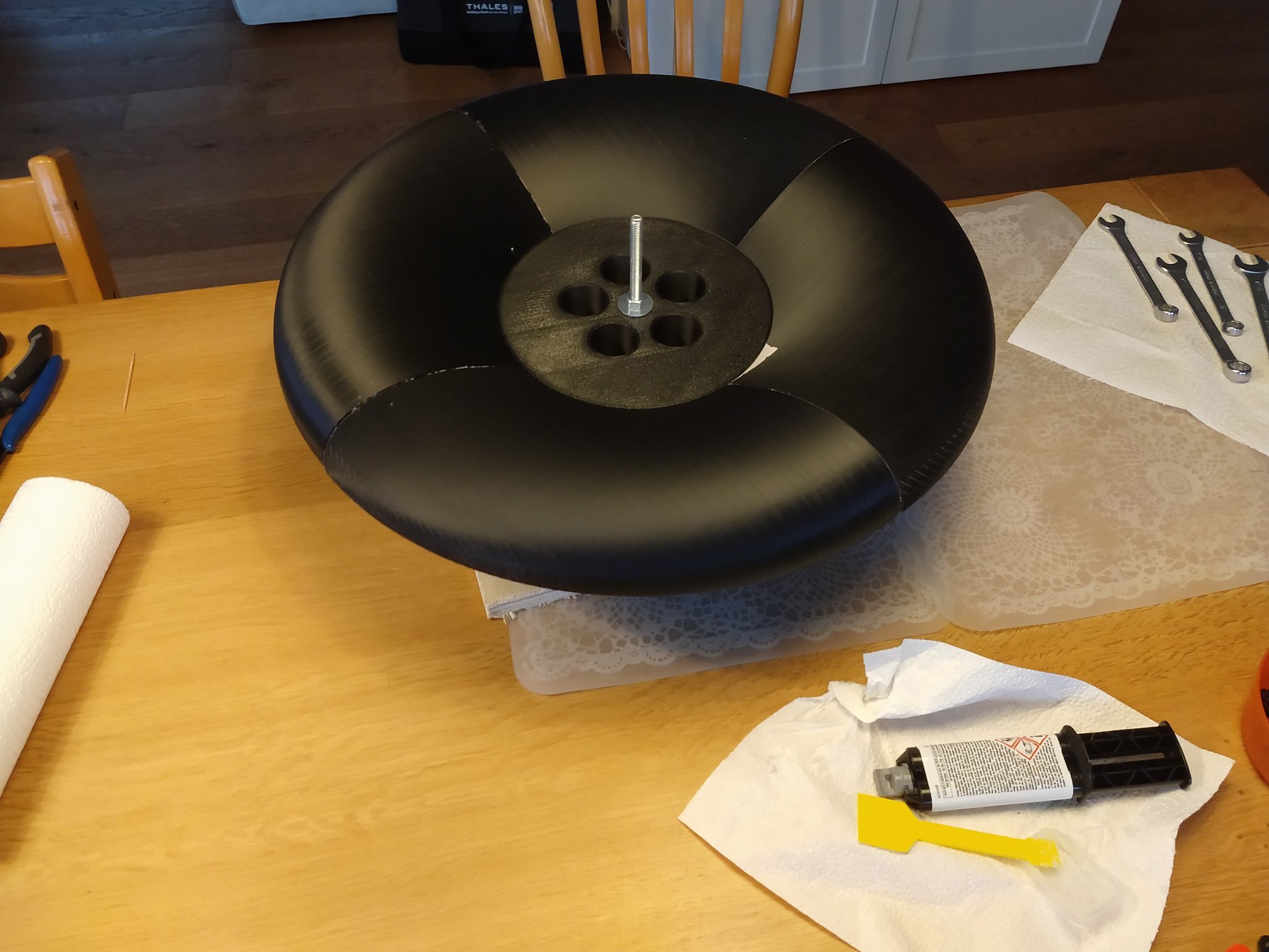

Appears like a success to me 🙂Another Ath horn is born:

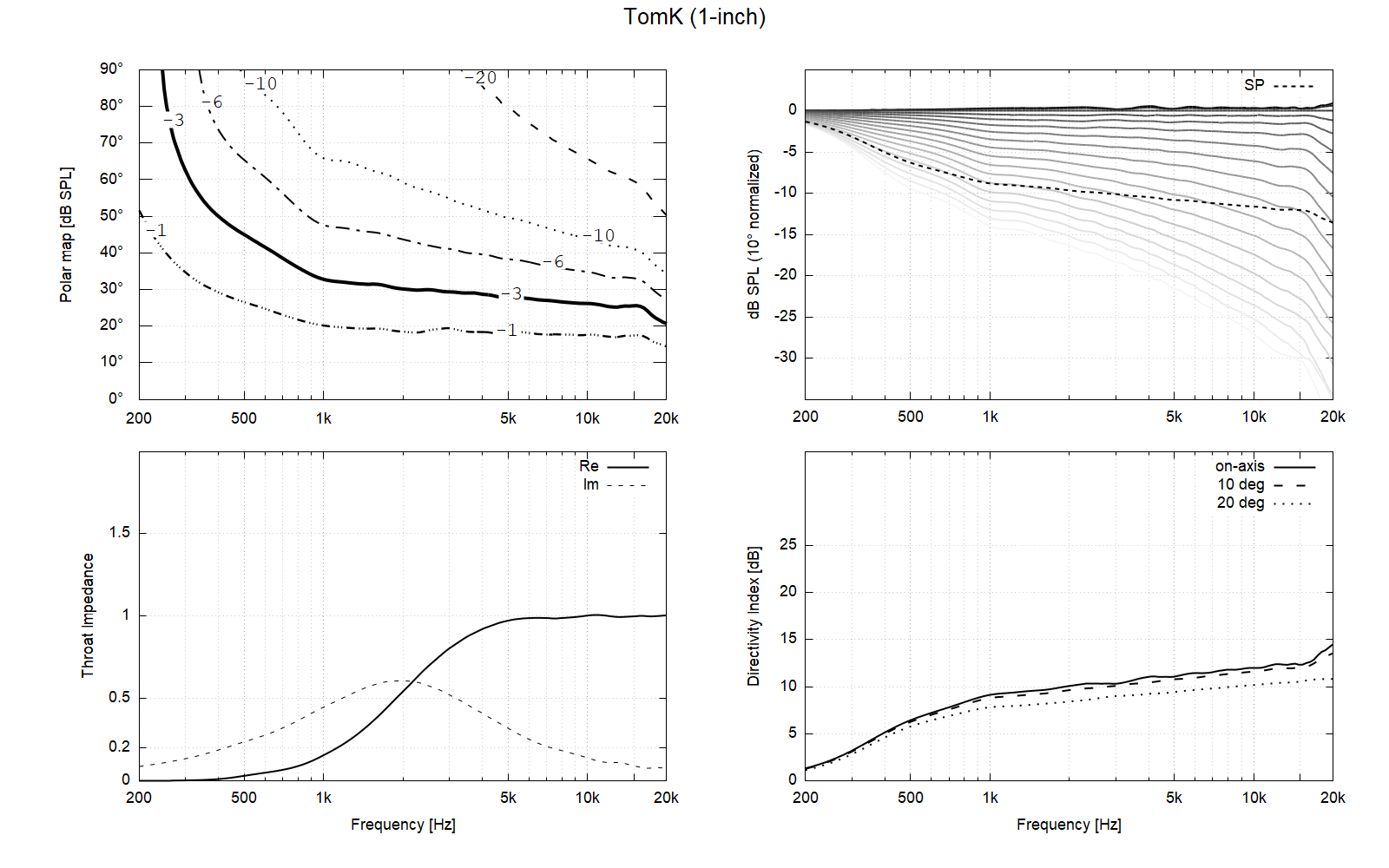

With these waveguides I don't see size as critical, due to their gradual and monotonic DI - something like what Tom showed should work wonders here, with plenty of options and freedom. With the larger throats I'd be more concerned about high frequencies - it will beam sooner than a 1" and that should (IMO) be reflected in the overall DI desing, allowing for its smooth and gradual rise. What's possible with a 1" simply doesn't work very well with 1.4" or larger (that doesn't mean it must be worse - you gain somewhere else, as usual).
That's a very different task, I'm afraid, far from being just an "inverse".Would it be possible to use this tool "inverted" to make phase plugs with it?

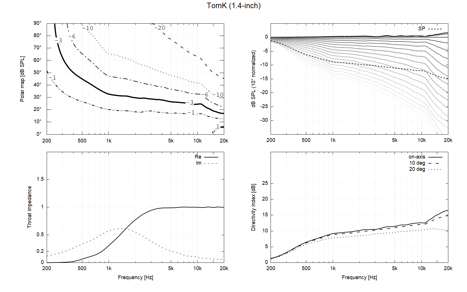

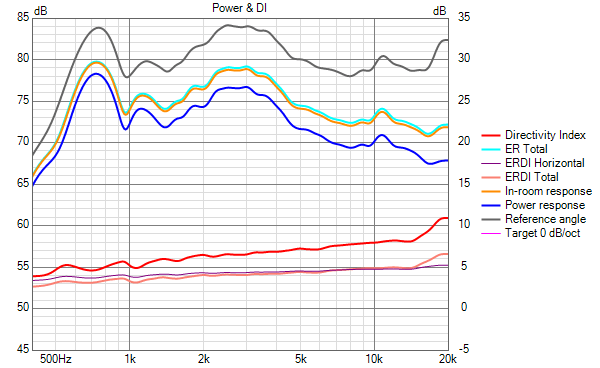

BTW, I couldn't resist and put the Tom's numbers into the simulator. It's a very nice horn indeed.
Here are the results, together with a direct 1.4" version (all else equal).
