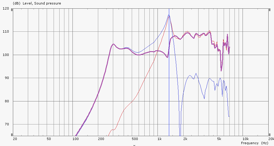

Does Horn Response allow you to simulate that with these ATH waveguides? Or is there a standard horn shape that is close enough to an ATH waveguide for simulation?The frequency response of the midrange is a tradeoff between how deep in the horn the holes are (loading by the horn) and how big the chamber/port size and length are.
It's basically a miniature 4-th order bandpass subwoofer design
I think the better way to do it is to model the driver and port (bandpass) as a lumped element coupled to a driver element the size of the port like shown in this post. This roughly equivalent to what Horesp can do except directly in ABEC with the exact shape created in Ath.Does Horn Response allow you to simulate that with these ATH waveguides? Or is there a standard horn shape that is close enough to an ATH waveguide for simulation?
https://www.diyaudio.com/community/...bandpass-mid-in-unity-horn.88237/post-4152484
You can see in the output graph the bandpass peak and cancellation notch in the output on the blue trace.
That can be done with an Ath horn model with a little bit of CAD work and some ABEC understanding, or maybe this is another thing that mabat wants to automate to remove that barrier to entry? 🙂

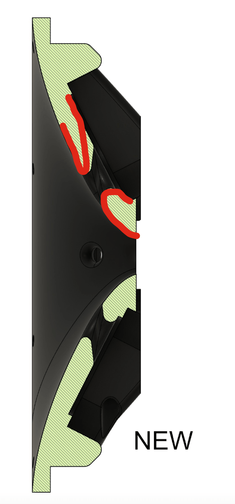

Hi Marcel,BTW, I tried to simulate a throat extension plug (bridging over the driver's conical exit section) for FANE CD131, which is quite a nice 1" driver. It has a 3-slot phase plug ending at ⌀16 mm and 30° conical exit. Extending the waveguide profile down to the phase plug ending, these are the results for a ⌀320 x 120 mm free standing waveguide based on the latest advancements:
I'm trying to make version of ST260 with an insert plug that goes inside compression driver conical exist section but I haven't been able to come up with settings to achieve it with ATH. How do you make plug that has curvature to it, how to extend the R-OSSE profile all the way through the plug as well? Throat.ext parameters seem to always make a conical section to the profile. There is numerous references to this in the thread by you, perhaps its something that is not documented? Guiding curve? Thanks!
Added a mention of the "Throat expansion factor", page 15:
http://www.at-horns.eu/release/R-OSSE Waveguide rev7.pdf#page=15
Assuming you have a driver that makes it feasible, a good approach is to set a0=0 and increase k (the throat expansion factor) until the waveguide fits into the driver (you can do that because you start with a smaller throat). Sometimes it helps to add a small lenght of a straight extension but that's basically counter to what you are trying to achieve.How do you make plug that has curvature to it, how to extend the R-OSSE profile all the way through the plug as well?
