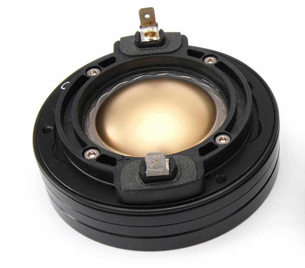

The diaphram of the ND3ST looks suitable:
The diaphragm assembly is made by joining the former directly to the titanium dome on its upper bend edge. In comparison with a usual straight former joint, the driver's design assures extended frequency energy transfer for improved response linearity and unparallel reliability. This feature facilitates proper motion control of the dome in real working conditions.

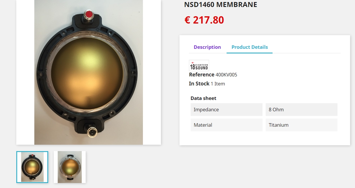

You're right. I erroneously assumed the ND3ST's diaphragm is also Nitride coated.

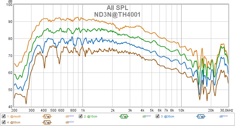

Indeed! One best performances of AL/Ti diaphragms I tested so far. The nitride coating seems to be more successful than for the bigger brother NSD4015N.
But these ND3x drivers are of very tiny format. I do not like such small outer dimension drivers. Mounted to the TH4001 horn they look really under-dimensioned. But the performance speak for themselves.

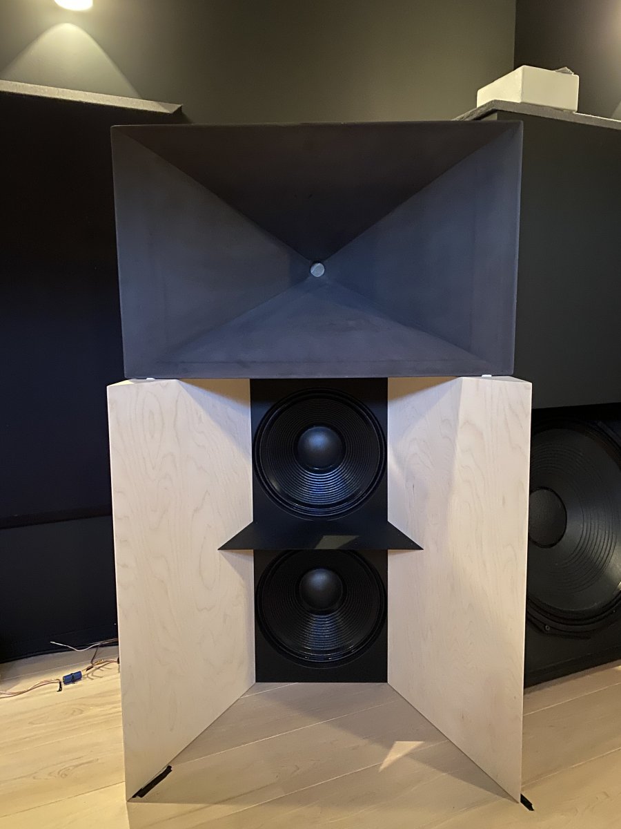

It seems quite a few guys in your country retreat from (Salmon-type) multiple hornsystems to more straightforward 2 ways (+ sub) with an increased focus on directivity.
The guy that goes by the moniker of Emokid takes the cake. He went from an ALE based multiple horn system including an Altec/GPA loaded bass array to a "modest" 2 way FLH system with 2x PD 15" (if I'm not mistaken) + TAD TD4003.
The midbass drivers are PHL 6321Nd. The cake is good.
Sincerly, "emokid" himself 😎
Thanks for posting.
There's a hint of Bert Doppenberg and Wolf von Langa and in your midbass.
I suppose it is probably a lot easier to make this sound good (as in in homogeneous) compared to your previous Ale JMLC system?
Do you perhaps have (less smoothed) measurements of mid / high horn alone and of the combined system in your room?

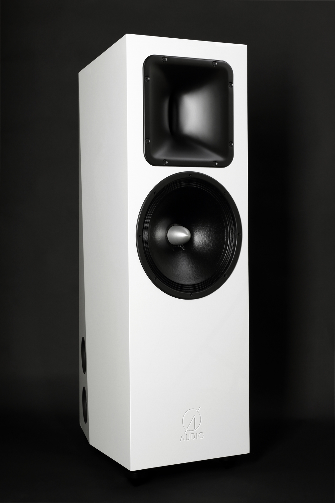

Since Norwegians are participating in this thread and while we're discussing 18Sound's Nitride coated Titanium diaphragms, the Ø Icon came to mind.
There's a NSD (Nitride) driver mounted to the XR1464 and people seem to like this combo quite a lot and praise its smoothness, which is an indication the Nitride coating actually works.

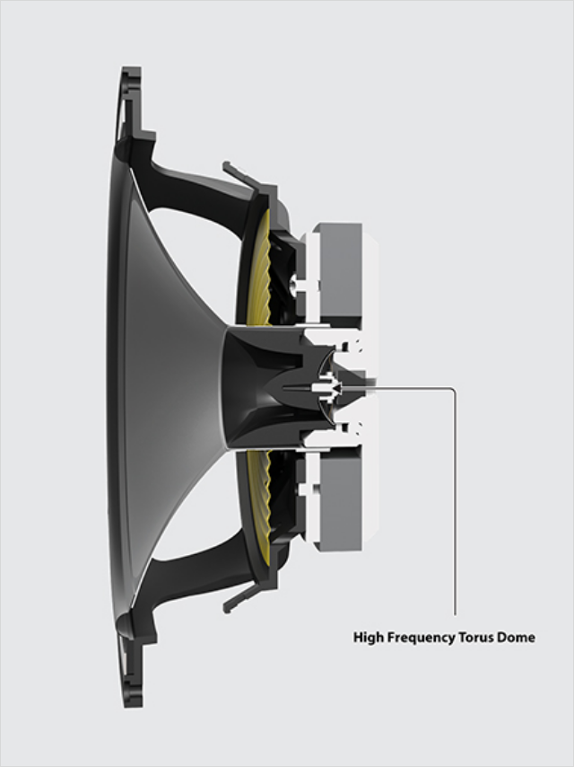

I briefly searched for existing examples of "convexely used" compression drivers.
Below are a few examples, most of them are smaller diaphragms.
Tannoy Revolution XT series DC design
The Tannoy features a center plug, it's both a clever and simple design that should work pretty well.
Small forward-radiating diaphragms are often integrated into the phaseplug, this way the issues with the surround and compression cavity can be (partly) mitigated.
