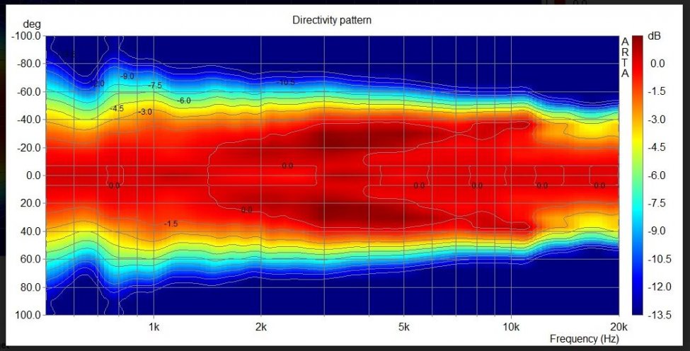

Look at the polar respons inn post 10513 under the text «sonogram storhornet», the large version. This is the best 600 Hz to 15000 Hz i have ever seen.
Is this with the JBL 2451Be or the TAD TD4003?

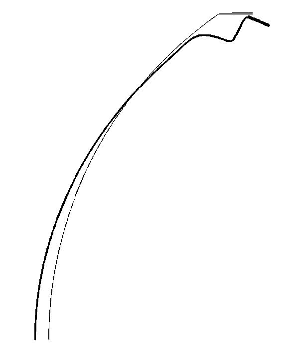

Sure, I was reffering to metal diaphragms and the situation when the surround (suspension) and the diaphragm are from one piece of material as this situation is still very common. Also it seems to me that bending this plate near the edge must deform the whole structure, including the voice coil. I guess this holds for any material when clamped at the egde like that.
I would try to cut the suspension off the clamp and glue a foam ring between the edge and some mouting flange.

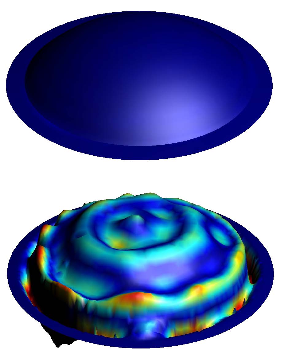

Yes, the bending of the VC is also shown in Oclee-Brown's thesis (2nd pic.)
These issues probably also fuelled development of an annular diaphragm for the Axi2050.
Yes, this is what I'm talking about I suppose. So my question is why to clamp the whole plate (diaphragm + suspension) at one point at the edge so it actually must be deformed for any axial motion of the voice coil? It seems to me that there must be a better way, like some elastic clamping of the whole suspension that would not require the deformation of the diaphragm but only of the suspending foam. It would get deformed anyway but to much lesser degree I suppose.

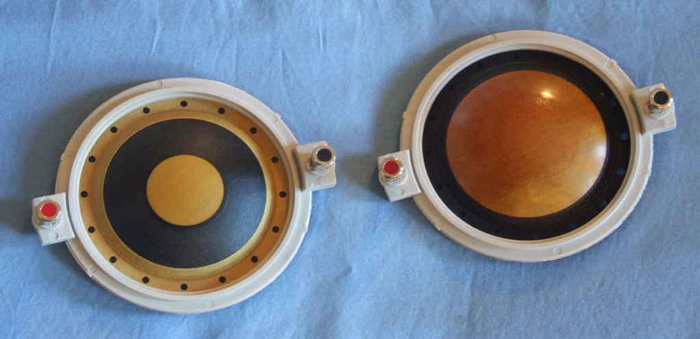

A very small surround?
My solution would be an improved clone of G.T. Sound's Duraluminum diaphragm.
The Japanese produce the highest grades Aluminum (alloys and composites), but China and Russia are catching up.

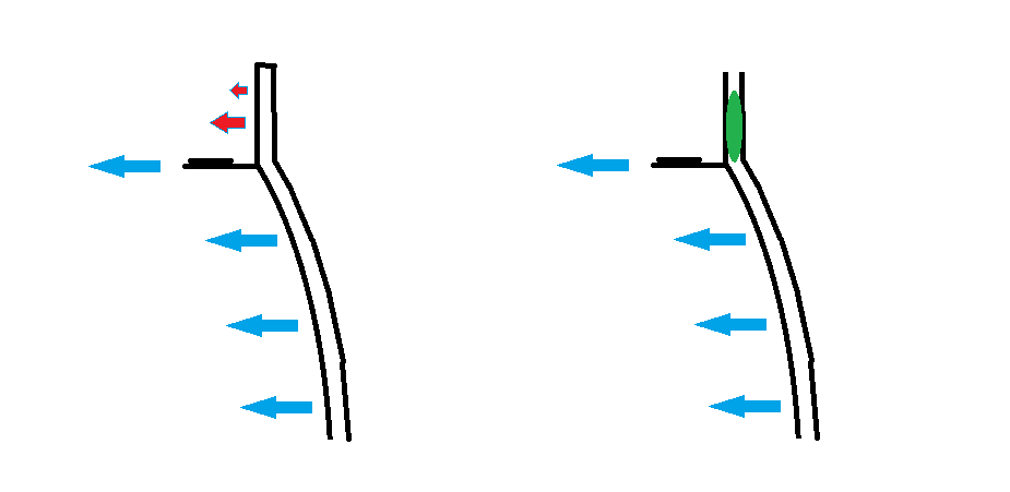

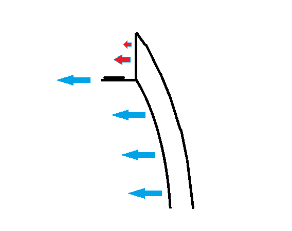

First and foremost, I would want a uniform pressure drive across the whole wall of the compression chamber, i.e. not to have any suspension in the chamber. The practical realization is another issue.
No I don't know what you mean.
- Maybe I should more precisely say that I want a uniform axial excursion across the cavity wall. In any case leaving a falling excursion towards the periphery of the chamber makes the situation a lot worse as the simulations suggest.
Yeah, a "foam" stands for "something elastic" here. Maybe, given the dimensions and excursions involved, just a layer of a suitable permanently elastic glue could work, I don't know....Foam probably works well at low freqs, but I expect too much damping for hf.
JBL 2451 with Truextent

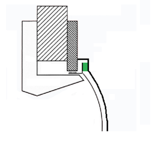

The green part is a kind of damping (material) I suppose?
I am definitely no expert in mechanics, but some (not too much) "cushioning" seems the best way to absorb (most of) the vibrational transmissions.
The green part is the suspension - it would have to hold the diaphragm in place and allow for its axial motion.
