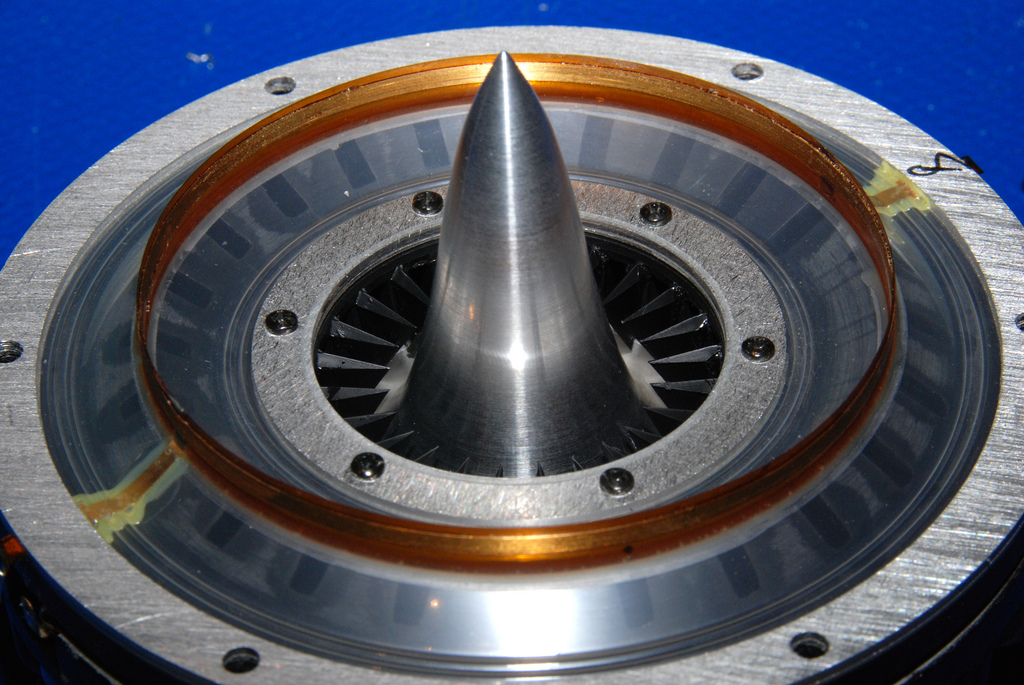

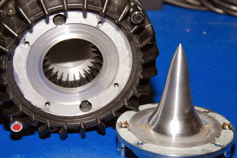

That doesn't answer my question how to setup the simulation to obtain the actual impedances. But I think the slots can be regarded simply as wavegudies of their kind and use the same procedure. I only wonder if it depends on whether the other channels are driven at the same time or not. It should I guess.
To me getting a radially pulsating source is the holy grail to waveguide design. So if that was their motivation and if they succeded, which seems to be the case, based on the available measurements, then it is actually quite an achievement.Apart from a 3dB increase in power response, the added advantage of the KEF tangerine phaseplug seems questionable.
But hey, it looks cool so it'll probably sell
Just look at the directivity index of the latest UniQ - https://www.audiosciencereview.com/forum/index.php?attachments/1588968486698-png.62530
Actually, the channels should be mutually coupled, i.e. pressure at the channels outputs effects each other acoustic loading. ABEC3 accounts this automatically if you consider each channel as the separate source. But for the correct simulation you should also consider thermoviscous losses that have profound effect in narrow channels, the picture below demonstrates the effect
There is no way for direct account the thermoviscous losses in ABEC3, but you can do some approximation as was recently described by Joerg Panzer
http://pub.dega-akustik.de/ICA2019/data/articles/000394.pdf
Fot the thermo effects you need comsol, but you can appoach the effect a bit by adding a little damping inside the channels.
And yes you can check every channel seperated and terminated with full absorption first.
I think this is good to do to isolate effects, the complete system is very complex and you ll have a hard time tuning thongs that way. A bit comparible to trying to tune a speakers and the roomnacoustics a the same time
One approach could be to have te channels exponentially expanding for better loading in the lower freqs, or you ccould also you continue the conical expansion of the horn right down to the phaseplug.
Jack Oclee-Brown:
""Up to a frequency of 20kHz, the directivity index is almost identical to the version without the phase plug. However, between 20 and 30kHz, the tweeter with the radial-channel phase plug is less directional, although arguably the directivity index of the tweeter without the phase plug is slightly smoother."
and:
"Approximately 80 different permutations of the channel flare were evaluated before a combination of central plug shape, exit surface and flare function were found that resulted in satisfactory performance."
Also taking into account the manufacturing issues, one may wonder whether a minor performance gain > 20kHz is worth all the hassle.

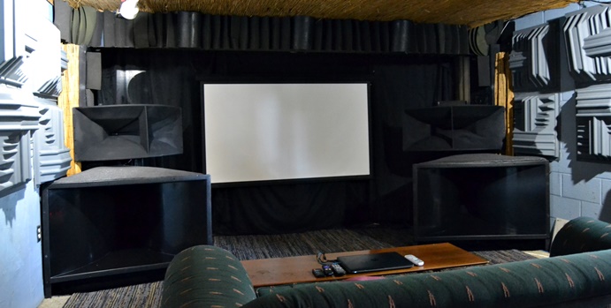

I have 2384 today. It sounds very good. But it isnt loading good under 8-900 Hz.
You can see my system in post #3724
Hornlyd i et lite rom - Side 187
I had a huge Tractrix horn before and miss the huuuge deeep sound:
5 way horn & Acoustic Elegance
The problem was loobing. With 2384 i have point source from 800 Hz and all the way up. I have also tested with and without Fostex T500 and i prefer point source all the way up even if i lose som «air» over 10000 Hz.

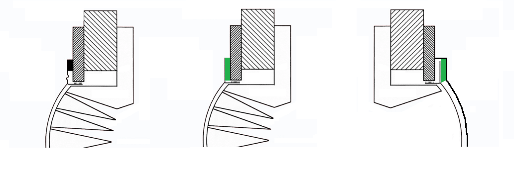

Maybe someone more informed about the mechanics involved could explain to me why a bending piece of metal (typically) is used as the surround all the time, instead of a ring of some more elastic material as illustrated (the green area). I thought about how to drive the compression cavity as uniformly as possible and this would be what I would try at least for the "convex drive".

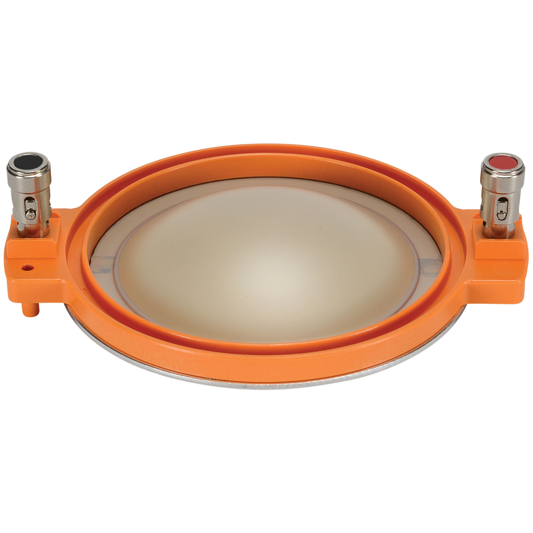

Not "all the time", or in every instance
I assume you refer to the actual surround and not the metal support ring underneath?
