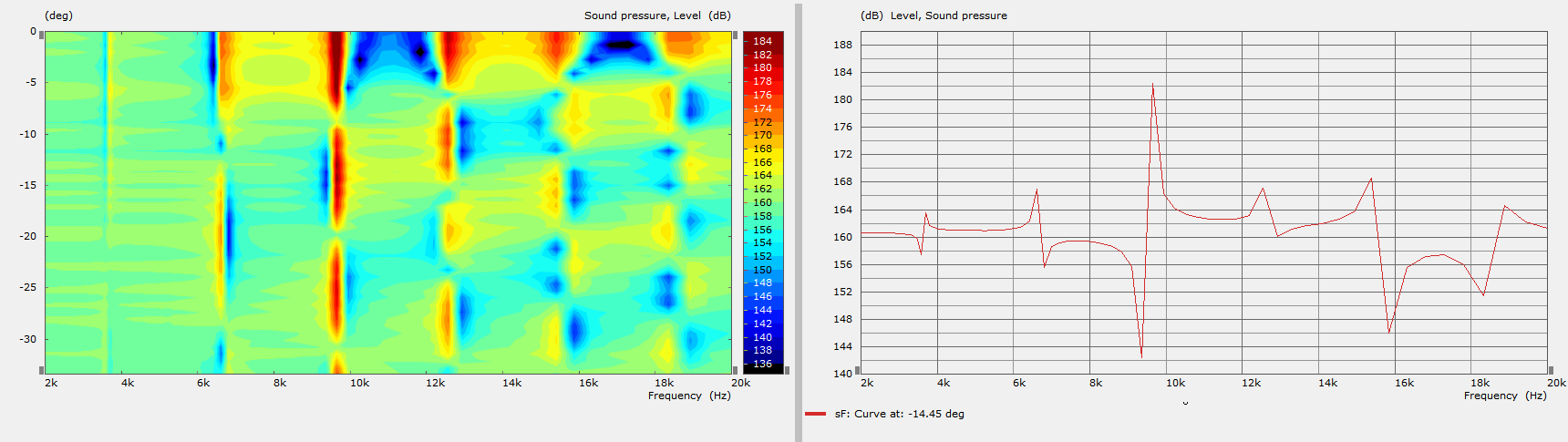

A couple of things jump out at me. First, it appears that a flatter diaphragm has fewer resonances, which would be a big advantage. Kind of dispels the idea of a deeper draw on the diaphragm, until diaphragm modes become more problematic than phase plug modes.
Second, for the example shown above, the disturbances are not significant until about 15 kHz. Is that really worth worrying so much about? (its a 2.3 % difference at 8 kHz. or about -32 dB. This would be very hard to measure let alone hear.

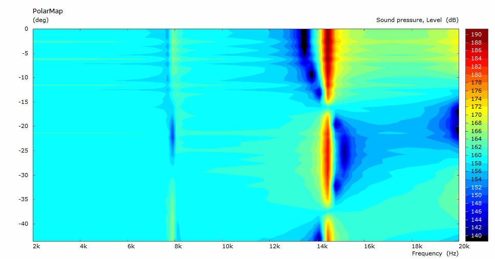

It should be noted that the example above is for an ideal situation where the chamber is driven uniformly across its whole face. If the surround is incorporated, i.e the excursion is progressively reduced to zero at the egde, it get considerably worse (the first picture shown).

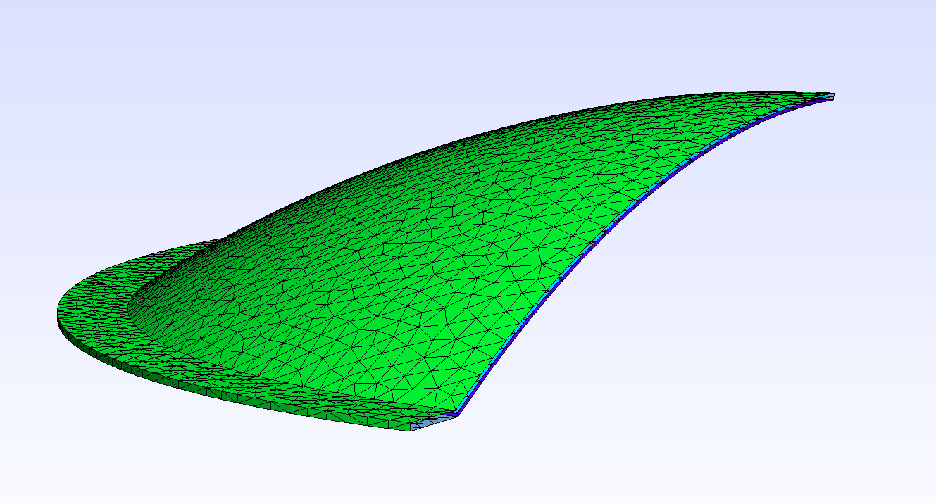

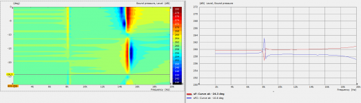

A already tried a deeper draw, it's not that worse in fact (see the image attached). I can imagine it might have an advantage in the end. Hard to tell, the Celestion data doesn't actually look that better in the datasheets.

How did you get this number? To me it looks like there might be otherwise a difference in the input pressures of several dB for the two channels. So I probably still not get it.its a 2.3 % difference at 8 kHz. or about -32 dB

OK, but one wants to drive all the channels with the same pressure, no? If ignoring these modes (which are excited even without the channels just because of the cavity curvature - I wouldn't think of that a few days ago), severe disturbances might be introduced just by this. At least this is how I read the results. I might be wrong about the importance in the overall picture however.
I only have doubts about the summing of the individual exits of the slots. It is my impression at the moment that for this to work properly, they should share the same output area, overlap in fact.
Sorry, I misread the units on the graph, It would be 6 dB difference in 260 dB, a 2.3% difference in dB. It's not clear to me that this would mean a 6 dB problem in the radiated sound - I would think not. The differences could average out yielding no net change in radiation. Or they could couple to a HOM making it worse if there are HOM propagation at 8 kHz.
I would think that the channels should all have the same volume velocity. If the channels all have the same area then they should have equal pressure, but if the areas differ, then so should the pressures.

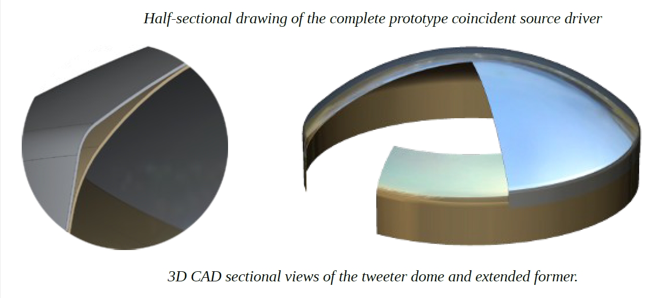

This is an interesting diaphragm feature, the integrated VC former.
I'd like to see this formed in one piece of a (nano) Al alloy (composite).
