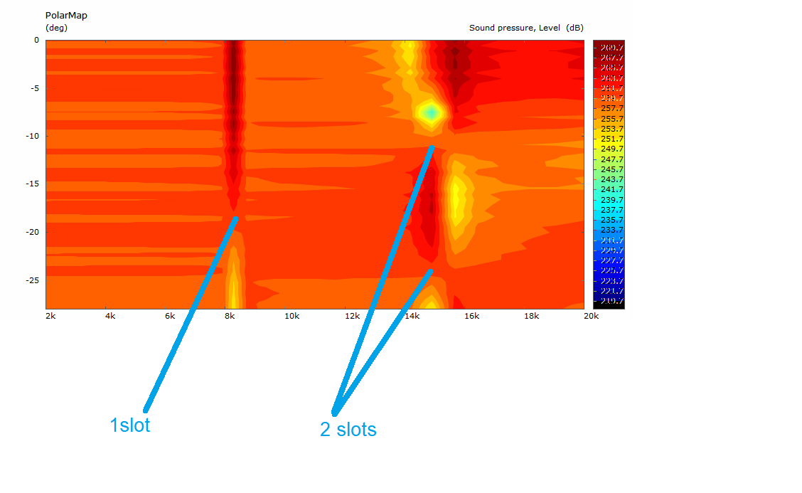

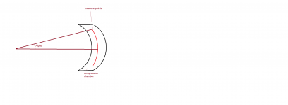

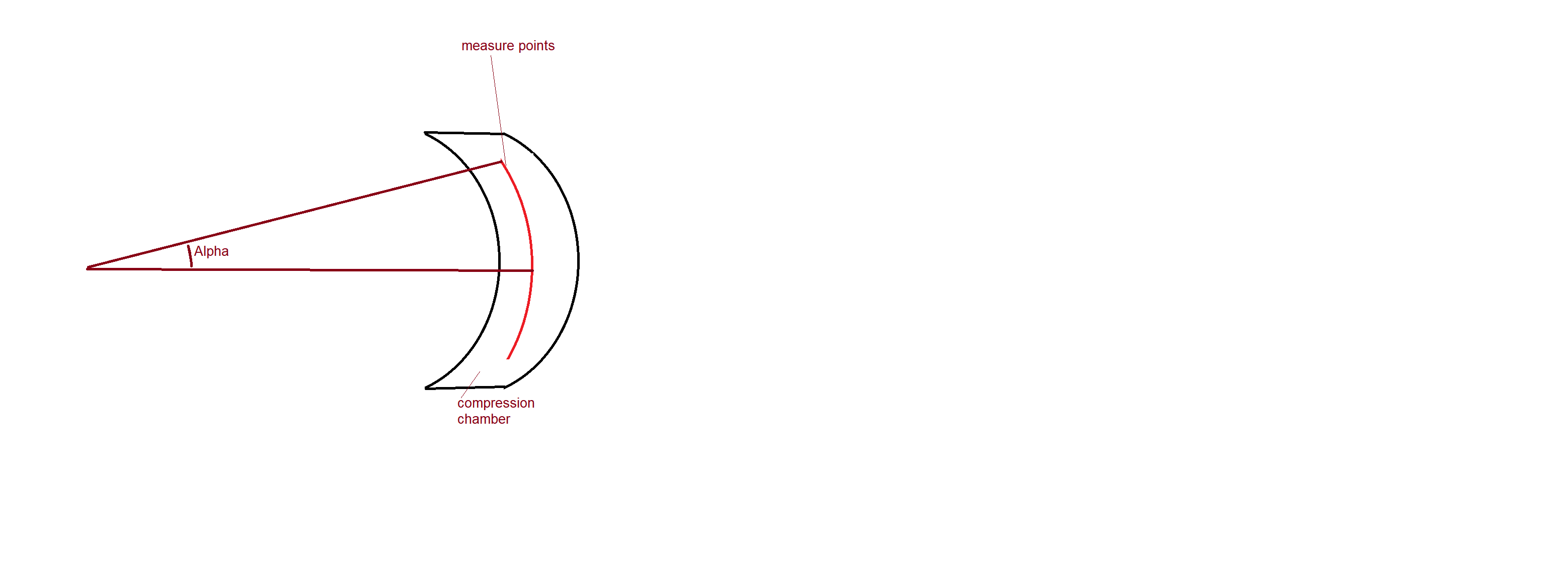

Kees, as I started to go practically through your points, just to be sure - what do you mean by "line response over the surface of the diaphragm"? Are these simply SPLs measured in front of the diaphragm, at densely placed points along an arc? Do you really mean a thousand of them per 1 deg?Another tip which I have used before;
-let ABEC generate a line reponse over the surface of the diaphragm with a very high angular resolution (0.001degree).
-Then run the sim with the channels not attached tot the compression chamber.
-now, if you open this reponse in a VACS contour plot, you can scroll through the angles and determine the optimum place for the channel entries, this is the location where the frequency response has no dips/peaks.
-then thank me later 😉

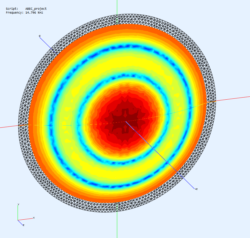

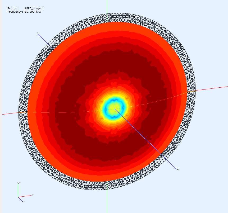

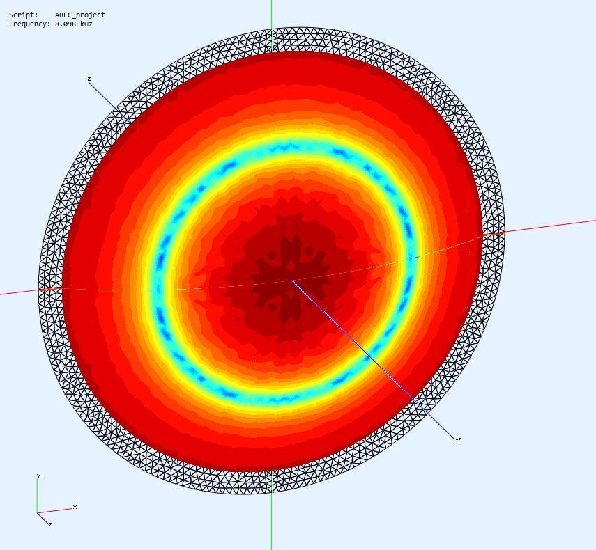

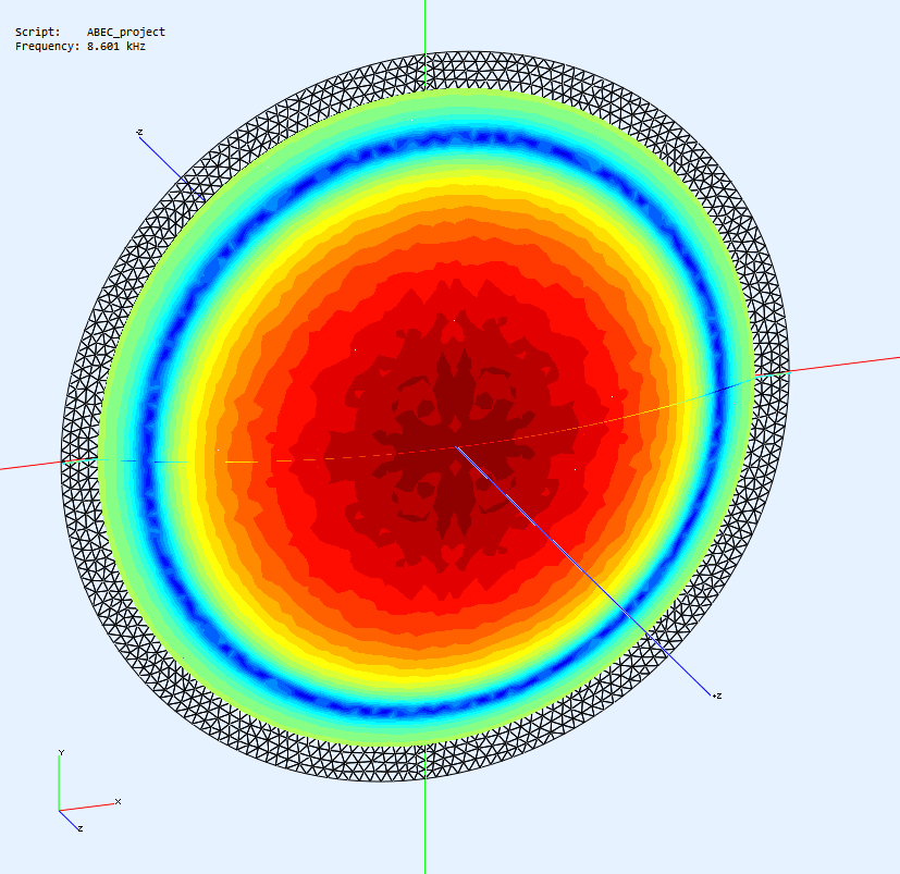

Oh boy this will be tricky. For now this is just a chamber without channels connected. There are basically no radial points without issues. 😱
Treatment of the surround will be critical I guess. More on that later.
Also, I suspect now that the "deep-drawn" diaphragm cavity would behave even worse in this respect.
(44 mm voice coil diameter; 0.5 mm diaphragm-phase plug distance.)

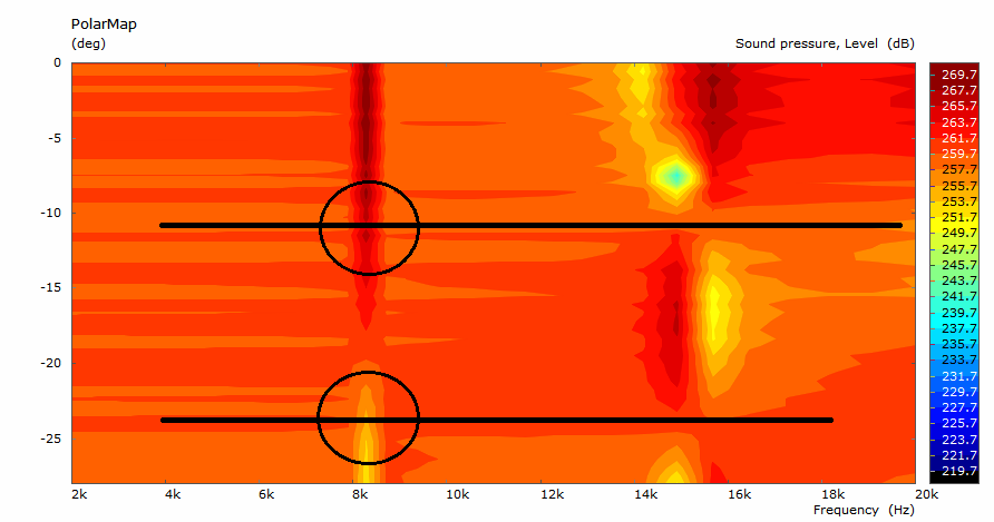

Good!

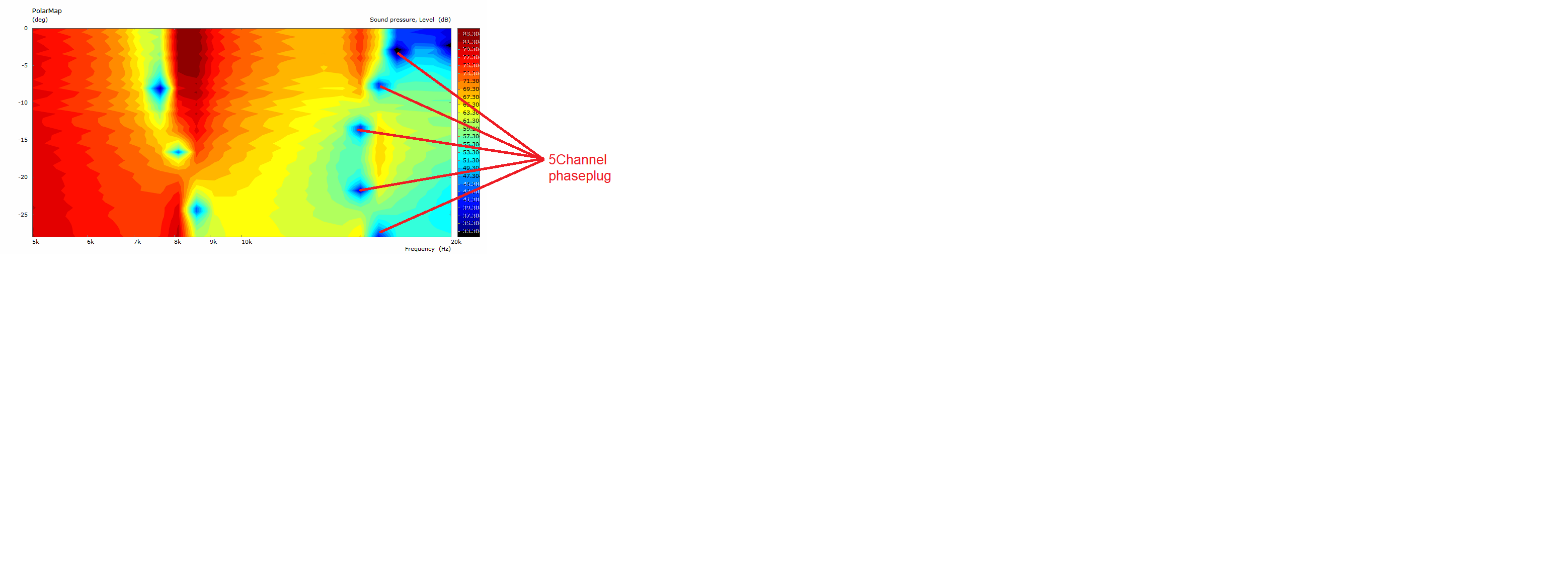

now scroll through the results and find the first 4 nodes (for a 4chnnl phaseplug), this is where youplace the channel entrances
more clearly,
this way you can see how many channels are needed to get clean reponse to a certain frequency (apart from diaphragm breakup of course, you would need COMSOL to also model those)

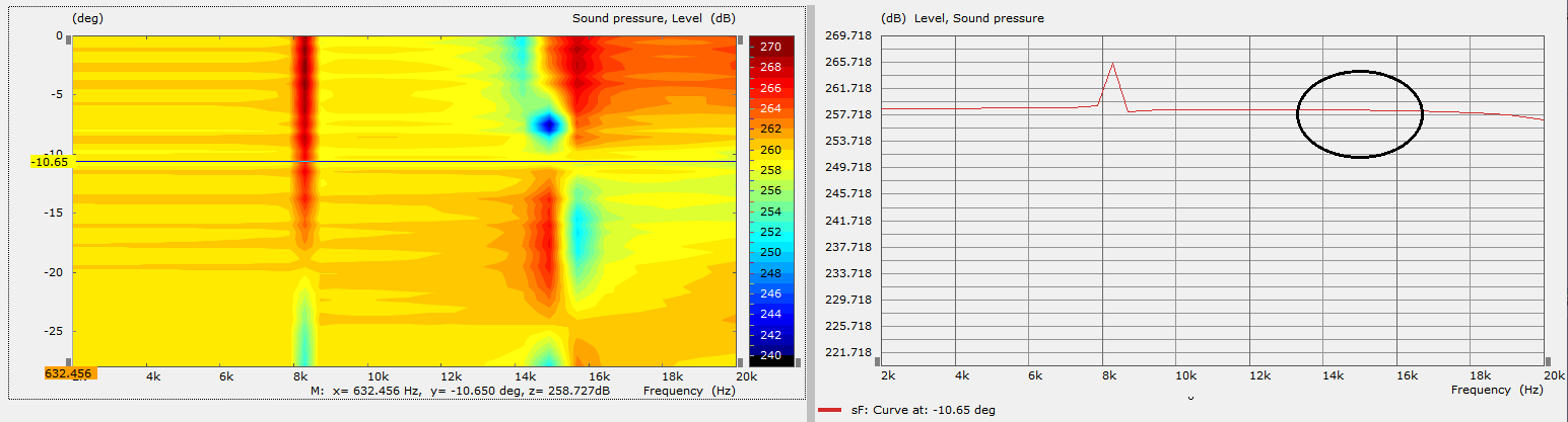

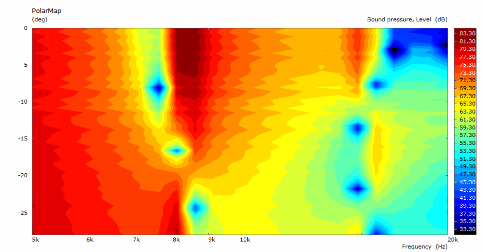

BTW, the following would be for a uniform axial drive along the whole chamber. That's much better but this won't be the case in practice as the surround contributes less and that makes quite a difference in the end. I wonder is this can be dealt with more effectively when using the diaphragm from the voice coil side
(On the second plot I changed frequency axis to linear and the driving to constant excursion (was of constant acceleration before).)

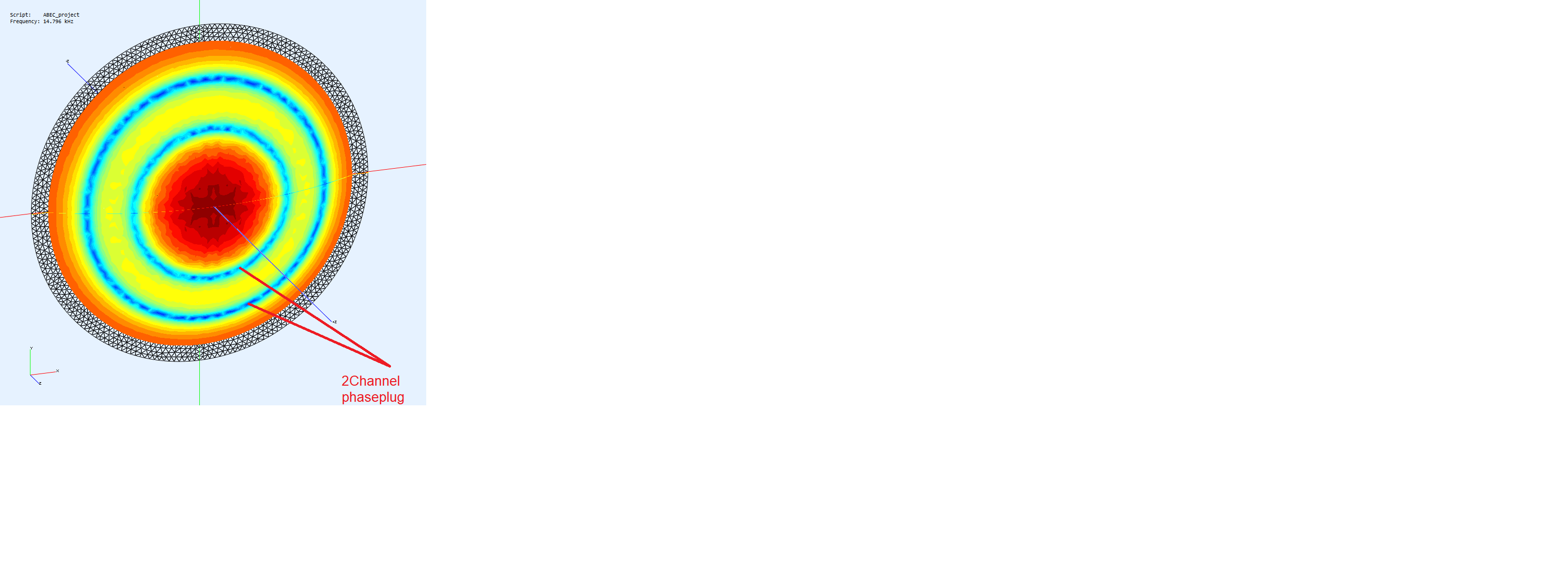

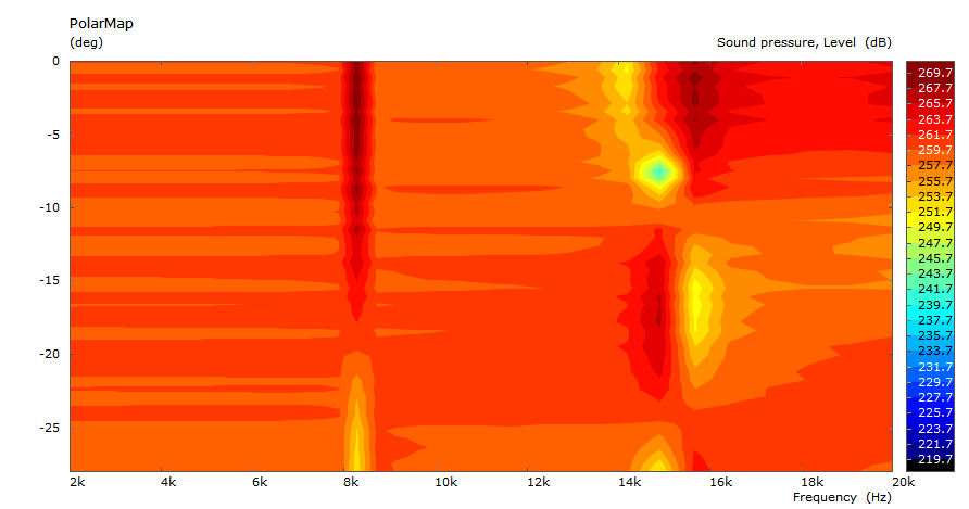

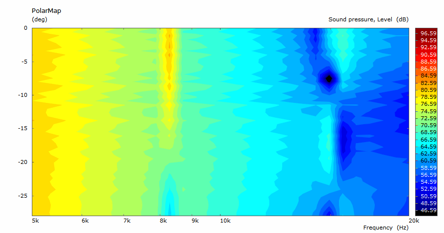

Sorry, I have been giving wrng info in the last 2 posts! (it has been a c ouple of years since I've done this myself)
please see pic attached, the entrances should be at excatly in between the nulls and the nodes of the resonanes
probably the lines I marked aren't the whole picture,k please try and scale the color range for better insight (you should see what I mean if you place a horinzontal marker and look at the frequency plot of that, the angular location without strong peaks or dips are the proper ones
Yea, I understand what you mean by the peaks and dips. I only still don't get why it should work this way. But I'll try to figure that out!
(The frequency resolution is also somewhat coarse as this is just a quick sim to make some insight).
So, if I'm getting this right, the two slots positioned as illustrated would in effect cancel the mode around 8 kHz? Is this a generally applicable principle here?
I just can't see how this could improve the wavefront at the throat of the waveguide as the slots terminate at different places.
