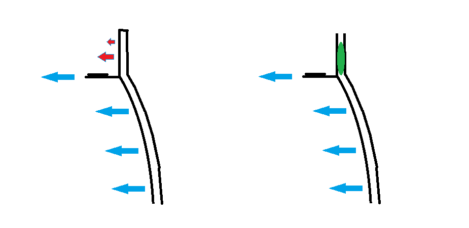

A typical silicone sealant resists temperatures to about 100°C, some even to 300°C. Could that possibly work? Hardness is about 20 - 40 Shore A. What is the mechanical property that would indicate its suitability for this purpose?...And this would be my completely naive attempt to resolve it -
If you're planning on using it as a filler material, it seems to me it would be too stiff? But silicone foam might work if it's clamped/snugged in place.A typical silicone sealant resists temperatures to about 100°C, some even to 300°C. Could that possibly work? Hardness is about 20 - 40 Shore A. What is the mechanical property that would indicate its suitability for this purpose?
The suspensions on compression drivers are actually pretty stiff but I have no idea.

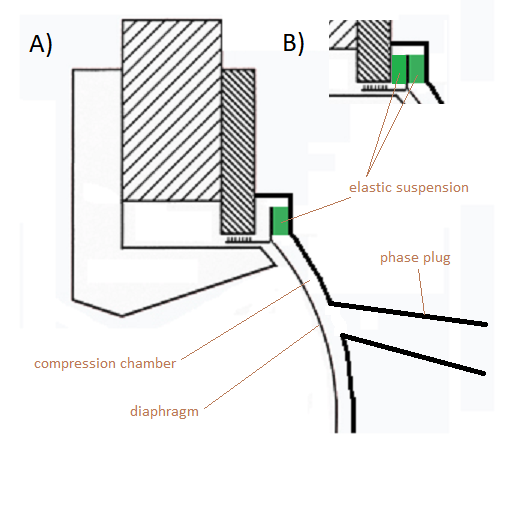

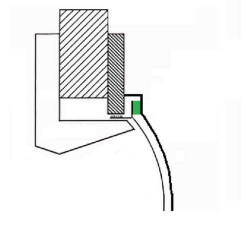

This would be the situation (as a principle, not actual drawing):
Silicone on both sides of diaphragm ,compression traction equals on both directions ( forward backward diaphragm ) if I understand your graphic correctly.
The suspension of a CD is normally very stiff to restrain excursion as well as to raise the resonance into the passband. But equally, if not more important is it's lateral stiffness. This is required to keep the voice coil centered in its very narrow gap. Silicone may be fine for the excursion, (a little too soft though I suspect) but what you show would have very very low lateral stiffness (the silicone in shear.) This would be a major problem in practice.
You might try filling the gap, but I suspect this still won't be stiff enough.
