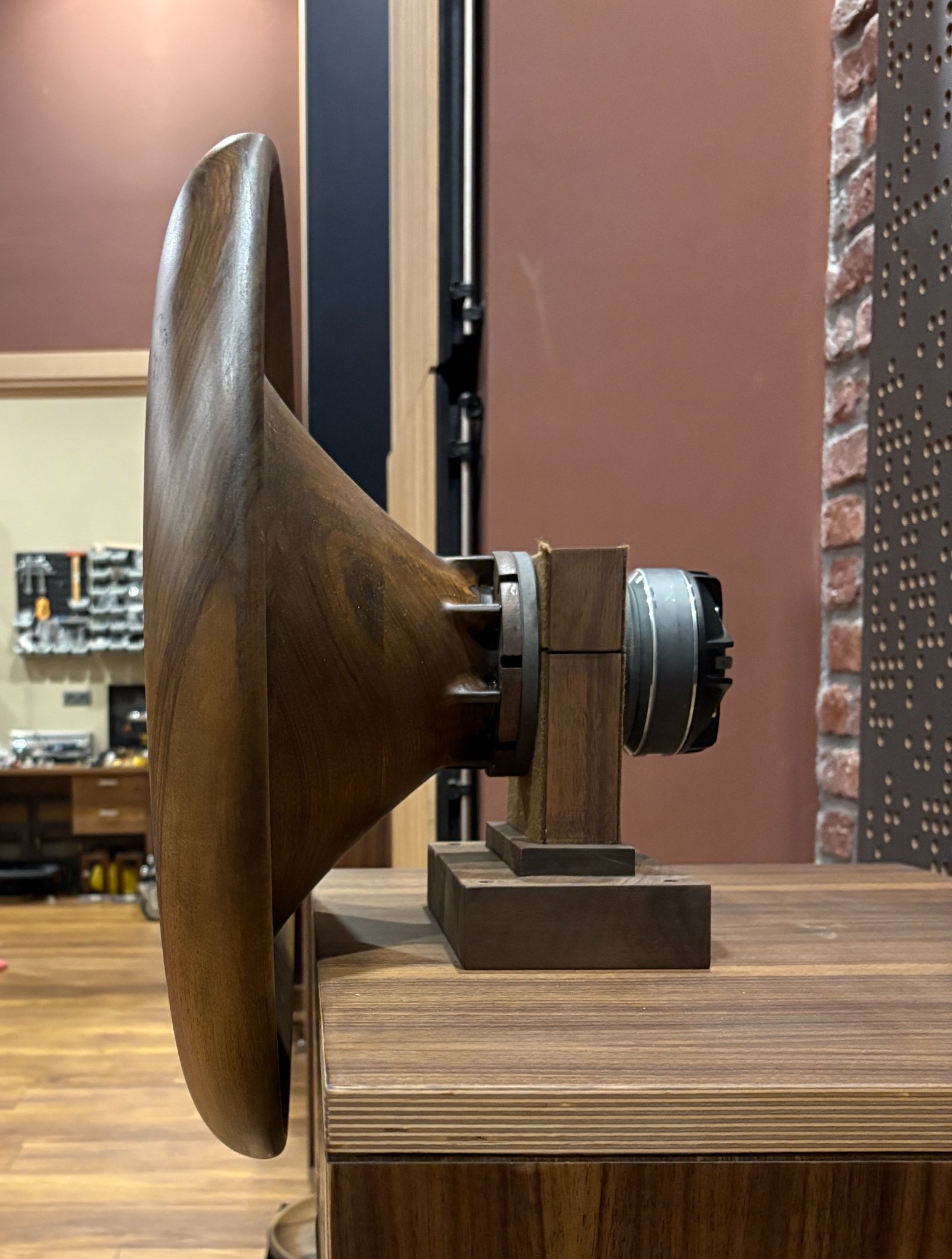

Nylon easily absorbs humidity.
If you don't have already do this, you could check this steps:
  • Drying the parts in an oven, maybe few hours at low temp like 50° celsius. Be aware of a potential shrinkage. Measuring the throat hourly.
  • Cleaning with isopropyl alcohol
  • Sanding the surfaces
  • Cleaning again
  • Quick drying with an hairdryer
Is the glue good, not too old ?
Are the 2 parts mixed correctly?
It's possible to pour the glue in a cup to see the quantity and mix by hand
Thank you very much.
I cleaned them with iso, resand the surfaces, cleaned and quickly dried with a heat gun.
The glue is new and I am using its own mixer. I applied and waited 24h.
Today I put them together and they seem to hold (for now). I am waiting for 24h like this and then I will put some stress on them to see/hear if anything is happening.

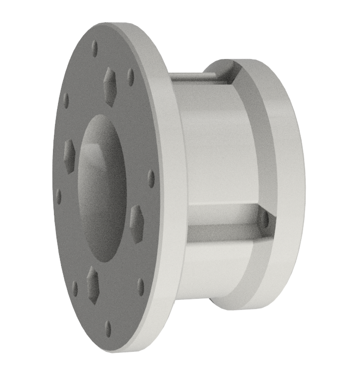

Does the top phase plug come together all in one piece with the troath?
I don't know what do you mean by "with the troath", but no, there's supposed to be a gap between the ring inserts and the flange - see Fig. 9 here: https://www.at-horns.eu/gen2-4554.html
BTW, all the three parts were intended to be printed separately. I'm not sure there's any advantage in doing it otherwise.
