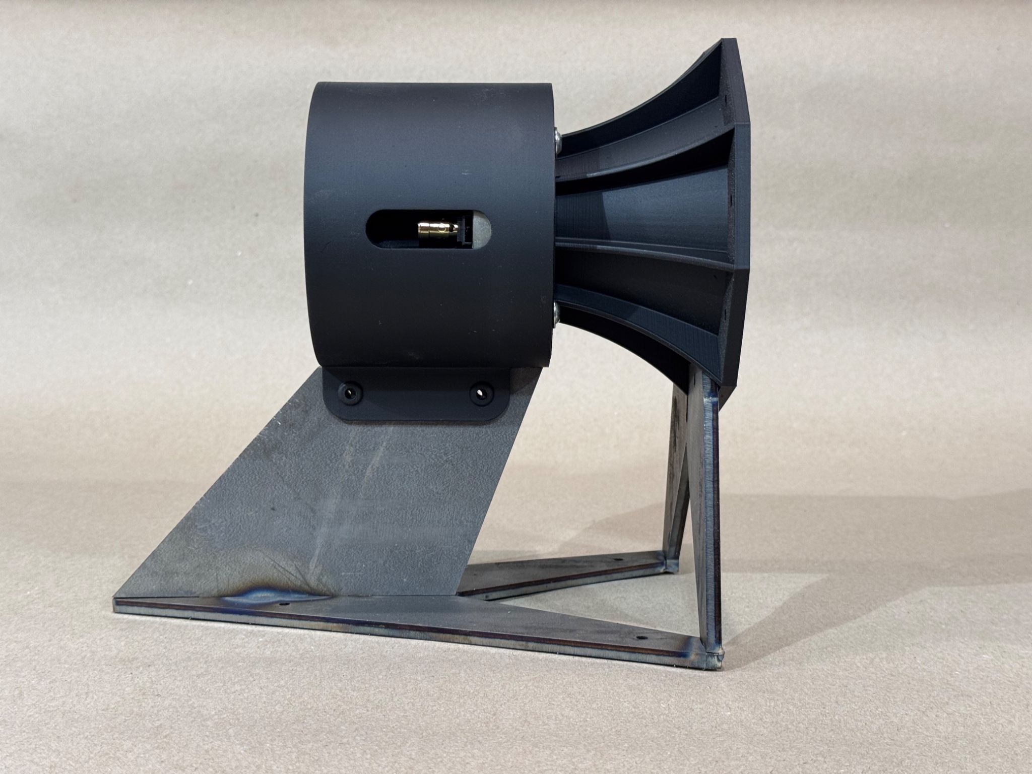

while the petals are busy being milled on the CNC I had a chance to weld up the horn stands - at 1/4” plate steel they won’t be going anywhere

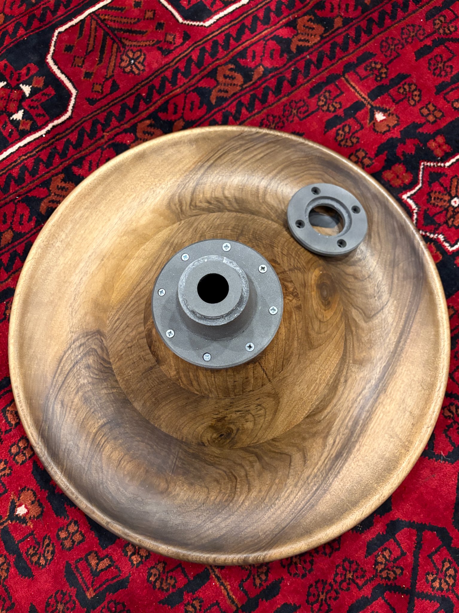

I couldn't make the measurements because the throat piece delaminated. It was not a strong enough bond to hold the horn it seems. It is made out of MJF and I have used (per HP's recommendation) the Loctite HY4070.
At this point I am considering if I should make the throat one piece out of mjf or maybe even wood. Why was the throat in parts to begin with? Is it for the ease of printing?
Hi @kodomo,
Nylon easily absorbs humidity.
If you don't have already do this, you could check this steps:
  • Drying the parts in an oven, maybe few hours at low temp like 50° celsius. Be aware of a potential shrinkage. Measuring the throat hourly.
  • Cleaning with isopropyl alcohol
  • Sanding the surfaces
  • Cleaning again
  • Quick drying with an hairdryer
Is the glue good, not too old ?
Are the 2 parts mixed correctly?
It's possible to pour the glue in a cup to see the quantity and mix by hand
Yes, ease of printing. But it was never intended for holding all the weight as in your case, the more so with such a heavy horn.
It would try to find the center of gravity of the whole thing and design someting on which you just lay it and fix. The recent adapters are all cylindrical from the outside, which also helps, maybe you could redesign this particular one to something more suitable in your situation.

In this case I farmed out the cutting to an outfit called sendcutsend - they do custom lasercutting from drawing files and they are really pretty reasonable. I've done the clamp-a-tube-section-and-cut-with-an-angle-grinder thing in the past but you go through so many disks that it ends up being more expensive anyway, not to mention much less precise.

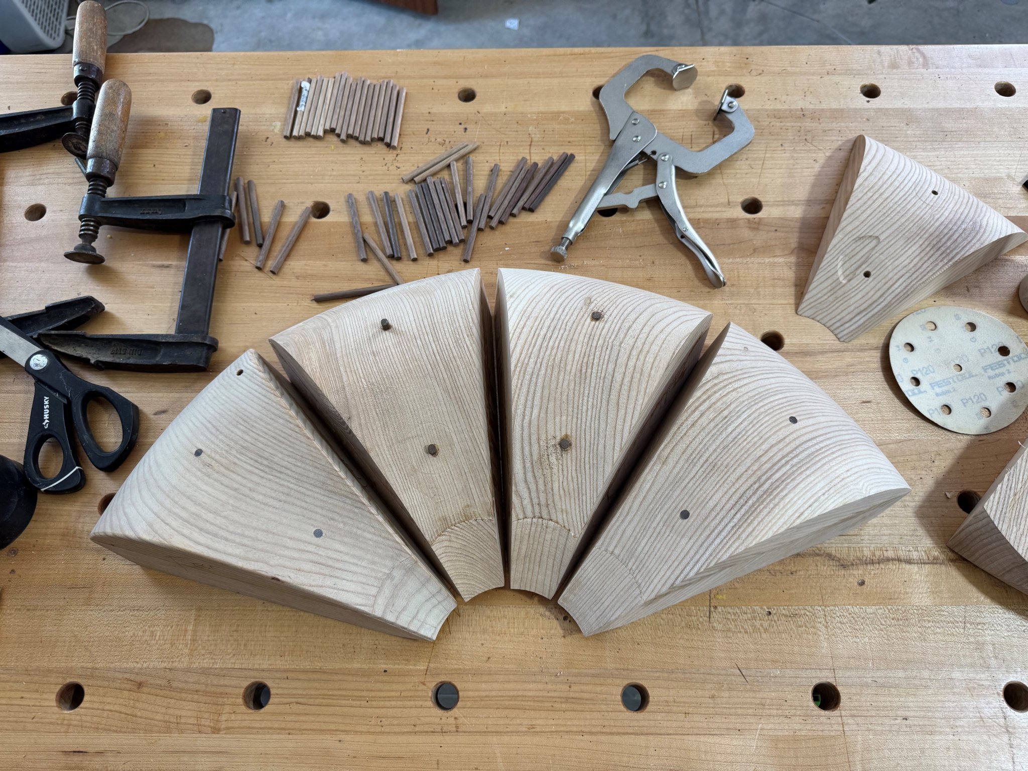

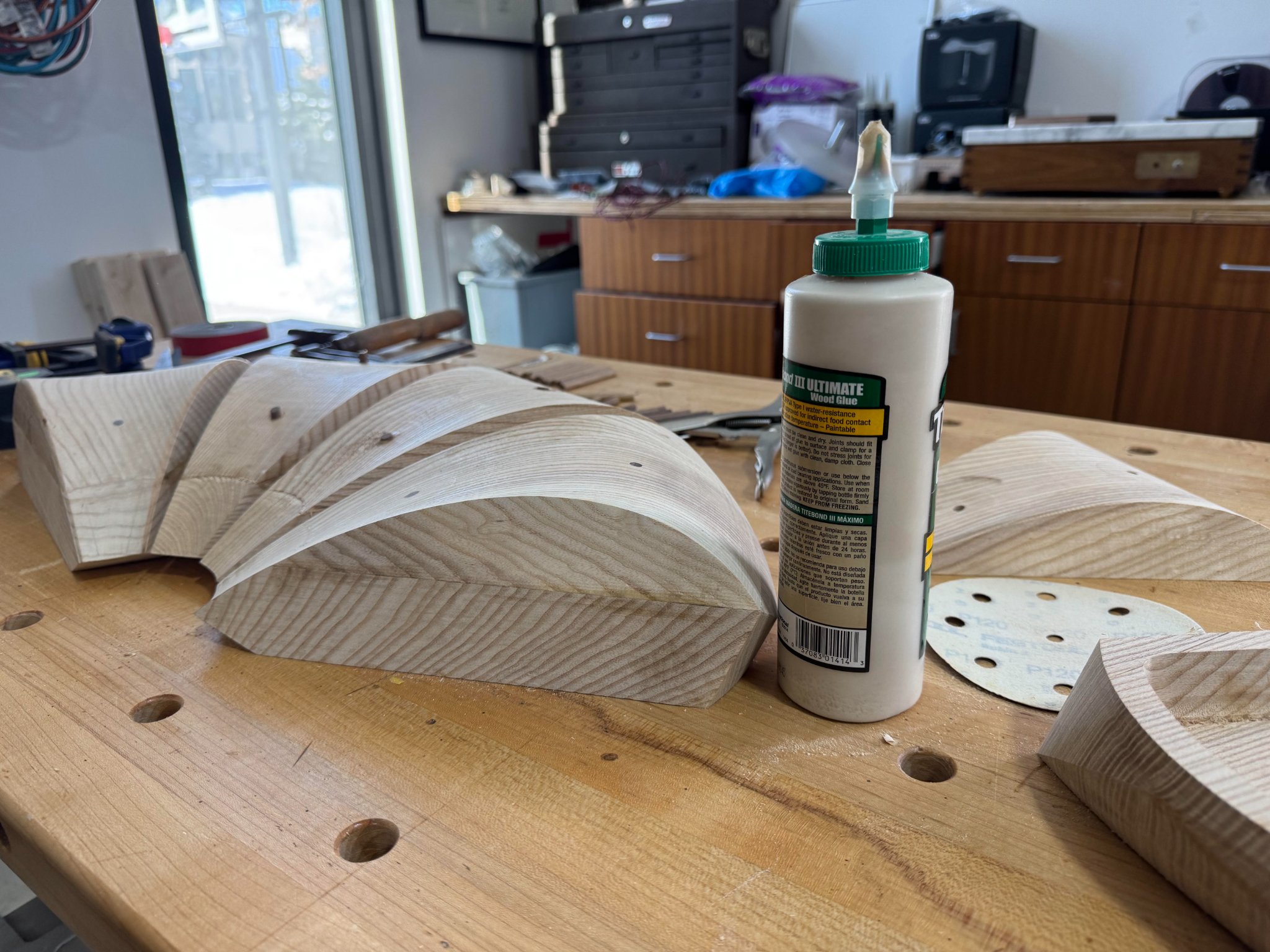

Also - finally starting the process of milling the tops and gluing up each of the 9 petals per horn. Here's what the first three look like (fourth was a test with mistakes) and a photo with a glue bottle for scale. Also obligatory clamp picture.
