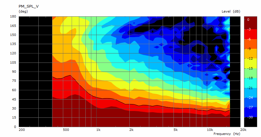

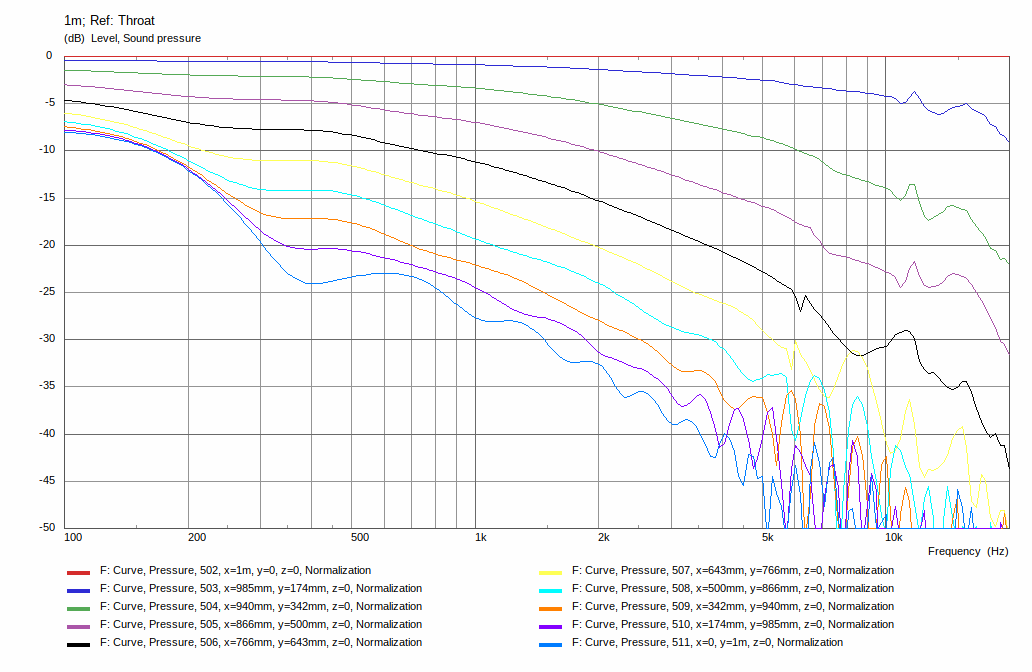

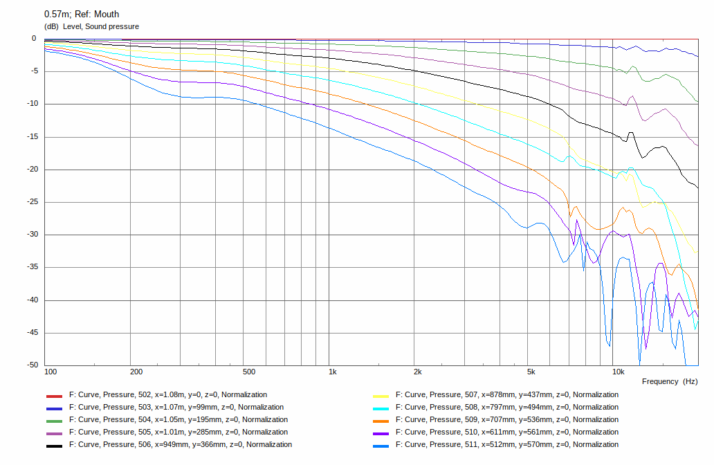

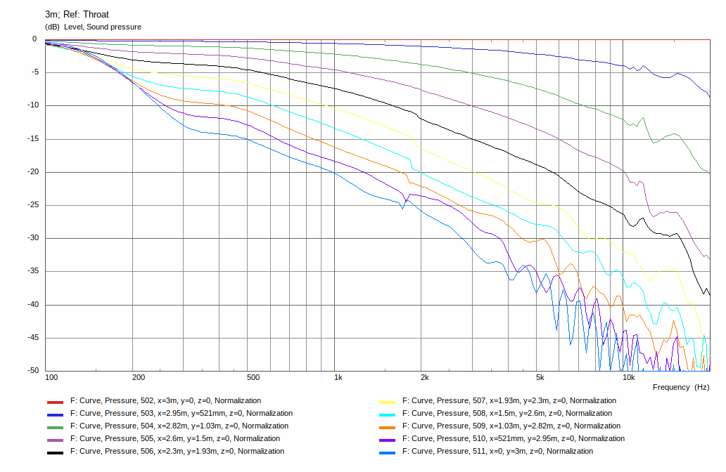

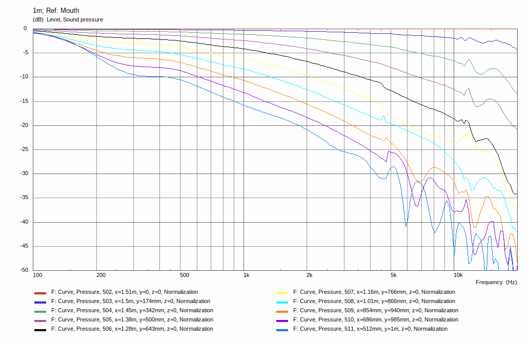

I concur. The distance and point of rotation matters a lot. Whenever I measure my horns/waveguides at home with too small distances (~1m) I find that the horn is much wider than the simulation predicts (most recently a large +-50 degree horn I made showed closer to +-70 degree beamwidth at this distance and with wrong axis of rotation at the throat instead of the mouth). When taking the horn to a large space where measurements can be done at, say, 3m distance and with the same point of rotation as the AKABAK sim, they match almost perfectly. I typically set the mouth as the reference rather than the throat, FWIW.

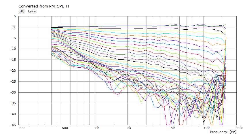

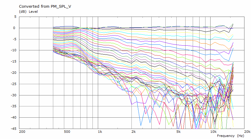

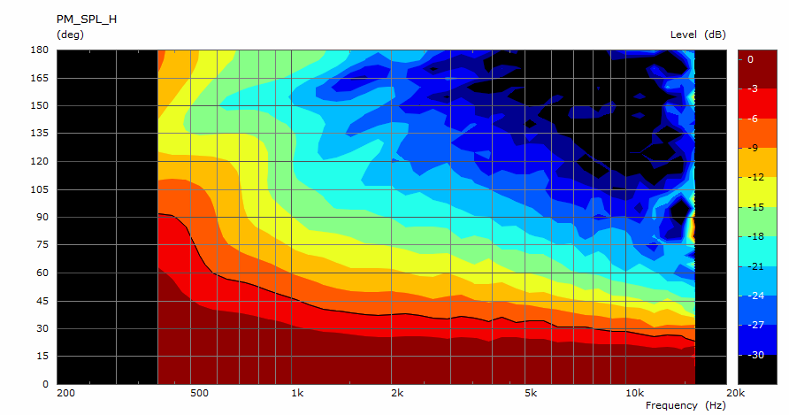

Apologies; I guess I could've figured that out if I had paid attention to the polar map...The steps are 5°
I agree that the discrepancy is likely due to differences in distance and axis of rotation. If the profile is available, I can run a sim with these parameters matching the actual measurement conditions (or someone else can, if they're so inclined).
... is not the same as 5 deg steps - right!?...text is stated 5 degrees normalized.
Thanks. The origin of the rotation was on the Z-axis aligned with the horn mouth and I rotated the horn, with the mic at a fixed place. So the driver moved away sidewards in 10 degrees steps, I did not "obviously" rotated the mic. I understand mic distances matter, though. If I recall correctly, I used 1 meter distance from driver. I'll make some new measurements in free field then, with bigger mic distances. I won't bug you anymore, I conclude that matching a simulation with actual measurements may be more complicated than I realized, if you do not exactly know what parameters are used or how the rotation takes place. Unusable is a subjective qualification indeed. Depends on what you want to achieve.The steps are 5°, but for these small mic distances the actual mic position is quite dependent on the axis of rotation. My 20° can easily be Horneydude's 40°, as he obviously rotated the mic around the mouth. In the sims the origin is at the throat by default (which I believe was also the case here) with the mic farther away.

That is a very kind offer, but I think it is not worth the effort as I am generally happy with the horn after all. The off axis peak at 10kHz is more problematic but I listen on-axis with threated sidewalls so I don't notice it, but it is noticable at certain places outside of the listening area.If the profile is available, I can run a sim with these parameters matching the actual measurement conditions

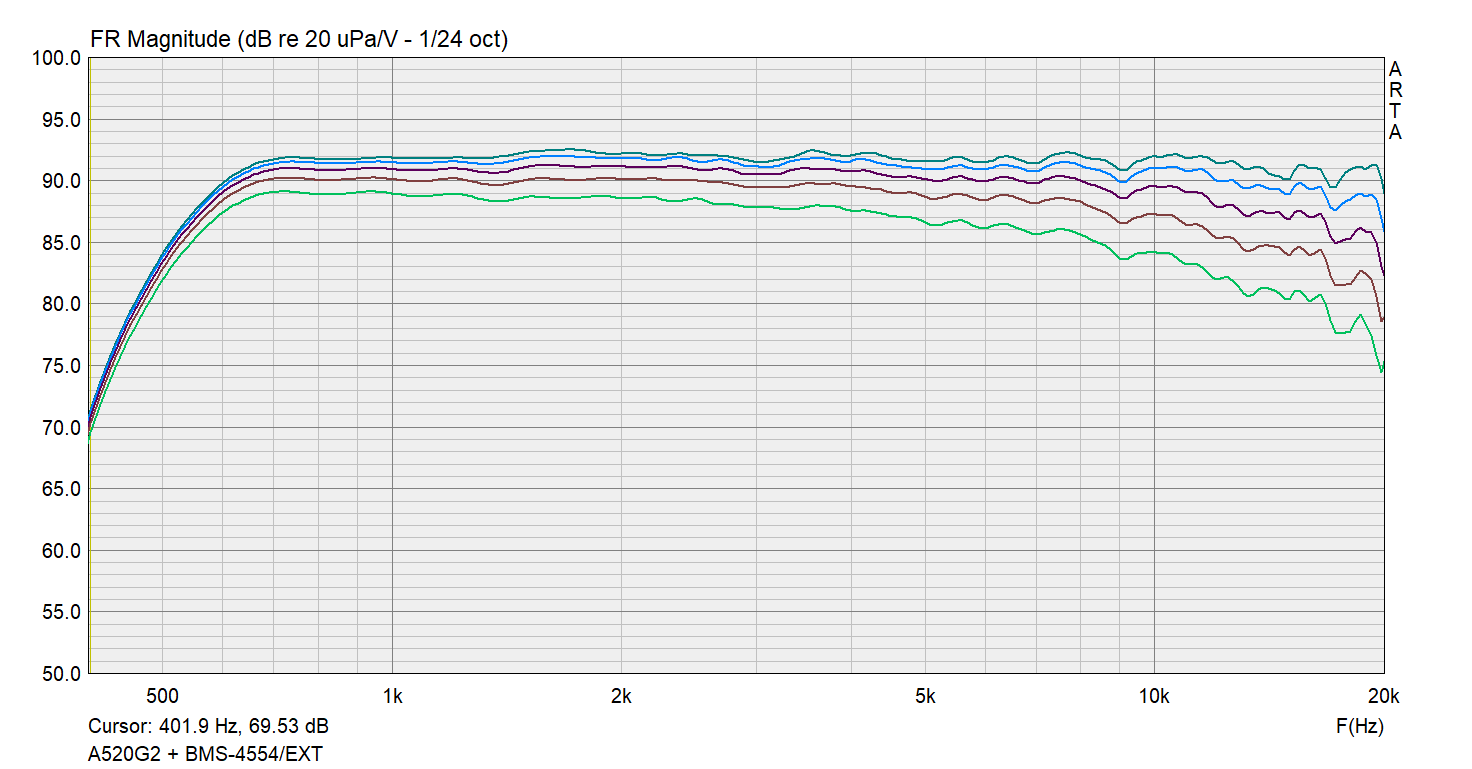

BMS 4554 extended, with an adapter starting right at the exit of the (ring) diaphragm, which is roughly ⌀16 mm.
Still keeping the directivity of Gen2, I think this is actually pretty cool.
Shaping the response is no issue with a DSP. Perhaps it could be further optimized in the adpater, hard to say.
(Measured with A520G2; at two different distances from the mouth.)
- Did a quick sweep for harmonics, at two different levels, just to have an idea:
2nd, 3rd, 4th:
Seems to me like 700 Hz would still be no...

What were the distances? Listening distance 2 to 2.5 meters? or 40mm and 400mm? Horns can take a little time of flight for the wavefront to generate fully. Ideally we are talking soap bubbles yes? once the soap bubble leaves the ring it is fully formed. But in our case there are thousands of them a second, and they create an air pressure front that takes time to integrate into the room. Time means distance from the horn mouth. I understand the ideas behind presenting beautiful graphs. But real world distances can be just as useful. If we know the gating, we can understand the lower limit of where the graph is reliable.(Measured with A520G2; at two different distances from the mouth.)
Around 1 m. Once you're more than say 0.5 m away, the frequency responses virtually don't change further, and that's what I present. This can be shown both in simulations and real world. This is simply how high-quality devices behave.What were the distances?

This is with ~5 ms window, the lower resonance will be a bit sharper in reality, that's to be expected.
Raw and EQed:

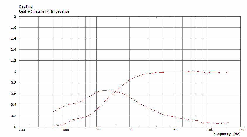

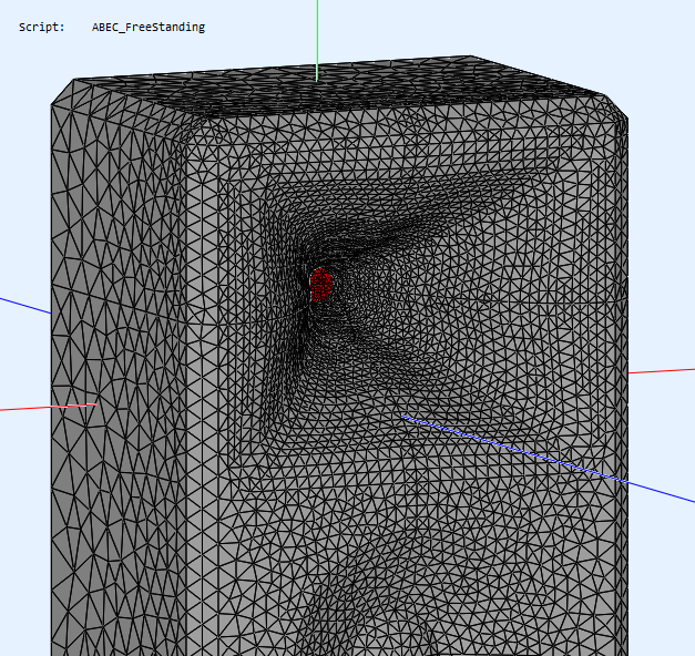

Well, I was curious so here's some data anyway. I used Hornresp to calculate a profile that hopefully isn't too far off (265Hz; T=0.71; "Exact Profile" selected on export), then used ABEC3 for the simulation.That is a very kind offer, but I think it is not worth the effort
