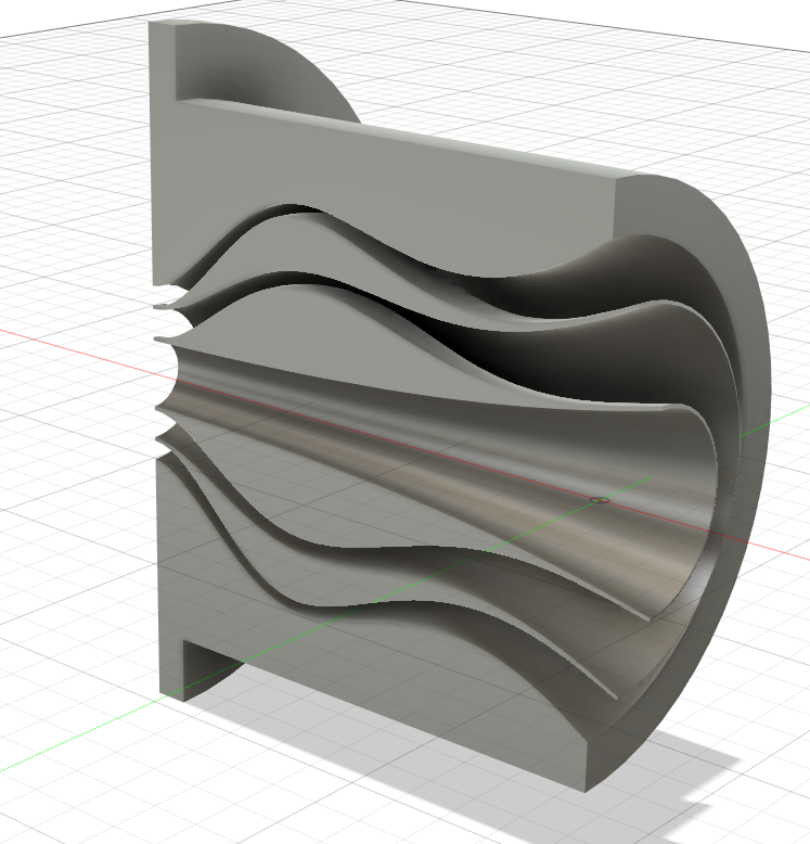

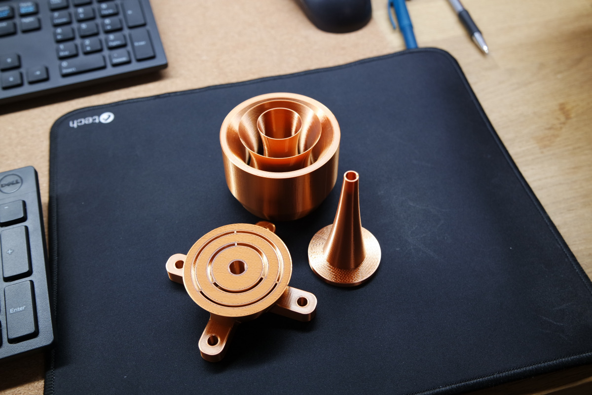

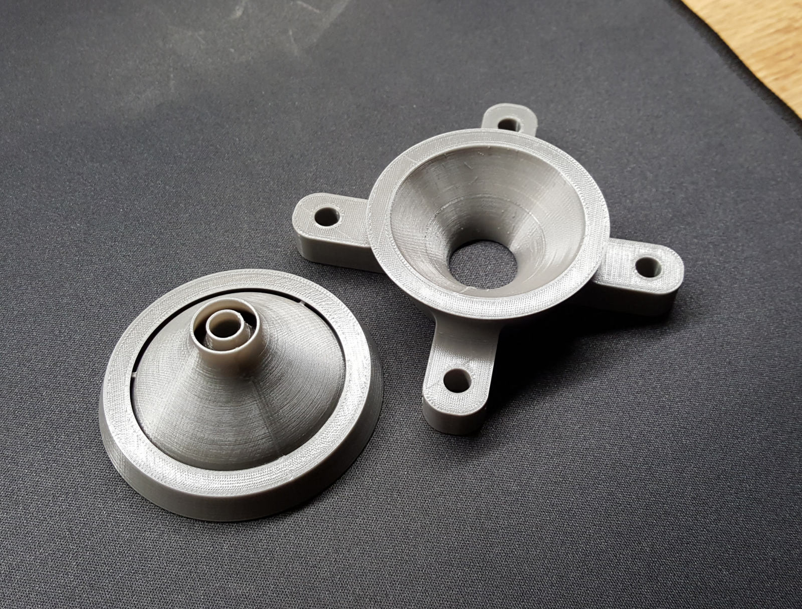

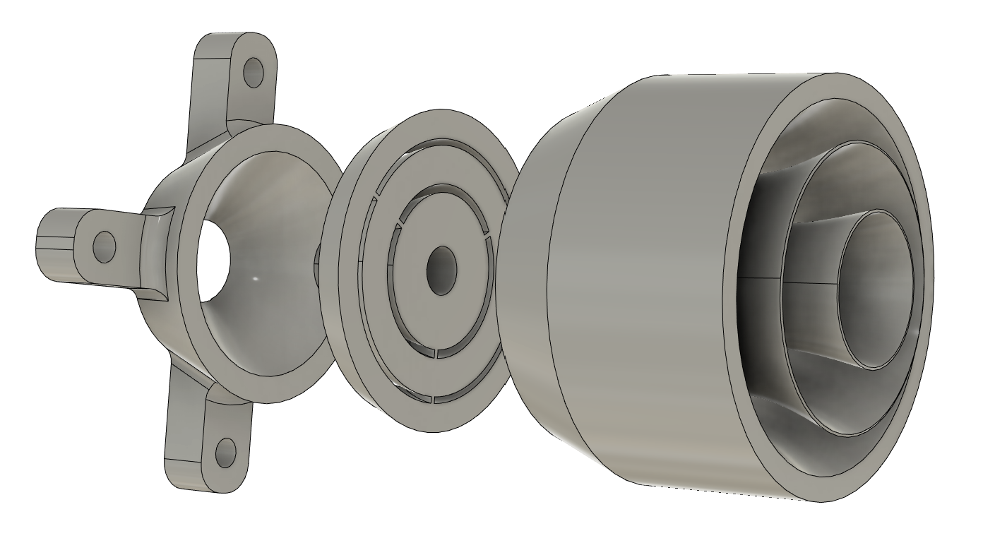

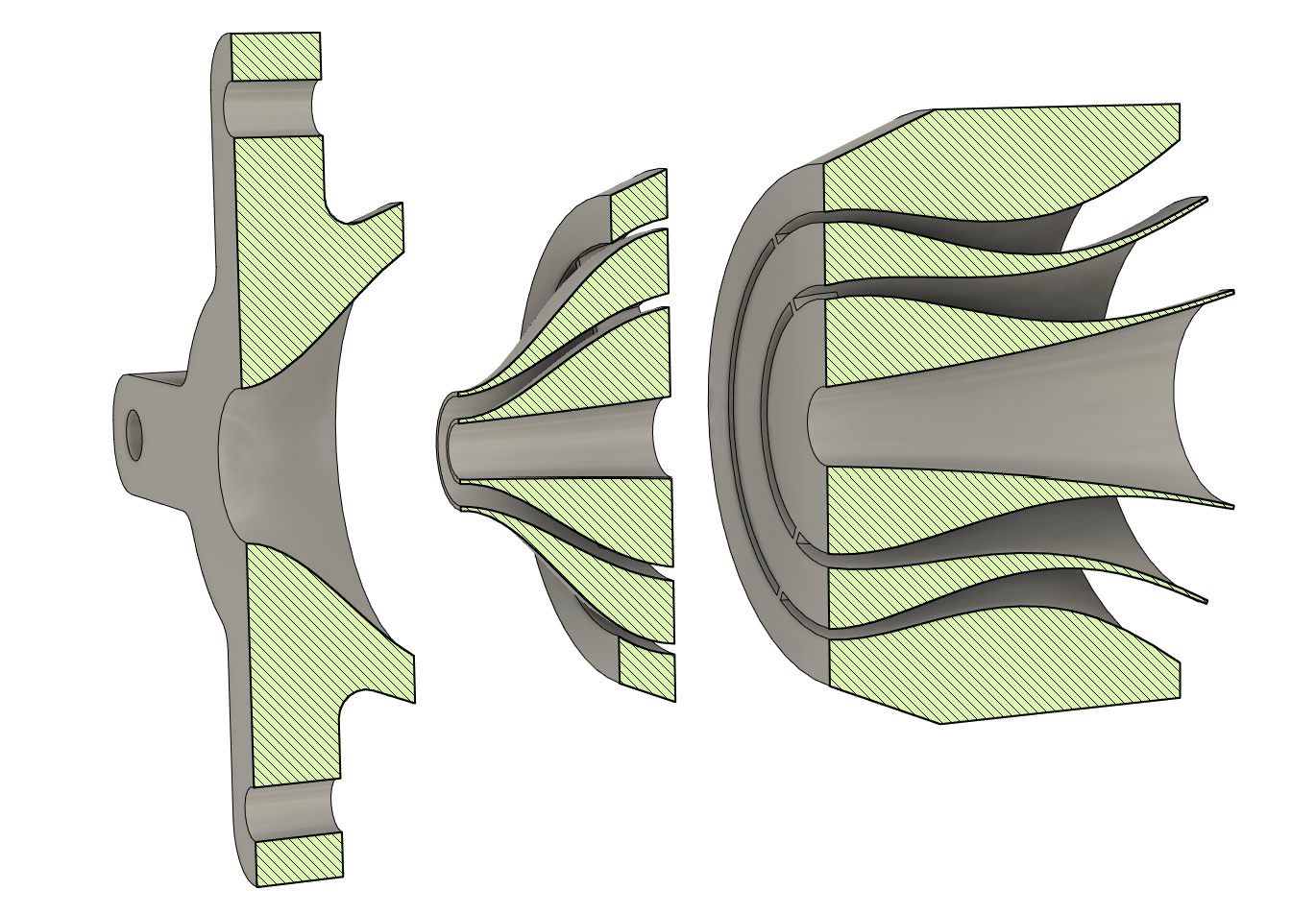

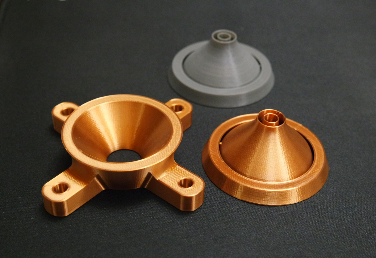

Sorry for the beginner question—I feel like I’m missing something.
I followed the instructions and some posts in this thread and received the initial model as well.
However, I still don’t fully understand how to fabricate it so that everything stands together. Right now, each tunnel is standalone. Do I need to add any bracing or support?
I'm planning to 3D print it.
Thank you!
Thank you!
Greetings to Israel! When I made a prototype, it was composed of three parts, printed separately and glued afterwards. You need to add something that will hold it all together - e.g. in the same way as phase plugs of compression drivers are made. I used only three thin supports (visible in the below pictures). On todays multi-material 3D printers, the whole thing could be probably easily printed as a single part with the help of soluble supports.
