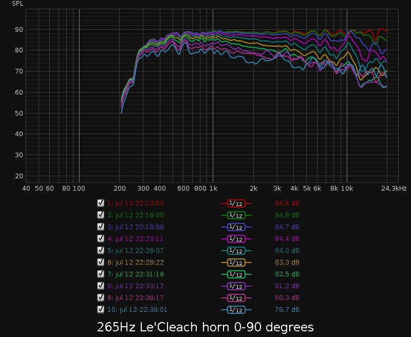

It has been a while ago, I understand. Because of the outcome of your simulation that contradicted with what I heard, it motivated me to verify your model of my horn with real measurements.I can't recall seeing such data. The exact exit wavefront shape has an effect but only at wavelengths comparable to the throat diameter, and often these are not very big differences. The horn itself pretty much sets the basic outcome here.
I was not satisfied with optimization of the mid-high Le'Cleach horn and decided to do it again, this time I placed a table in the middle of the room, with the horn on top, to be able to use windowing analysis. The ceiling and floor were closest to the mic and speaker, so a window of 2ms start and 4ms end is used for the analysis. The mic is placed one meter from the throat, so 57cm from the mouth. I used some manual peqs to correct the curve (no REW EQ used). Pity that my horn is not hifi... still good to scare something 😉
As you can see, it is not so bad -in my opinion. Your prediction is pretty similar, except for the degree of "beaminess". Yes it is a bit beamy but not to the extent that you can say it is unusable. I choose for a more beamy horn, where others choose to use absorption at the first reflection points with wide dispersion horns. Also, I do not need "DI compensation" as such, just a few PEQ's here and there to flatten the curve.

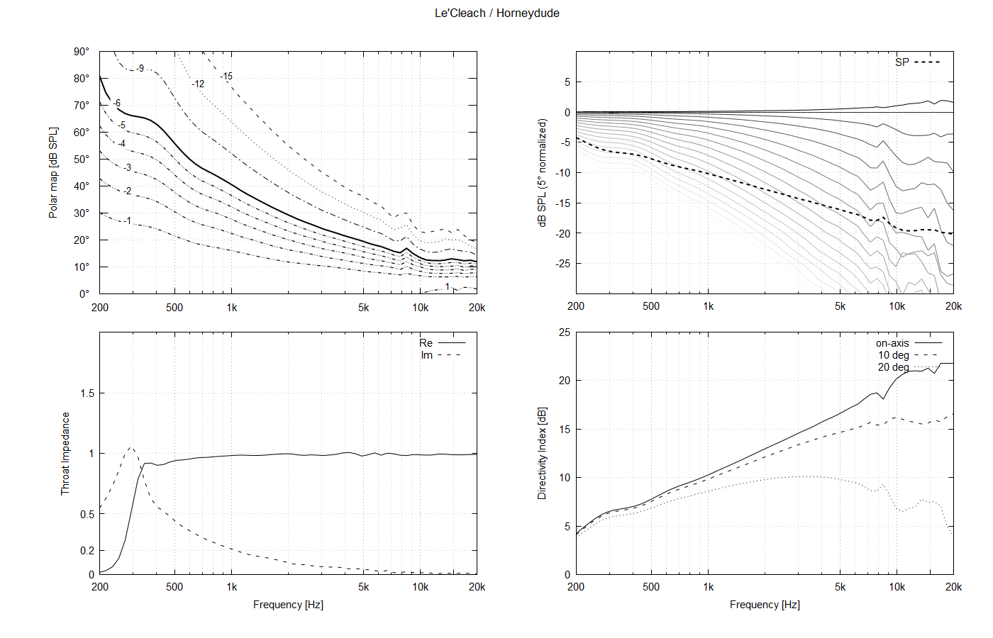

So... when you say it is not the driver, then what causes the anomaly in my measurements versus your model? Maybe your model of a Le'Cleach horn is less accurate, with all due respect?
Your SPL plot is 93 dB, mabat's is 40 dB (top right). The adjusted plot would reveal more than twice the beaminess. There is no anomaly.
Beyond that, what's the matter discussing this: the Le'Cleach is a very beamy horn and if you enjoy the presentation, that's good.
Are these measurements gated to exclude all reflections? If not, the 90° measurement is likely showing something closer to the power response which more-or-less agrees with Marcel's simulation (around -10dB from 1kHz to 10kHz).it motivated me to verify your model of my horn with real measurements.
That is not true either, he uses 5 degrees steps, I use 9 degree steps (90/10 steps). If you adjust for that, and counting dB's you see the difference.Your SPL plot is 93 dB, mabat's is 40 dB (top right). The adjusted plot would reveal more than twice the beaminess. There is no anomaly.

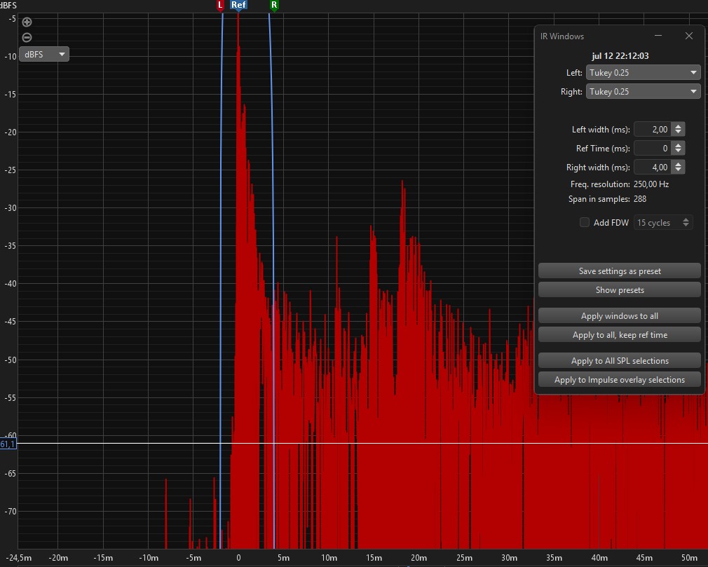

Doesn't look like it to me... Any chance you could show the impulse response along with the gate used?Yes, gated
If you didn't use a loopback or (separate) acoustic timing reference, REW may have locked on to a reflection rather than the direct sound. This tends to happen with high DI devices far off axis because reflections can be significantly louder than the direct sound.

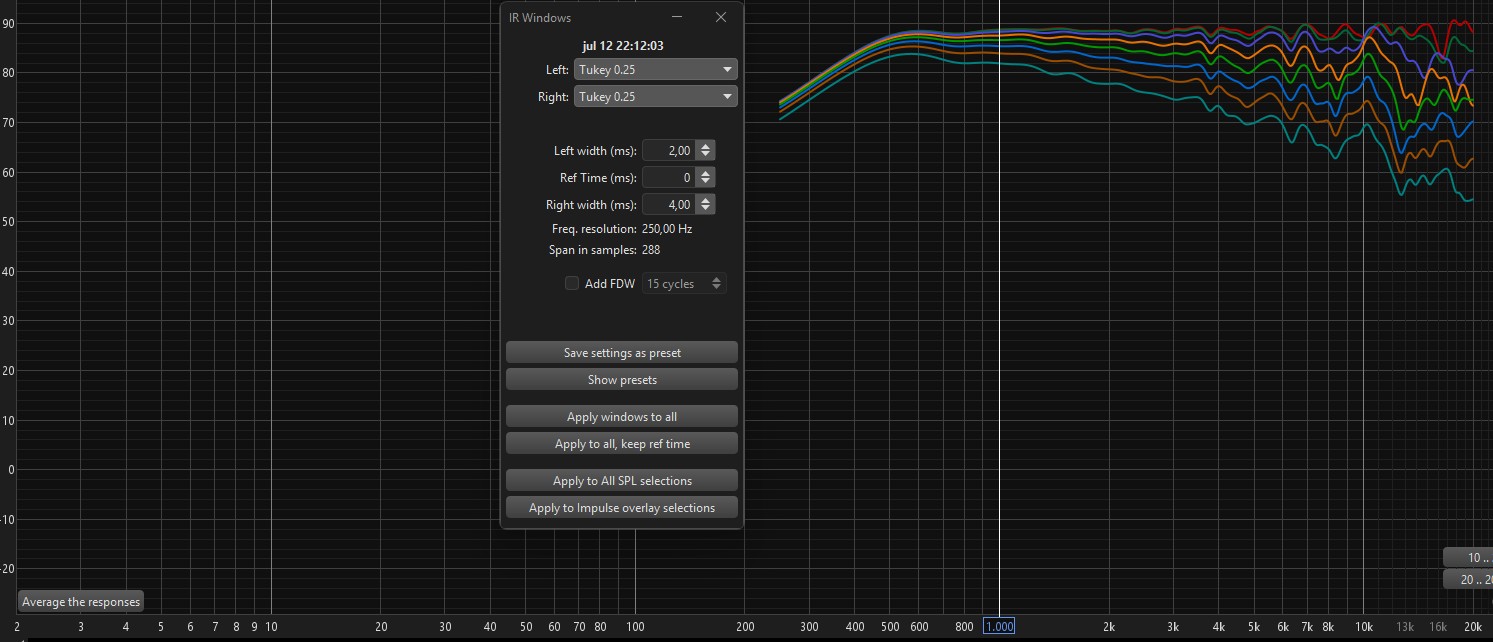

I think you are right about the far off axis reflections. I found the measurements back and applied a window which results in the following picture. Note that I left out the 90 degrees and 80 degrees measurement, because indeed those contained rubbish. But up to 70 degrees it seems valid to me. Also, it is in 10 degree steps, not 9 degrees. What I try to find out is if mabats model above exaggerates the beaminess of my horn or not. It does not look very nice around 10kHz, but that is also more or less visible in the model, albeit at a lower frequency.Doesn't look like it to me... Any chance you could show the impulse response along with the gate used?
If you look at f.e. 20 degrees in the model (4 lines down) it shows way more attenuation in dB than below (the purple line). To be clear, if I make a mistake, I am man enough to admit. I am not very experienced with rew. That is why I post, to find out if mabat statement is true that it is an unusable horn when looking at his data (could be, yes). I am for now not willing to accept that statement and try to prove that in this case, his simulation is not correct.

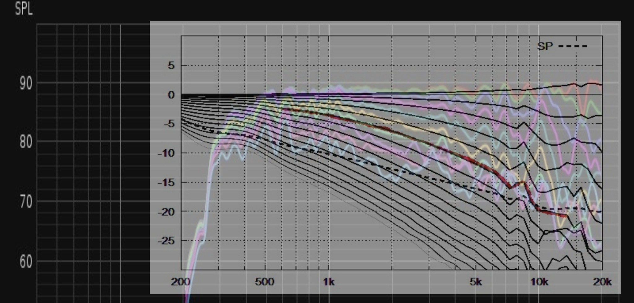

In that case the fit is quite good. I made an overlay with matching scale.
The polar marked in red is 60° I suppose. It matches the 60° polar from your measurement (green).

Exactly. I've seen people making this mistake a lot. If done properly, the measurements shall match the simulations quite well, that has been already verified so many times that it's hard to believe that this particular device should be an exception. The gated data are already much closer to the prediction.Are these measurements gated to exclude all reflections? If not, the 90° measurement is likely showing something closer to the power response which more-or-less agrees with Marcel's simulation (around -10dB from 1kHz to 10kHz).
Pretty close yes, maybe 50-75cm from the mouth as the measurements where done in the living room. The reference turning axis was the Z-axis in line with the front of the horn. Also the horn turns around the horn mouth vertical axis in the horizontal plane.EDIT: Your measurement was done pretty close, probably that is a factor and what is your reference axis?
What about the 5 degrees normalisation in the graph? The gated data is not much closer to the prediction when you take that into account. Or do I need a new set of glasses..The gated data are already much closer to the prediction.
The new graph looks good to me. I believe that the simulation output shows 10° steps, normalized to 5°. Using your 70° (cyan) measurement, there's about 18dB or so drop from 1kHz to 10kHz (following the general trend; i.e. ignoring the peak around 10kHz). The simulation shows about 17dB drop over the same frequency range in what should be the 70° curve. Add in the extra 1dB or so from the 5° normalization and it's a pretty close match.up to 70 degrees it seems valid to me.
Measuring close will change the results a bit, but I'm not certain what the effect would be in this case.

The steps are 5°, but for these small mic distances the actual mic position is quite dependent on the axis of rotation. My 20° can easily be Horneydude's 40°, as he obviously rotated the mic around the mouth. In the sims the origin is at the throat by default (which I believe was also the case here) with the mic farther away.I believe that the simulation output shows 10° steps, normalized to 5°.
