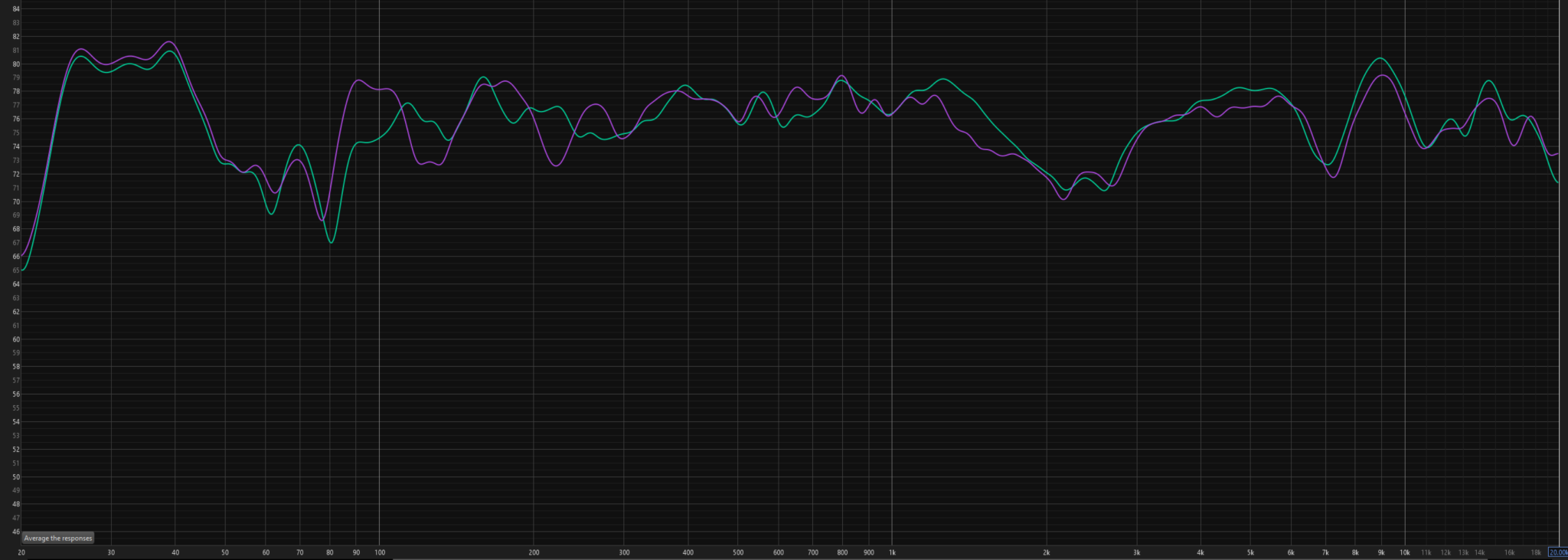

The region from about 1.5 k to 4k is the area in which our hearing gives us spatial cues. Actually it starts a little lower, but the point for this graph is that you have a fairly large dip where it actually will be audible very readily.I didnt think it would work either but it actually sounds really good.
this is from REW with 1/6th smoothing after dirac (in room) . Yeah it is very far from flat but it sounds great tbh. I will put some more effort into it once the horns are smooth and painted and there is a pair of them.
I also time aligned each driver in the hypex amp and you can't tell sound is coming from the speakers it's just floating in space and sounds very real.
Green is your horn design mabat and purple is the PAP wood horn

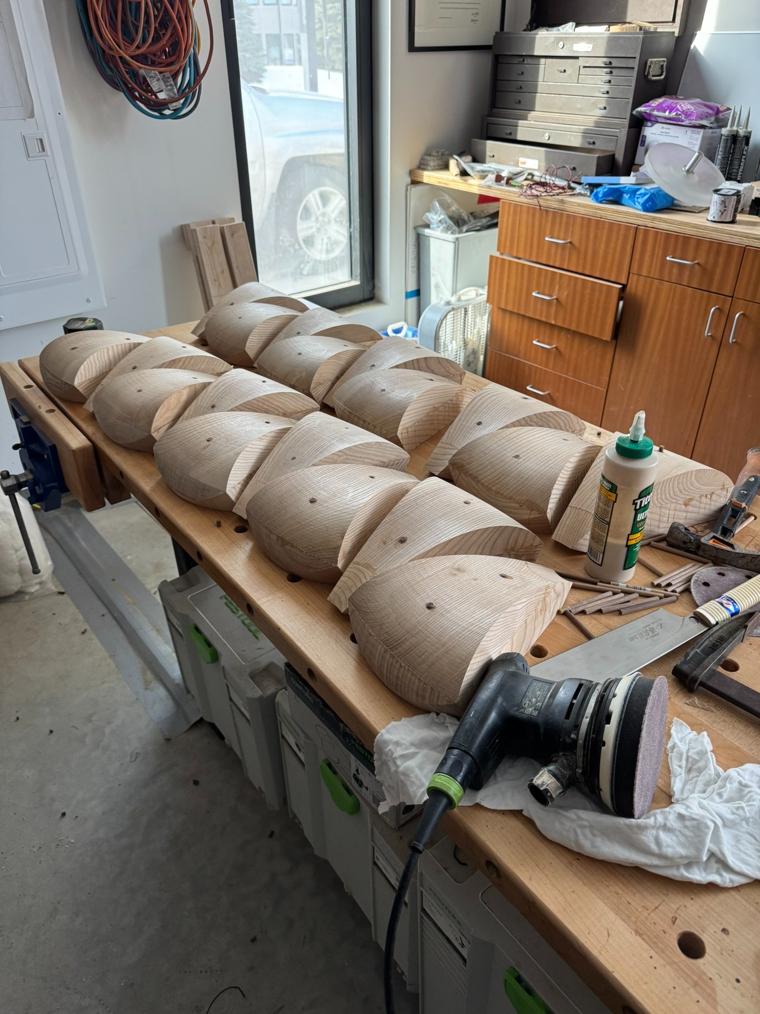

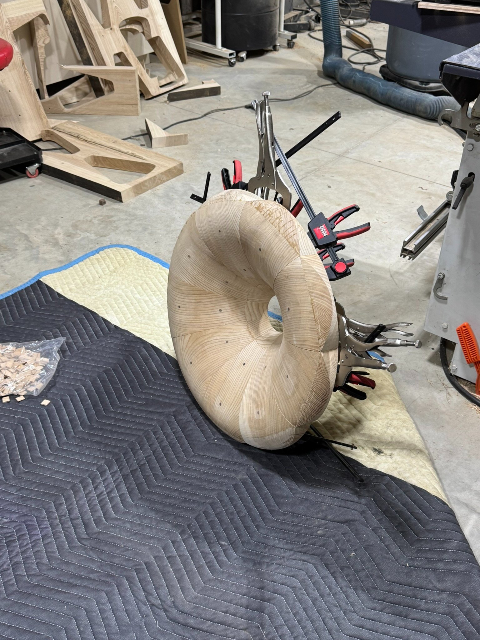

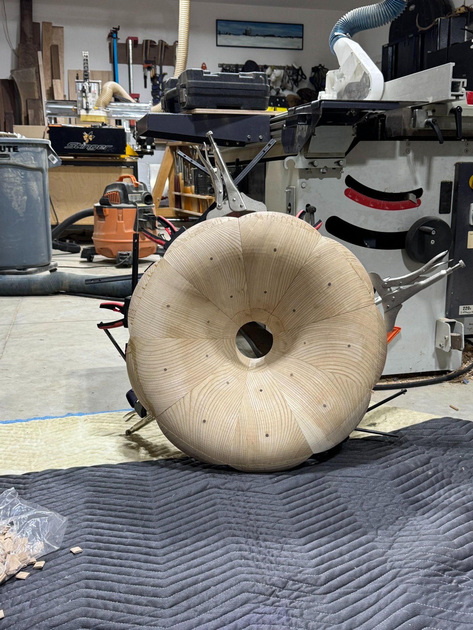

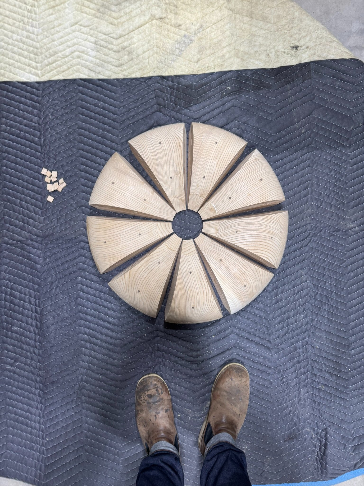

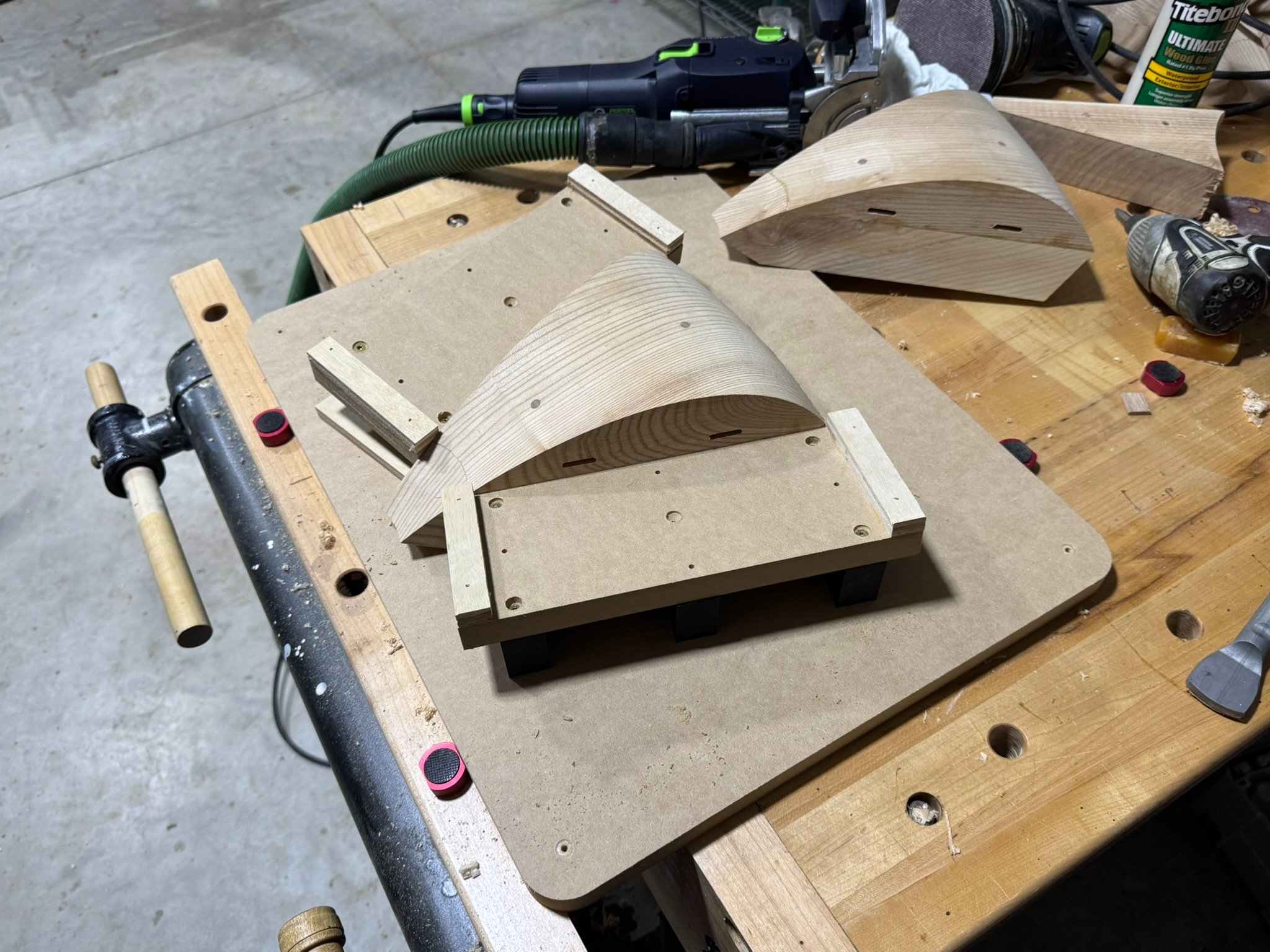

I thought I'd post a fabrication update since none of my friends are woodworkers and my wife (bless her soul) feigns interest but probably doesn't care much - I finally got all of the petals milled, glued, and pieced together. I cut in some domino mortise slots to help with alignment and did a down-and-dirty dry fit tonight to see how it would fit together as now - after all that work - was really the only moment I'd be able to see if it actually fits together or not. Thankfully, everything went together smoothly and there's maybe 1 miter with 1/64" of a gap I can probably fudge. I think I am going to route a 1/8" fillet at the edges of each of the petals to really emphasize the "petal" quality, but overall the toughest part of this project has come together pretty well.

That looks very cool and also a ton of work! reinforcing my choice to buy a 3d printer instead of a CNC machine 😀I thought I'd post a fabrication update since none of my friends are woodworkers and my wife (bless her soul) feigns interest but probably doesn't care much
Thanks for drawing my attention to that - Yeah I suspect you might be right and I'll look into it and see what is going on. A similar dip at the subwoofer area too.What if the below dip is there because the horn and the woofer(s) are cancelling each other, i.e. they are not well in phase?
What do you think can the Dirac do? It will only increase the voltage in that region. Instead of solving the issue it will only drive the transducers harder.
Then you come and say that the driver needs to be crossed higher... Well, when treated like this it probably does 🙂

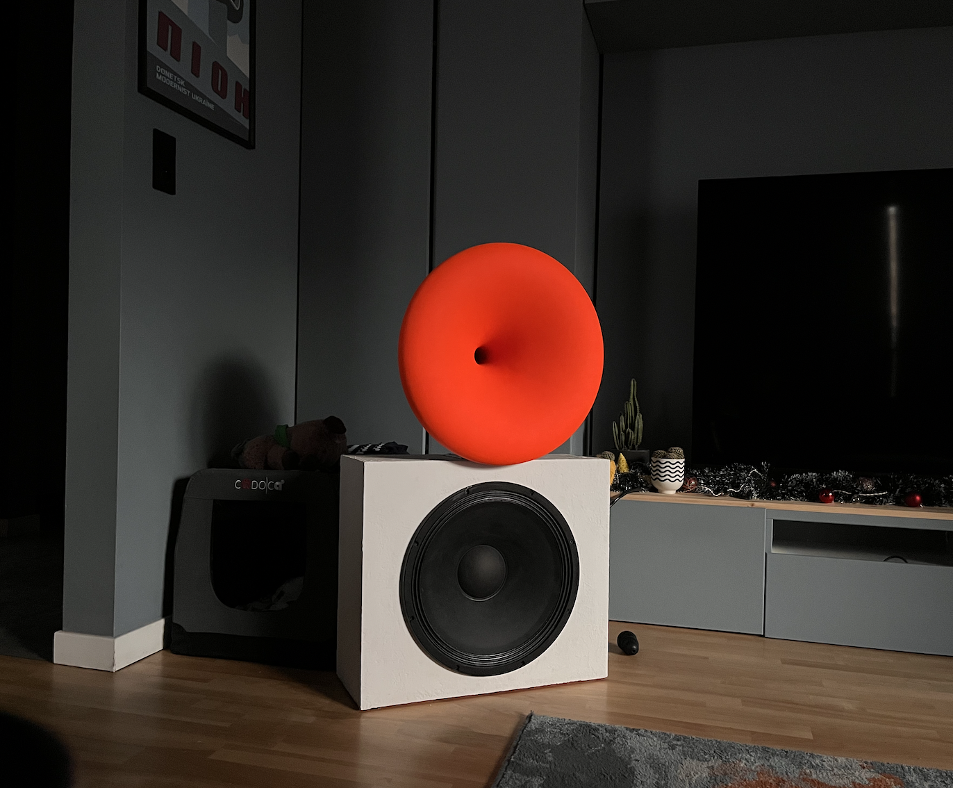

looks good, is the 520 horn and 18 inch?
Stunning! would love to know about the basic setup of that system.
It's more like an update, past pages had past versions of the system, now closer to the finish than ever 🙂Stunning! would love to know about the basic setup of that system.
- RCF nd940 in 520 horn
- 18'' Faital Pro 18fh500 in resistive cardioid box (not finished, but generally works - there are resistive ports on the back wall, I still want to try to do the side wall as well)
- 2х10'' servo subwoofers on the wardrobe under the ceiling
- Hybrid crossover ~400 Hz, passive + overal EQ (not finished, but good enough))
- The subwoofers work together with the mains up to 100 Hz
- Lyngdorf TDAI-1120 - amp, EQ, bass management
- Acoustic Horn Design – The Easy Way (Ath4)
