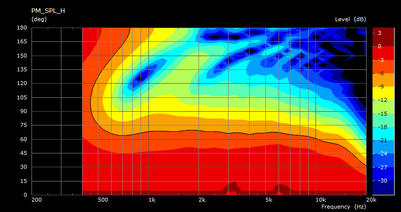

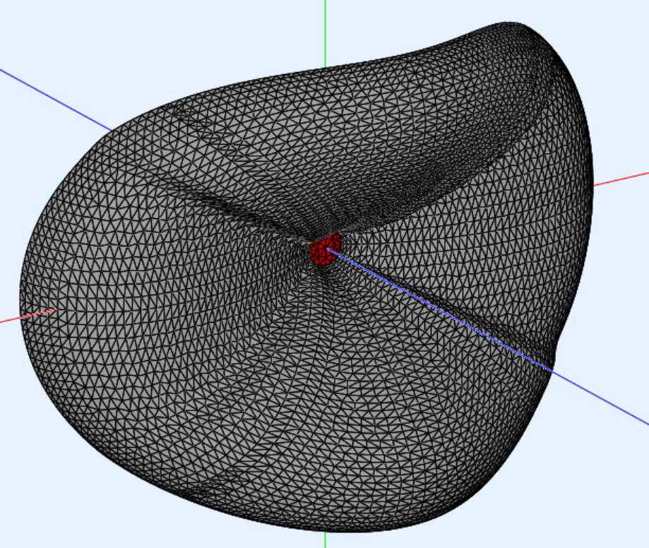

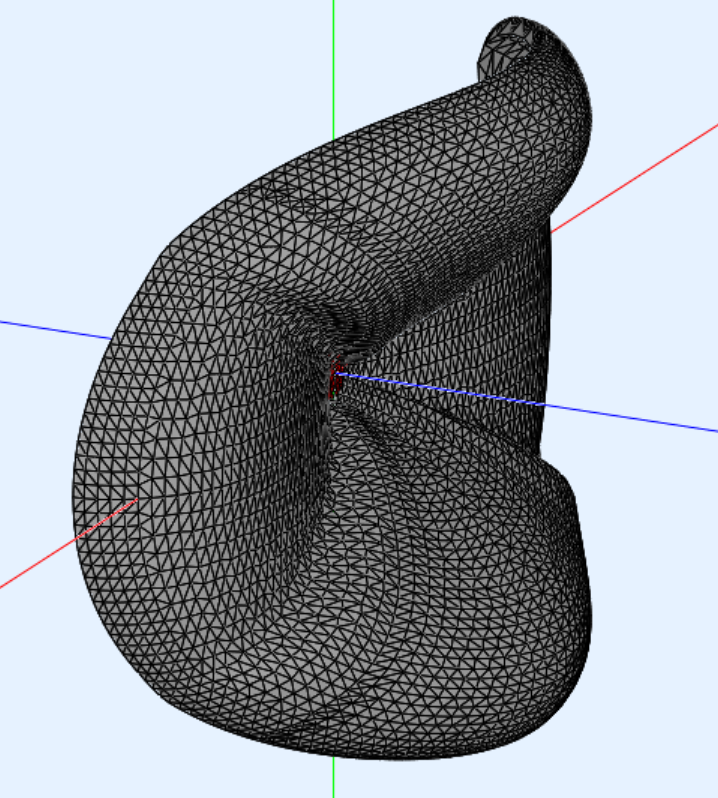

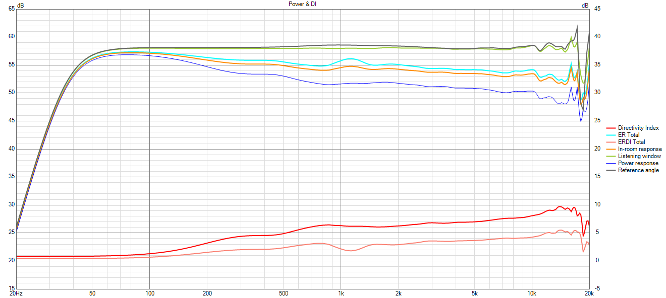

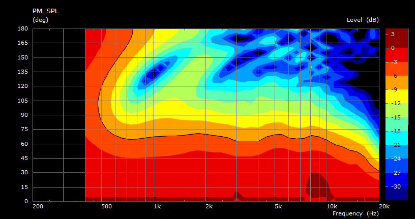

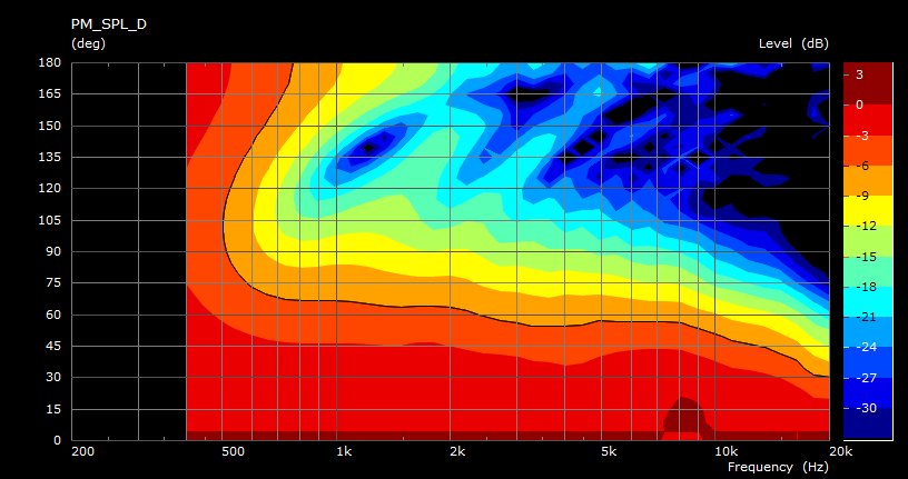

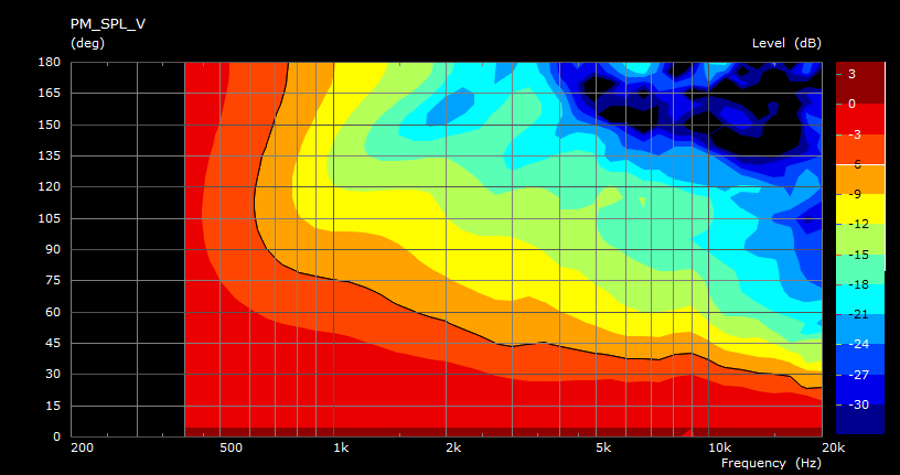

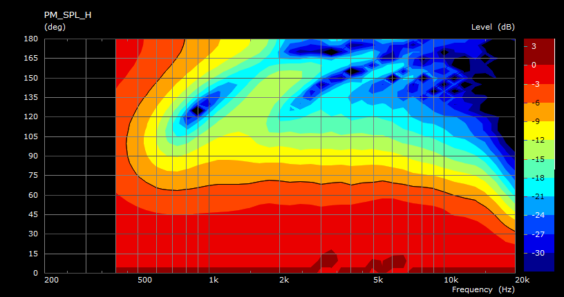

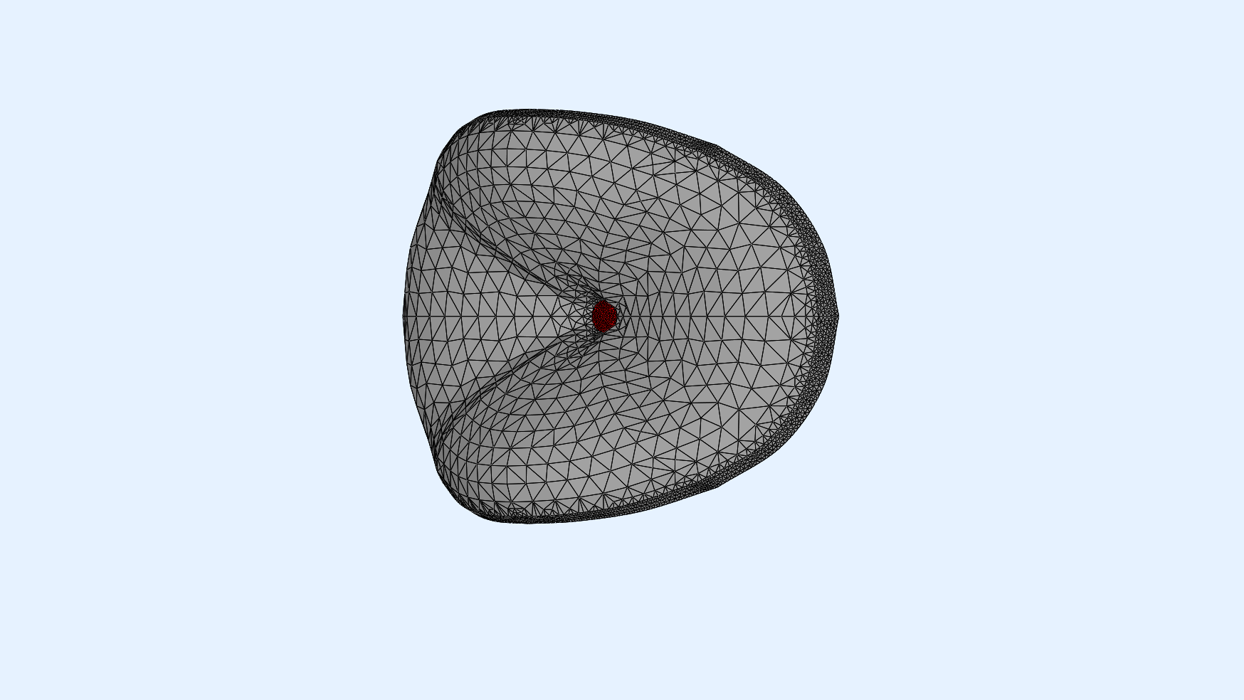

Maybe It did not quite turn out as intended, insofar as I wanted to change the distribution of vertical vs. horizontal walls towards increasing the area of vertical control. When I defined smaller angles than 30 degree, the results looked much the same as before. This is the definition I used:
But I think the vertical dispersion is no governed more evenly now, which is good for sound power.
Should be good enough after some refinement of the horizontal pattern.
Somewhat reminiscent of the JBL 2404H ....

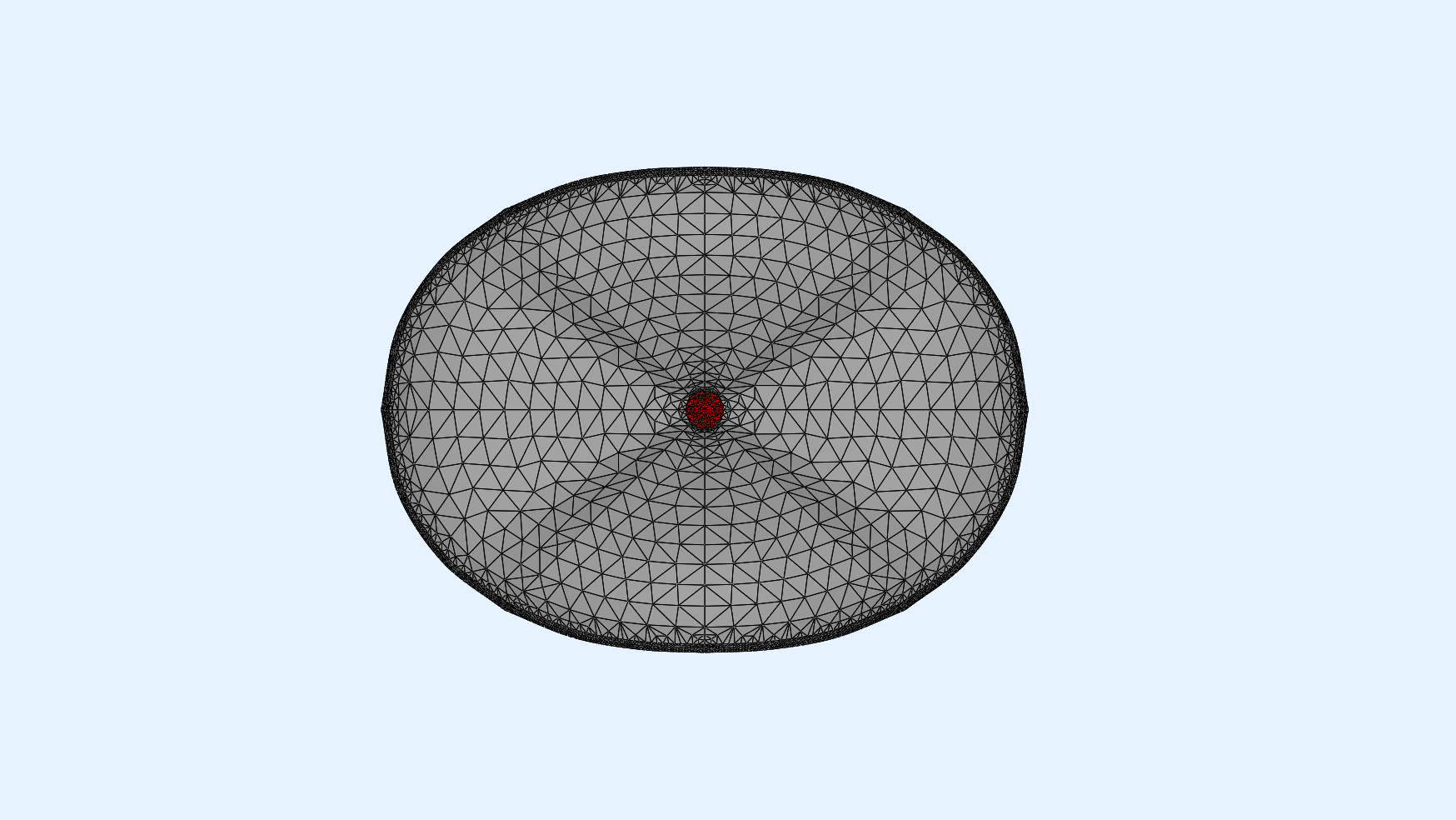

This device is only 32 cm wide, and it holds directivity way below 1 kHz on the horizontal axis. If one preferred another appearance and a crossover at 1 kHz was enough, a smaller horizontal diameter is feasible, as long as the vertical dimesion does not get reduced, then leading to a more circleish frontal appearance. My decision for the width of 32 cm was made because a somewhat rounded enclosure for a 10-inch woofer is at least 36 cm wide, and a smaller diameter would make the waveguide look silly small above the wooden box.
In any case: the principle of a very wide horizontal (in this case 130+ degree) and narrower vertical pattern for sound power optimization can come in different shapes, depending on the intended crossover frequency and size of the device. I hold my claim this is the proper approach to both consider spaciality as well as image size, both resulting from a wide horizontal pattern, while also diminishing unnecessary energy on the vertical axis, which would otherwise only negatively contribute to the total sound power radiated, resulting in a too bright presentation.
Looking forward for other designs that best mine. 😊

That's based on A460G2 (⌀460 mm), but it can be applied in the same way to any axisymmetric waveguide.@mabat: what are the dimensions of this? Looks....interesting in some way 🤣
Could you share the whole input script? Would.like to play around with that a bit.

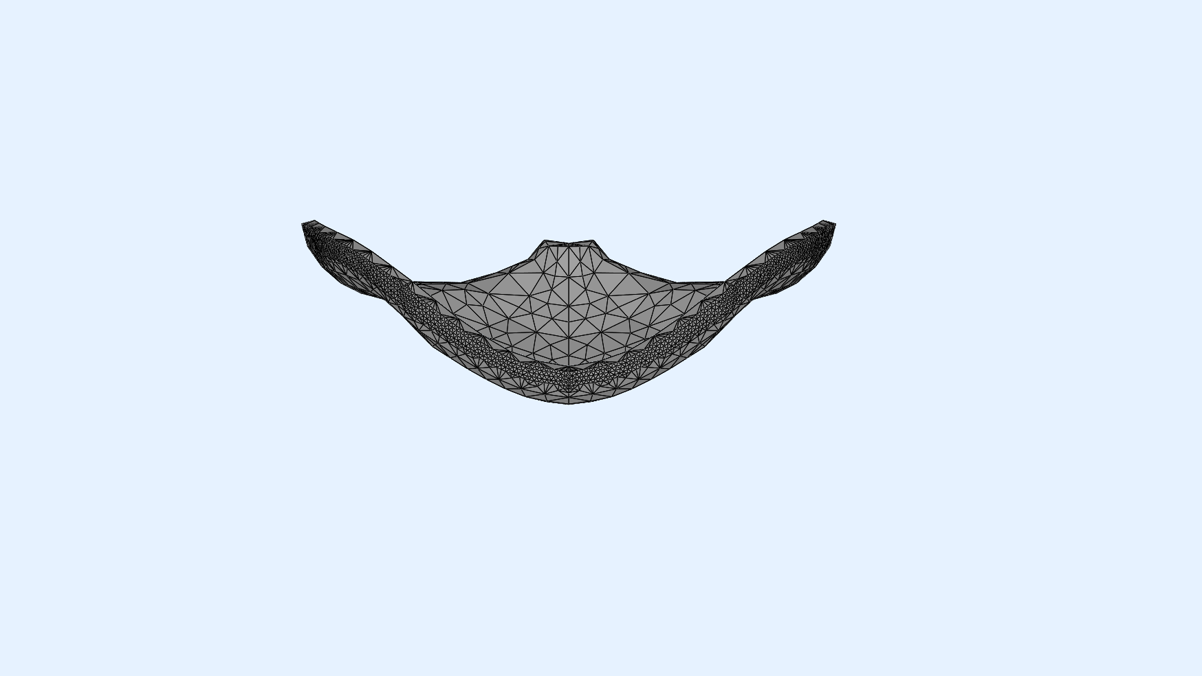

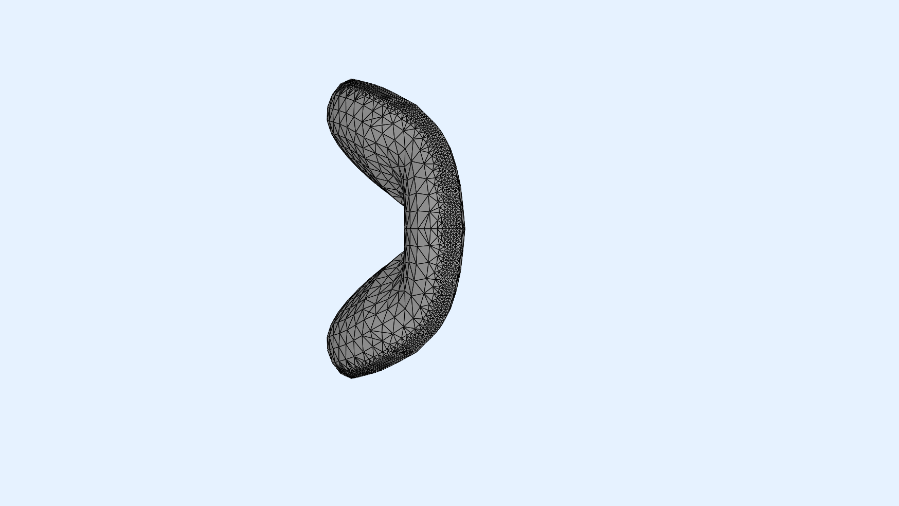

@sheeple, I ran the sim with a bit finer mesh -
Mesh.LengthSegments = 48
Mesh.AngularSegments = 120
Mesh.SubdomainSlices =
Mesh.WallThickness = 6
Mesh.ThroatResolution = 5
Mesh.MouthResolution = 7
Mesh.RearResolution = 25
(Maybe this is unnecessarily dense, haven't tried. It's still only 2432 elements.)

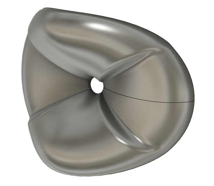

Yeah, after I find the time to ...
... make it simulate proper. Then, I will ask a friend to make me a printable model from fusion.
Thanks for checking. I should have used the finer mesh, was kind of a quick shot. In principle it should be possible to solve the remaining issues.

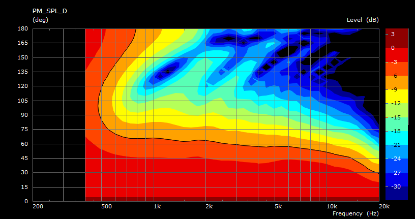

What was the number of frequencies for these plots?
Only 40.
This is a STEP + STL for a 1-inch version, if anyone had the patience to continue (I don't) - https://at-horns.eu/ext/sheeple-1inch.zip

a = 60 - 18*trwu(0.4, 0.8, 2, p)*sin(p)
That already looks quite good and the wider transition seemingly solved many of the issues.
Beware the throat diameter is still set to a sub 1-inch 18.6 mm (minimum aparture of the DFM-2535 if used with a dedicated throat insert).
The horizontal coverage angle could be somewhat reduced again. It's now at 70 and was at 65-67 degree before. It widened from where it was at before the make over, due the changes that occured to the profile. When I was working the simulations, it sometimes felt as if creating a clean profile at 70/140 degree was pushing the limits of controllability, while 60 was much easier to attain. But I don't know if there is much improvement possible with that little more of a constraint to 65-67.
It's very sensitive, it's not possible to adjust the coverages just by changing the nominal values.

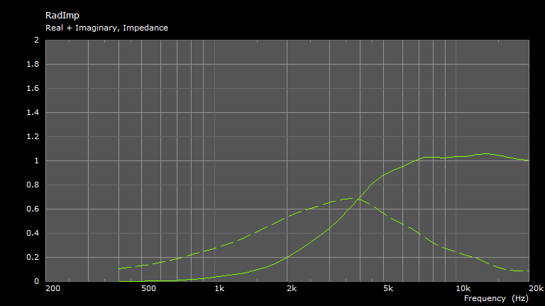

Now I'm trying to have them rated automatically and for that I'm missing some experience. All waveguides on at-horns seem to have an almost horizontal RE in the radiation impedance graph. Would it make sense to rate a waveguide based on slope, deviation and 'low frequency extension'? I've tried that with a few hundred simulations and it seems to work, but before I write some additional scripts to optimize the parameters a hint if that's a good idea would be nice.
it depends what you want from your waveguide. You might want to increase "loading", which inevitably makes wavy impedance graph for example and now you'd optimize for something else than flat impedance plot. I've been automating just for about a week now and do it the following way:
