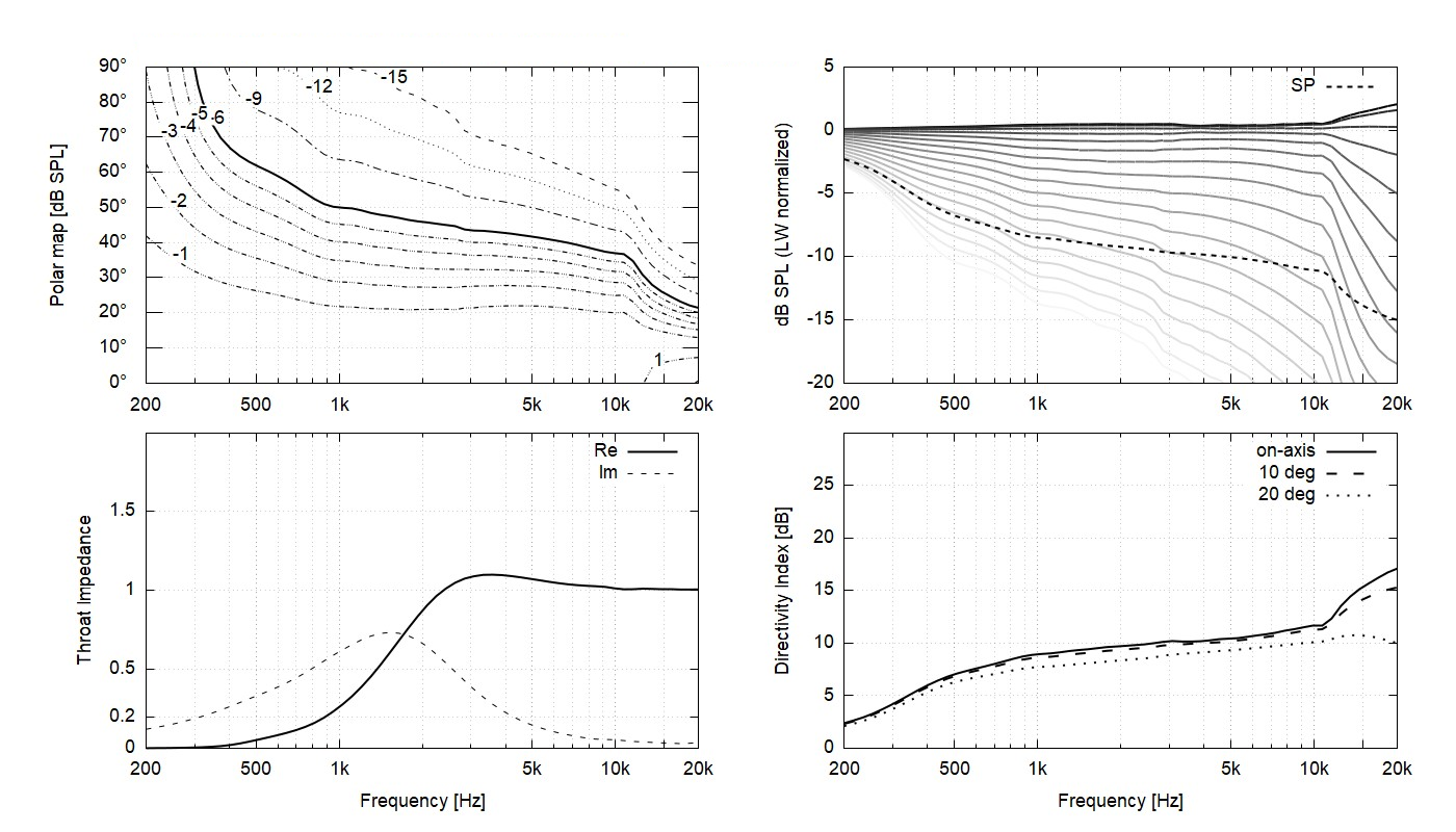

That's not inevitable, you can have a nice flat impedance, but it will beam badly.You might want to increase "loading", which inevitably makes wavy impedance graph [...]
Yeah it's always a multifaced problem, I can imagine it's not that easy to define what to optimize for. Beaming can be done without loading as well, with circular arc profile, as an example.

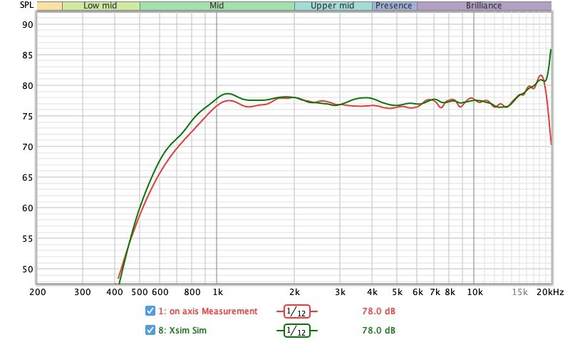

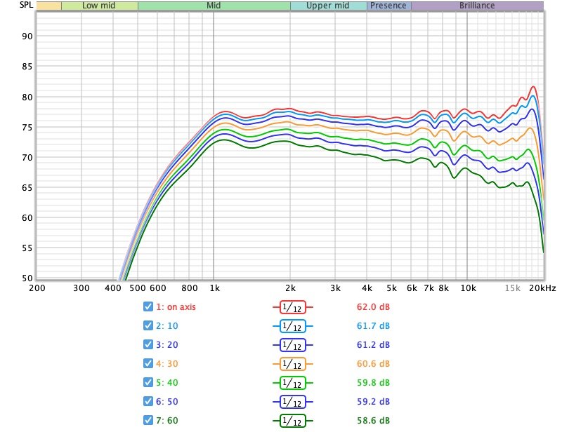

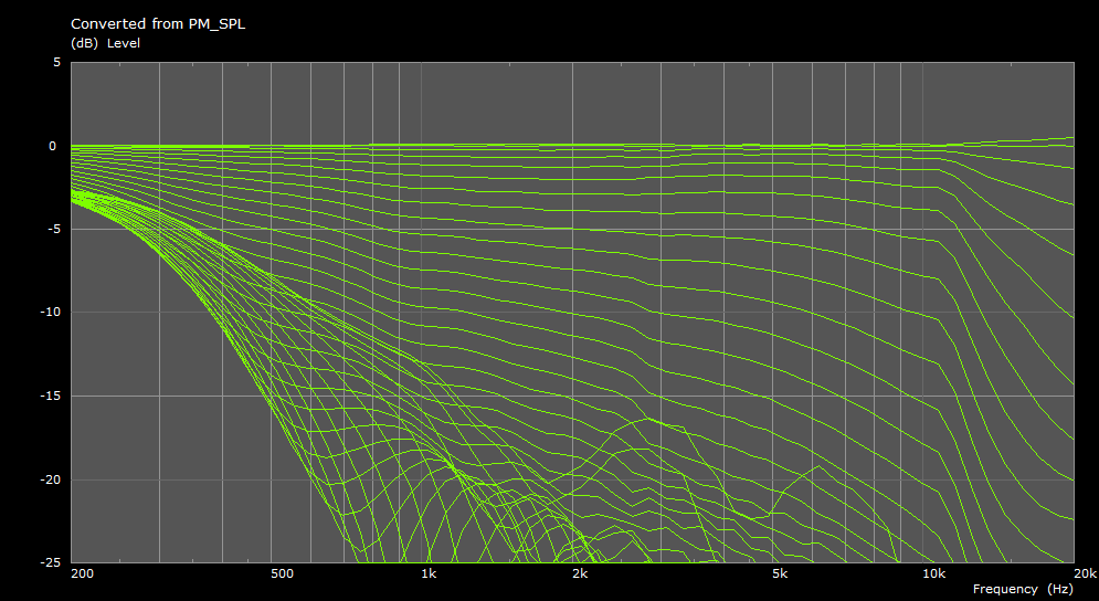

I just want to share the measurements I took with my passive crossover prototype for the g520extended with La Voce DF10.171K.
I intentionally left the rise on the high end of the spectrum. This crossover has a 3rd order filter, followed by parallel notch filter and a shelf filter. I aimed for flat and 800hz crossover.
The measurements are taken at around 1m and gated 5ms and smoothed 1/12. The off axis angles were done without measuring roughly 10degrees each
up to 60.
up to 60.

I would try to dampen down the peak just above 1 kHz. This is typically possible by changing the values of the parts a bit, without a topological change in the crossover, and in a simulator this should be an easy task.I just want to share the measurements I took with my passive crossover prototype for the g520extended with La Voce DF10.171K.
BTW, for a 800 Hz crossover I think you could use a short adapter instead as well: https://at-horns.eu/gen2m.html#df10171k
It may be much easier to do passively than the long one. I would definitely try the short first in that case.

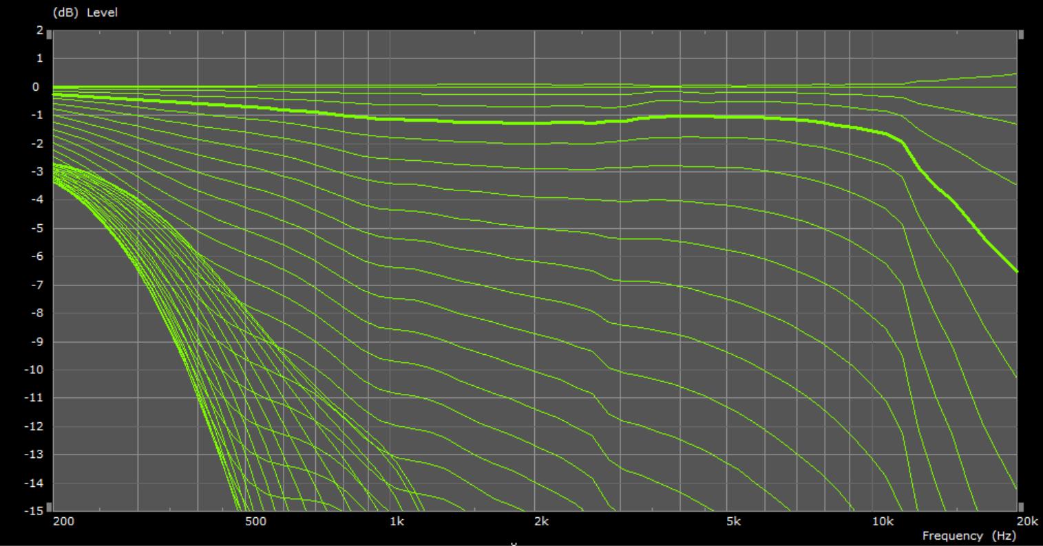

This is not "flat enough" for you (the blue trace is at +-20deg)?
It's roughly -2 dB from 700 Hz to 10 kHz for 20 deg. This can be reduced of course, but there's a cost (which I wouldn't take).

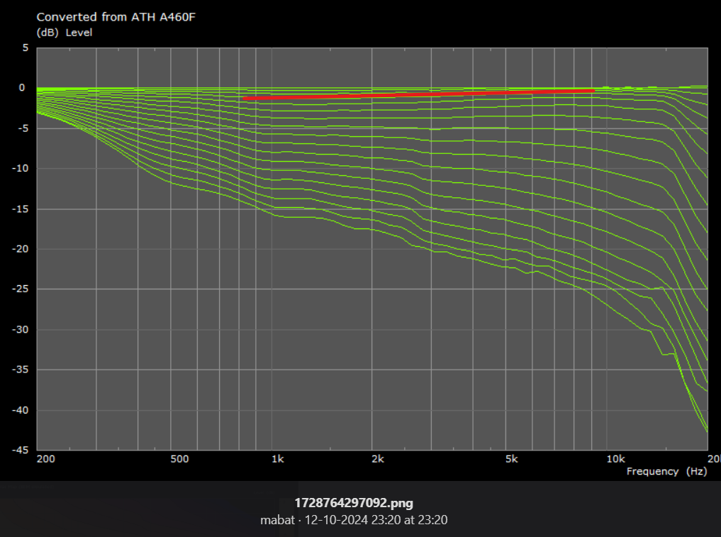

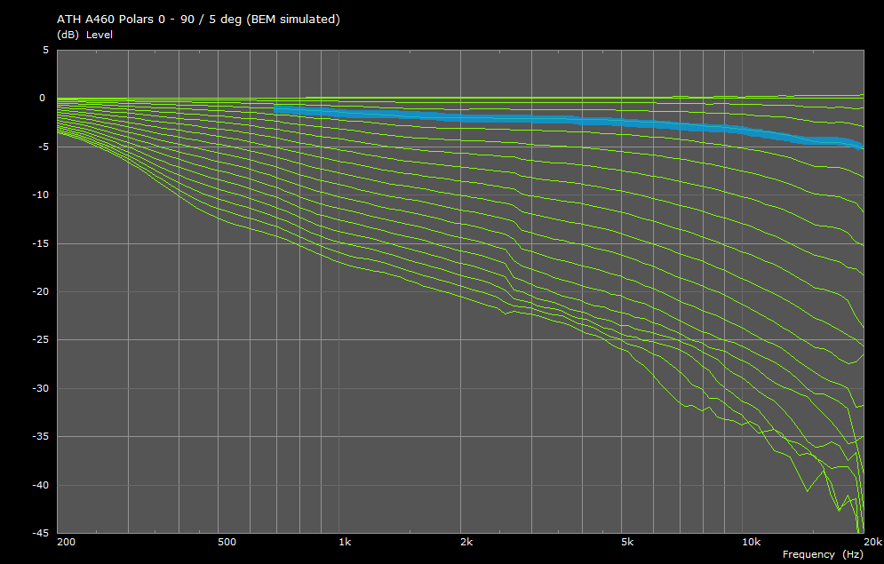

Actually what's my first wish is bit wider pattern than A460G2 and more constant. You published intent for constant directivity waveguide here https://www.diyaudio.com/community/...-design-the-easy-way-ath4.338806/post-7814678 but only for 1" so I started to roll my own. And if you look at listening window response for the constant DI device it's not constant but rising, and what I'd like is have it constant, middle of the two examples you have. Screenshot and illustration from behind the link.

That's more or less the approach I'm using in the genetic algorithm I developed for this - although only for the -3dB and -6dB lines.Well, if one line isn't good enough to rate a waveguide, I'll probably rate the -1 -3 -6dB lines. It'll be just a little bit more work to rate three lines instead of one. Ideally I'd like a 'true' constant directivity waveguide anyway.
Finding a good "scoring" system is the bulk of the work. I'd recommend weighting the frequencies in the 800-16khz range more as that should be the priority for optimization - at least to begin with. I also experimented with applying a slightly harsher "penalty" for a falling DI as that allowed me to get better results with less iterations.
A flat listening window may be a better target than the flat DI, which was obviously my target for that particular design (A460D). In fact, it's somewhere in between in the end and I tend to think about it as "in tolerance" (+/- 1dB for 800 - 16k everywhere in the listening window).
Yeah, it enables tonality of direct sound stay same when toe-in is changed for example, or if people moves in the room, compared to system where the listening window response tilts either way per angle. For example I have quite short listening distance in a domestic room, if I lean back at main listening position I have different angle to speakers than if I lean forward, and tonality changes. I want this be more constant. There is lot's of reasons why tonality changes moving in the room closer / further from speakers, like at which azimuth angle the speakers are to head and head shadowing changes things, early reflections change a bit, and so on, so perhaps this is not the ideal either. It's still something that I think would be great at the moment, at least until I've tried it 🙂
I suspect you won't be satisfied with this kind of LW flatness but this is all I can do without a considerable more effort (a 1.4" throat).
But I also think you already have someting close (also based on the Gen2).
(per 5 deg)
(per 5 deg)
