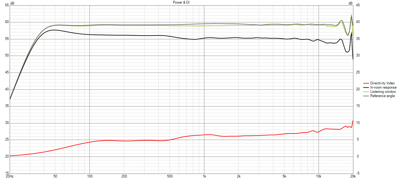

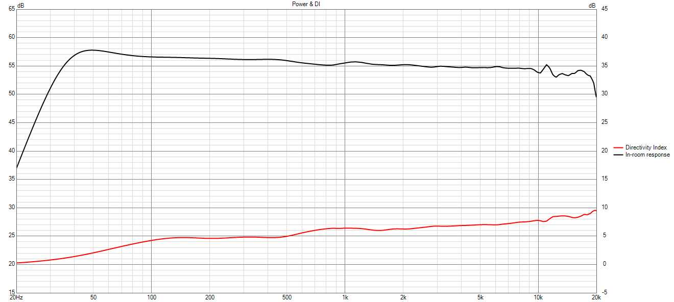

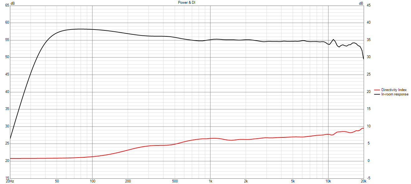

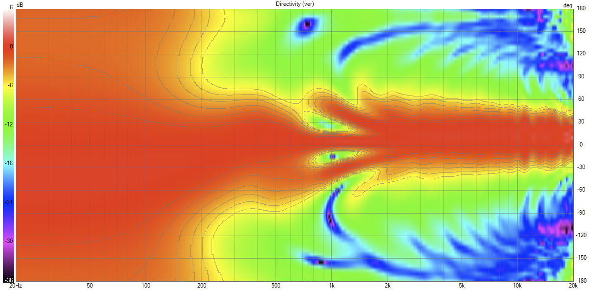

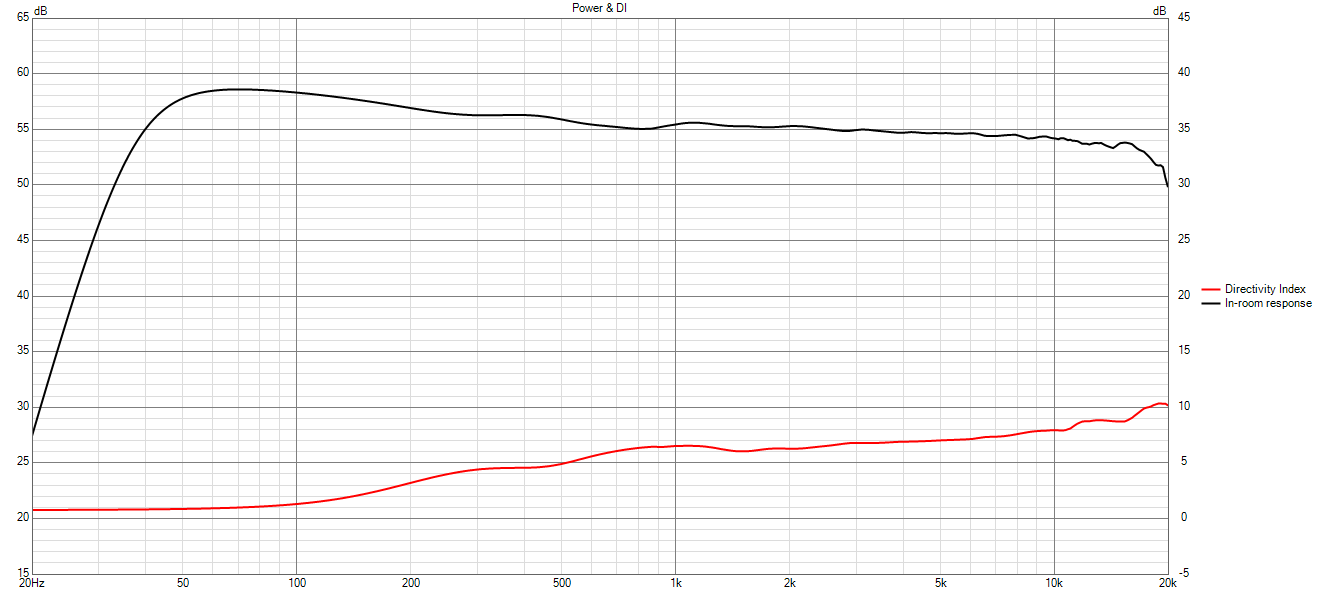

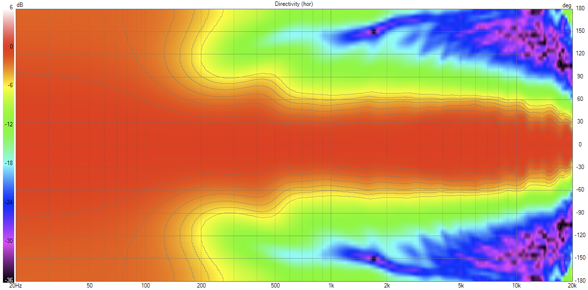

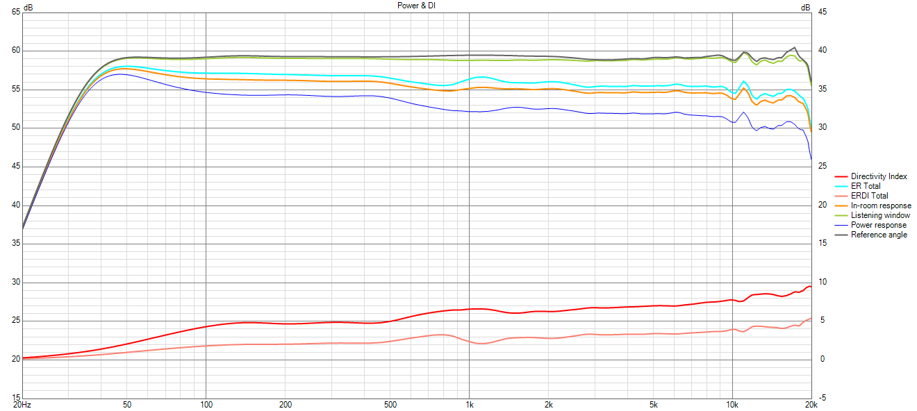

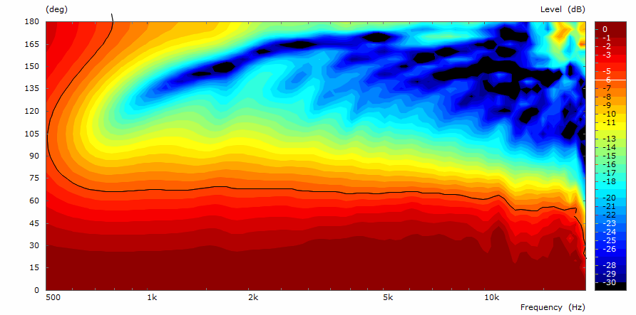

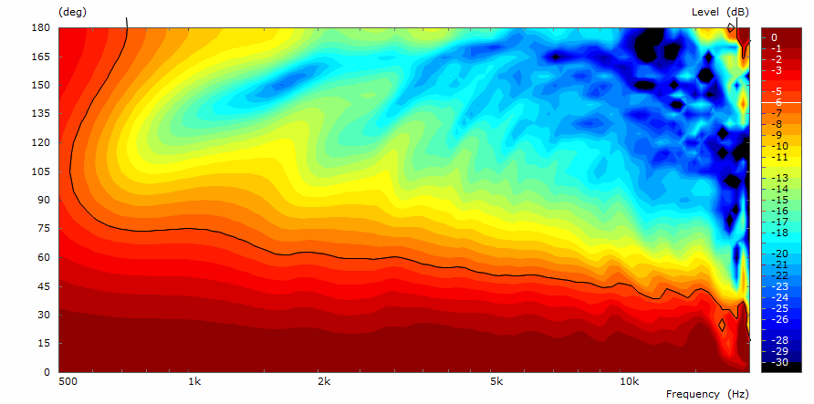

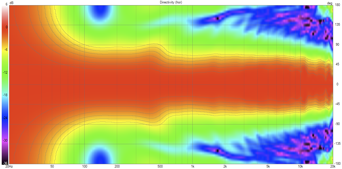

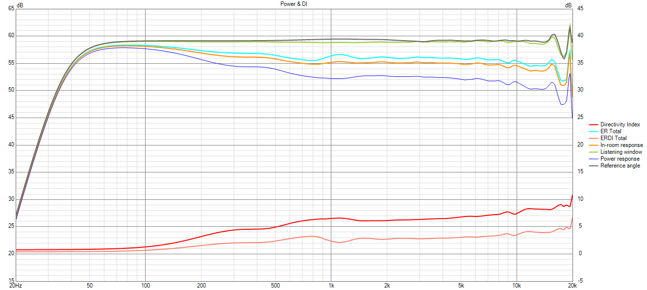

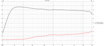

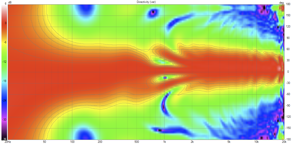

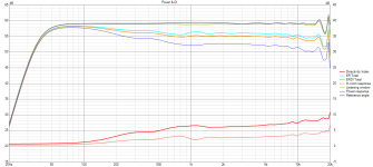

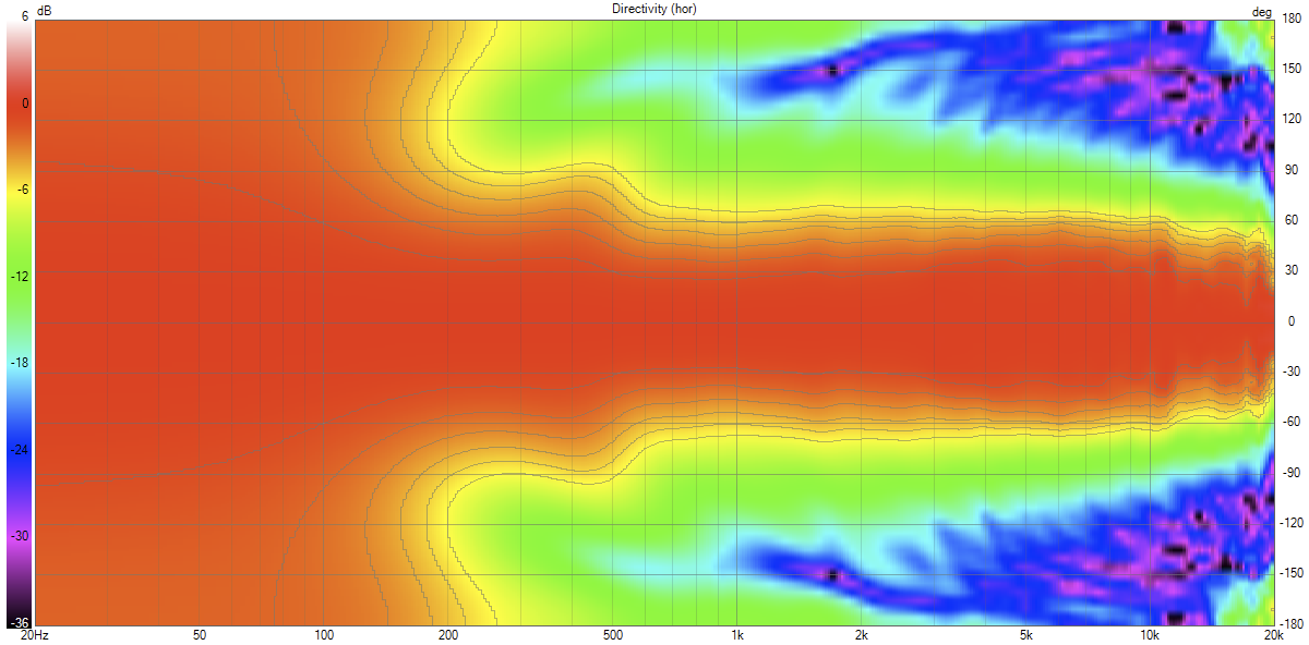

I don't want to derange this thread on transitive forms of existence, but I thought I would see what directivity the BMS 4554 minimum aperture (16 mm) allows.

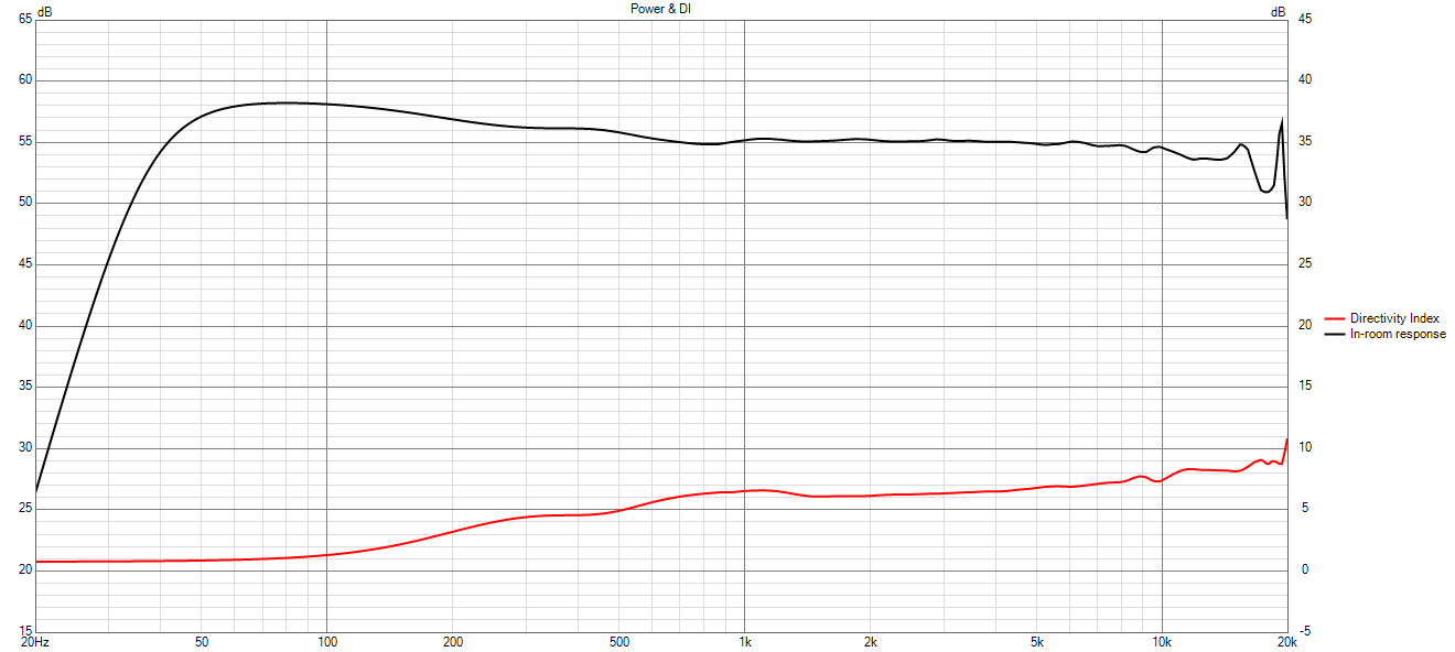

Here is the sims for a simple two-way (10-inch woofer).
1) VACS
2) VCad
And for the sake of it, what how this waveguide simulates in a 3-way cardioid speaker:
1) VCad
Pretty constant, no?
[edit] frontal view for aesthetical considerations:

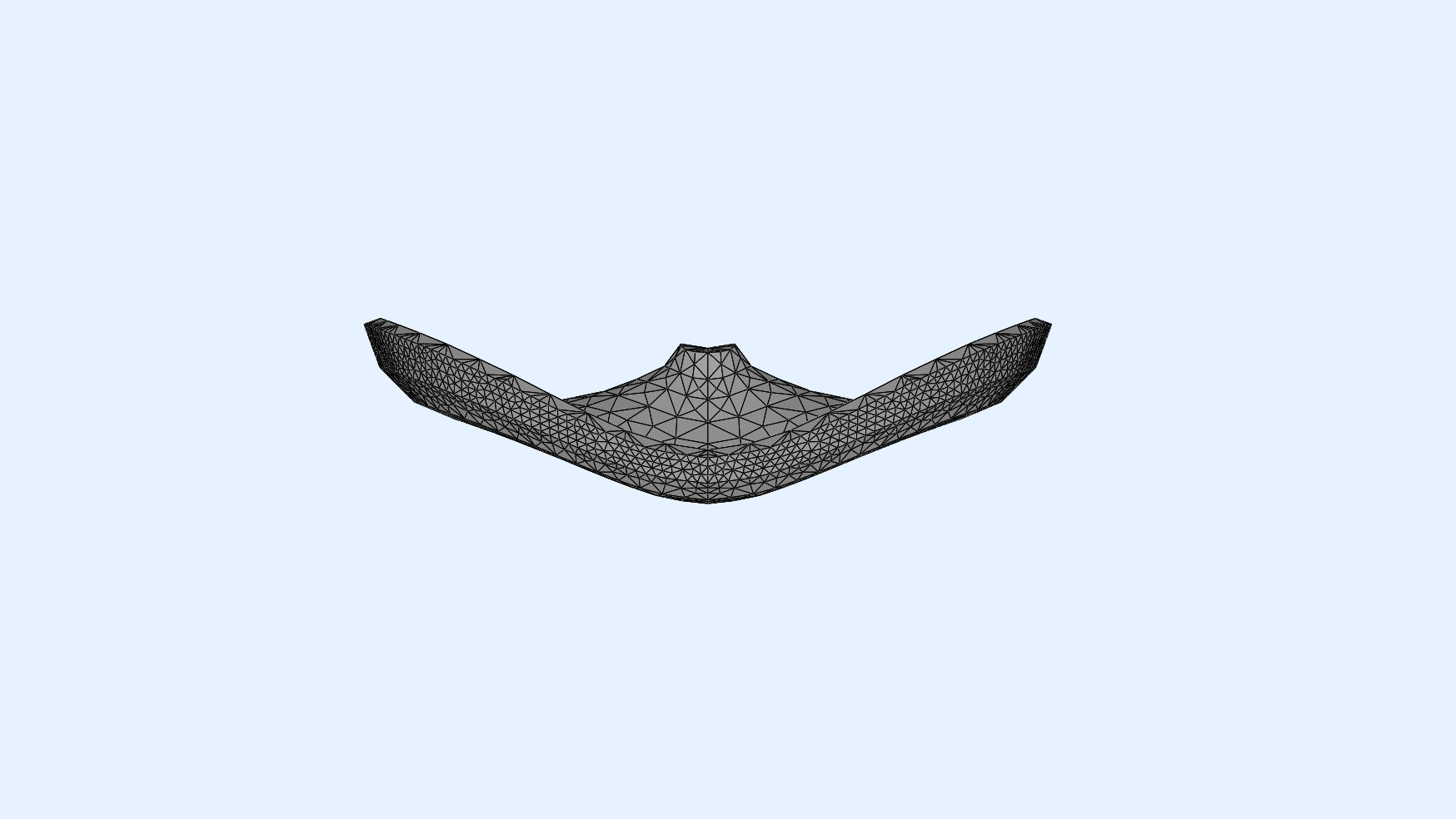

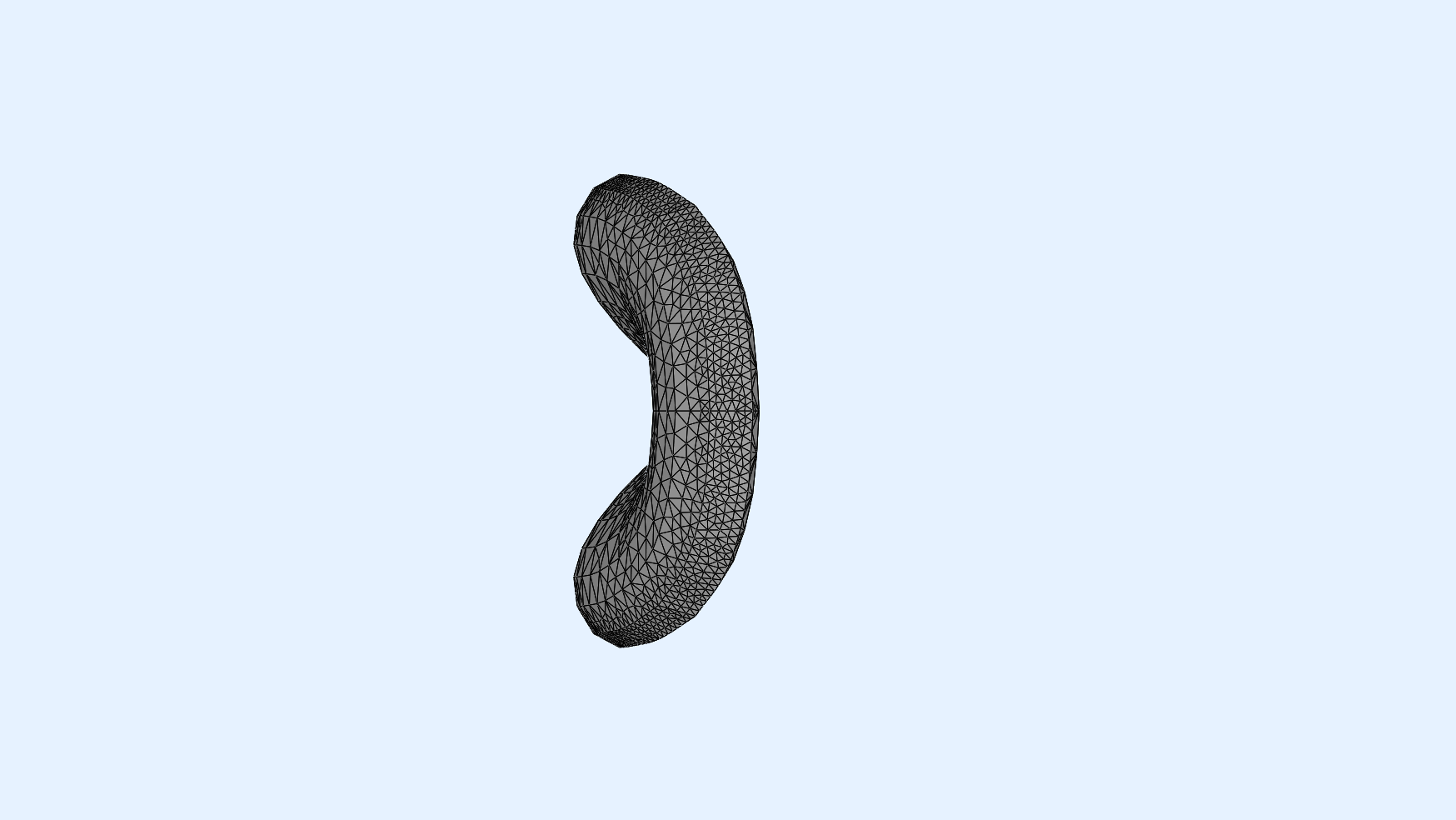

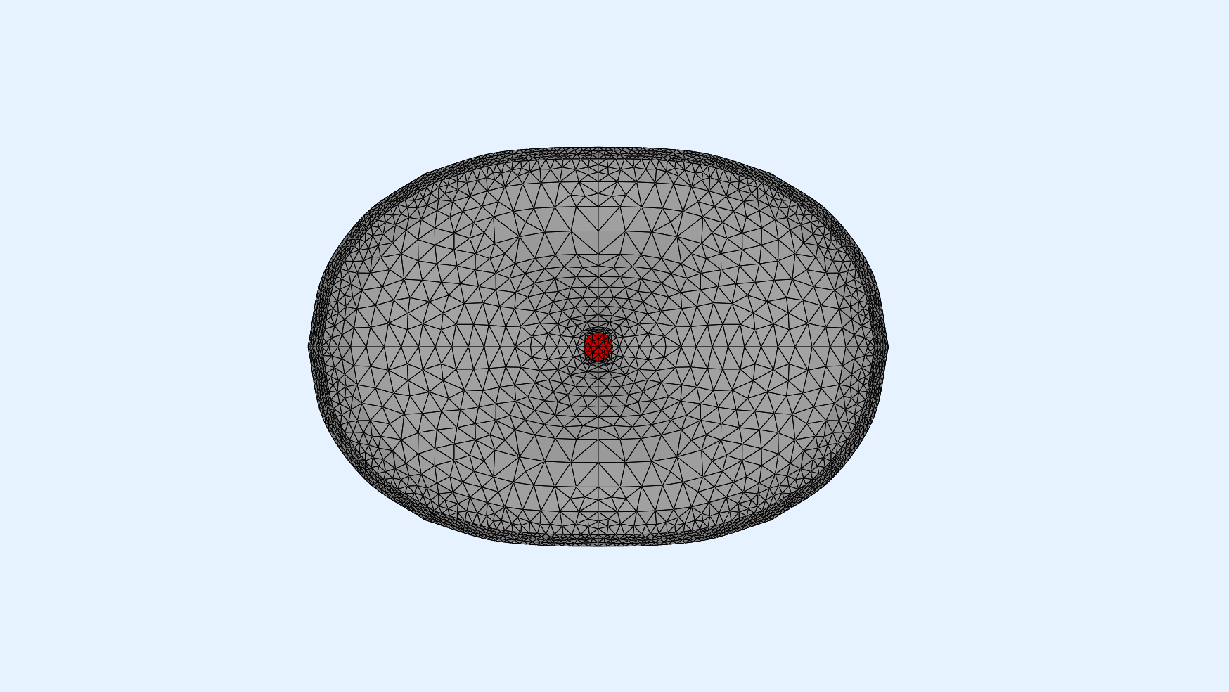

This is the waveguide definition for the asymmetrical freestanding device from the post cited below:
Parameter r0 changed
R-OSSE = {
R = 160 - 33*sin(p)^2
r0 = 8
a0 = 10.85
a = 60 -18*sin(p)^2
k = 0.4 + 2.5*sin(p)^2
r = 0.18 - 0.07*cos(p)^2 + 0.05*sin(p)^2
b = 1.2 + 0.2*cos(p)^2 - 0.5*sin(p)^2
m = 0.8 + 0.1*sin(p)^2
q = 5 - 1*sin(p)^2 + 1*cos(p)^2

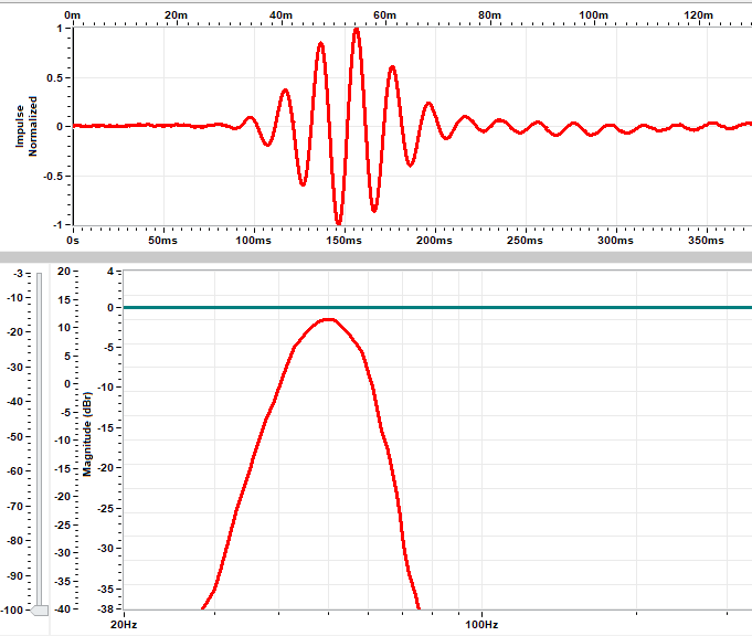

Wavelets seem to be a good 'single frequency' transient.
One type called a Morlet wavelet appear to be used in medical tests, as there are many youtubes on it (and understanding Fourier in general)
The Morlet is a n-cycle sine of a given frequency multiplied by a Gaussian distribution.
So a Morlet (or cosine or whatever window wavelet ) doesn't have a very strong abrupt start/stop, with the accompanying wide bandwidth spectrum abrupt brings.
from:
I was led to Morlet wavelets because they are the wavelets of choice in a measurement program I've been using.
Here is an acoustic capture of a 50Hz one from my sub.
The time domain response is essentially a scope capture, with its mathematically derived frequency response below.
Sounds like 'bump" with your hand over your mouth 🙂
Sure, and that's precisely the transient response where the original transient is almost gone.

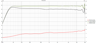

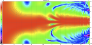

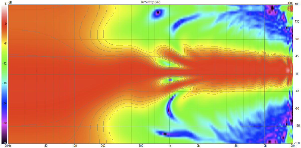

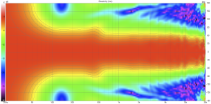

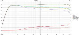

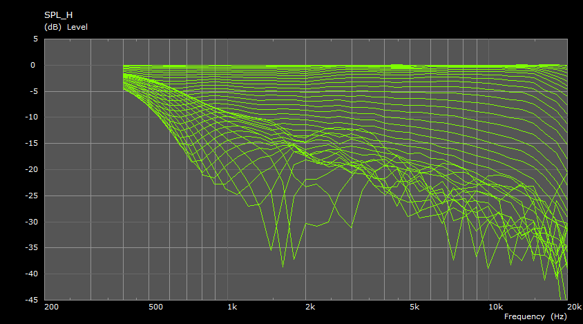

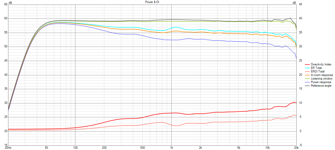

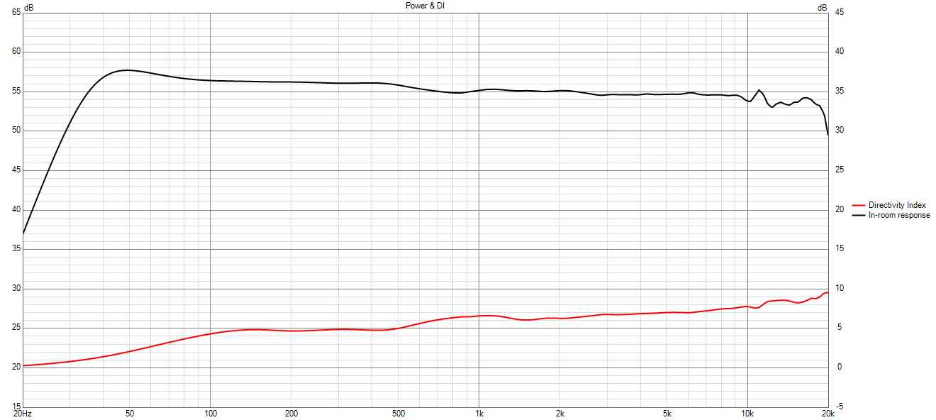

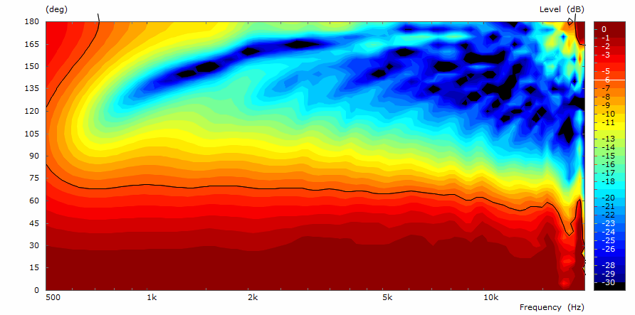

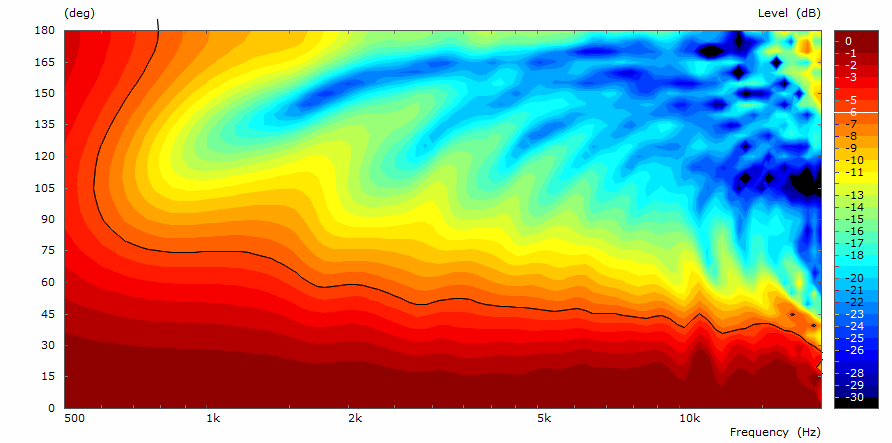

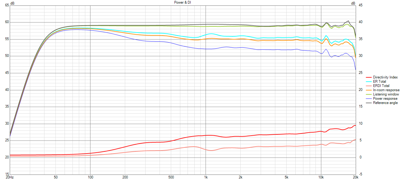

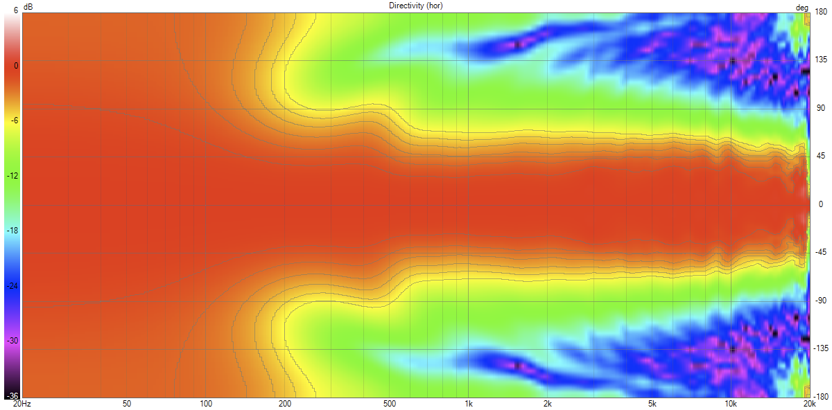

Quick and dirty and non-optimized attempt with a more radical vertical constraint. For the following values:
1) VACS
2) VCad (conventional / cardioid)
Device profile:
Code:
R-OSSE = {
R = 160 - 50*sin(p)^2
r0 = 8
a0 = 10.85
a = 60 -18*sin(p)^2
b = 1.2 + 0.2*cos(p)^2 - 0.8*sin(p)^2
m = 0.8 ;- 0.05*sin(p)^2
q = 5 + 1*cos(p)^2 + 3*sin(p)^2
1) VACS
Device profile:
If you can stand the shape, why not, the data look good indeed. With that small throat you can do these things.
I'm only not sure it will allow a crossover around 1 kHz, that would need to be checked. It may be more like 1.5 - 2k.

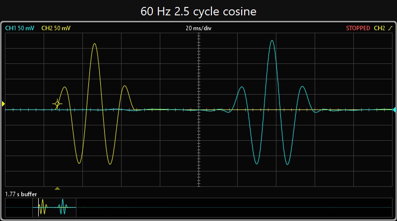

Hey, maybe this helps......to precisely match a transient stimulus to it's response, here's a 60Hz 2.5 cycle wavelet.
Yellow is REW's electrical output. Blue is microphone capture.
(Yellow is trigger, the approx 90ms mic delay is from FIR filter on sub.)
That wavelet burst is definitely a "transient" imo.
A transient with little energy away from its 60Hz frequency.....No?

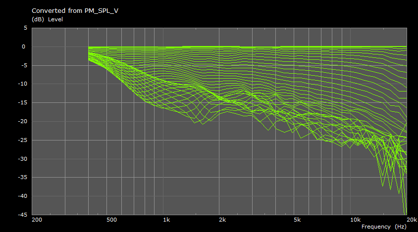

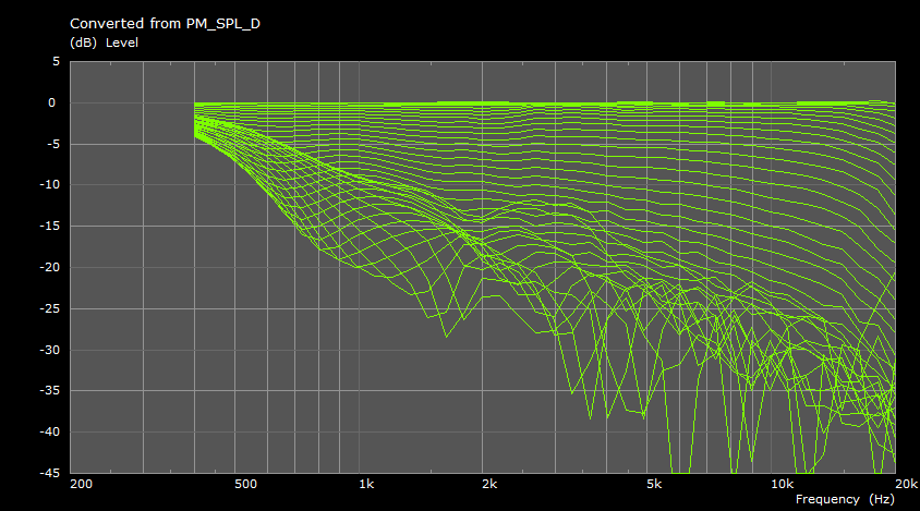

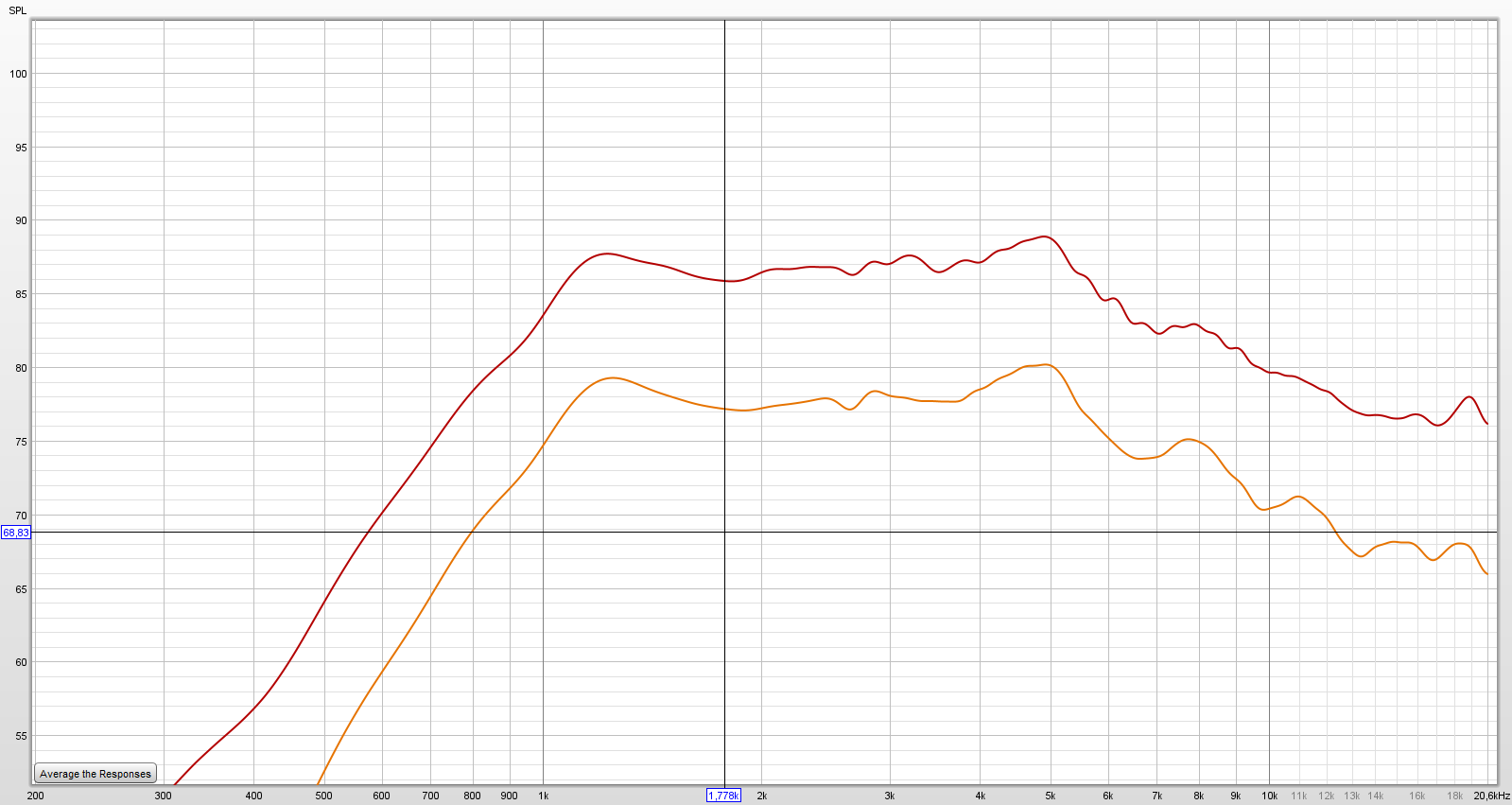

Some measurements of a 340mm prototype waveguide with the BMS 5530ND. Note that the distance at which I measured is too close in this case (roughly 0.5m from horn mouth) and my microphone stand is not ideal. Nonetheless the results look promising:
Unfortunately it does seem the short cylindrical throat introduces some issues in the frequency response. I compared two different throat pieces (similar to what Mabat has shown earlier in this thread), and compared the on-axis frequency response of the two roughly 10cm away from the horn mouth. Orange is the cylindrical piece, red is a smoother shape (no directivity measurements of this one yet):

The narrow spectral content means that it has almost no transient part (which is the point of a wavelet). How long would the Gaussian window used to create the wavelet need to be so you wouldn't call it transient anymore?That wavelet burst is definitely a "transient" imo.
I refuse to call something transient just because it has a beginning and an end 🙂
But I think there's really not much more to this, mostly semantics I guess.
Yeah, the red one seems already close to what's available as the best case for that geometry. It really needs to be made as smooth as possible within the existing throat exit boundaries. Even if it meant some slight narrowing in the top octave, IMO.Orange is the cylindrical piece, red is a smoother shape
In principle this can be EQed but a lot of assumptions are being made and it's surely best to eliminate the need as much as possible.
