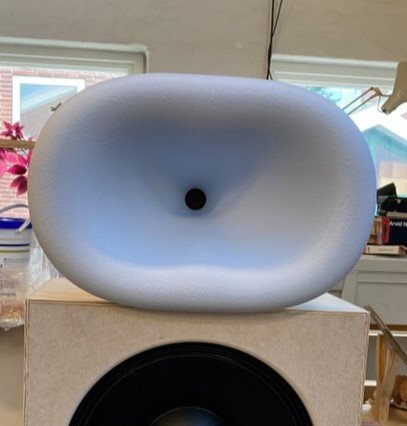

I think oval looks very nice for this class of devices. @aragorus showed one on insta a while back that I quite liked as a form principle:... but it would be rectangular 🙂

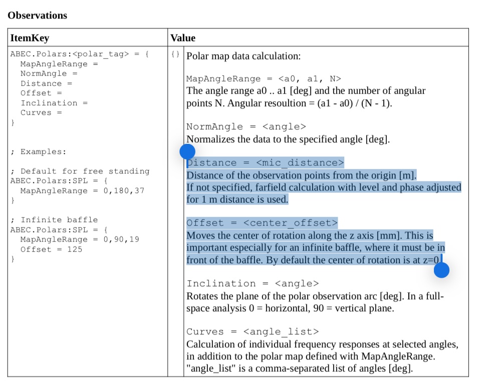

Here's a recap regarding phase data:
- If you specify Distance in ABEC.Polars, FRs are simply calculated at that distance from the origin and VACS phases include all the propagation delays (may seem "weird" due to wrapping but they are correct). Ath currently removes the delay corresponding to this distance automatically in the FRD export function. This is the recommended way how to obtain the data for a crossover simulation. Don't use any PhaseComp unless you know what you're doing.
- If you don't specify Distance in ABEC.Polars, ABEC...

"You have to set an explicit distance for the polars if you want to export them. This will be also the default delay compensation (which you can manually adjust with the PhaseComp value, that will be added to the Distance value)."

You want to define distance, phasecomp and offset in the observation section for a controlled measuring script.

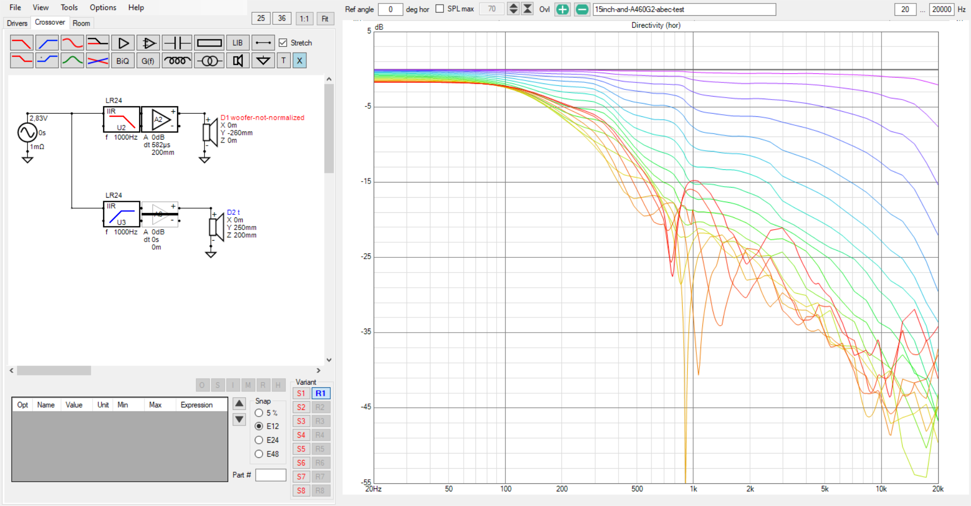

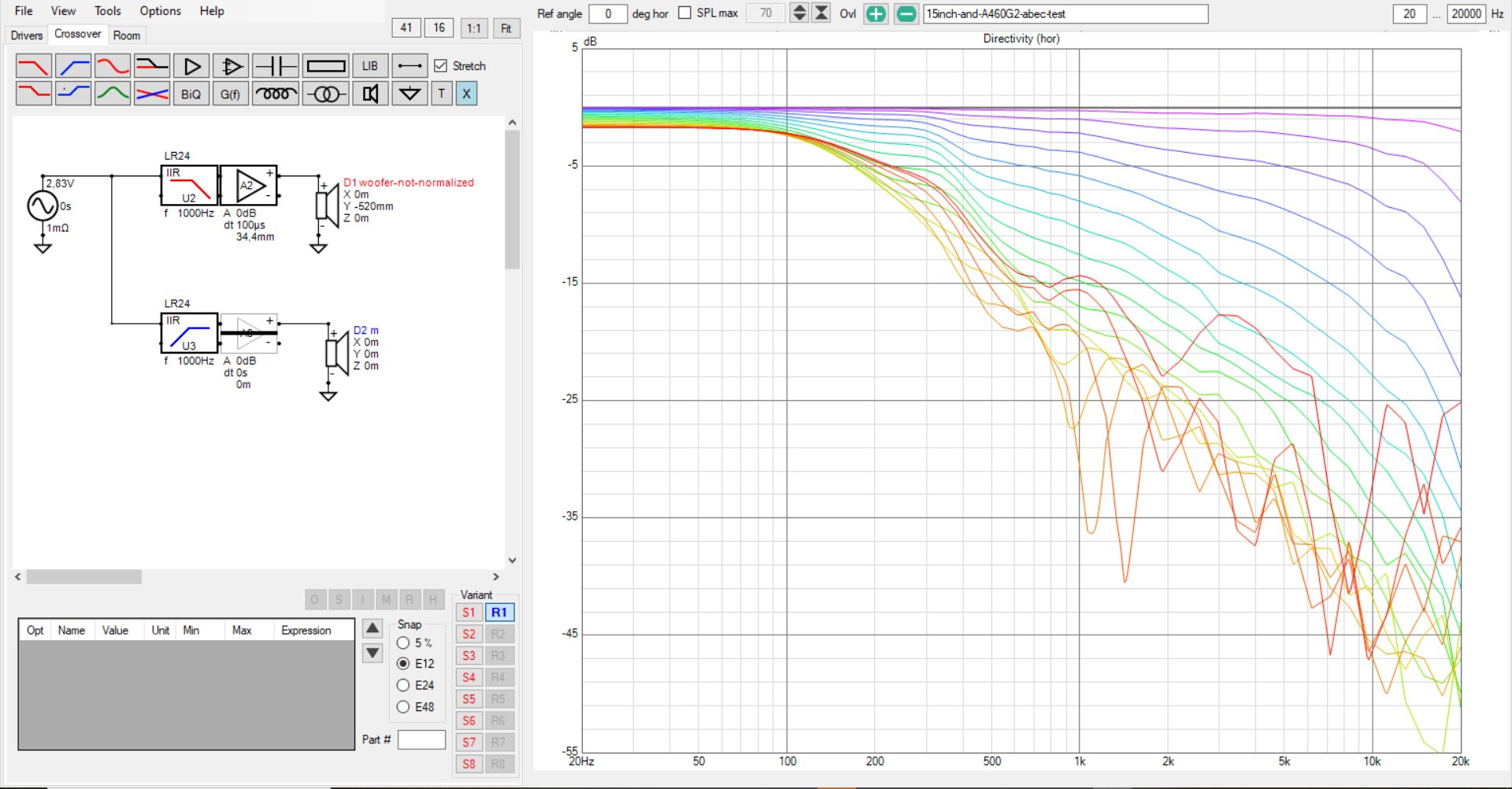

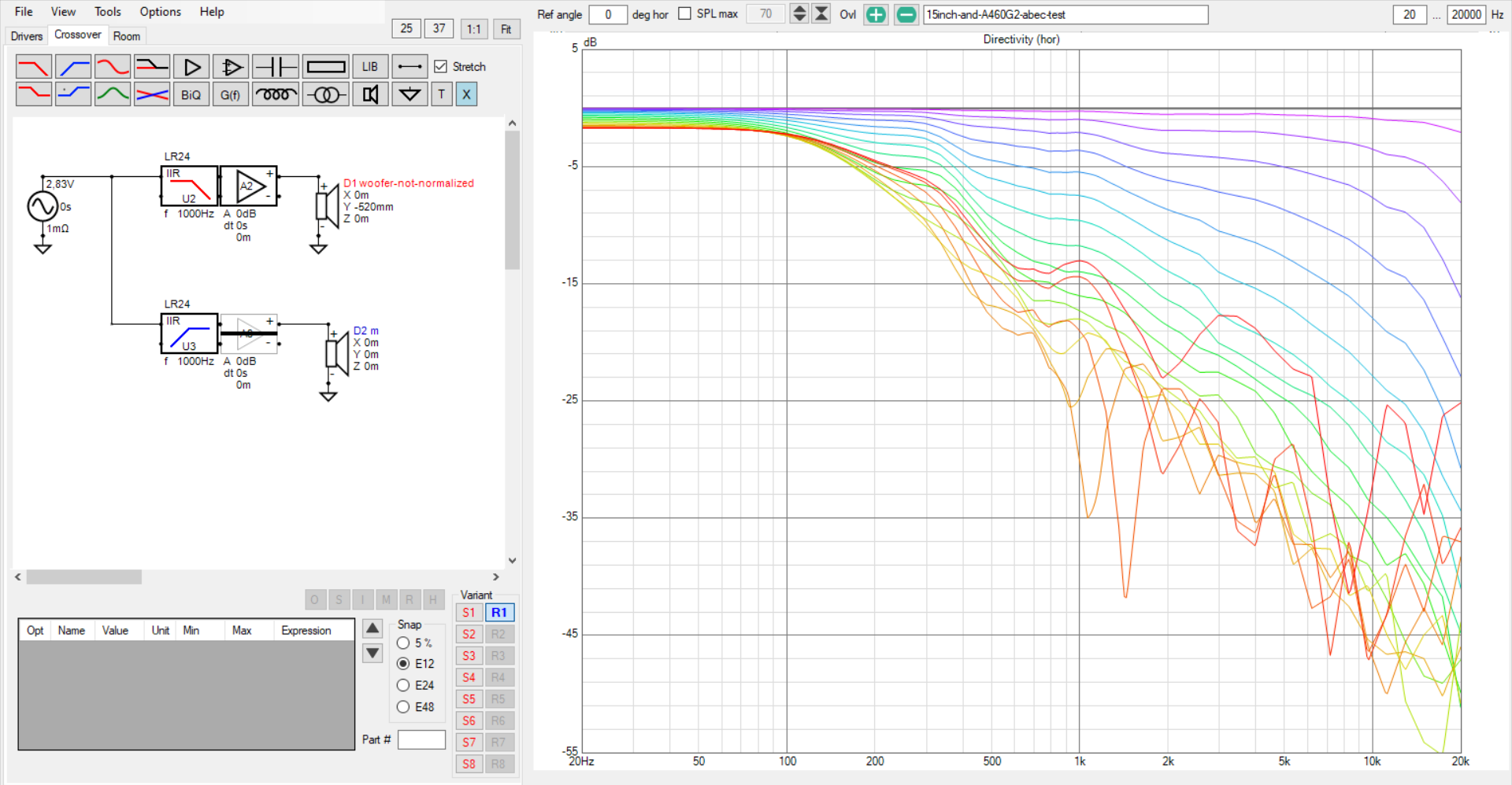

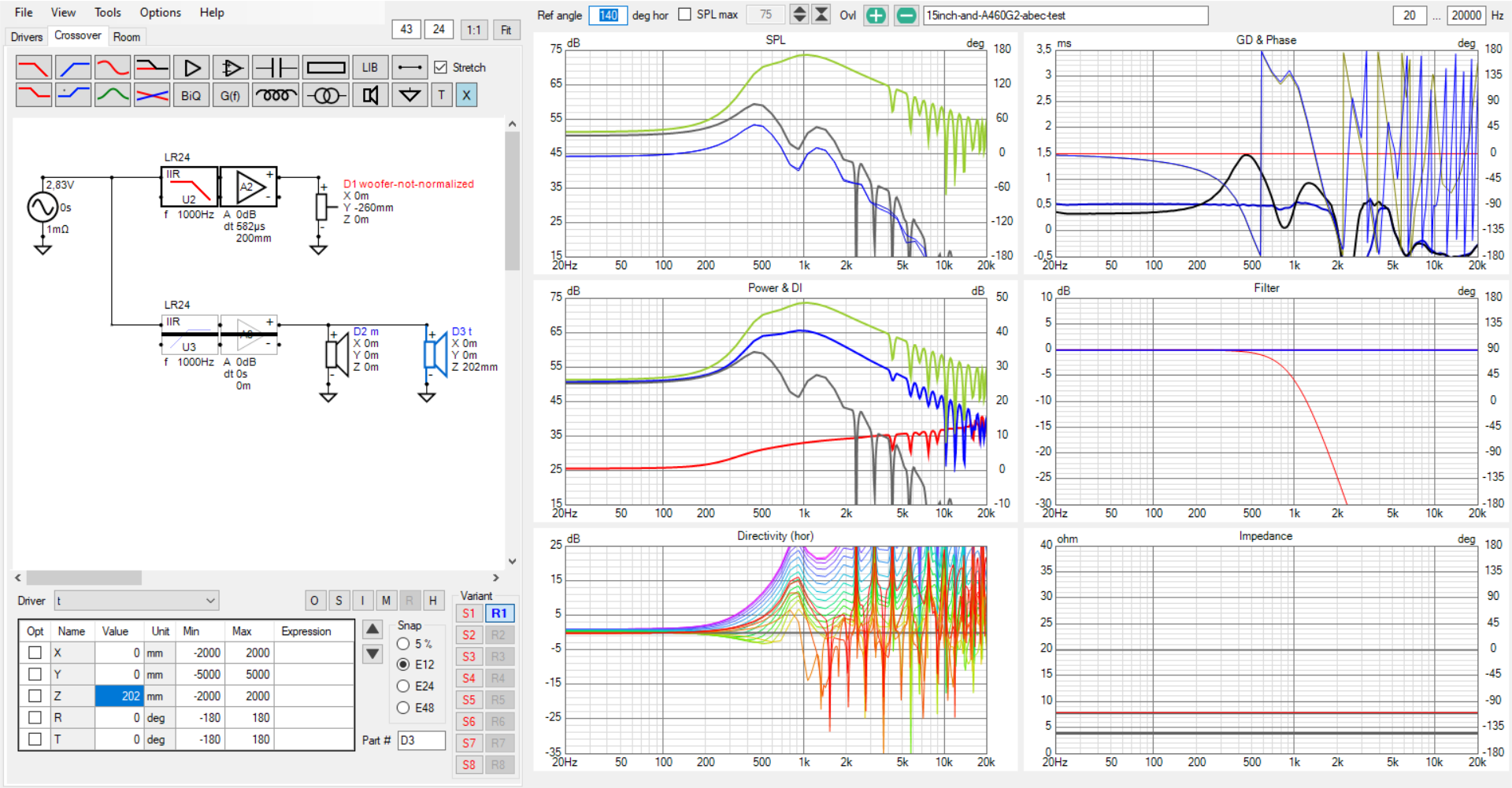

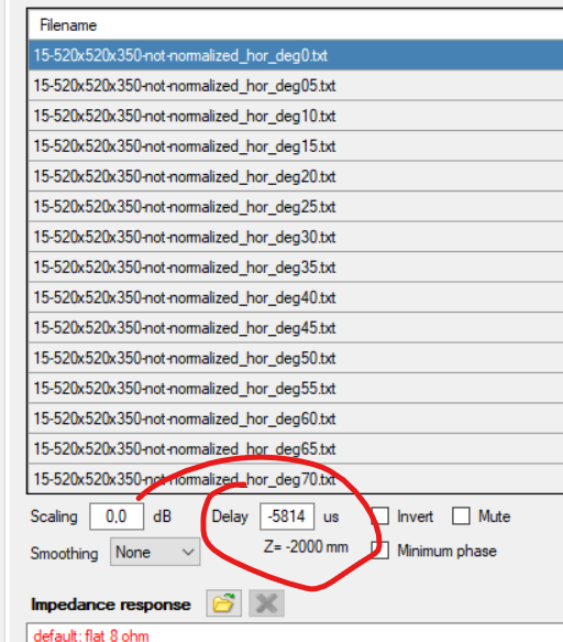

solution for my issue with recent sims was that VACS normalized responses had unwind all the constant delay out up to the impulse by some automatic thing, which removed any differences of acoustic centers in a way, made the common reference of 2m measurement distance irrelevant.
This is fixed just by taking out Normalizatio, either from ABEC observation.txt or removing NormAngle from ath definition file which generates the observation.txt

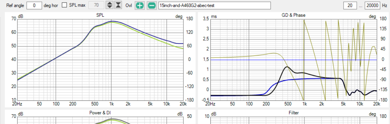

Now the responses include phase in regards to rotation axis, and this can be removed in VituixCAD for example. It can be removed with ath script FRDExport definition, but downside to this is that if there is another ABEC sim done without ath it's just different process. So, simulate what ever you wana, observe from constant distance, and remove distance from mic to rotation axis in VituixCAD using Delay in the Drivers tab:
Now the mouth as rotation axis has some extra delay compared to throat rotated, as it should:
ps. the frequency responses differ because the other was simulated full 20-20kHz and the other is standard 200-20kHz so VCAD extrapolates the missing bottom.
Anyway, data made this way resembles data on would get by making real measurements following VituixCAD measurement manual and we do not have to guess to compensate distances to acoustic centers as people do with single channel measured data (USB mic without reference) or minimum phase data.

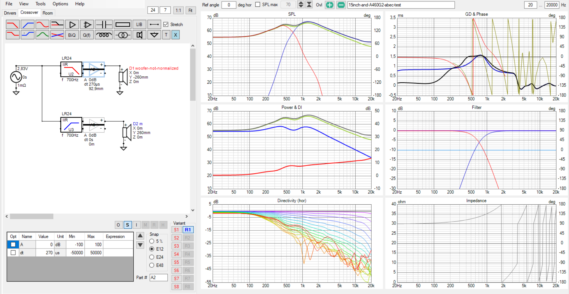

Now both the throat or mouth spun waveguide data must have delay block on the woofer as it should. Throat spun set is moved back to align mouth to woofer, while the mouth spun stays Z=0 as it's measured mouth aligned with woofer, like it should. So, errors are now gone from the data.

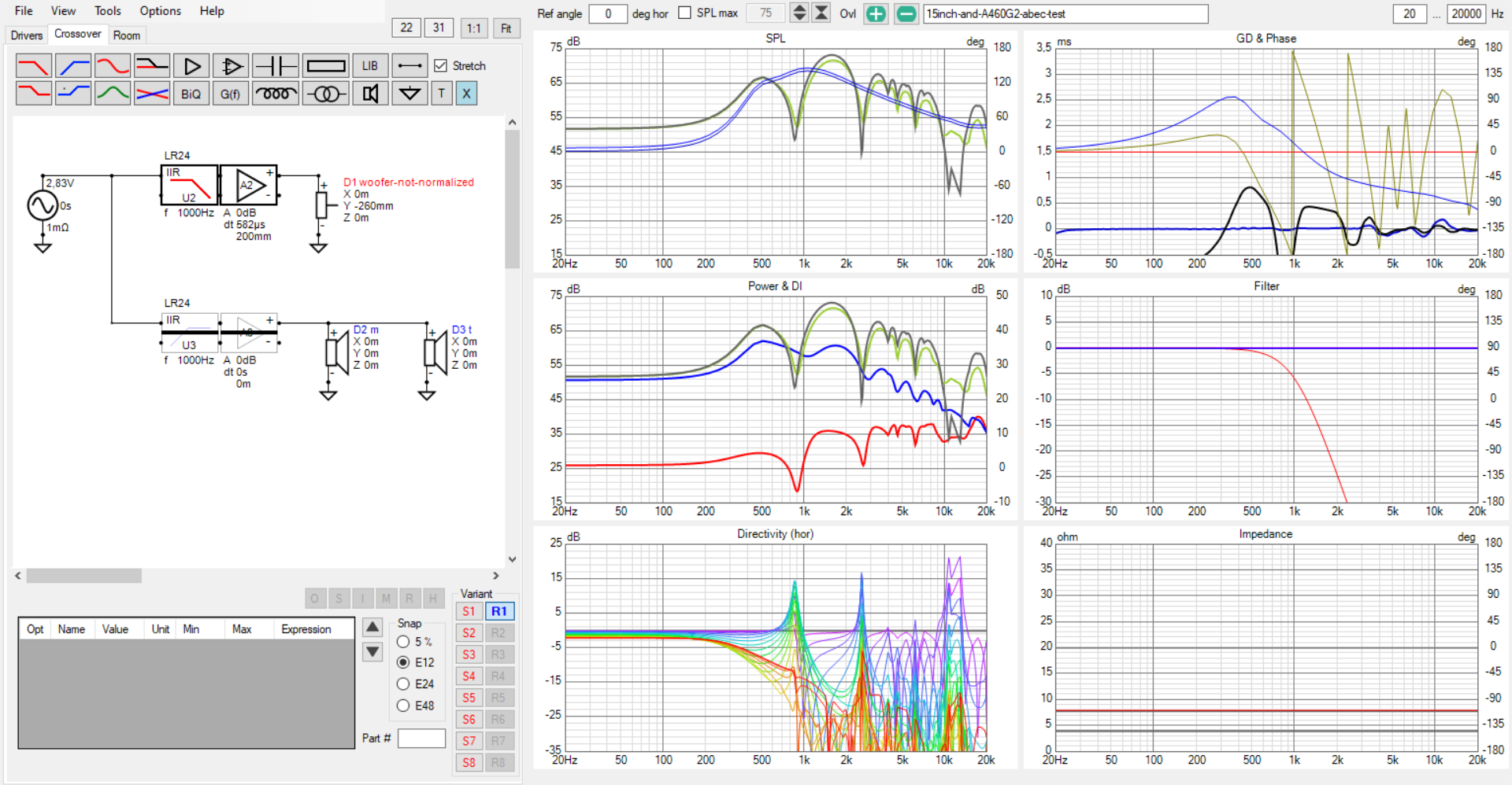

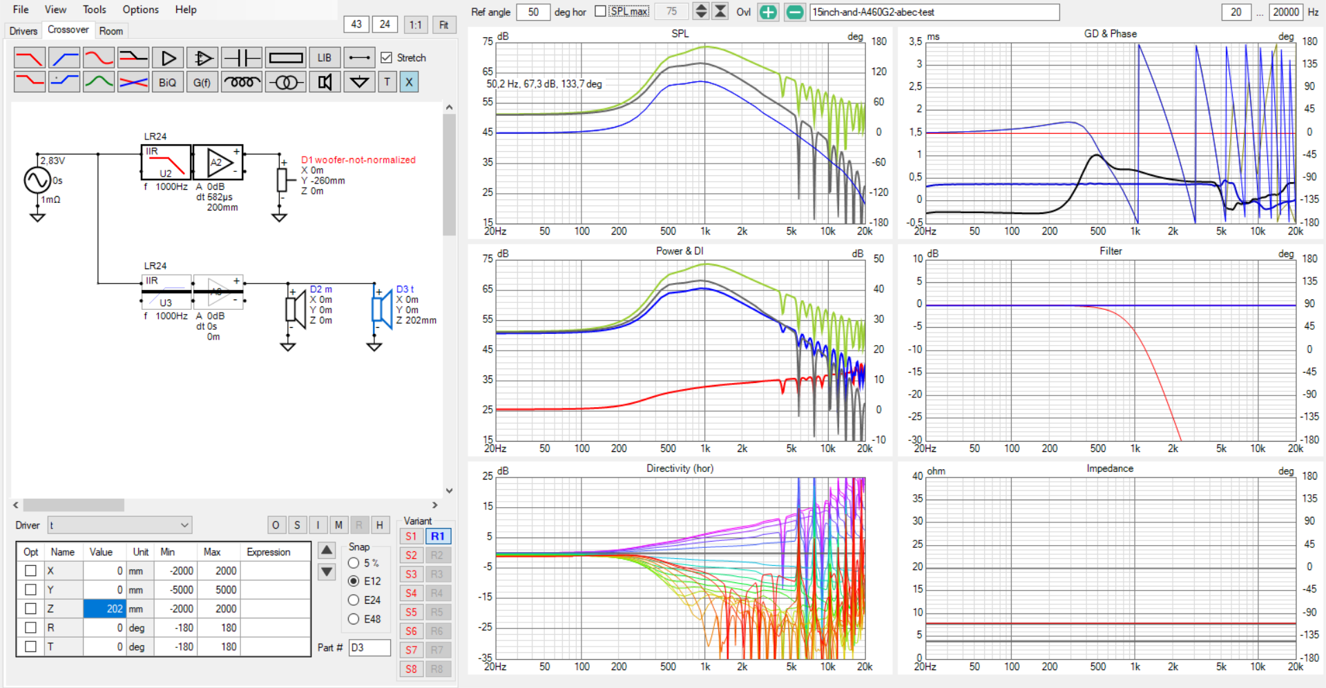

edit. here is easy way to compare whether it matters which axis is used as measurement axis:
Put both throat and mouth spun at same location, and if they match to all directions there is no difference which way to do it.
Here the raw measurements not aligned yet, showing some ~20cm delay between acoustic centers readable from interference pattern, first interfrence null where wavelength 20cm is half wavelength ~857Hz.
Now If I just move the throat spun back, or mouth spun forward to "align the devices", the interference disappears as both acoustic centers coincide. The comb seen here is some rubbish data and doesn't cancel out. Now just use mousewheel to scroll through any observation angles and the same holds true, they all coincide perfectly until far off-axis some differences emerge.

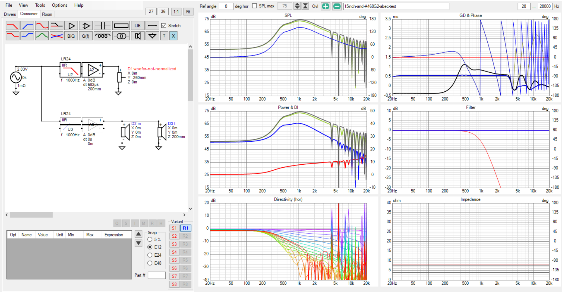

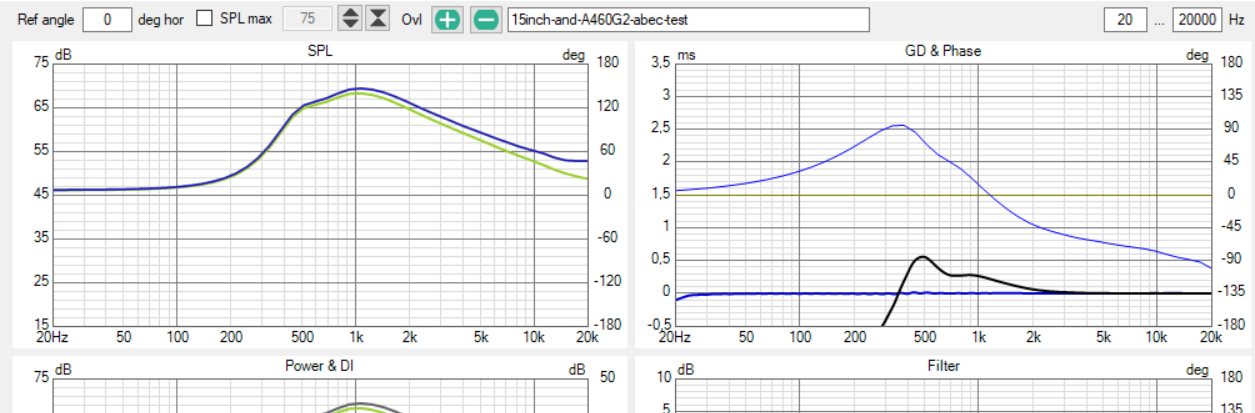

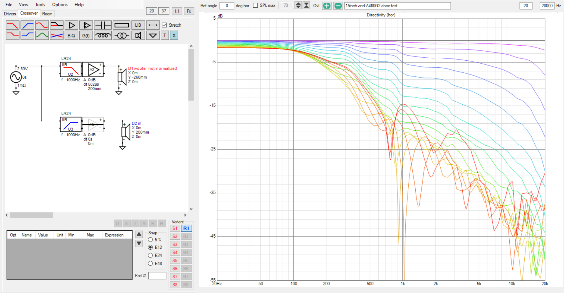

Now that the problems are solved there doesn't seem to be any issue with aligning mouth with baffle (woofer) with this device, difference to off-axis is minor whether the throat or mouth is aligned with woofer, and it's better with mouth aligned actually, opposite to what the initial observation was from poor data. Woofers acoustic center isn't at baffle plane either, but some cm behind.
So, if listening axis is set at throat height, the woofer gets longer path length to ear physically so no additional delay is necessary in this example case, with ~52cm c-c and 3m listening distance, for relatively smooth transition to all directions, here 1000Hz xo to highlight any issues, and there is almost none.
Small 3cm delay to woofer smoothens it a bit more.

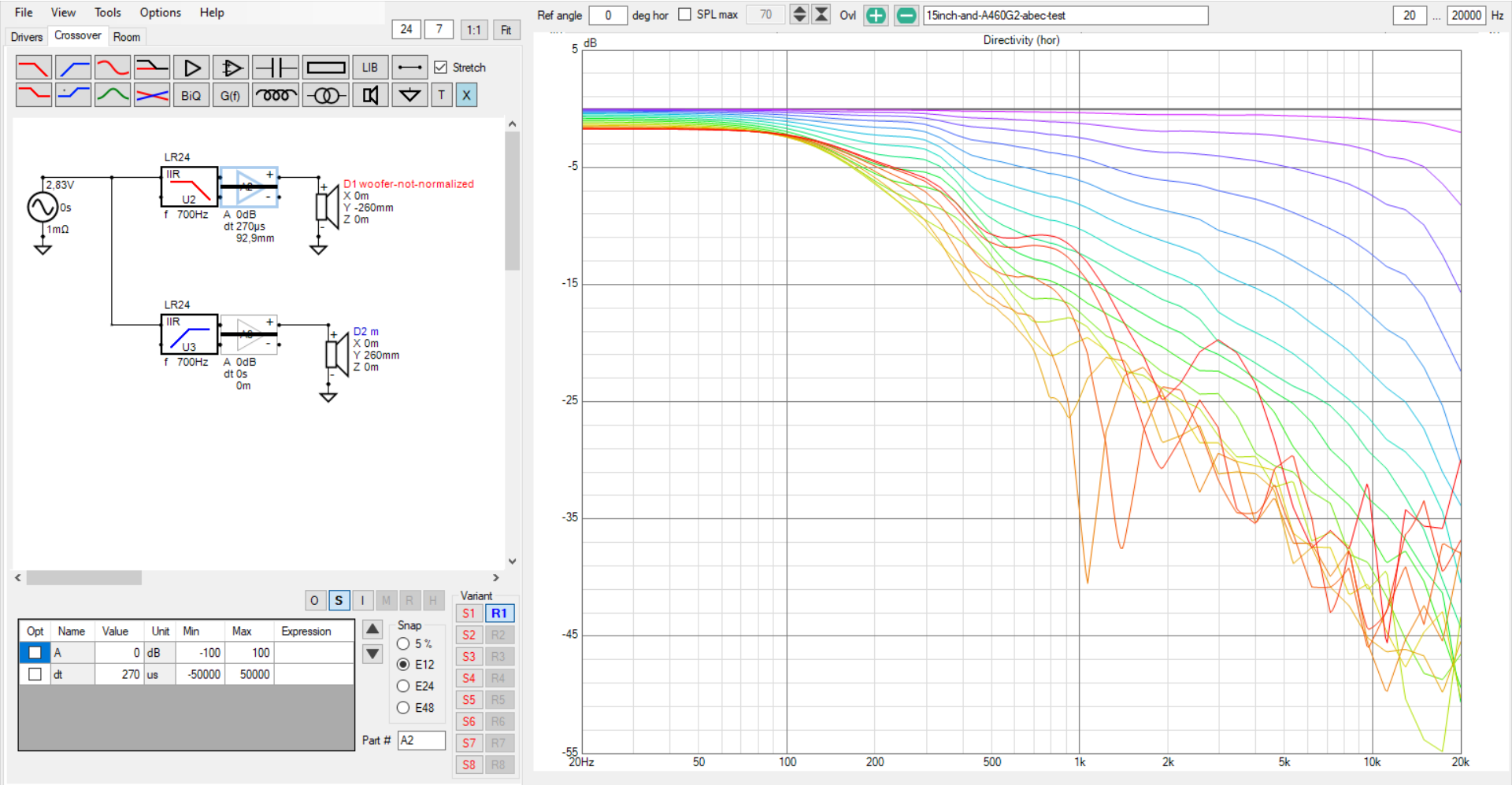

For listening axis midway between woofer and waveguide, nice delay for woofer is roughly ~10cm in this case, not the full 20cm of waveguide depth.
If xo is lower, like 700Hz, there doesn't seem to be any need for extra delay as it's smooth already.
There is caveat for all remarks above though, the images show normalized polars, and do not see the not normalized data behind, so the actual xo slopes are not ideal LR (filter blocks) but bit something else, so real world stuff might differ, or if I did use time to smoothen the responses and check again how big of an error it makes.
