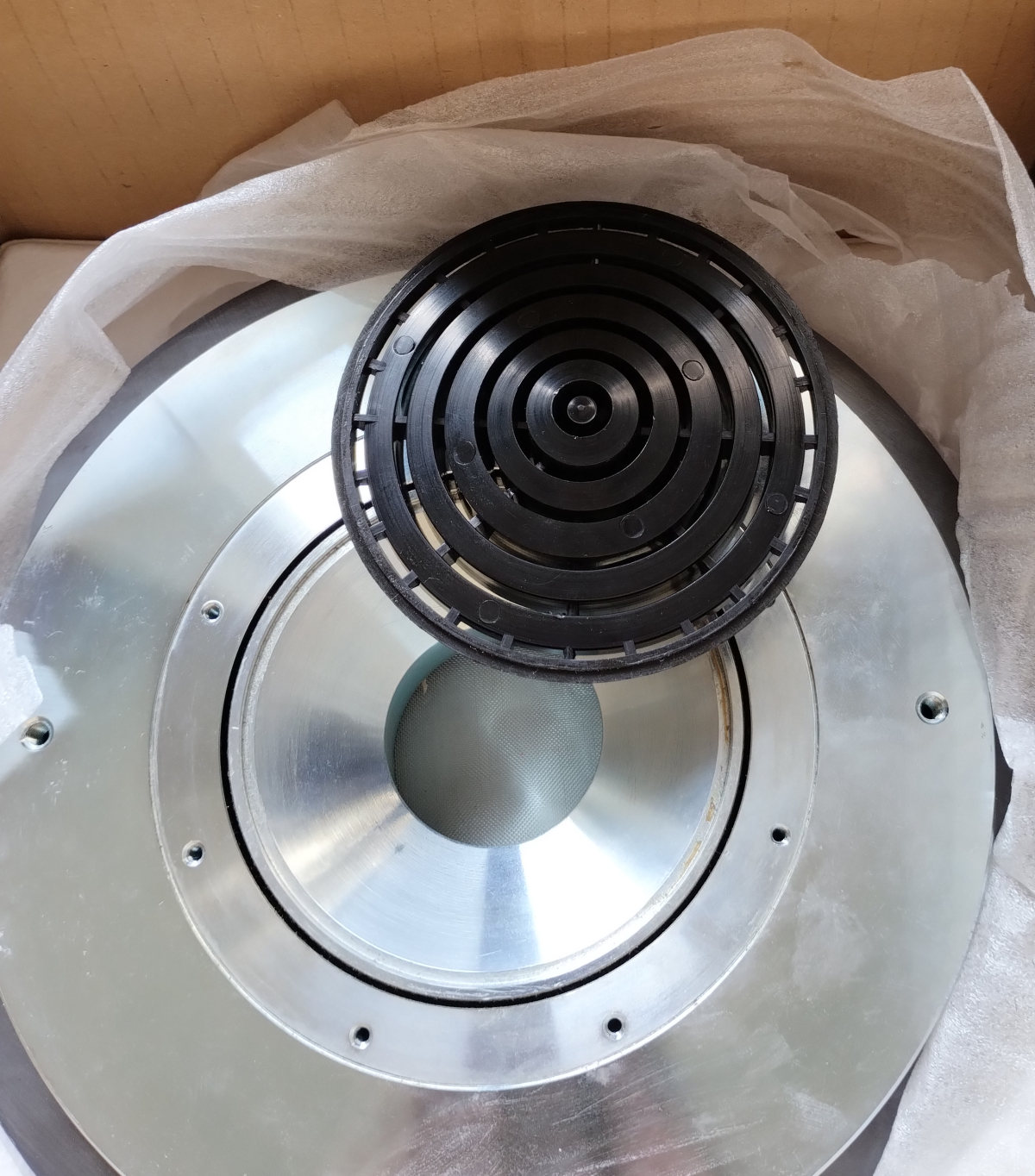

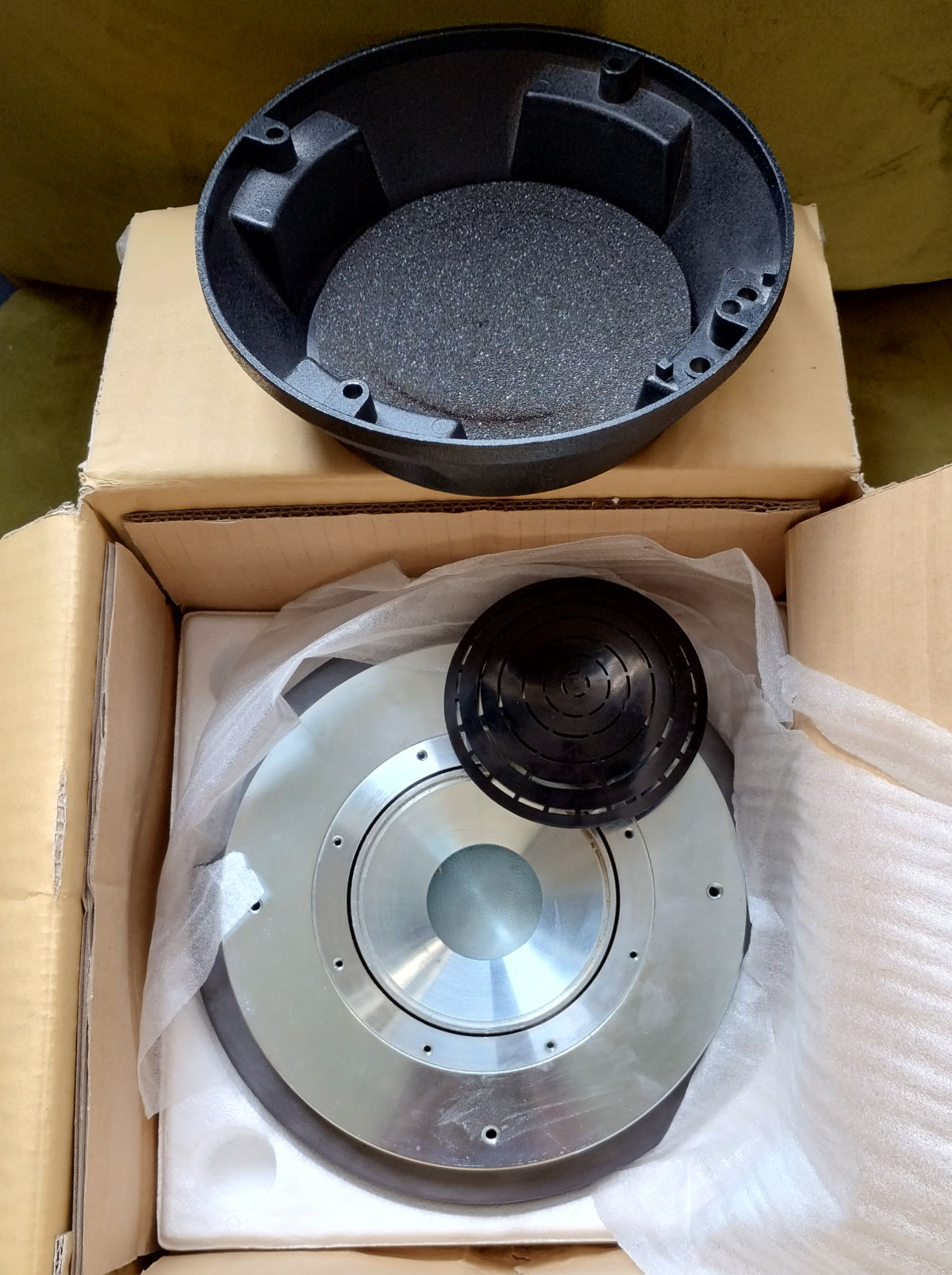

BTW, this is what I have lying around for a while - a 2" exit CD with 4" diaphragm, bought cheap in a sale years ago.
It's nicely shallow. The current phase plug is something ridiculously rudimentary (I can't understand how it can even work - it's there just for the compression, it seems). Can't wait to try this with a proper one. 🙂

I was curious. Is this how cheap (one-piece) phase plugs are commonly designed?The current phase plug is something ridiculously rudimentary [...]
Actually, there's an evident attempt to equalize the path lengths, maybe they are.

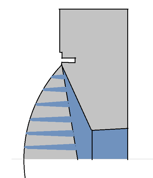

This is a quick sketch of the thing (the air path in blue):
This is a 6-slot plug 🙂

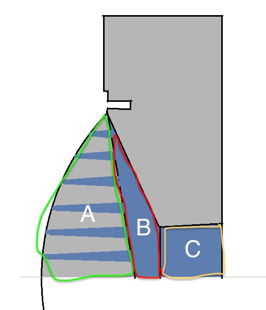

It feels like that A and C volumes can be reasonably mastered but that volume B seems really tricky... in this case the situation in B for the upper slots seem very different from the lower ones.... it just looks like a turbulence machine... 🙂

It's obviously one those "gradual-integration" types, where the channels are not joined all at one place, but they are summed in steps. I can't see a reason why this couldn't work in principle, but the optimization sure won't be easy. It should be possible to simulate this as well, as soon as I have the tool finished.it just looks like a turbulence machine... 🙂
Well that's the common (and I guess more expensive) way.Get rid of B. Make all slots start in A and terminate in C?
