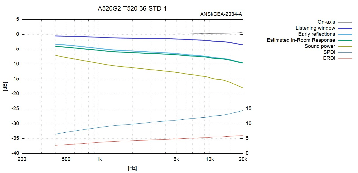

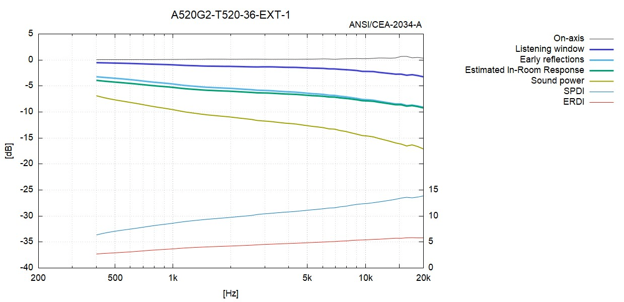

I would say that it doesn't need to be a coax...The ATH A520G2 with the T520-36-ext-1 (1.4" throat extension) with an appropriate 1.4" coax cd like B&C DCX464 would be a good candidate for a 2 way system with an 15".
It doesn't need to be but if one wants the full treble extension and still want to cross as low as possible, it seems to be a good solution.I would say that it doesn't need to be a coax...
If I were to choose an alternative path, I would go for a 1" throat extension with a 1"cd mated with an an 12" woofer crossed higher.

- As for the extended throats, please still consider these as somewhat experimental. There are still very few certainties in this regard. It seems to improve things in general, but surprises may happen, even those unpleasant. What's virtually certain is the directivity.

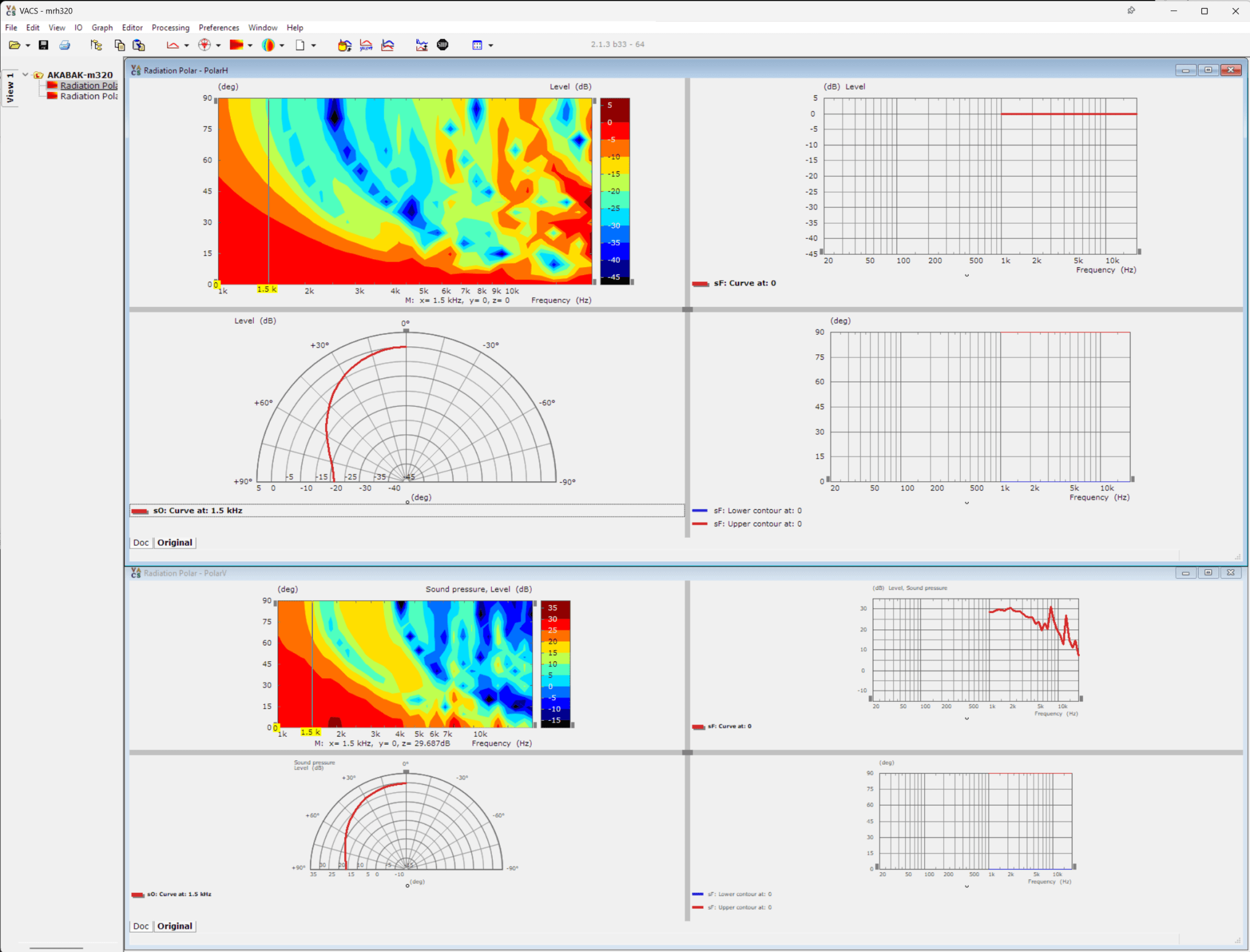

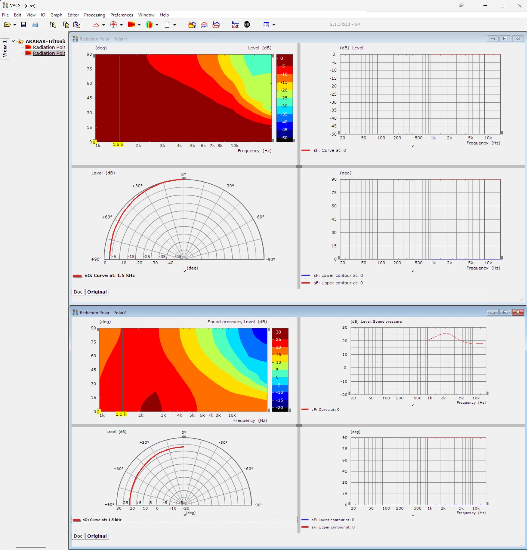

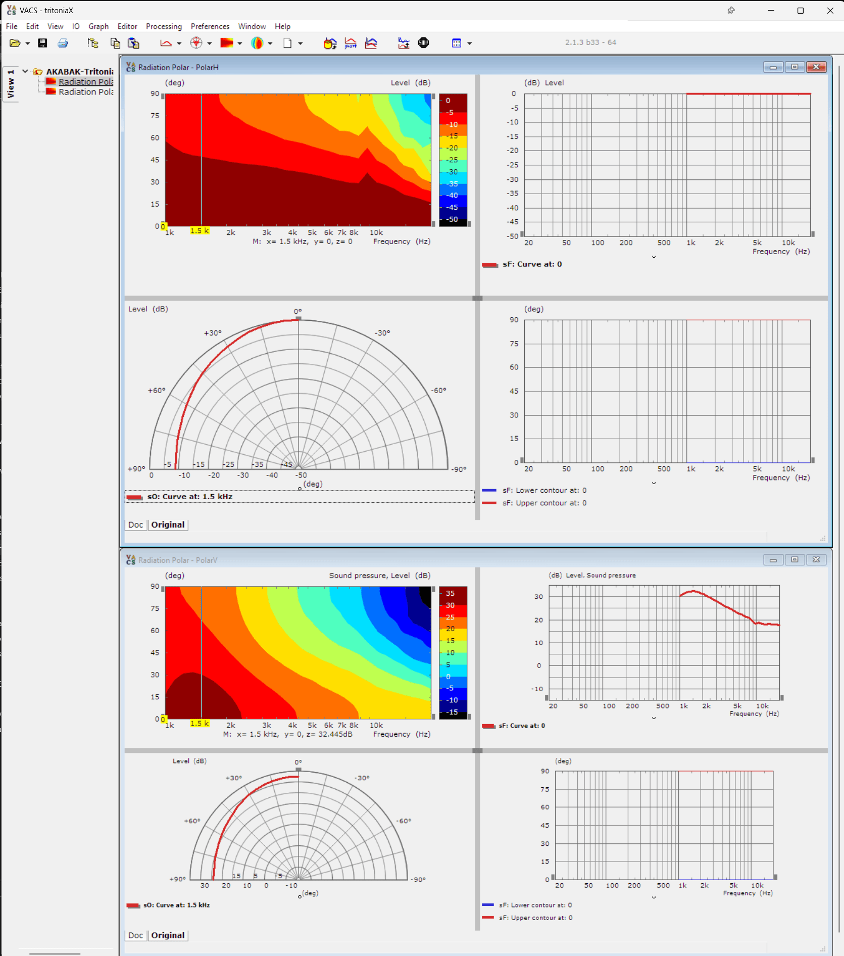

Thanks for your great work, Marcel! I managed to run ath on tritoniaX and even akabak, VACS looks great, I think. I'm currently considering cloning an old monitor design that is using an MRH-320 which is hard to find, currently, but the community created a 3d model for me to use.
In Akabaka and VACS (if I actually know now what I'm doing which I'm not so sure about), that one looks like in my attachment.
To my inexperienced eye, it looks worse. So I was starting to mess with the tritonia cfg to come closer to the mrh320 cutout measurements like so:

which works but I don't understand that this is better than mrh320.
If I increase the length, I also get too wide and too high which I guess is about the s n and q terms.
Practically, what are some key targets in changing these and how would you prioritise reaching them?

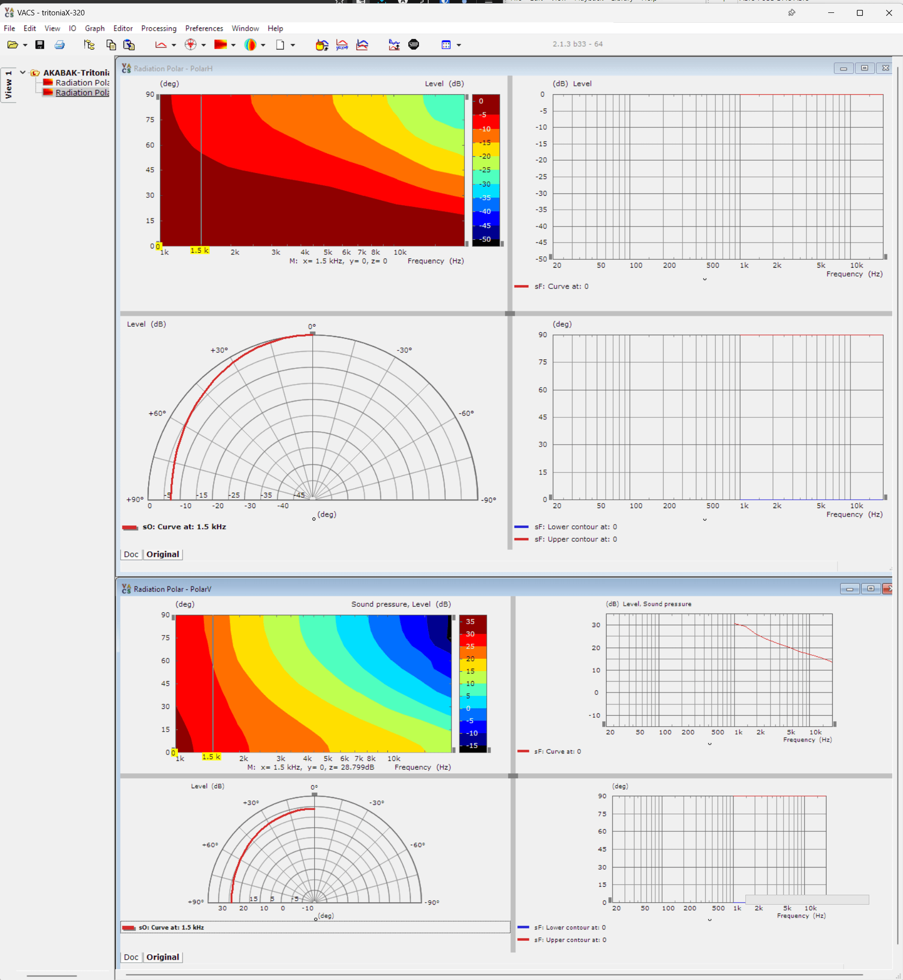

PS: I just now discovered k, bringing me close enough to the target height and width:
Throat.Diameter = 25.4 ; [mm]
Throat.Angle = 0 ; [deg]
Throat.Profile = 1
Length = 140 ; [mm]
Coverage.Angle = 38 - 20*cos(2*p)^5 - 25*sin(p)^12
Term.s = 0.7 + 0.2*cos(p)^2
Term.n = 3.7
Term.q = 0.995
OS.k = 10
Slot.Length = 20*sin(p)^4
Morph.TargetShape = 1
Morph.FixedPart = 0.0
Morph.Rate = 3
Morph.CornerRadius = 4
Morph.TargetHeight = 165
Morph.TargetWidth = 260
looking at the polars, is this better than mrh320?

I have added a wide-angle throat adapter for those 1" drivers like the Faital HF108.
http://www.at-horns.eu/gen2.html
1.4" extended throat.
The story short, with this design the throat adapters basically don't change the directivity, which was designed with a 1.4" driver in mind.
