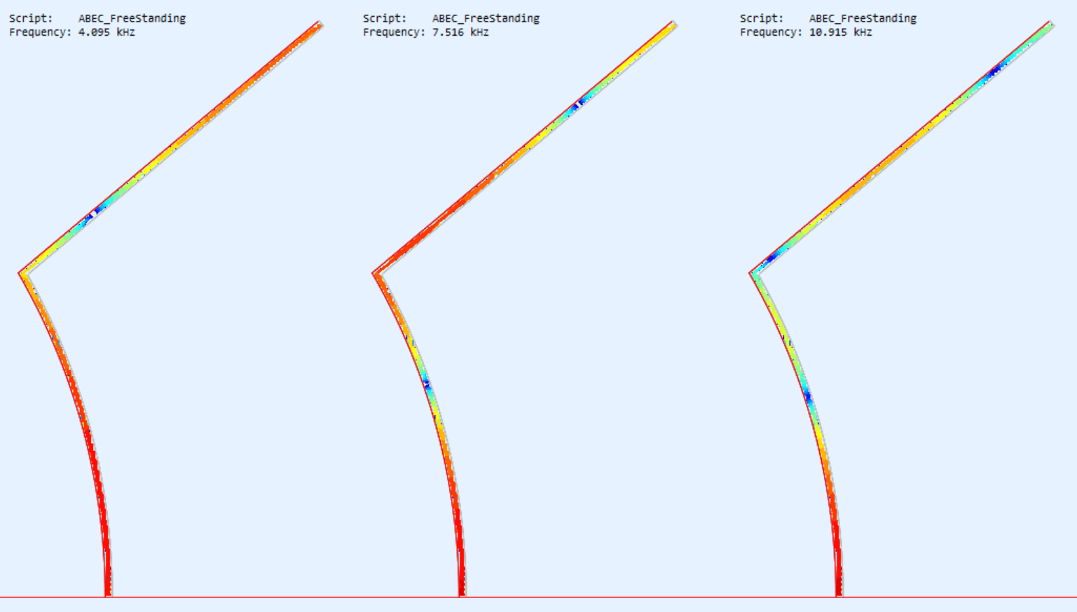

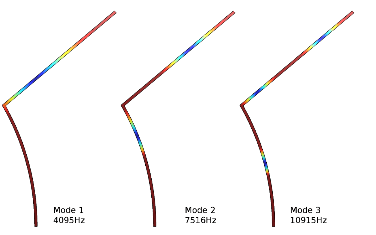

I tried to replicate the results from the work referenced below.
FEM / Fig.4 from https://www.researchgate.net/public...ers_with_narrow_channels_and_rigid_diaphragms
BEM via ABEC3:
This was in axial symmetry mode. It's pretty sensitive to the exact geometry defined.
I created this manually. With the "plotter" tool I'll be able to easily test both axial symmetry and full-3D mesh.
I guess a more proper way would be to compare a sim to some "simple" analytical solution, but I don't have any at hand.

That looks promising for a geometry I would have expected to cause issues for conventional BEM. There are differences though which it may be wise to understand and quantify. Of course the published FEM results may not be fully grid independent though it should be straightforward to achieve in 2D. A fully resolved FEM simulation of a representative geometry is likely more useful than an analytical solution of a less representative geometry given the nature of the error.

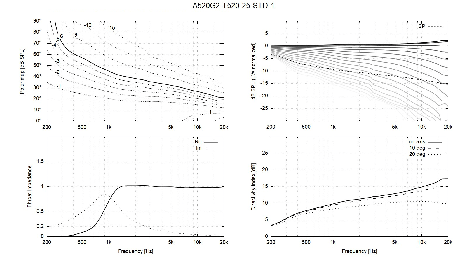

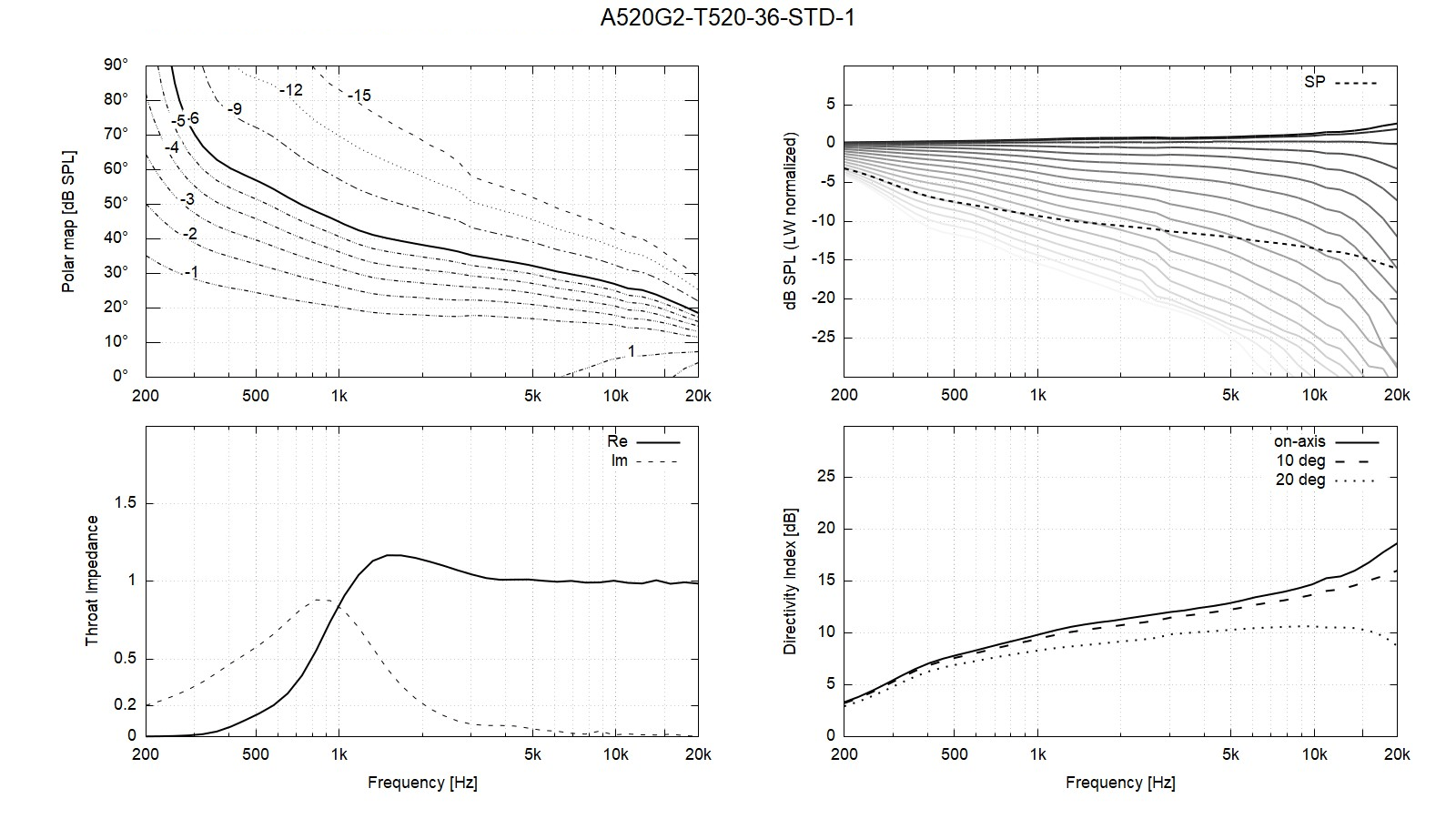

The first batch of Gen2 waveguides is available now.
As always, I planned a lot more "content", but as always...
(The next will be probably a segmentized version, keeping the same throat parts. )
Would be interesting to see exp throat extension instead conical.
Any way to add it on R-OSSE?
None of this is conical. The whole adapter, connecting the driver and the main waveguide body (which is a truncated R-OSSE), is in fact a "free hand" curve (a Bezier cubic). That's the convenient way of doing it.
