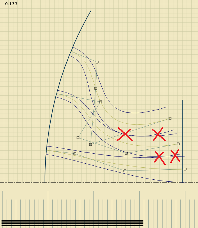

I'm really starting to think that the straight channels are flawed design from the start.
Why you think so ?
I just can't imagine that the area expanding and shrinking again, and in each channel differently, can be a good thing for the overall performance of a phase plug as a system.
I went through 20ish itterations and still running into issues.Yeah, I've tried something very similar. It doesn't seem to work so well in practice and my explanation was that it magnifies all the deviations from wavefront coherency to a much larger area, making it simply worse. For this to work as intended, you would probably need a perfect driver.
There was some success (not mine) with BMS 4550, but that's still a small driver:
https://www.diyaudio.com/community/attachments/bms4550_4vaneplug-png.1004919/
Make it bigger and the problems grow. @aragorus probably made the biggest effort testing these things.
There may be some room for improvement in phase plugs though. We'll see.
On the simulations I've managed to push all resonances above 20k, but in reality there are some in the 10-15k region.
I belive that the wavefront at he CD's exit doesn't exactly follow a spherical to flat shape evolution with frequency.
That I think this is probably caused by the design of the Celestion Axi2050's phaseplug.

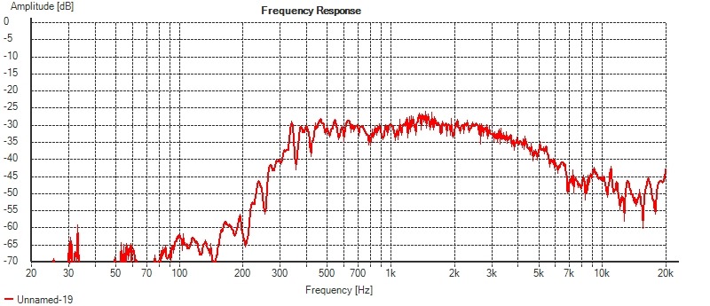

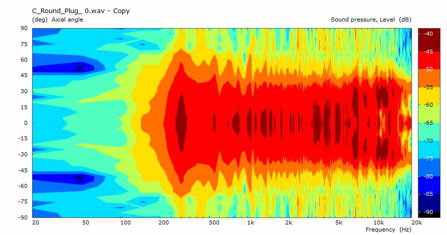

The driver itself is not very smooth above 10k and the ESP plug makes it even less so.
The contour plot is made with in room measurements, 5 degree resolution and 20ms window. There are some room reflections.
The plug is mounted on a 50cm ish concenric horn.
The frequency response plot contains the raw reponse, the contour plot response is EQ'd flat-ish on axis and is not normalised.

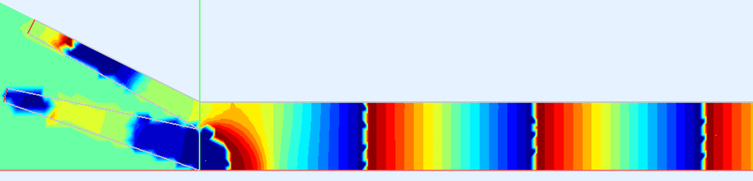

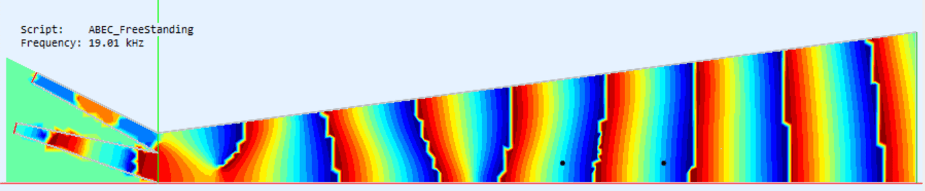

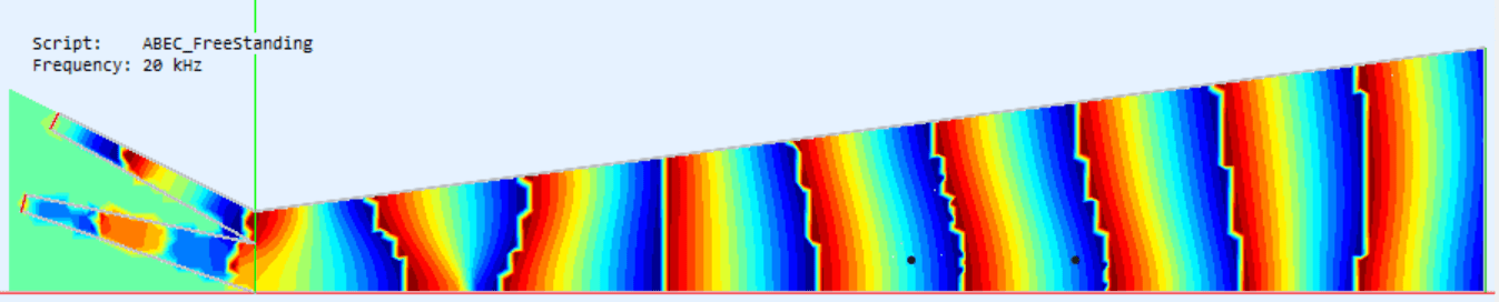

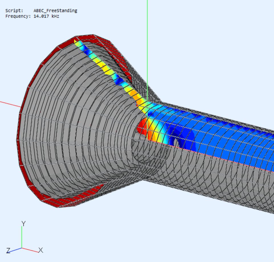

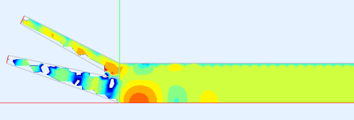

I'm setting up an ABEC framework for the task, and what's interesting is that even if the phase plug itself is plain poor (here it's just randomly assembled), after some length of a subsequent (on-the-end-damped) tube, it tends to smooth out - I guess these are the evanescent modes. The conical exit sections of compression drivers probably also help to "flatten" the wave before it enters a horn.
(14, 19 a 20 kHz for some random geometry.)

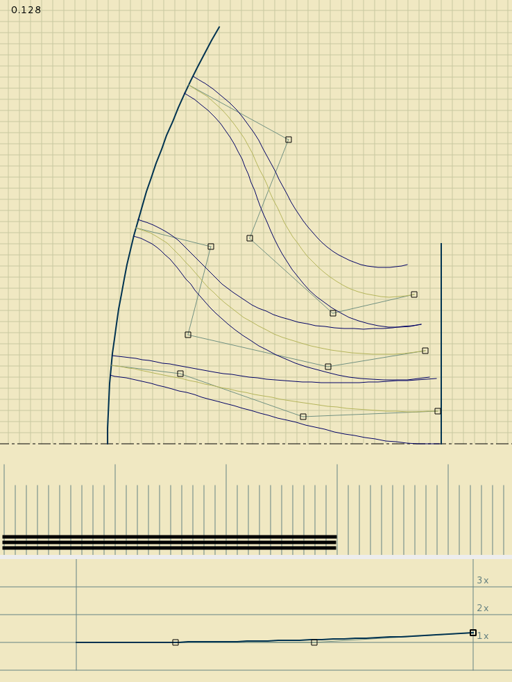

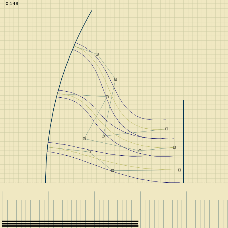

- I don't know, maybe it's just the input and output areas that actually matter, no matter what is in between. It just doesn't seem right to me. I like this idea of zero-expansion geometry, i.e. to have a constant area through each channel, input to output. I shall wait till I have some simulations at hand, I guess.
After all, it's possible to shape the exit into a spherical wavefront even with a concave dome. We only need a higher degree of the splines than cubic (this is five, six should be more than enough) -
(All the same length, constant areas through the plug)

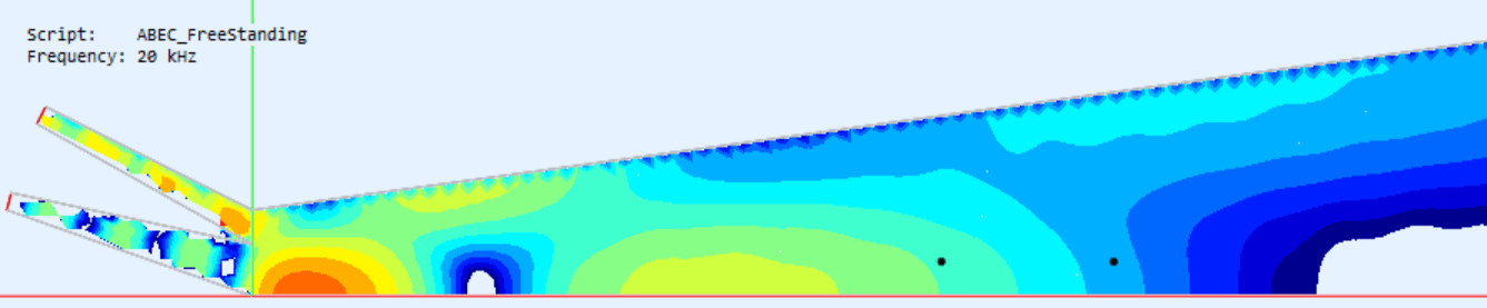

This is with a slight expansion. I guess the common vanes near the passage ends could be just cut off.
This would require some manual "polishing" of the model...

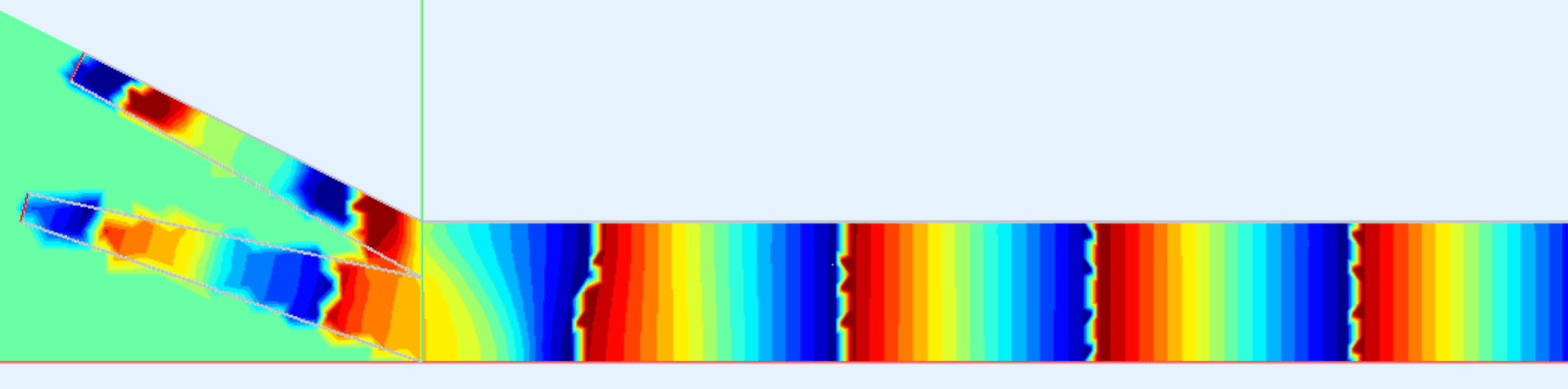

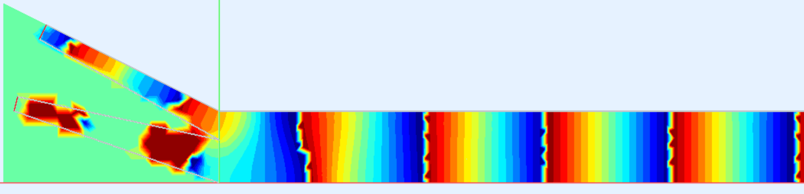

I was a bit too quick here. Cone is not nearly as efficient as wave "flattener" as a tube -The conical exit sections of compression drivers probably also help to "flatten" the wave before it enters a horn.
(The same geometry as before, only now connected to a conical duct.)
Levels:
Phases:
Which I interpret as that the cutoffs of the higher order modes must be noticeably lower.
