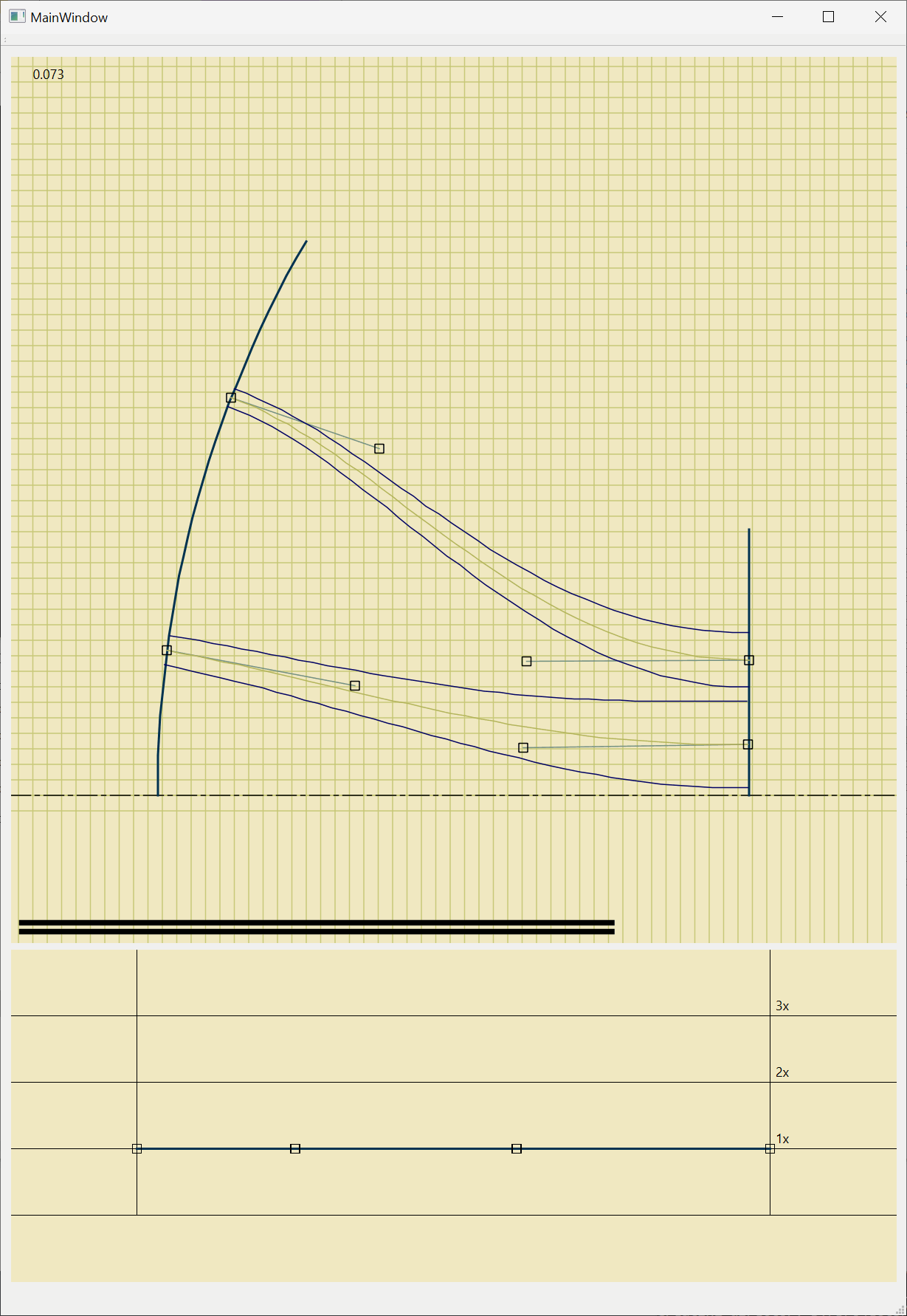

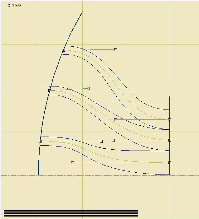

I think no expansion is the best expansion here. It means that the input area of each channel equals its output area, and that any horn with a smootly rising expansion (starting at zero) should be a good match. Of course that for a flat output wavefront the input/output volume velocities need to be the same for all the channels, but that's not difficult, I already have an implementation for that in the code.
looks good with the beziers, but please consider keeping all channels exactly the same length by putting the middle ones more forward, this will help greatly with matching the channels.

They are already exactly the same length as shown. This is indicated by the black bars below the phase plug drawing.looks good with the beziers, but please consider keeping all channels exactly the same length by putting the middle ones more forward, this will help greatly with matching the channels.
- This is still just a quick and random try, no optimization loop yet.

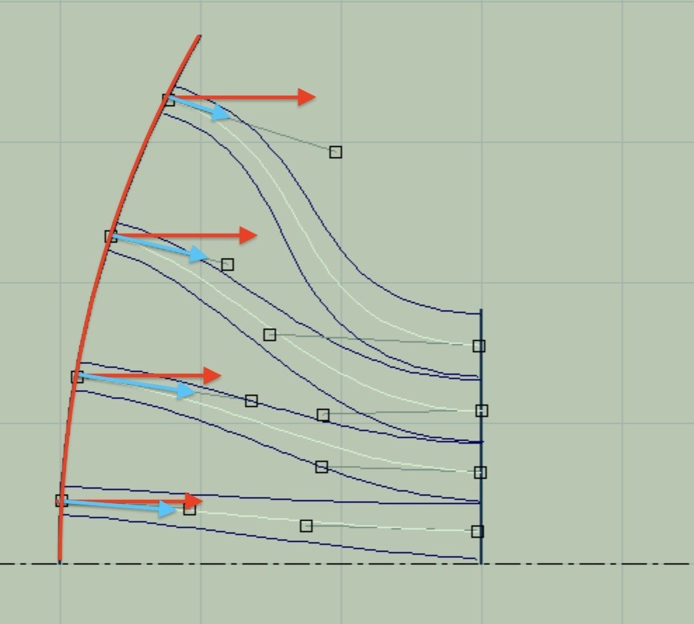

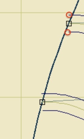

The entries are increasingly deviating from the wave direction for the ones closer to the rim of the dome - is this a problem?
I don't think this is a problem. I'm not sure about the suggested wave direction either - are the air particles actually pushed in that (red) direction? I don't think so, I thought about this and concluded that the radial direction is the more natural one, but of course I may be wrong. Will be interesting to see the sims, this can be easily tried out.
But there's no wave there even at high frequencies, just a change in pressure?The entries are increasingly deviating from the wave direction for the ones closer to the rim of the dome - is this a problem?
Will be interesting to find out. One see in alternative picture where there is a need to be a different entry...

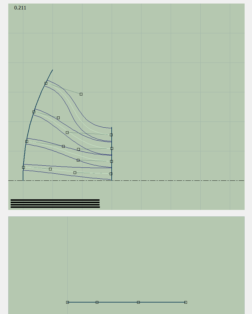

Once again, this is the area progression (the bottom curve) needed to have a straight-wall slot:
For the other (straight) slots it will be different. How is even possible to equalize the impedances of all of them? I'm really starting to think that the straight channels are flawed design from the start.
