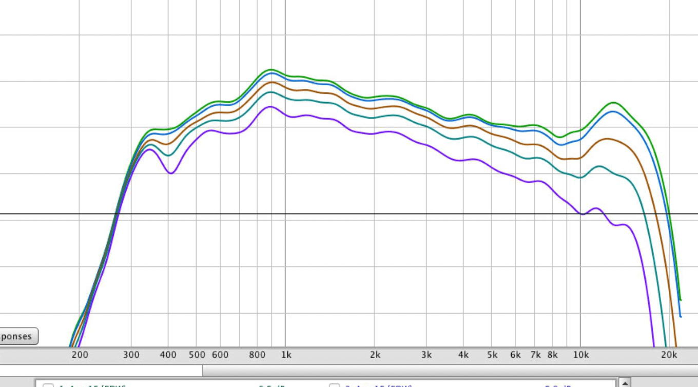

On and off-axis with RCF 940, at a distance ~60cm, FDW 6 cycles, 5 dB step, without EQ.
Looks like a good combination. The problem with such a measurement is that it doesn't necessarily reflect the actual source directivity and can be misleading, but of course it gives you an idea about the basic performance, which is so far very impressive indeed.
Would love to hear some big band 🙂

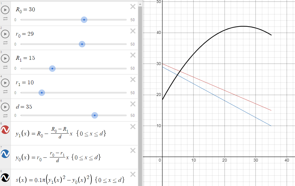

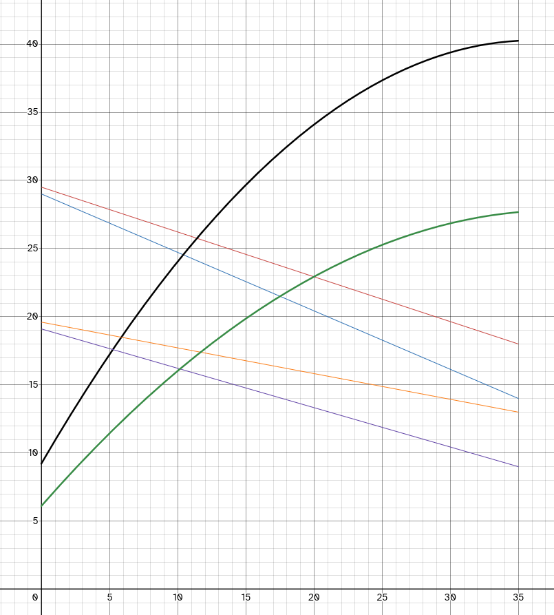

Regarding phase plugs, it's all pretty unintuitive stuff.
For example, the black curve is the area expansion profile of a single phase plug channel, if defined as shown. It actually starts decreasing towards the end of the phase plug. Overall, a straight-wall slot seems suboptimal.
https://www.desmos.com/calculator/yirxbis60w

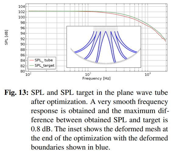

Now I wonder whether the area expansion has anything to do with these (numerically optimized) results:
https://www.researchgate.net/public...s_for_Acoustic_Elements_in_Loudspeaker_Design
- The algorithm used found some curved channel shapes, but it's not clear why exactly it is better that way.
Do I understand correct that the cross section areas of theese channels get smaller towards open end? That is.......lets call it difficult 🤔
Yes, the black curve shows the cross section area as a function of axial length of the channel.
(Actually, it shows 10x smaller value (mm^2), so it fits in the plot.)
Hard to predict by intuition, right?
I suspect that the phase plug in Fig.13 above will be better also in this regard.
I did some experiments with V-Dosc waveforming adapters. A shrinking cross section area was one of the most important things to avoid as is causes internal reflections which are visible in burst decay. Honestly no route I would go for; but surely interesting!

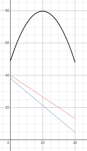

Maybe not all of them...Overall, a straight-wall slot seems suboptimal.
https://www.desmos.com/calculator/gaejztozmt
So is that optimal? I have my doubts - the rate still decreases, to become increasing again in the horn.
The issue is that the individual channels in such a phase plug will likely be different, even if the entry and exit areas are in the same ratio. How much is this a problem is not clear to me, but I supect we could do better. Another design tool is needed... 🙂
If I remember correctly I gave you some pointers on how to do this correctly a couple of years ago in this thread 🙂
I think with all the knowledge you have developed so far regarding running optimization with ABEC it should be quite doable to design a great working 4-slit phaseplug with lowish compression ratio (IE 1:4) and a nice wide HF opening angle

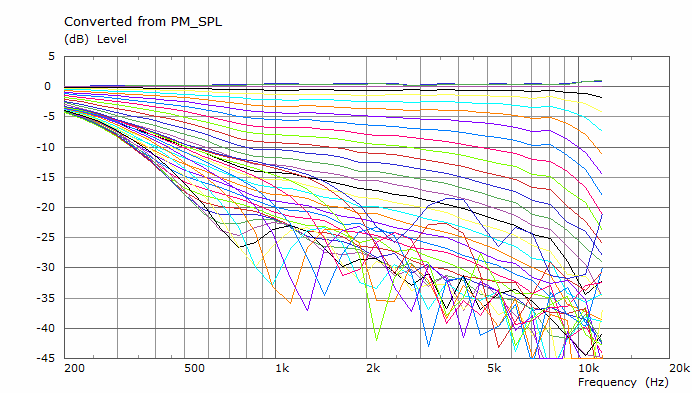

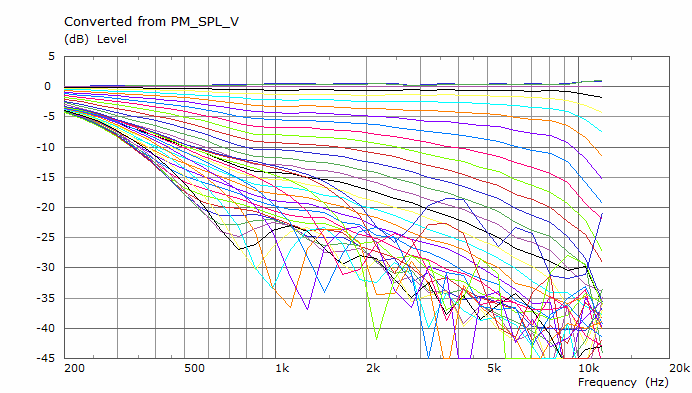

Here's a quick sim of the EXAR 400 scaled 1.4 : 1.My first try, I bought EXAR 400 files and scaled them to 1.4
Polars 0 - 180 / 5deg, normalized @10deg
