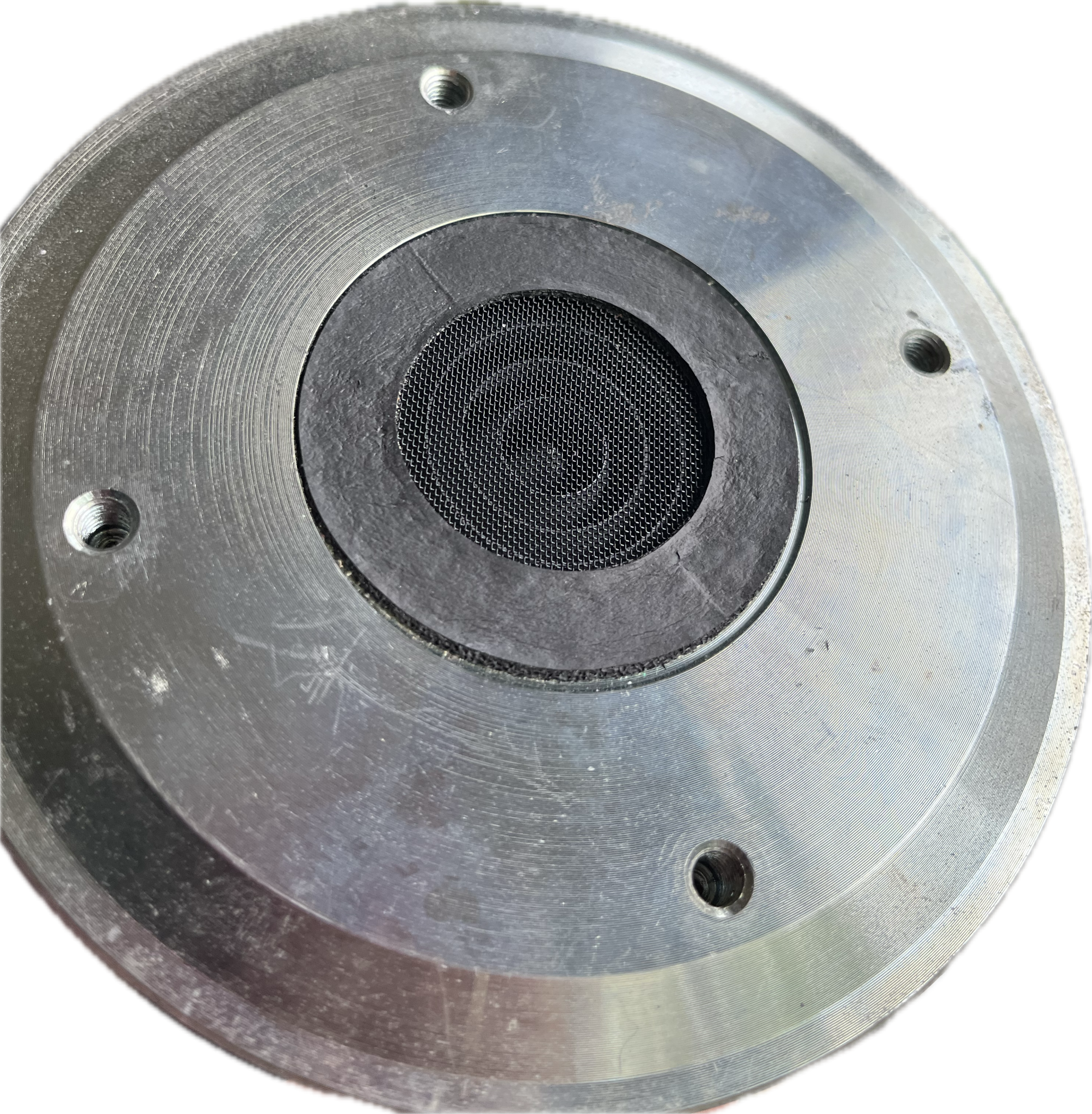

Does anyone know the exit angle of RCF ND940?

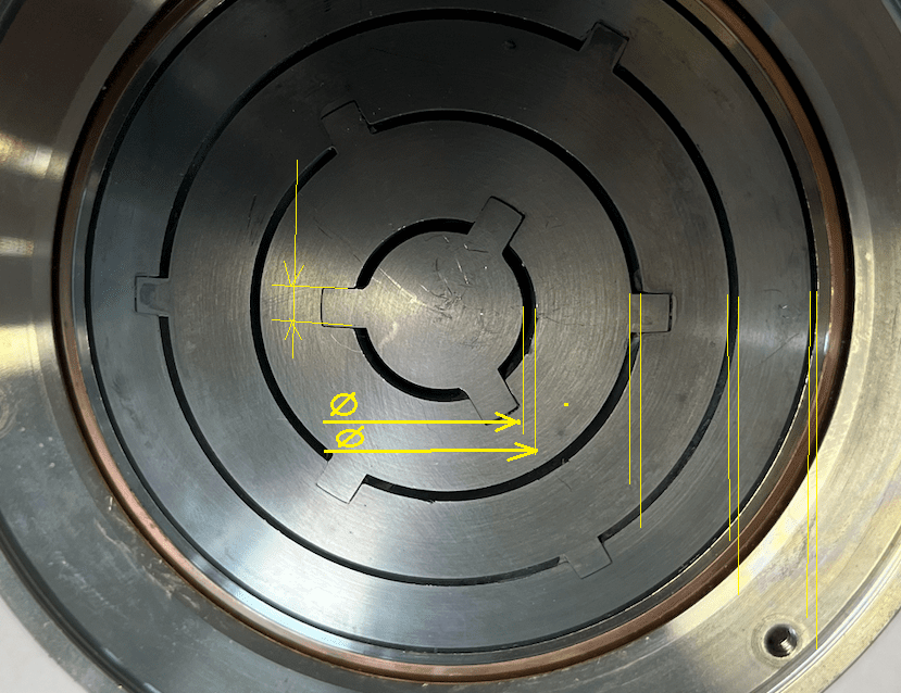

I haven't seen any information about exit angle of RCF ND940/950 (I think they are identical on this point). Is there any way to measure this? Just for illustration, this is what its exit hole looks like.
Thanks a lot, so the phase plug terminates at the very exit of the driver. Some would say hence the exit angle should be zero (assuming the wavefront to be flat), but I'm not really sure it's the absolutely correct way of doing it. Which leads back to the question what is the (total) expansion rate of the phase plug itself. There shouldn't be a discontinuity, IMO, if possible.
The response from the RCF was so quick 🙂
The request was about RCF 940/950For both drivers the exit angle is 0° (zero °).
That's probably true, but I don't think I'll get more detailed information from the company. Never researched how to measure this at home, maybe there are some methods, need to read up.but as I said, I still feel that's not the whole story
The basic estimation can be done simply by measuring the (projected) entry area of the slits and the length. And in a case that the phase plug channels have straight walls (i.e. conical, pretty often), this can be quite accurate. Certainly better than no idea at all. It means to open the driver, take out the diaphragm to reach the phase plug from the inside.
Nothing destructive, but it may need plastic calipers, or just a good paper ruler 🙂
Careful with anything magnetic near an open driver (!).
Now I'm a bit confused, those numbers seem strange. Maybe we didn't understand each other.
What we need to measure are the following dimensions:
The "length" should be the axial length (depth) of the open driver, it will be on the order of centimeters.
