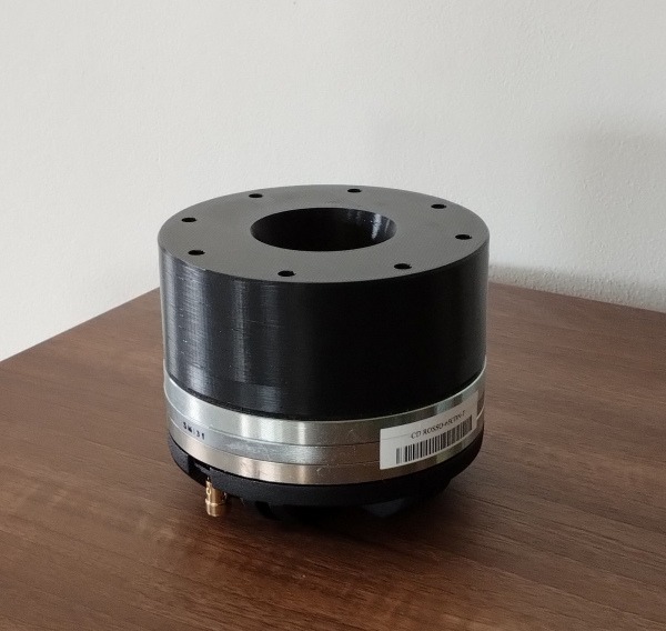

You can see the inner shapes of the adapters here: https://at-horns.eu/gen2.htmlHi Marcel
would you mind to explain it
Those are Bezier splines, simple as that. Of course always optimized via BEM, including the whole waveguide.
There's not a straight cone anywhere (anymore). As a result, the acoustic impedances seem more "polished", probably a good sign.

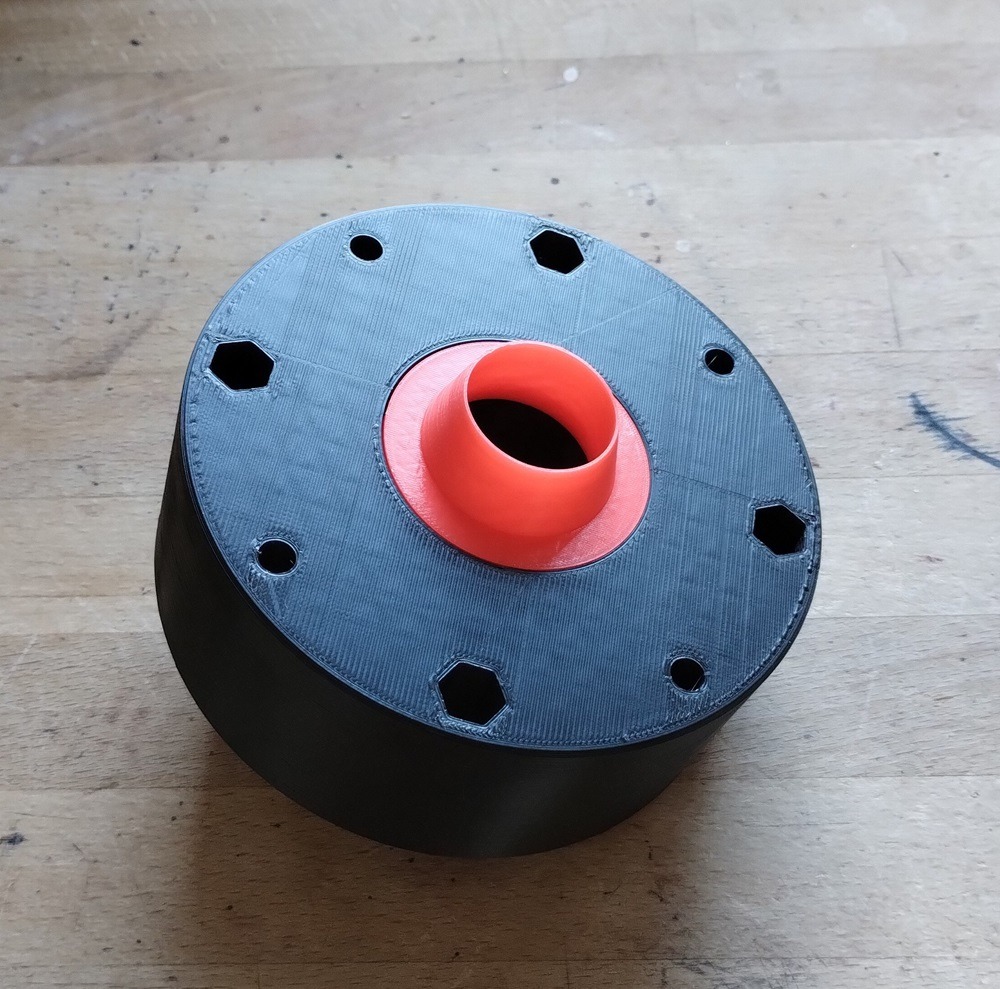

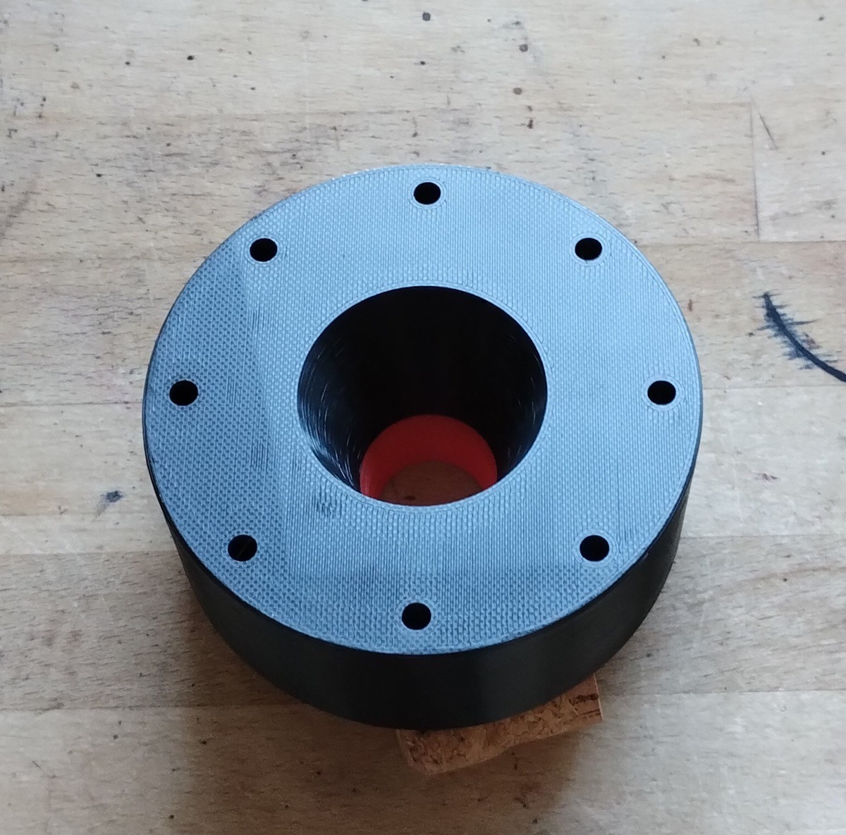

The "ROSSO adapter", right from the printers 🙂
(two different printers used, 0.6mm nozzle for the adapter, 0.25mm for the ring) -
I still only need to check it fits as it should, some adjustment still may be needed.
BTW, these are not supposed to be glued together. The ring should be inserted into a driver firmly (with a bit of a removable glue?) and then the rest of the adapter tightened to the driver with screws, over the ring (again, with some thin bonding/filling layer between the two).
So you dont have R-OSSE parameters for ATH A250G2?You can see the inner shapes of the adapters here: https://at-horns.eu/gen2.html
The common part (the main body) in combination with the standard 1.4" adapter make one pure R-OSSE profile - that's also how the basic performance is set. All the other adapters are then created differently - by connecting a spline to the common part, which gives a lot of flexibility. For those, there's no single R-OSSE curve.

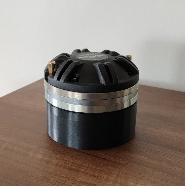

...and with the driver:The "ROSSO adapter", right from the printers 🙂
BTW, the effective throat diameter this way is 26.9 mm.

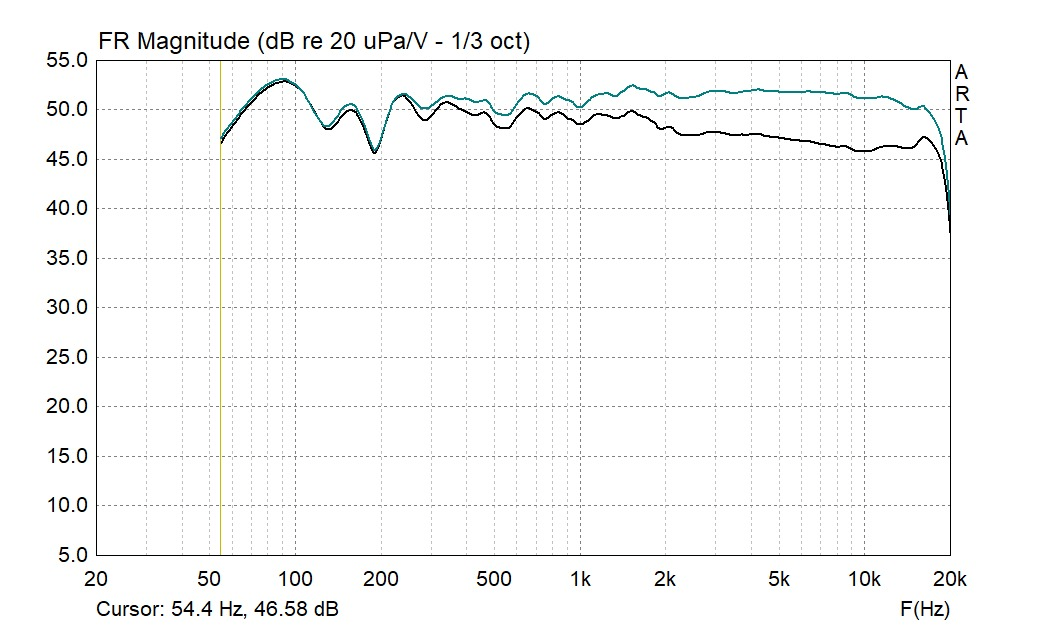

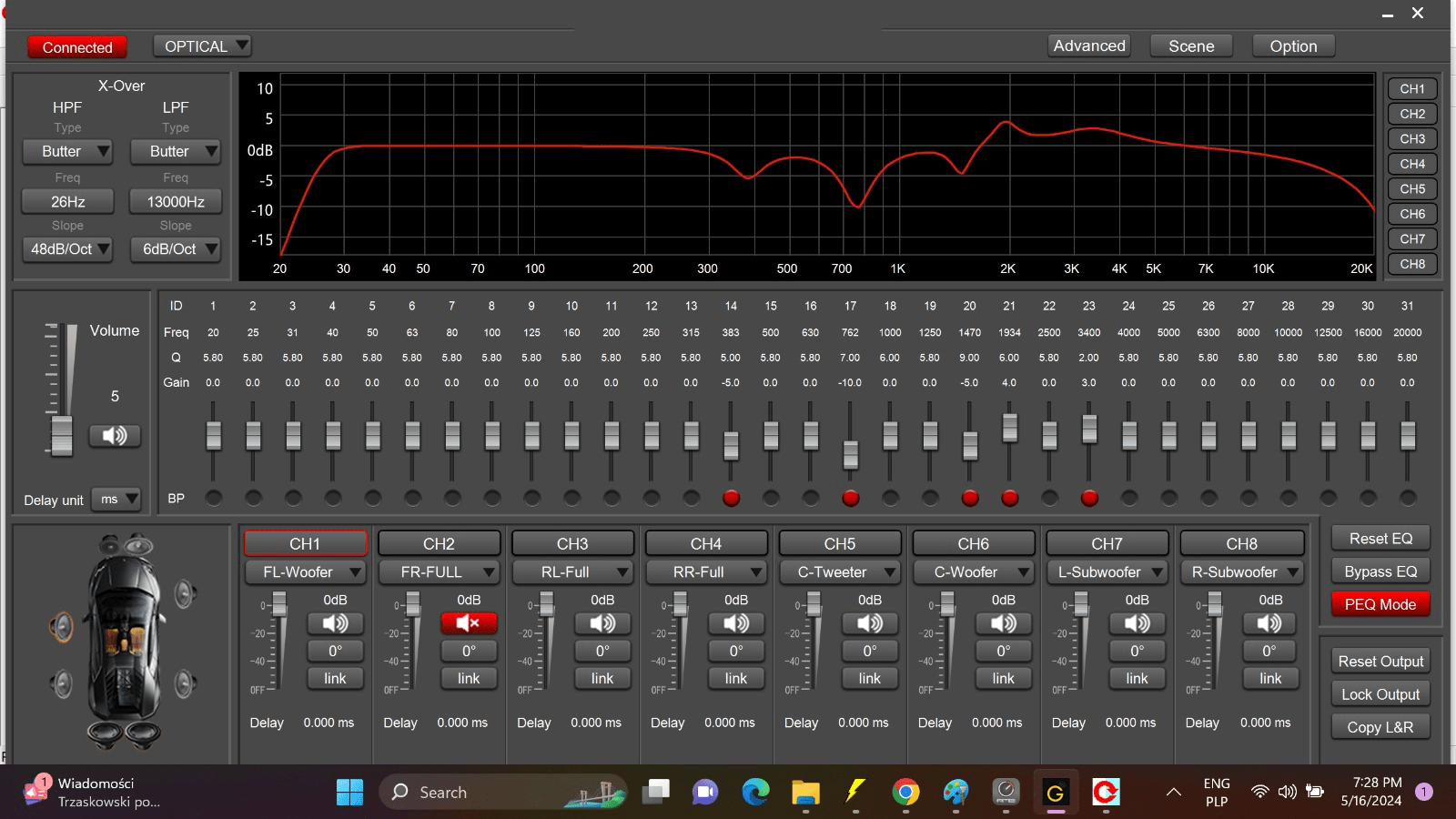

Hello happy builders. I'm testing Chinese DSP car amp that has 6 or 8 channels 150W with PEQ/GEQ and crossover/delay - total price shipped 269$ with measurement mic, BT and remote. I took my STH280 monitor and corrected passive crossover. Next I will remove passive and reprogramm again. You can store as many "scenes" (configs) you like. Phone app is nice. Optical input and BT. Thorugh USB you can use autotune but it has only 2 target curves and it doesn't correct as good as manual way.
Black is with HF lift made of 3x GEQ with Q=0.5
