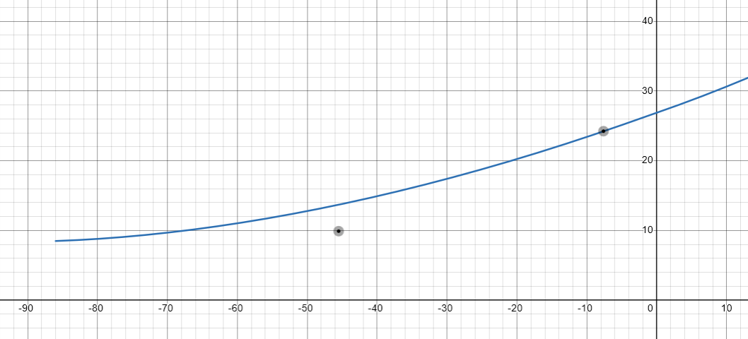

This is how an extension to a R-OSSE profile can be drawn: https://www.desmos.com/calculator/ph2ckhdurh
These parameters can be directly inserted into Ath and let ABEC to calculate it. I'll describe the procedure in some notes for my models.

Here's another version, a bit different appearance (showing one curve): https://www.desmos.com/calculator/pzbqxppjz2
(The split between the adapter and the waveguide body is always at x=0.)

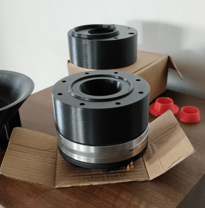

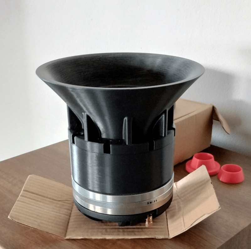

I have finished the ROSSO adapter. It's quite some piece of technology 🙂
(And I've just noticed that the phase plug is a straight-slot version...)

But there seems to be an "optimal" adapter for the HF10AK, including an inner ring, that looks like this (86 mm long):
As I don't have this driver at hand, would there be anyone who has the driver interested and also willing to participate in development of the adapter? This would mean to measure the driver as accurately as possible, 3D print a prototype and test it fits as expected.

HF10a: do not own one but was on short list for a long time. If no one else says " I want to" until tuesday I will order a set of them to do it. Monday is holiday so would be here end of next week.

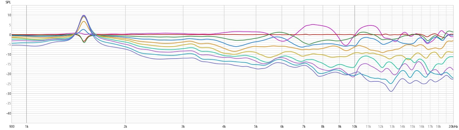

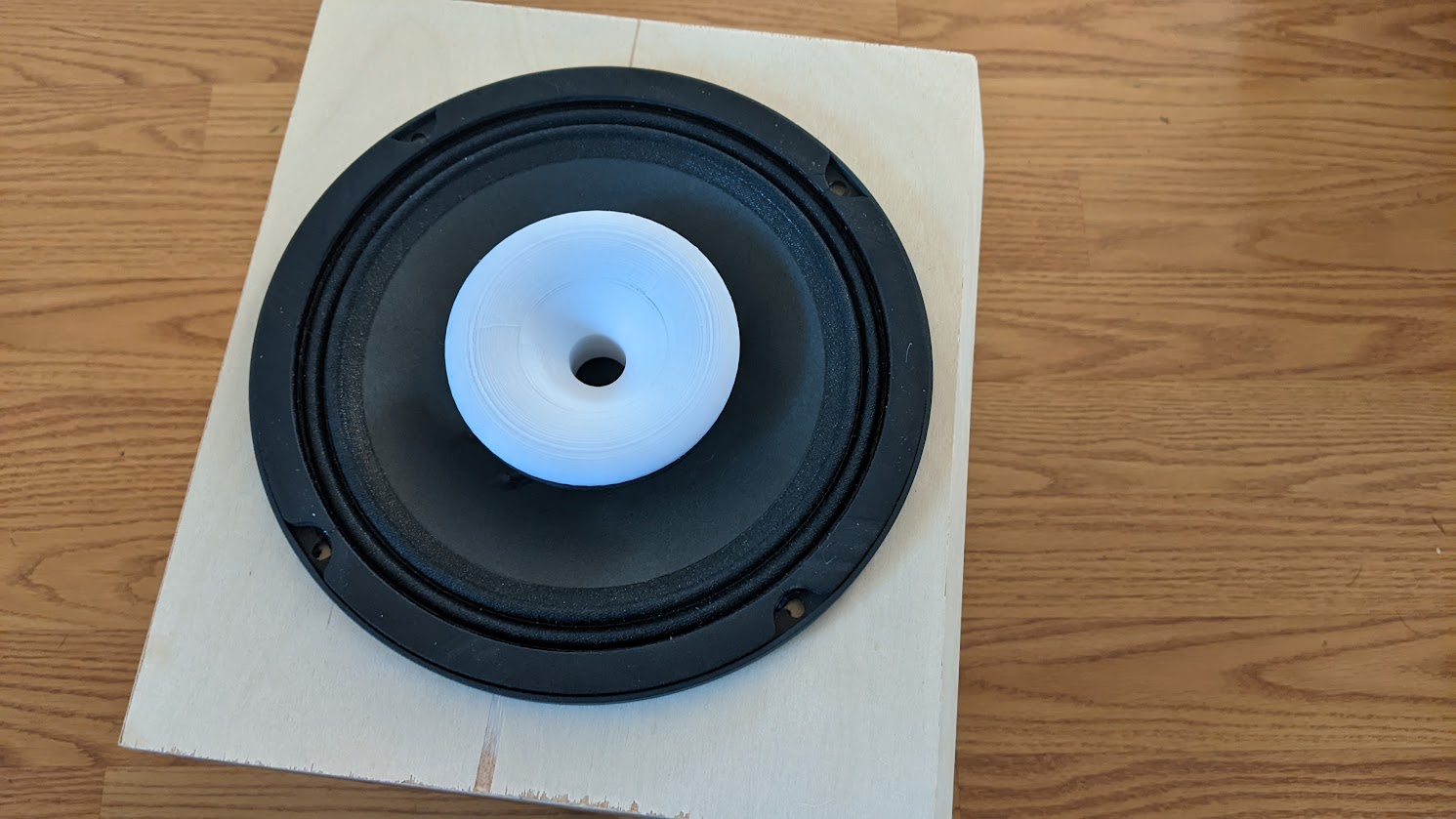

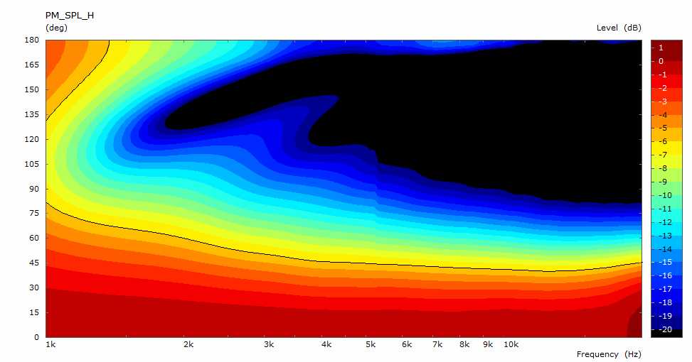

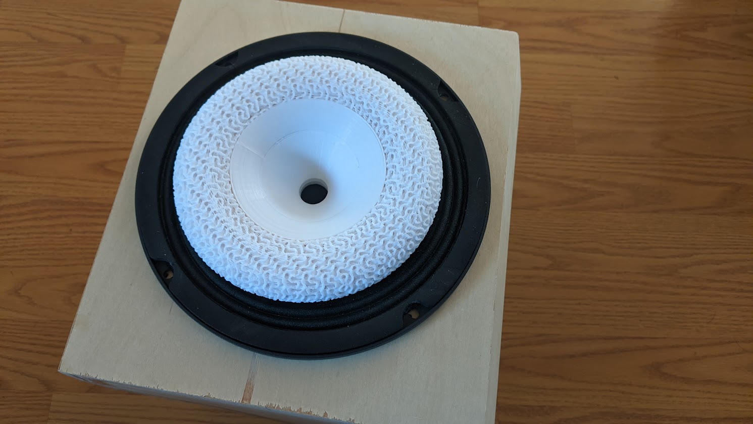

Here's an example of what not to do with a Coaxial horn. Did not model the horn in the coaxial woofer. Just winged it with two different sized R-OSSEs. The larger 6 inch horn mouth section was a gyroid 15% with no surface layer beyond a 90 mm diameter from the center of the horn.
Compression driver B&C DE111. Using a 18 mm diameter tube from the exit of the phase plug to the start of the horn. No angle, just a straight tube. 83 mm long straight tube from phase plug exit to start of horn. Did not remove the factory horn, it's glued in. I inserted the straight sided tube inside the factory horn up to my 3D printed horns. The 3D printed horns were elevated above the factory horn but as close as possible. I thought I would at least get smooth polars above 5k even if everything else fell apart but nope. My intuition did not match reality.
I wanted to 3D print an OSSE as well for comparison but got impatient and wanted to start measuring to satisfy curiosity. I'll save OSSE for a simulation that includes woofer cone and enclosure. And I might simulate the OSSE without the woofer using a flat surface over the woofer cone that I'll convert into a 10% gyroid, same size horn as factory but transitioning to a 10% or even 5% gyroid over the woofer portion.

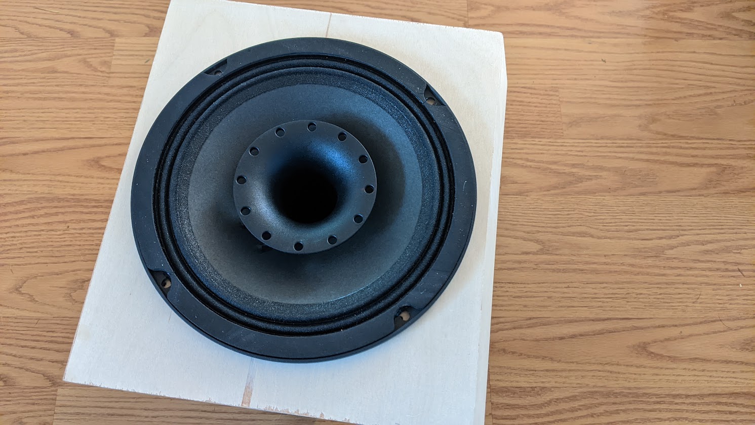

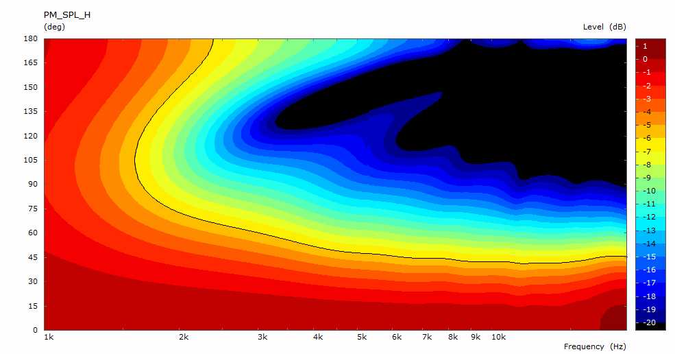

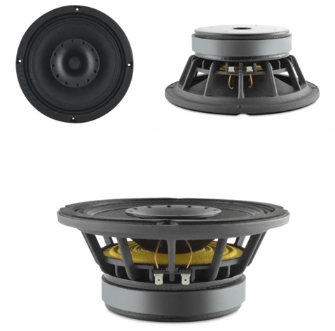

Sica 8C2CP 8 inch coaxial

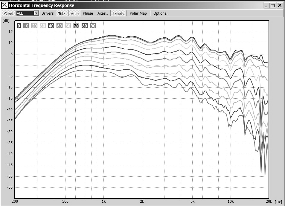

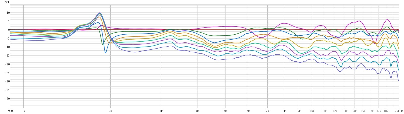

Factory designed horn. Normalized 10 degrees.

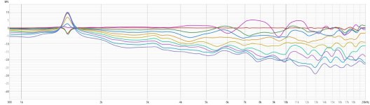

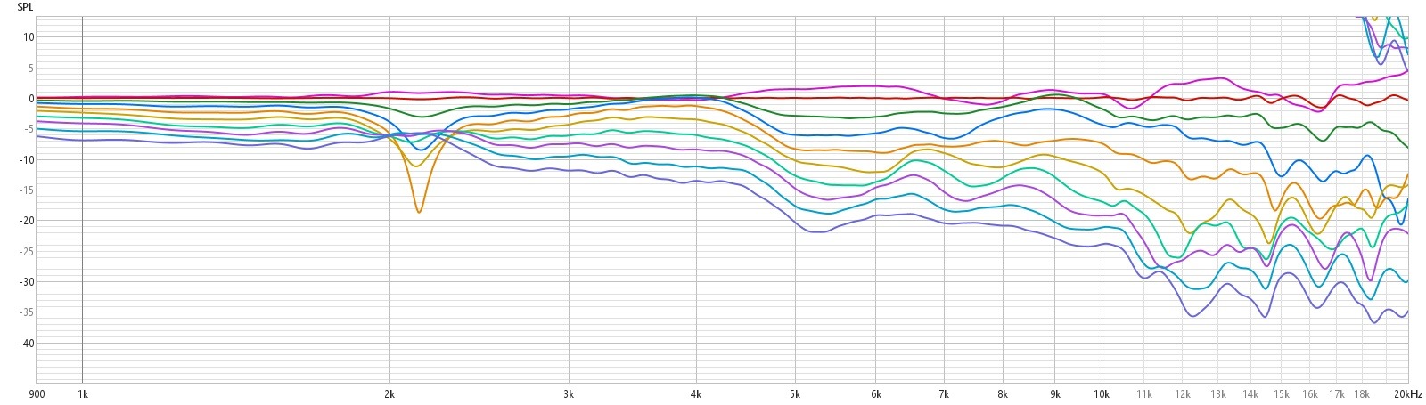

3.5 inch R-OSSE, with horn simulation in free space, not with woofer cone or enclosure. Normalized 10 degrees
6 inch R-OSSE w/ Gyroid Mouth, with horn simulation in free space, not with woofer cone or enclosure. Normalized 10 degrees

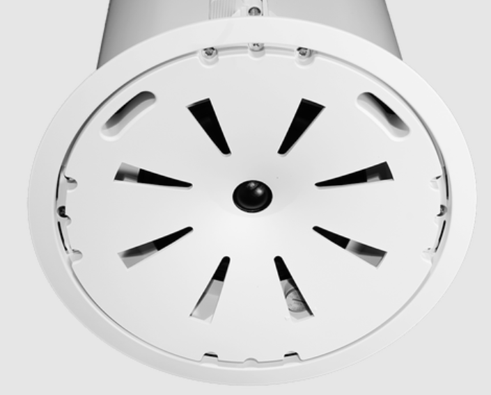

I never liked the concept, so it's hard to recommend anything. I think that if you strive for coaxial, a multy-entry solution would work better. You're almost there, just make the waveguide bigger and cut some holes 🙂
Exactly... why use manifold of mid drivers? Why not just put a WG covering the whole bass driver and open suitable holes in the WG?
Still working on how to implement the whole thing using a free-standing horn.
I like this - the waveguide suspended on strings and below it there's room for virtually anything.
