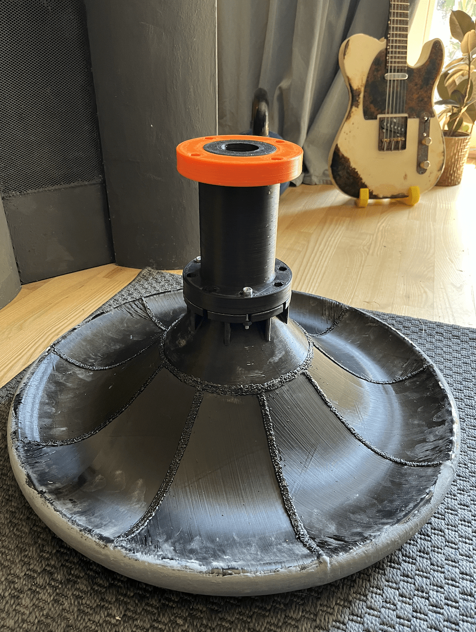

It looks like it could tip forward if unlucky... otherwise a really nice and airy solution. The "strings" I don't understand...Still working on how to implement the whole thing using a free-standing horn.
I like this - the waveguide suspended on strings and below it there's room for virtually anything.

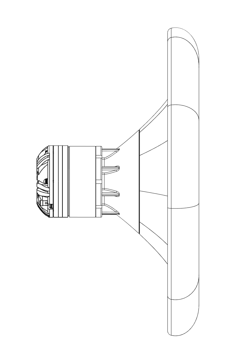

Looking at the G2 stuff for the ROSSO, its total "depth" incl. CD will be: 174+46+54=274mm?
That's correct.Looking at the G2 stuff for the ROSSO, its total "depth" incl. CD will be: 174+46+54=274mm?

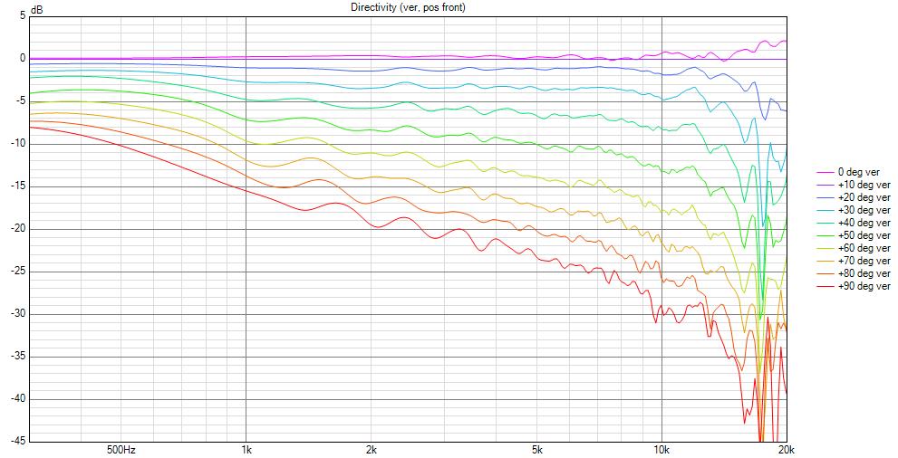

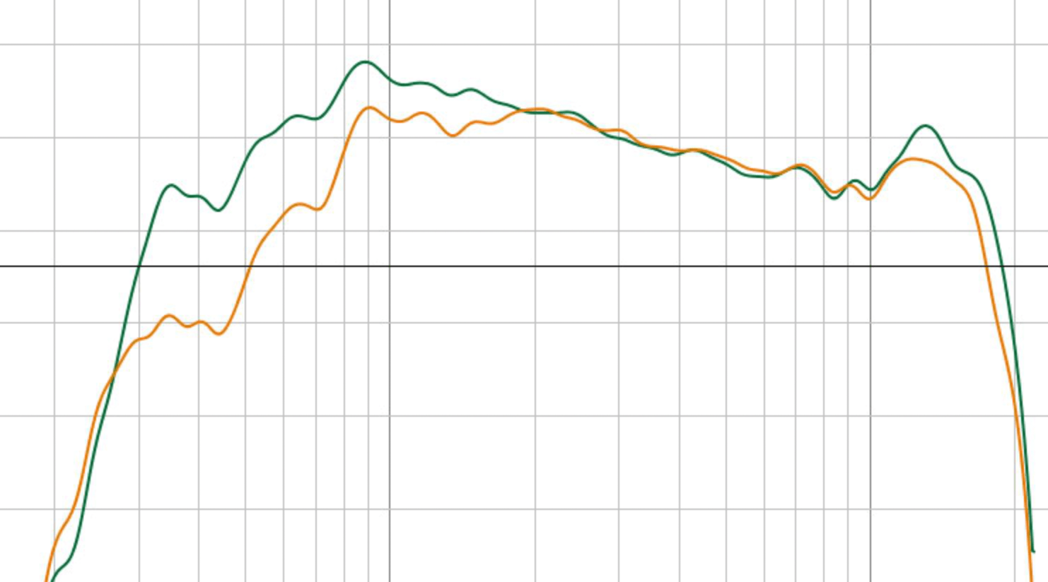

...normalized @10deg:BTW, today a measurement of the EXAR-400 with B&C DE500 was posted on a local Czech forum:
I believe the A520G2/25-EXT would still have an edge but we need to wait 🙂

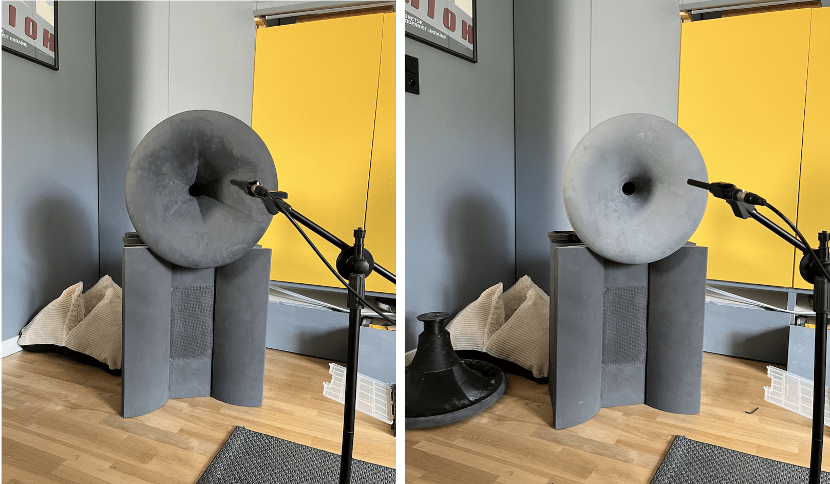

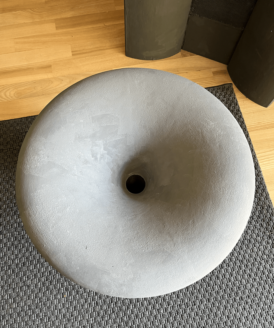

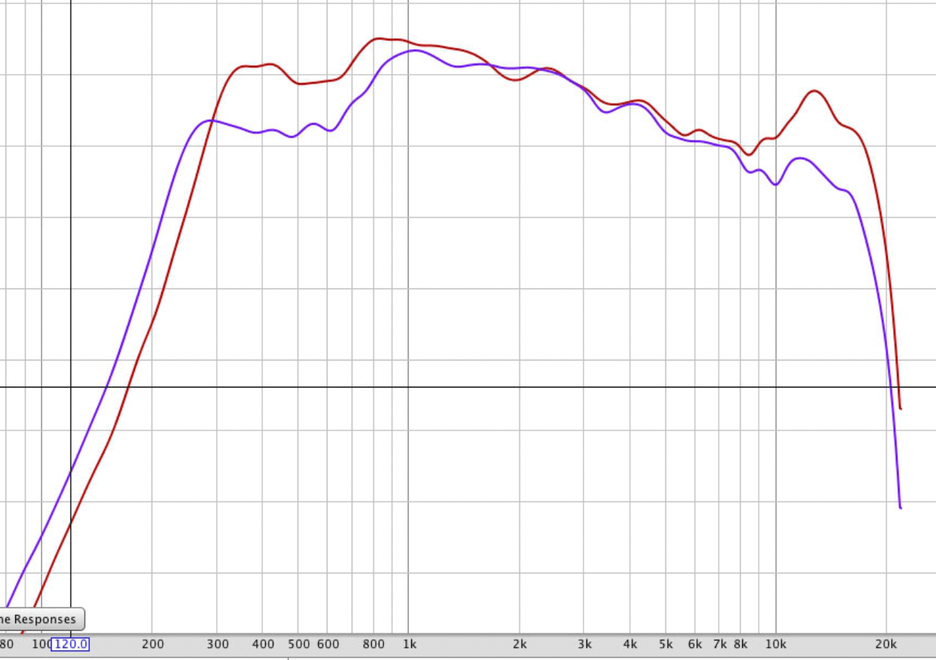

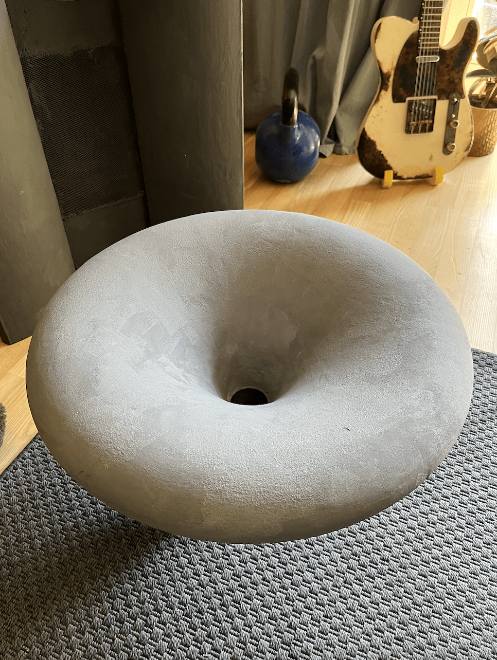

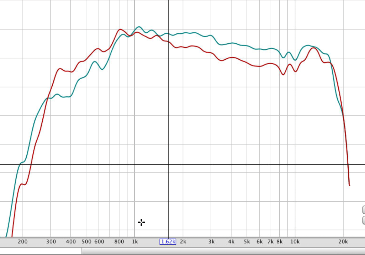

Gen2 with T520-36-EXT-1 + RCF 940 drivers, fast and dirty measurements (5 dB step, 10 cycle window):
And... this is a comparison to my upscale (red graph) version:
Thank you very much, this is indeed valuable.
Are the SPLs in the comparison supposed to be directly comparable? I don't quite understand why there should be such a big systematic difference above 2 kHz, as the beamwidths should not be much different. Also, the LF extension would be somewhat dissapointing, compared to the upscaled EXAR version. This is indeed interesting, and as always, suprising to a degree. The EXT-1 just came out from the simulations as very smooth, but perhaps it's not the best solution for a maximum LF extension (although the throat impedances should be close, I will check that). That's the nice thing - a different adapter, closer to the upscaled version, can be easily tried as well - I will send you an STL. Otherwise, if measured without reflections, the G2 waveguide should be a bit smoother overall.
Could you perhaps measure it (once) close to mouth?
I also don't understand why there such a difference above kHz... the measurements were taken from about the same point just with a change of horn. But I have to check it again, now I'll eat my ramen and do another set of measurements, I'll post a report later.Are the SPLs in the comparison supposed to be directly comparable? I don't quite understand why there should be such a big systematic difference above 2 kHz, as the beamwidths should not be much different.
As for the levels, to be comparable, you should have the mic the same distance from the driver (at least on axis). The more so if the whole distance is not very large.
But maybe it makes sense, as the "tubular" part of the EXT-1 doesn't decrease the level as much as the conical part in the other one. Could it be 3 dB? I wouldn't have expected such difference.
It would be great to see the 36mm STD-1 adapter as well 🙂 Especially for a comparison of the LF performance.

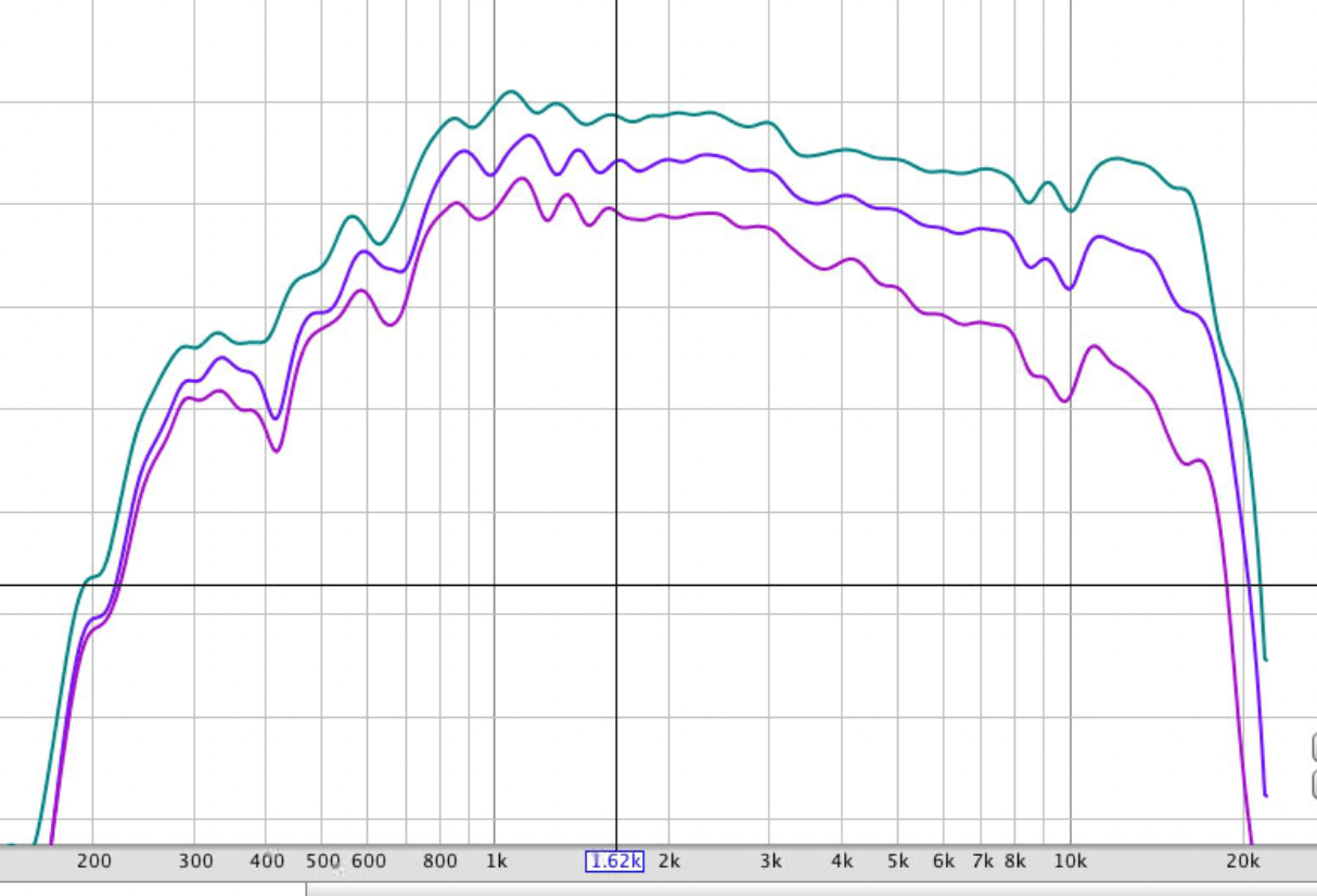

A bit less fast and dirty 🙂 Now it looks at least more logical:
distance of about 1 meter from the driver
It's about in the plane of the mouth maybe 3-5 centimeters deeper.
