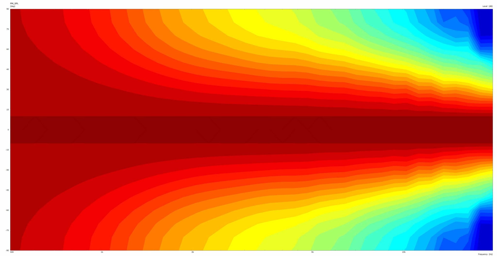

thank you @fluid, i finally got it running. SB26CDC dome in a waveguide with enclosure. Looks bad but you got to start somewhere...
Finally i can get into optimization. I really hope calculation time is quicker on my CAD workstation. This result took me 2h on a pretty quick laptop, but it seems to be RAM limited.

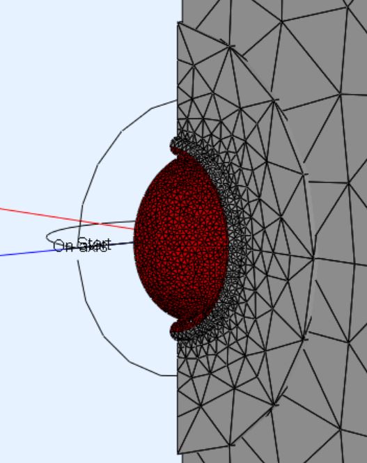

Are you able to use CircSym with a dome tweeter profile (ABEC.SimProfile = 0)? It makes processing a compression driver horn fast but I've never tried it with a dome tweeter source.
CircSym only works if the whole assembly is axisymmetric, right? Can´t be used if theres an enclosure involved.

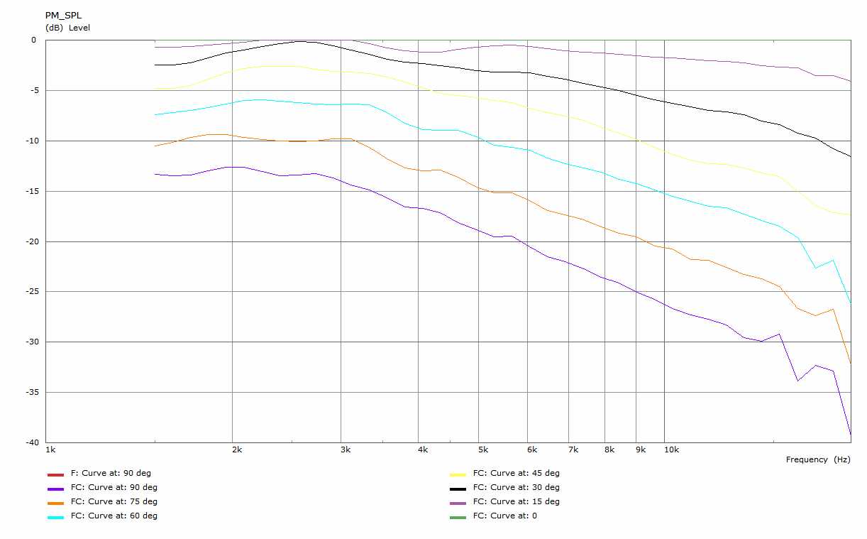

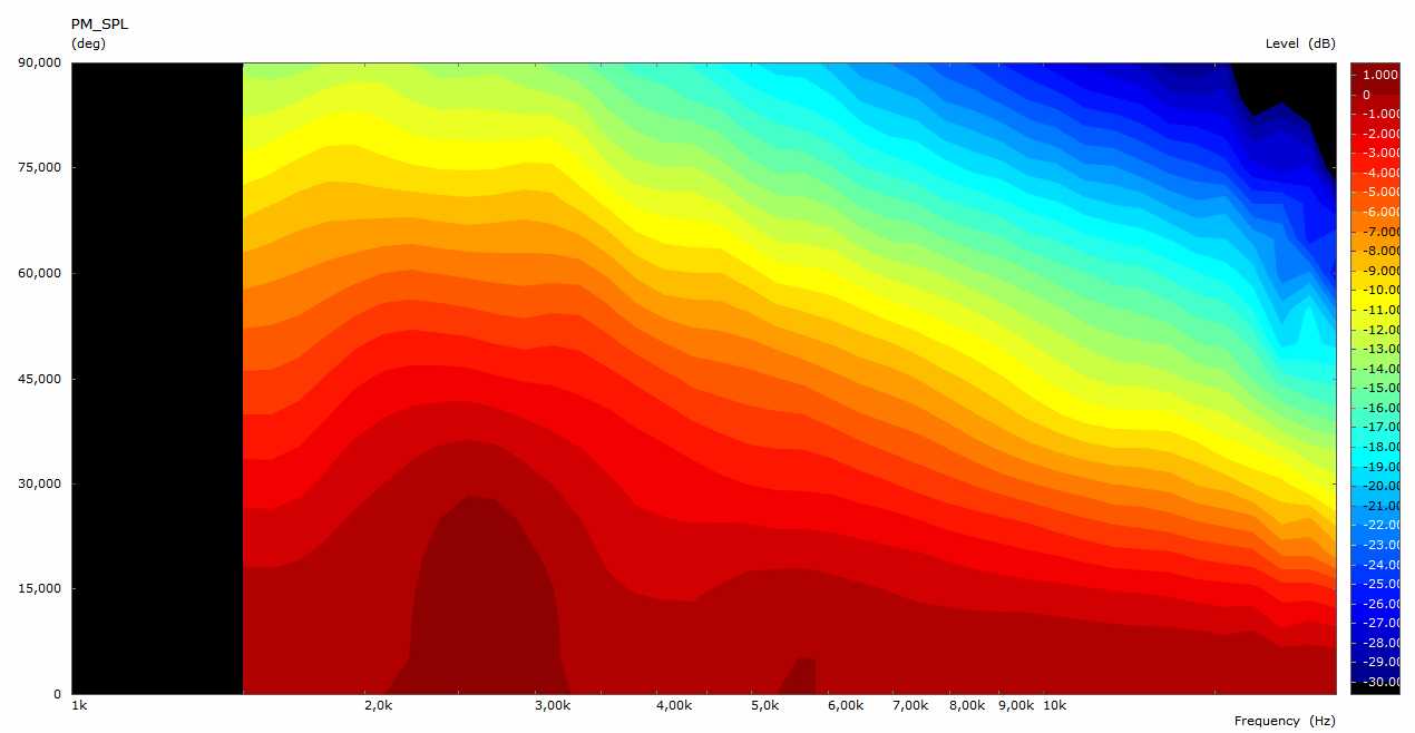

250mm wide waveguide with dome tweeter in infinite baffle normalized to 10°
my plan is to mate it to a 10" Paper Woofer at 1300 Hz
I have yet to find a way to reduce enclosure influence/randomness
Learning loads since simulationfrequency was increased when using my proper PC. 68Gb RAM in use, almost never have seen that before..
