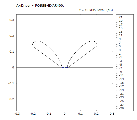

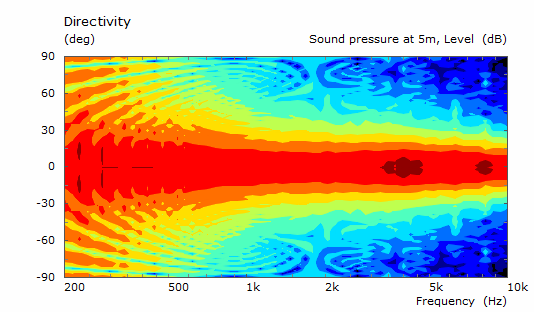

I was playing a bit with Axidriver and decomposed EXAR400 without conical extension because when added I'm getting mess.
Reactions: camplo

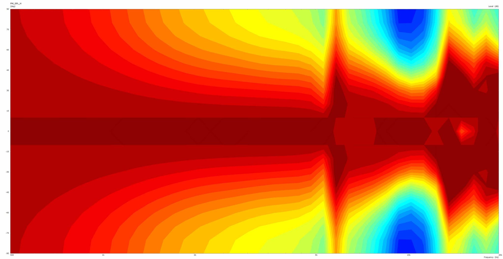

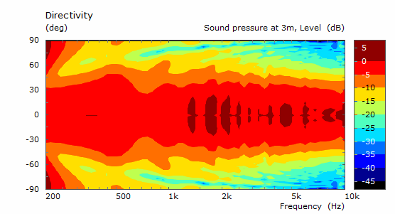

thank you @fluid, i finally got it running. SB26CDC dome in a waveguide with enclosure. Looks bad but you got to start somewhere...
Finally i can get into optimization. I really hope calculation time is quicker on my CAD workstation. This result took me 2h on a pretty quick laptop, but it seems to be RAM limited.
I'm a broken record on this one, but you can get fourteen core Xeons for $20 on eBay and the RAM is nearly free. I'm personally using Dell T5810s, I have four of them.
I have a $2500 Macbook and a $2500 Intel laptop with a 2023 CPU in it, and my seven year old Dell T5810s blow them out of the water for this stuff. Quad pumped DDR4 ram and fourteen xeon cores might be very old, but they still obliterate laptops because Intel CPUs haven't progressed a whole lot in the last ten years, and laptops are inherently unstable because they lack DDR RAM and massive heatsinks. (Even a twelve core laptop will get throttled because the heatsink isn't sufficiently large; Macbooks are fast but running native is always faster than emulation.)
Reactions: VoxCelestial
i can second that. My CAD worksation is a 7 year old HP machine with one of those 12core XEONs and lots of ECC memory. I paid 400 € for that thing and another 200€ for a 1080TI and its so much better than pretty much any laptop i can buy for all things work relatet.
I stand corrected (maybe). Using your @CinnamonRolls Source Contour it looks very wild. I used the one posted by augerpro sometime ago before and it was a lot cleaner...

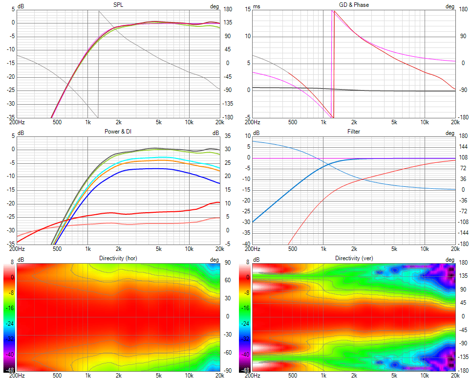

What is the current consensus for a compression driver to 1,2 kHz looking for clean response and use with a passive crossover bestcase scenario? 😛 Long term goal is to go MEH but would love to built a 2-way first.
Have a good new year everyone!

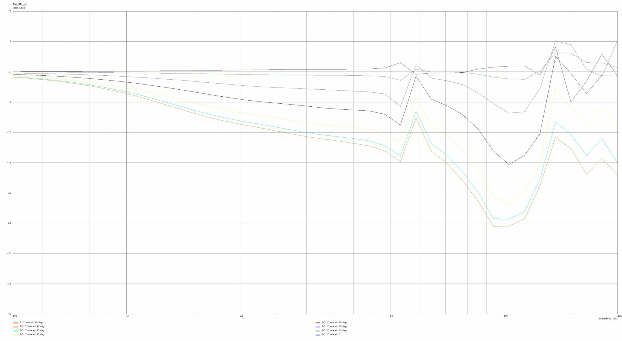

Reactions: CinnamonRolls
Wow. My measurements are way off. My dome is a full millimeter taller + 3 mm narrower and my surrounds were 0.5 mm taller + a full mm wider. Also, I didn't know how to deal with the foil piece/glue because it's at 26mm O.D. and is raised up to the top of the surround with the dome inside the cylinder. For simulation, it looks like it's better to ignore the foil piece and widen the dome. Glad @zangg tested it against a better model otherwise I wouldn't have learned.
Thanks for the model, @fluid
