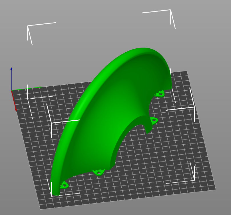

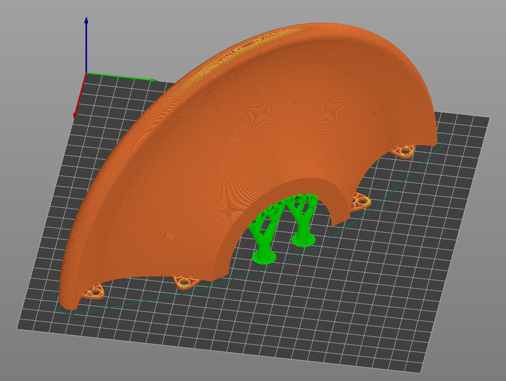

Yes, the bounding cube is 205 x 205 x 140 mm. Very little of supports needed.Beautiful. I wonder if the 280mm geometry would allow it to be printed as a 1/2 diagonally across the bed of my very basic Ender 3 pro (with a 220mm x 220mm print surface - with a hypotenuse of 311mm).

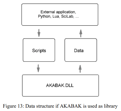

I got info from Joerg Panzer, the author of ABEC and AKABAK, that the import function in AKABAK should improve with some following version, so I expect it will be possible to use Ath with AKABAK smoothly. He is definitely aware of Ath existing.
The planned implementation of the BEM solver alone as a library is also quite exciting. I could then finally imagine Ath as a GUI application with the solver incorporated (including an optimization, etc.) -
- There are probably other, even open-source BEM packages that could be used. I just never got into any of those, as ABEC worked so well for me from the beginning. Honestly, I slightly hoped that someone else would do that in the meantime.

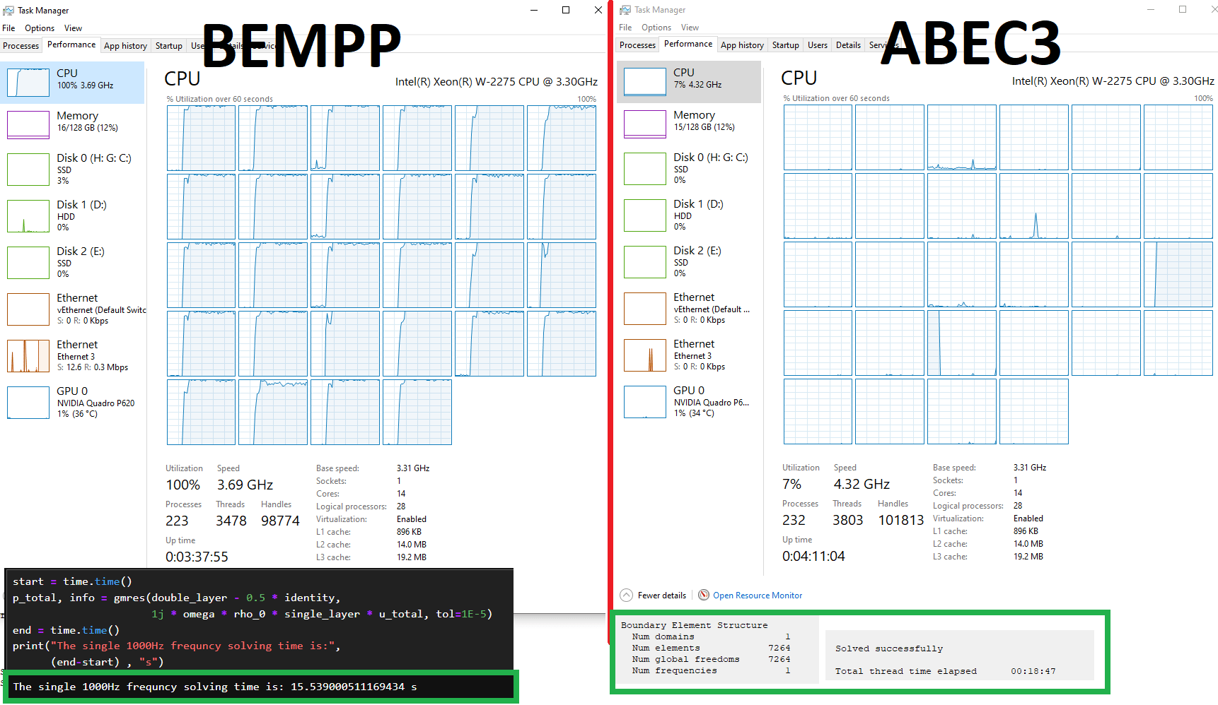

I performed a quick benchmark BEMPP vs ABEC3 using the loudspeaker form BEMPP loudspeaker tutorial. I modified original GMSH geo file to increase the mesh density
Mesh.MeshSizeMin = 0.003;
Mesh.MeshSizeMax = 0.01;
The both benchmarks were run for single 1000Hz frequency. It seems that BEMPP uses much more faster solver (iterative GMRES) than ABEC3. It took ~15.5 s to solve the problem on my 14 cores workstation in BEMPP. Whereas ABEC3 spent approximately 1127s to solve the same problem. It should be noted, that ABEC3 use single core to solve single frequency, whereas BEMPP use all cores. For an ideally parallelizable problem, the BEMM should be faster only by a factor of 14 because my workstation has 14 cores. However BEMPP is actually faster by a factor of 73 ! Which suggests that BEMPP uses a much more efficient solver.
I'll try to figure out BEMPP settings to run the same benchmark on a single core for a solver efficiency comparison vs. ABEC3.
And bempp supports computation using a GPU via OpenCL 😀I'll try to figure out BEMPP settings to run the same benchmark on a single core for a solver efficiency comparison vs. ABEC3.
Would it not be more fair to compare over 14 frequencies, allowing abec to use all cores?
I suppose calculating 14 frequencies in parallel will take the same amount of time, or even a little slower, since the core clock speed in single-threaded mode is always higher than in multithreaded mode 🙂. But in general I agree. This was actually my first time running BEMPP. I need to read BEMPP manual to figure out how how to change a number of threads.
