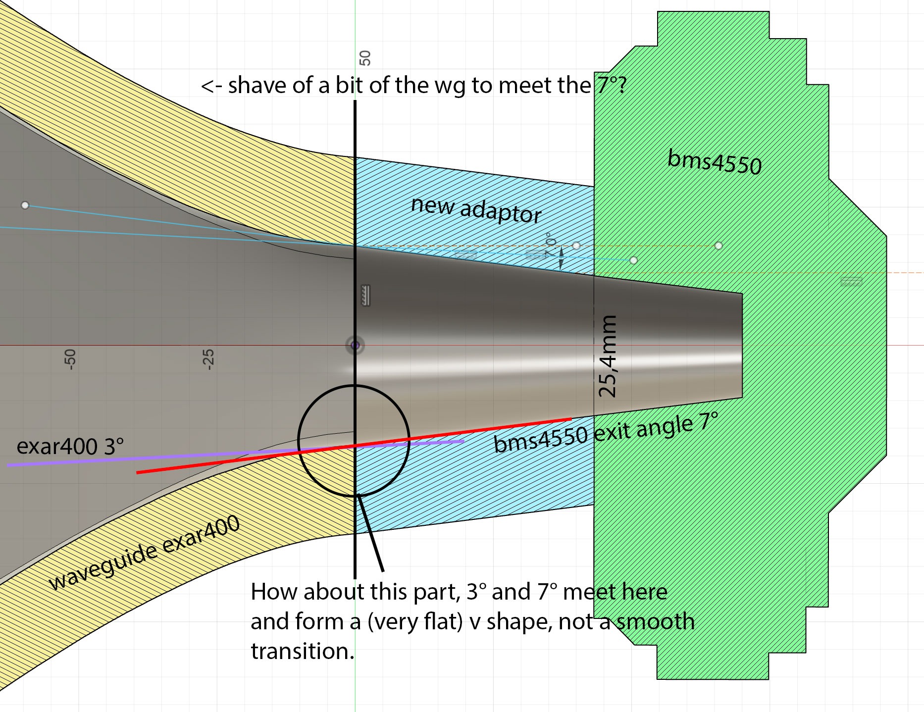

He guys, I am really curious about something; I have printed the exar-400-25 waveguide but made a mistaken, my BMS 4550 cd's have an output angle of 14 and the waveguide 6... I thought my drivers were 7 degrees so I thought it wouldn't be a problem if it's off 1 degree, but how about being off 8 degrees? Will this have a lot of negative impact on the performance?

Are you going to print an extension duct? If so, no problem.
I think the best approach is to take the diameter of the phase plug exit and start the whole WG geometry with a straight tube from there (can be made any length required). A piece of a spline (e.g. a cubic Bezier) can be used to connect such extension to an extisting WG. This should work well for any diameter of a particular phase plug, IMO.

No, the idea is to use the smallest initial diameter available - typically the exit of the phase plug, but it's driver dependent. For this you need an open conical section at the exit of the driver, and "replace" it with a tubular segment.Aren't you just seeking to elongate the initial throat section with a very steep wall angle?
This way you can make most of the 1.4" drivers to behave roughly like a 1", regarding the HF directivity. Or you can improve upon the HF response of a 1" driver (that's what @CinnamonRolls did, as far as I remember; or analogously for any other nominal exit size )
My concern is mostly, that if I am drawing a new adaptor plate for the wg, the initial start angle of the wg is still 6° instead of the exit angle of the cd.
I tried to visualize this to make it a bit clearer. What could be done is to shave of a bit of the wv throat until you meet the required angle but this is not a very good solution I think...

I think that the extension could be longer, at least it seems to me it's quite a bit shorter than the original. I would make it longer and then wouldn't worry too much about that angle mismatch. It's not so big.
It would be easier it the entry angle of the waveguides was higher, of course. This is what worked so well, so I left it as it was.
