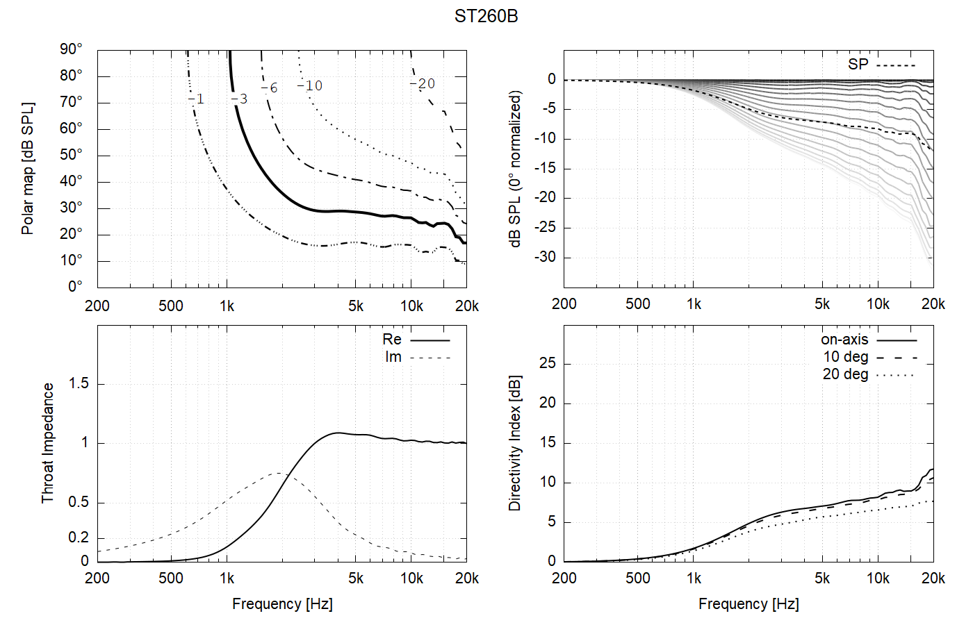

I was hoping to use the ST260B as a starting point (flush mounted system) and match the throat angle to my compression driver's exit (BMS 4550) and also experiment with squashing the waveguide into slightly non-axisymmetric shapes for C2C space reasons.
Did you ever end up sharing the definition file for that one? I tried to use the search/filters extensively, but have not been able to find it.

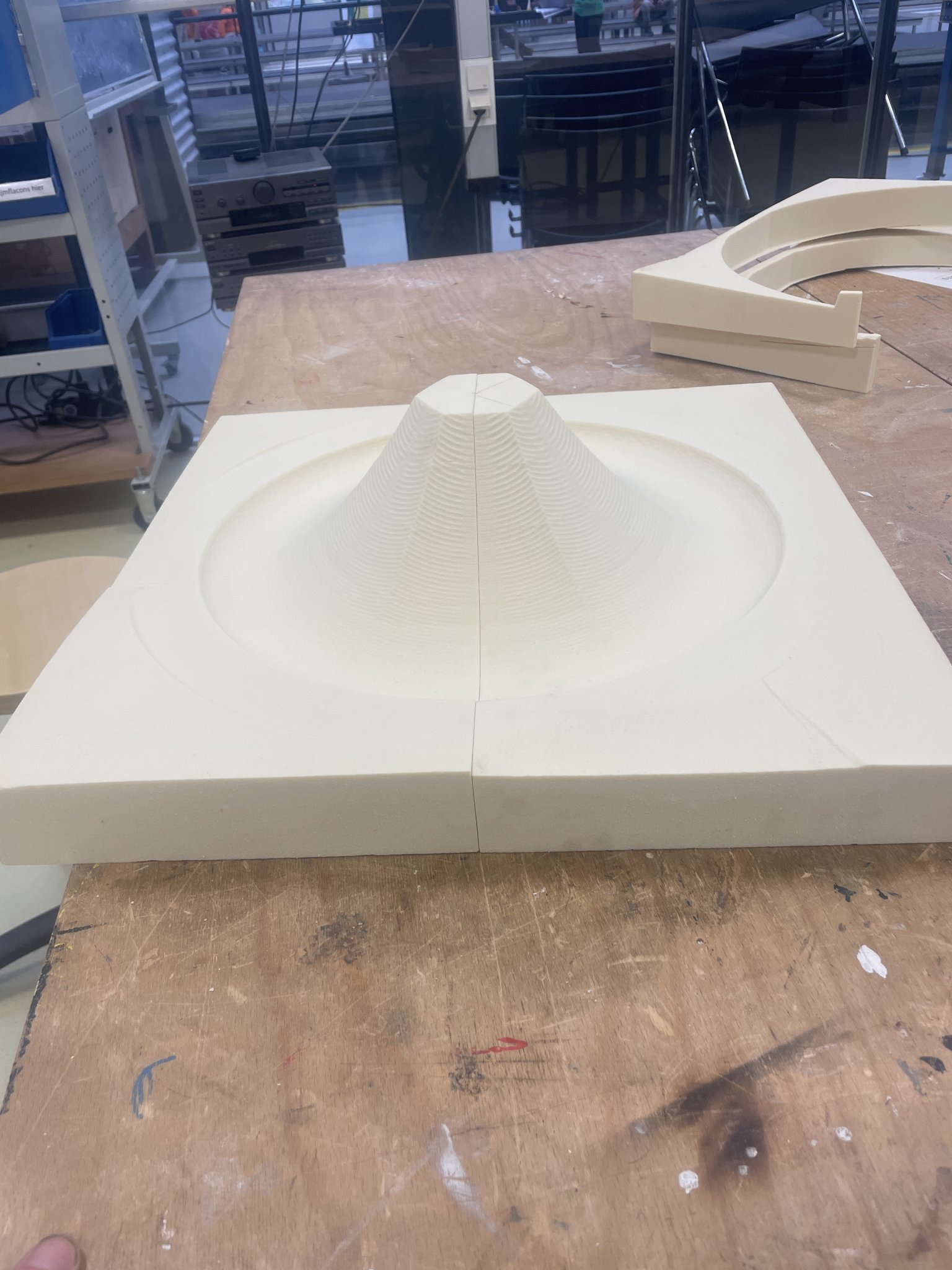

Mold for making the horn out of fiberglass almost finished

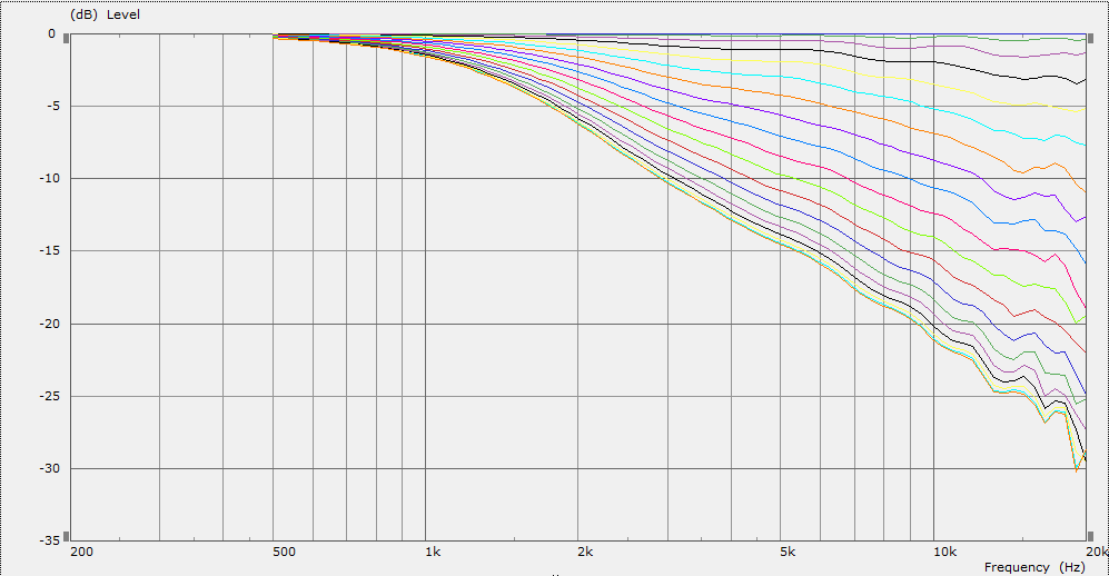

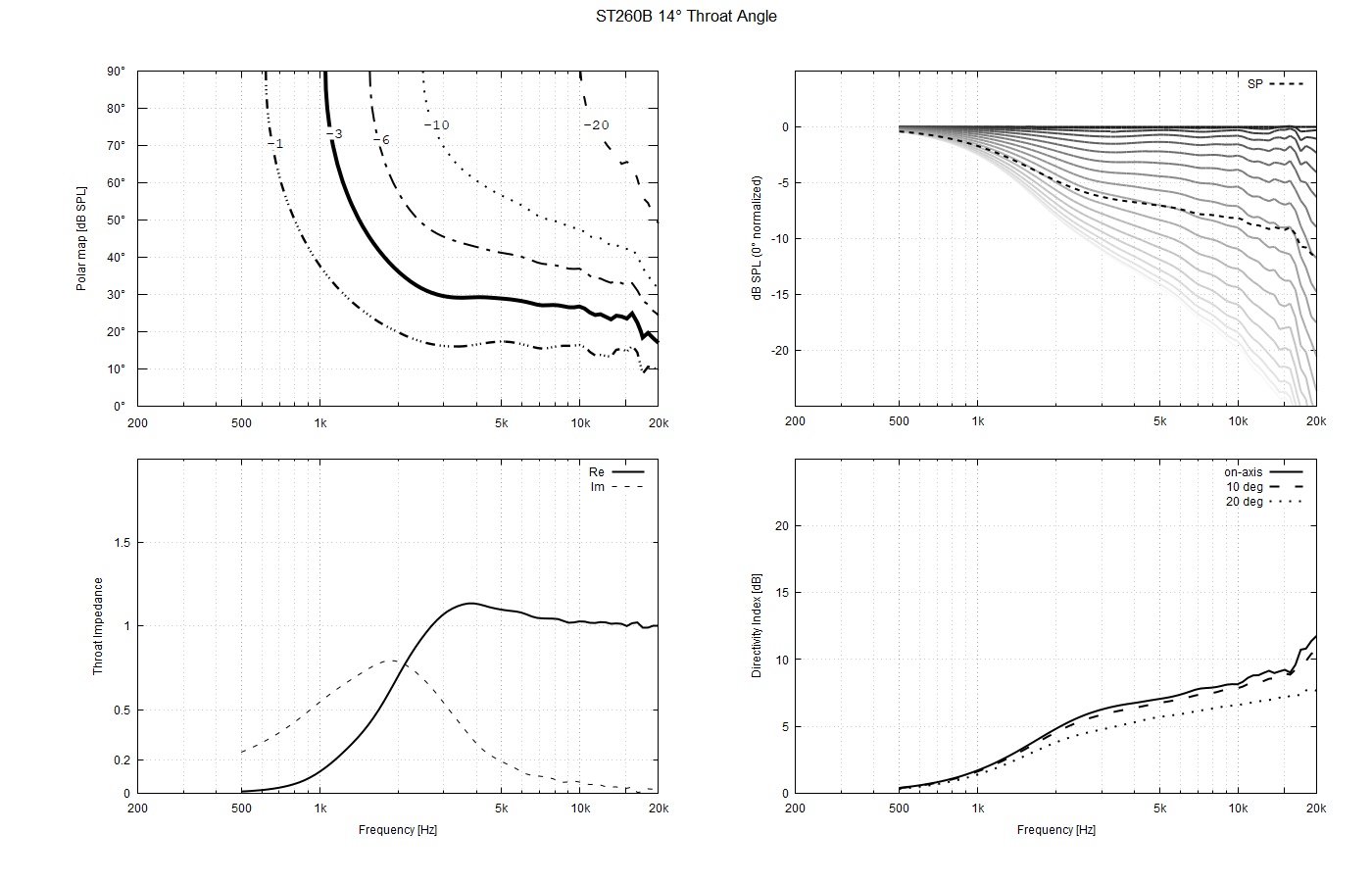

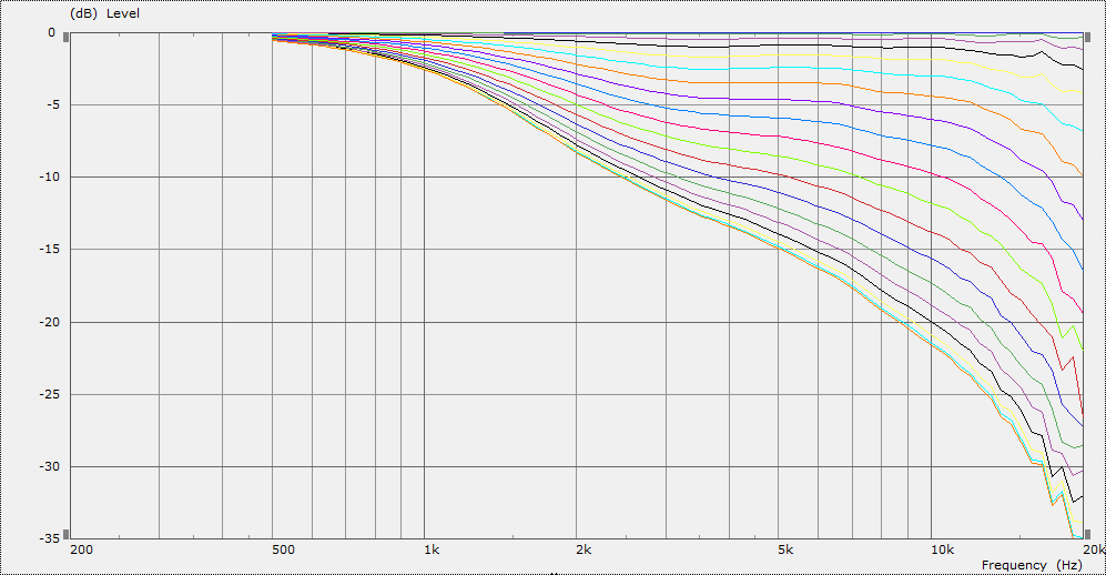

@mabat I actually found the parameters - you shared them in post #9,135. It seems to work fine as OS-SE.

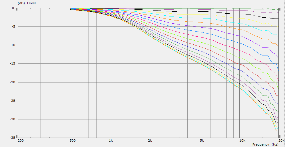

Attached are some sims with the modified throat angle and also one with an elliptical mouth with roughly a 50° coverage in the V plane, along with the original you posted for comparison.
Nothing to worry about directivity-wise, IMO. The speaker-to-room path in my room is nearly anechoic.
It's hard to say whether the increased jaggedness in the modified version is due to the actual horn behaviour or different ABEC settings.
What I am interested in optimizing, however, is diffraction in the device. I know there seems to be a trade-off between diffraction and beaming as shown in this post #11,252 by @tmuikku for example, but I don't fully comprehend the mechanism of that trade-off.
The use case here is critical listening in a very dead room and so the power response basically holds no weight. I'd be happy to trade a bit of beaming for increased smoothness/cleaner time response.
The examples posted by @mabat and @tmuikku around #11,252 are using R-OSSE and tweaking the parameter tmax, which of course isn't applicable to OS-SE, which is what I'm using because the system is to be flush mounted. "Sound around the device" is also not at play in this case, of course.
Would anybody be willing to make the nature of this trade-off more clear to me and/or share some tips on which parameters to tweak in order to play with this in an infinite baffle situation? (if it's even possible 😕)

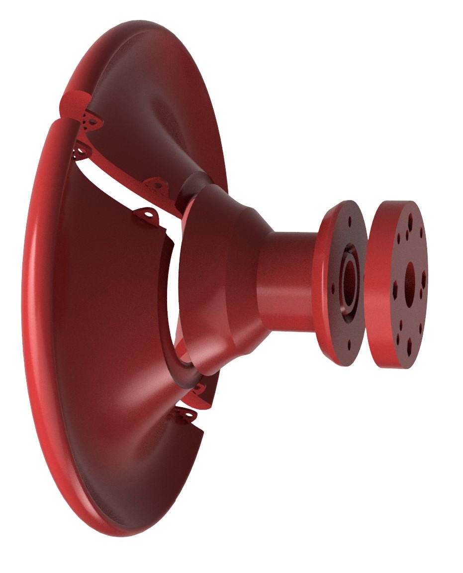

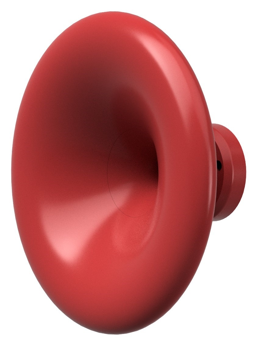

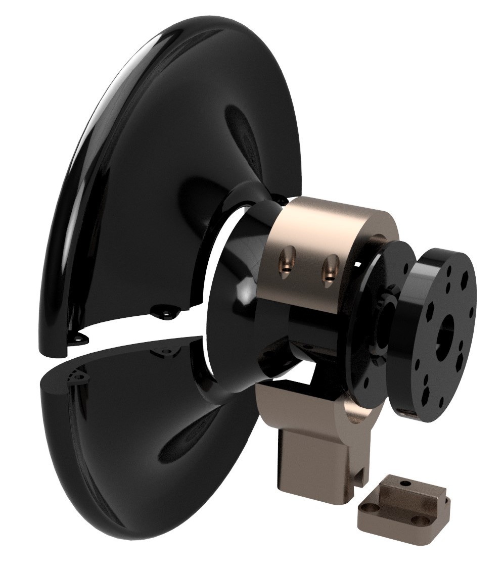

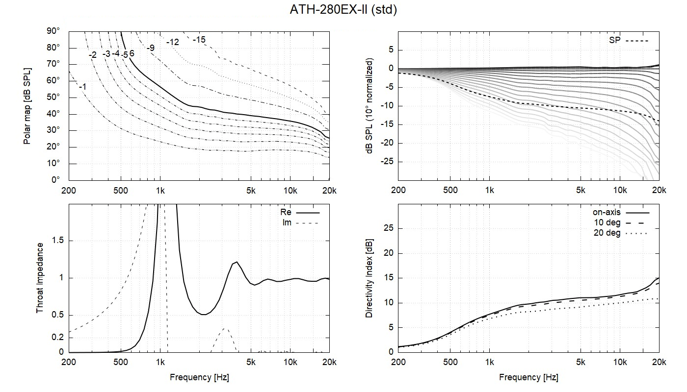

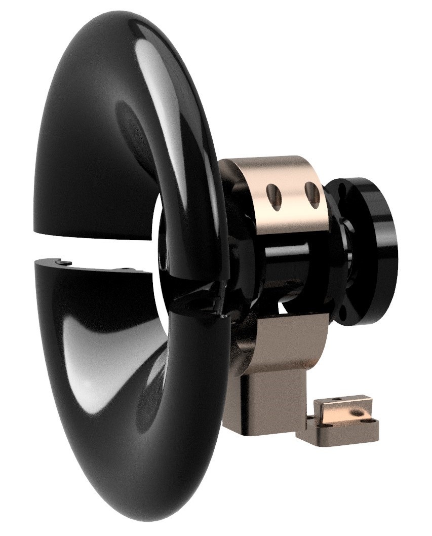

Was the kit version of this ever released?I'm still improving the geometry, it's now better than ever. Some new things, I just don't have the time for reporting. I hope to provide a new STL kit soon.
⌀280mm extended waveguide -
View attachment 1259594 View attachment 1259593
I have it almost ready. This time it's very easy to print and assemble (it will need M5 thread inserts).
This is the core shape. Any custom mounting, if desired, should be easy to add.
