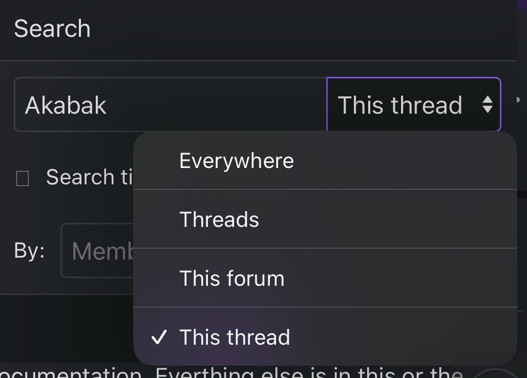

I do have problem getting ath output to work with akabak for example, but there seems to be a solution in here somewhere. If anybody knows where to point me, i would be delighted. Maybe it could be part of the first post with general directions?
