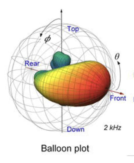

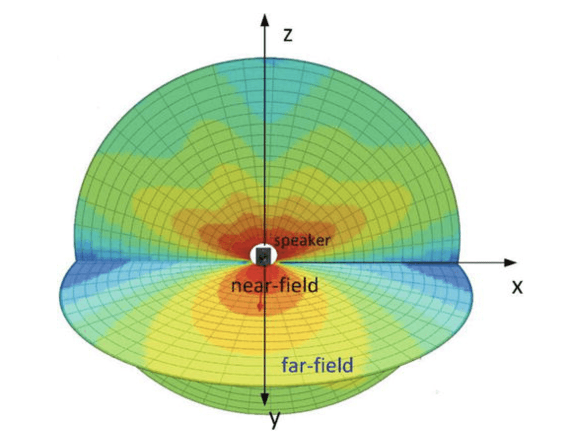

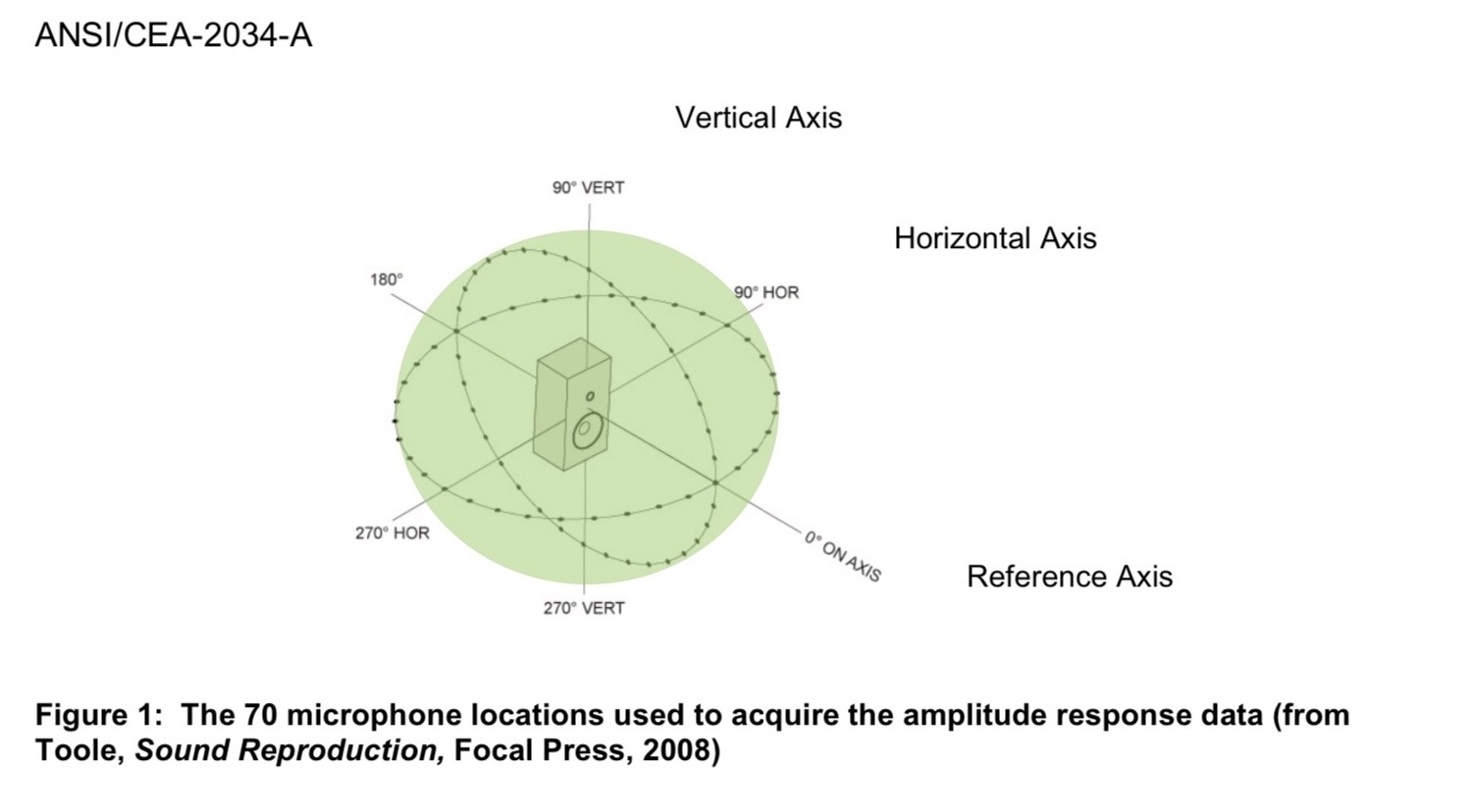

Accurately measuring and depicting true 3D dimensional loudspeaker directivity is not easy. Most of the time dual plane data is more than sufficient. When it is not, for example when a pro manufacturer wants to have their speaker used in an array, they will go to the trouble of having the full 3D balloon data captured.So if you think the abstraction that is ANSI/CTA-2034-A is incorrect, provide proof.
The difference in representation from this
to this

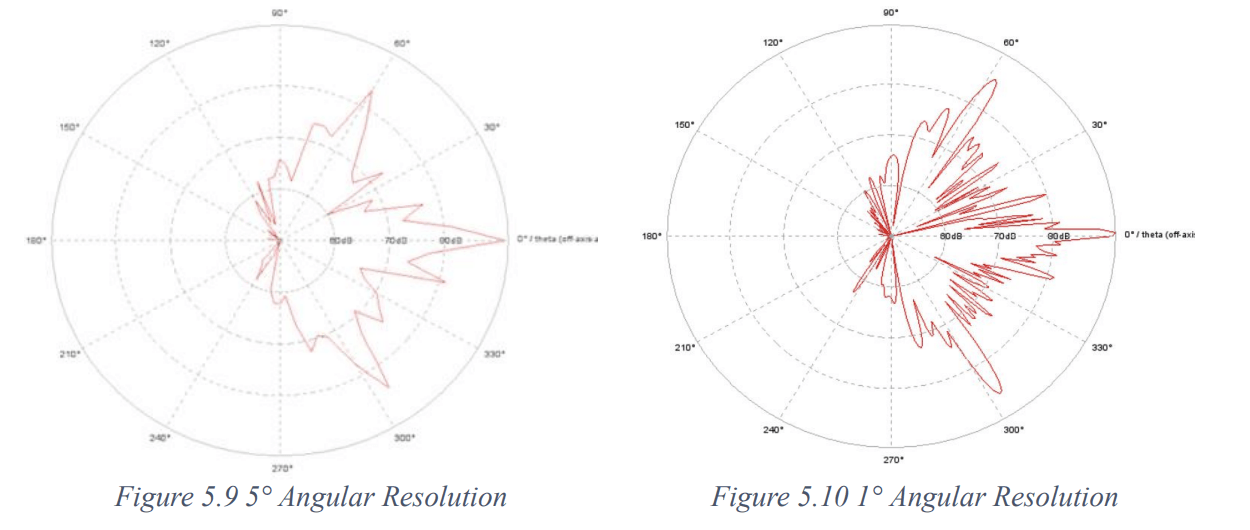

The angular resolution of measurements can hide a lot of features in the same way that smoothing or windowing does. Whether this matters or not depends entirely on what the data is going to be used for.
Because the vertical data occupies the same portion of a sphere as the horizontal does, it is given the same weighting in CTA2034. In perception terms the horizontal response dominates but that is not taken into account.
Perhaps these are the sort of things mabat is referring to.

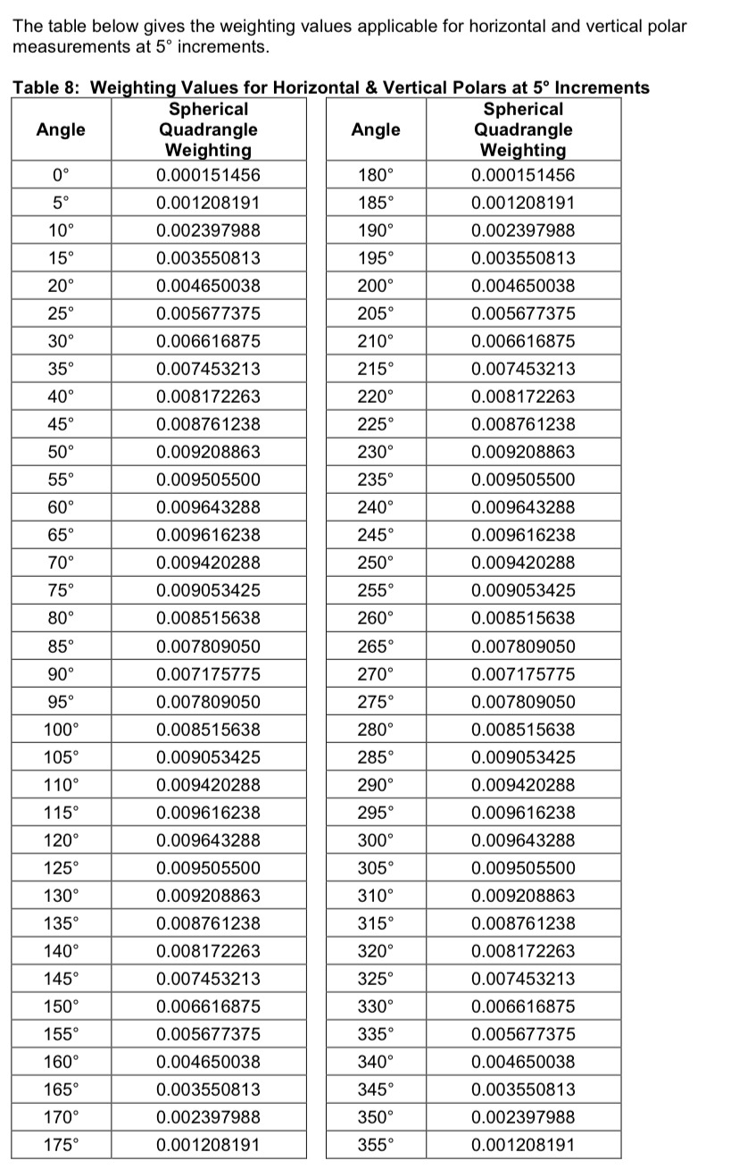

I think we are in all agreement, but may be misunderstanding each other.

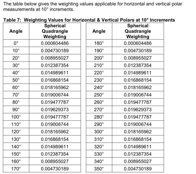

According to CTA2034…
“Sound Power
The sound power is the weighted rms average of all 70 measurements…with individual measurements weighted according to the portion of the spherical surface that they represent.
Calculation of the sound power curve begins with a conversion from SPL to pressure, a scalar magnitude. The individual measures of sound pressure are then weighted according to the values shown in Appendix C and an energy average (rms) is calculated using the weighted values. The final average is converted to SPL...
Appendix C. Sound Pressure Weighting Values
In order to approximate the total sound power radiated from a source by using the measurements at equal angular increments, the measurement at each angular increment must be weighted by the appropriate value. The weighting value corresponds to the area of the spherical quadrangle at the microphone position for a particular angular position."
The true sound power is a theoretical limit towards which measurements are taken continuously in all 3 dimensions, not 2 orthogonal circles at discrete intervals eg. 10 or 5 degrees.
The more irregular the device under test, the further away the 70 measurements captured by these 70 measurements would be to its true theoretical power response.
Green- shaded region by this author.
“In theory, with complete 360-degree anechoic data on a loudspeaker and sufficient acoustical and geometrical data on the listening room and its layout it would be possible to estimate with good precision what would be measured by an omnidirectional microphone located in the
listening area of that room. By making some simplifying assumptions about the listening space, the data set described above permits a usefully accurate preview of how a given loudspeaker might perform in a typical domestic listening room. Obviously, there are no guarantees, because individual rooms can be acoustically aberrant. Sometimes rooms are excessively reflective (“live”) as happens in certain hot, humid climates, with certain styles of interior décor and in under-furnished rooms. Sometimes rooms are excessively “dead” as in other styles of décor and in some custom home theaters where acoustical treatment has been used excessively. This form of post processing is offered only as an estimate of what might happen in a domestic living space with carpet on the floor and a “normal” amount of seating, drapes and cabinetry. Reverberation time would typically be in the vicinity of 0.4 s and relatively constant with frequency over most of the frequency range.
For these limited circumstances it has been found that a usefully accurate Predicted In-Room (PIR) amplitude response, also known as a “room curve” is obtained by a weighted average consisting of 12 % listening window, 44 % early reflections and 44 % sound power. At very high frequencies errors can creep in because of excessive absorption, microphone directivity, and room geometry. These discrepancies are not considered to be of great importance. Free-field data of the kind shown in Figure 4 are generally trustworthy indicators of performance at very high frequencies.
Figure 11 shows a comparison in which the agreement is impressive above the
transition/Schroeder frequency for the room (300 Hz to 400 Hz). At lower frequencies it is clear that the PIR cannot anticipate the effects of room modes and standing waves, although an ANSI/CEA-2034-A underlying trend seems to be evident … Individual users may experiment with other proportions of direct and spatially-averaged curves to find a good PIR fit for rooms they find themselves working in.
It is important to keep in mind that scientific research has shown that human listeners are farmore analytical than a microphone in a room. While it is tempting to think that a good looking room curve or PIR is a guarantee of good sound, it is not. The first requirement for good sound in a room is a good loudspeaker, something that will be evident from inspection of a data set. A room curve is not a diagnostic tool, in that it reflects a combination of the loudspeaker and the room, however by inspecting the comparison of a PIR and a measured room curve, it may be possible to learn something about the effects of the room, and from that what acoustical modifications might be required.”
Words Italicized by author.
Of course; the relevance of capturing the true power response, the power response, the predicted in-room response and its practical relevance in arbitrary rooms remains to be fully elucidated, as least to this author. For sure it is at least 86% better than a single on-axis curve.😉
Reference:
https://shop.cta.tech/products/standard-method-of-measurement-for-in-home-loudspeakers

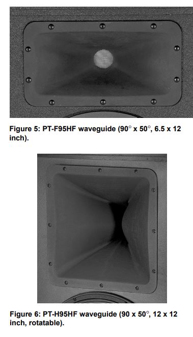

My experience with a slope for SP correction is a bit different. I do not use it anymore for the JBL PT-F95HF / Dayton H6512 waveguide.

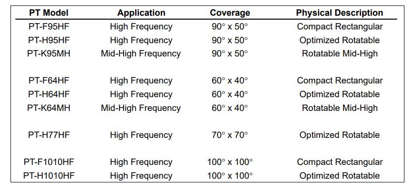

Had to start googling to learn what this was. Posting this here to save time for anyone else in the same boat as me. (Dayton H6512 is a copy of the JBL PT-F95HF)
Progressive Transition
Waveguide Families:
PT waveguides are grouped into two families. The first is “compact”, and second is “optimized coverage/rotatable”. Compact PT waveguides balance performance in favor of small overall package size. Frequency response is optimal, distortion is superbly low, depth is minimized for use where a shallow enclosure is required. Beamwidth and directivity are optimal in the horizontal plane. Vertical beamwidth and directivity are optimized to provide a good match with JBL low frequency and midrange transducers; however, vertical pattern control does not extend as low as optimized coverage PT waveguides. Figure 5 shows a compact PT waveguide.
Systems with rotatable PT waveguides optimize pattern control both horizontally and vertically. Pattern control is extended to a lower frequency. The installer can easily configure the loudspeaker for horizontal or vertical use. In systems using an optimized coverage PT waveguide, smooth frequency response, and the uniformity of off-axis coverage, and arrayability are all superior. A rotatable PT waveguide is shown in figure 6.
Compact vs. Optimized Coverage PT Waveguides:
Each PT design is appropriate for a wide variety of
applications:
Compact PT waveguides offer these features:
• Minimized enclosure size.
• Optimized low distortion for maximum output.
• Maximum output and superior intelligibility.
Stage monitors, distributed systems, and small
arrays are excellent applications.
Optimized Coverage PT waveguides allow for:
• Rotatable systems: Horizontal or Vertical
orientation.
• Extremely smooth frequency response at all
playback levels.
• Predictable arrayability in engineered loudspeaker systems.
• Superior uniform coverage in difficult acoustical
environments.
• Improved intelligibility.
Source: https://jblpro.com/en/site_elements/tech-note-progressive-transitiontm-pt-waveguides (PDF download from JBL Pro)

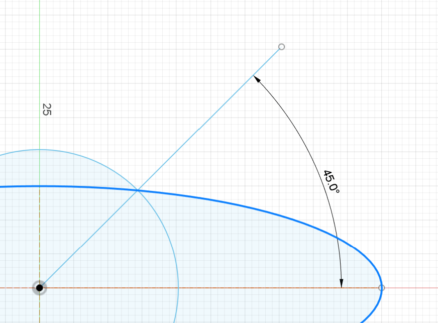

When all you have are the H and V (0° and 90° inclination) orbits, the best what you can do is a mere average, giving them both the same weight. There's simply no information what is between. That's what is used in CEA2034, but it doesn't mean it's correct.
I won't go through a whole proof, it's just maths, but here's a hint -
From the following picture it should be obvious that if you measured the orbit at 45° inclination for such an asymmetric source, the data would be closer to 90° (V) than to 0° (H). In other words, on a larger portion of a surface around the source the radiation would be closer to the vertical performance than to the horizontal. This means that for the total power calculation (and the DI), vertical orbit should be given a higher weight than the horizontal.
Now imagine even a simpler example - a square waveguide. The fact that it's actually square, and not perfectly round (!) is completely missing in the data.
The CEA2034 is simply not well suited for horns in general (for round it's of course perfectly accurate). Only after I tried to use it, I found how much it can be forgiving in many cases. If someone shows nothing but the CEA2034 curves, be cautious.
Put it yet another way, to show as representative the CEA2034 curves (or even a SP/DI calculated from the horizontal polars only) for horns that are highly asymmetric is nothing but cheating 🙂
