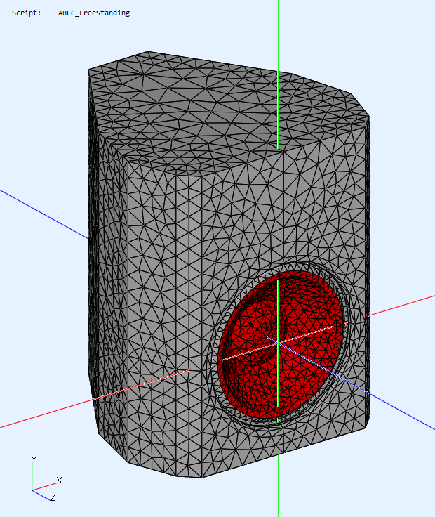

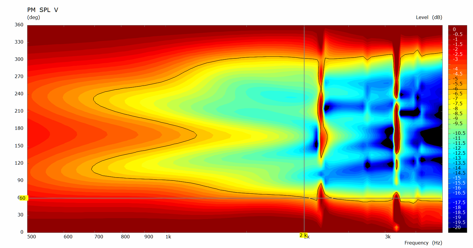

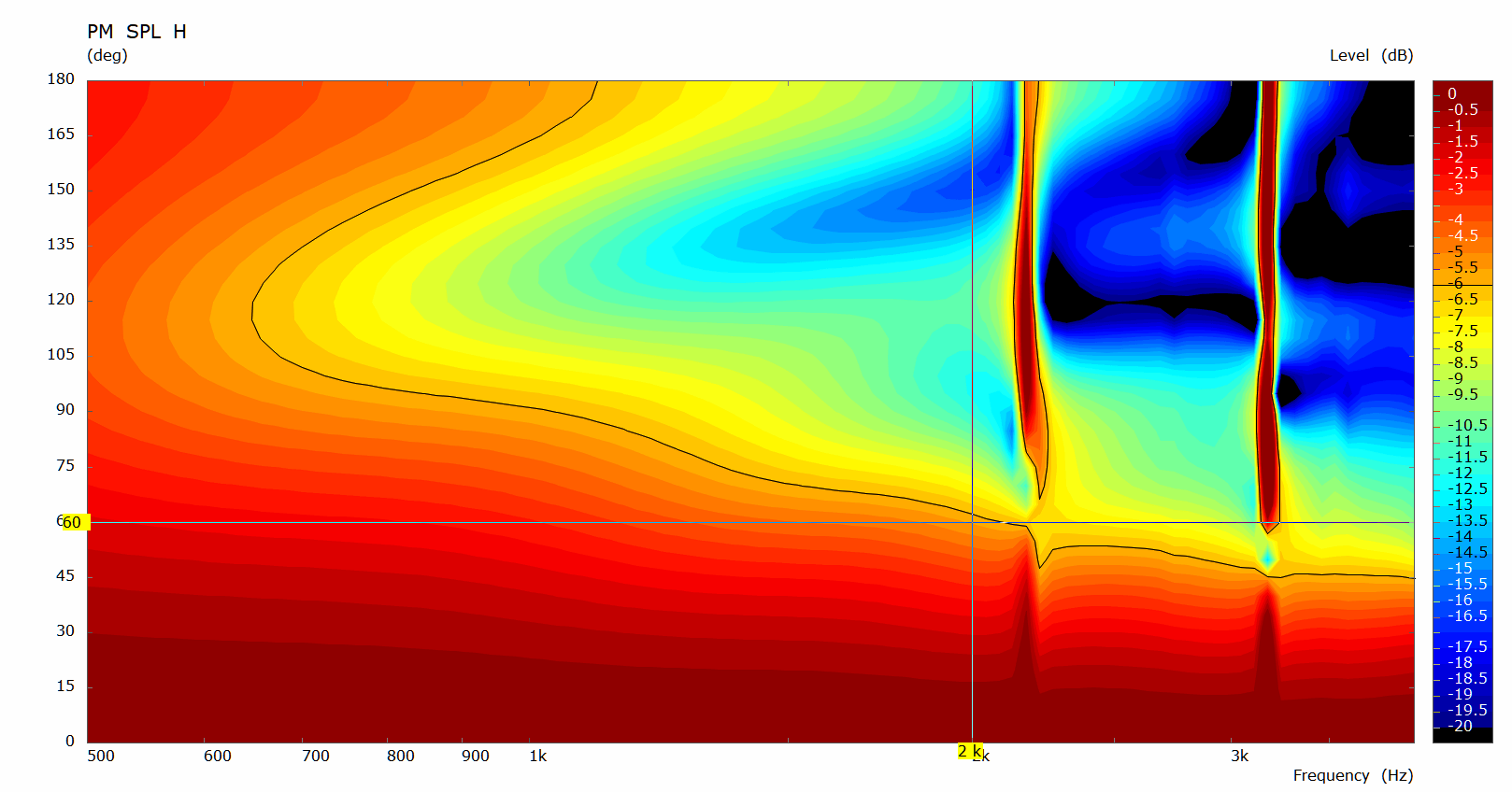

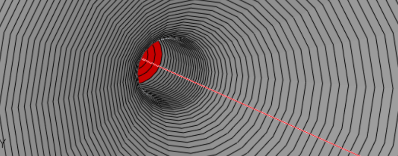

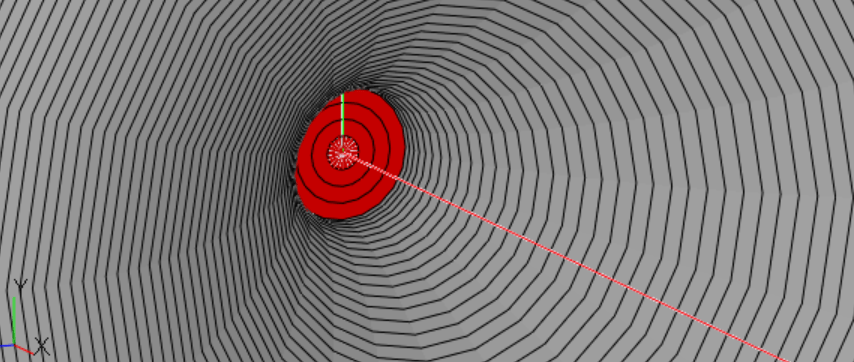

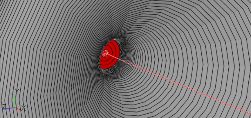

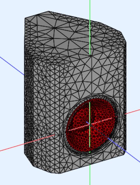

You can decrease Mesh.LengthSegments to eliminate that large number of thin triangles around the woofer (shown below as how I would do it; Mesh.LengthSegments = 4). I also noticed that the "horn" is not connected to the enclosure - it should be. (Don't ask me how now, but I think you should connect the outer edge of the source to WG0 - it's defintely in the User Guide).
  • 4_BC4NDS34_mesh2.zip
Reactions: 1 user

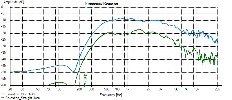

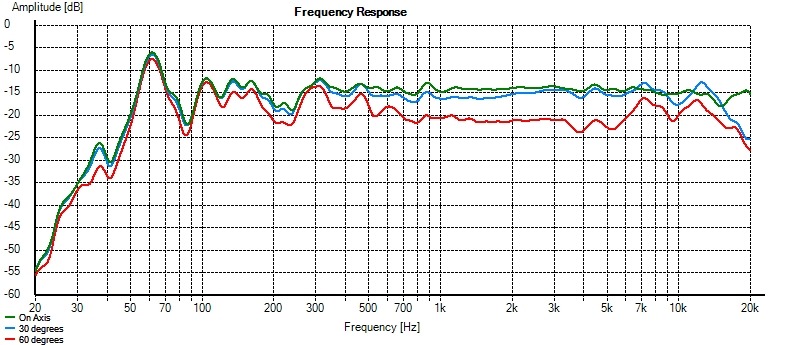

My interest in the ESP plug got re-kindled after a person I know purchased a pair of Klipsch Jubilee (which uses Celestion Axi2050 with THE mysterious plug).
The Jubilees sound really good to be honest and are to be used for soul and disco parties.
Hopefully after Christmas I will be able to do polars and (hopefully) settle the klipsch plug argument.

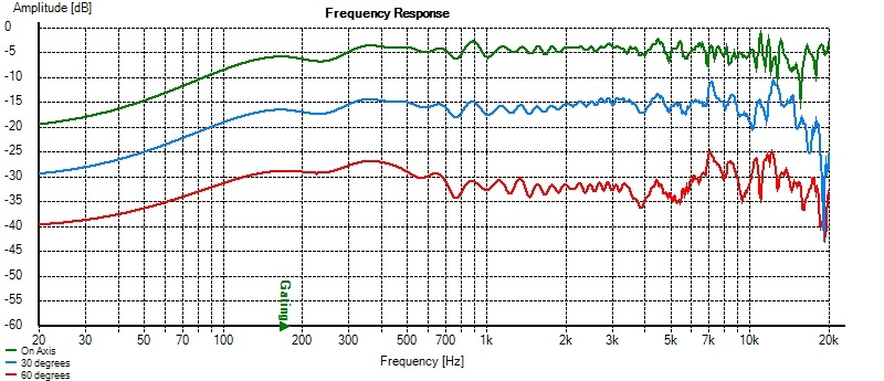

The latest itteration of the ESP plug still has issues and this is how it measures on axis.
Blue Trace - Semi-OSSE horn (no plug)
Green Trace - Semi -OSSE horn with ESP plug (shifted 10db down)
And quick and dirty on axis vs. off axis vs. more off axis with 10db offsets
EQ'd "flat" on axis
And last graph with the traces with no offset and 1/6 Oct Smoothing
At this point I'm not sure if the ESP plug is screwing with the directivity or the horn itself is a bit off.
Thanks for correcting me on WG0 and helping me with Mesh.LengthSegments, @mabat. In addition to the primary goal of OSSE/R-OSSE mathematics the other features of ATH such as Source.Contour and Box are amazing educational tools.
For @sheeple and everyone else, this is the line I forgot to include in the previous config file. New zip file attached.

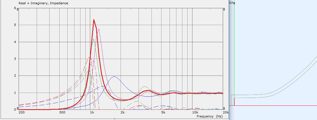

; Waveguide start
point p25 -1 47 20 ;
line p25 WG0 0 ; start of ATH waveguide

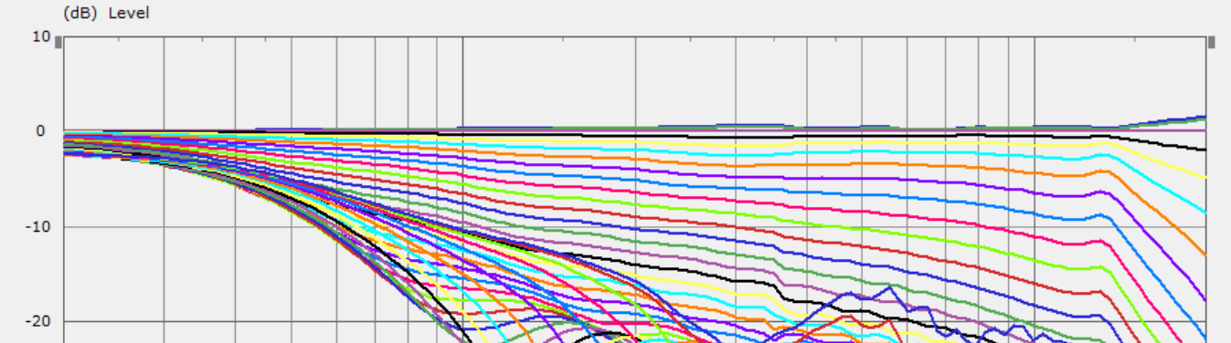

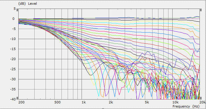

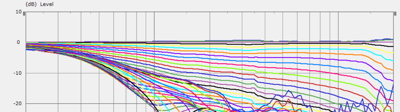

Horizontal / Vertical
  • 4_BC4NDS34.zip
Reactions: 1 user

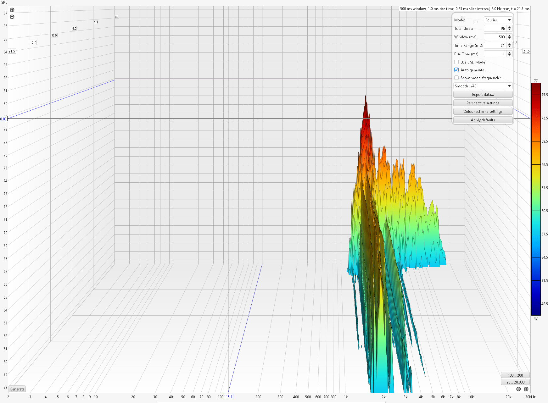

I don't have any at hand. But in general, a smooth frequency response corresponds to a clean decay
This is the only waveguide waterfall measurement I can find, I don't know whats going on here but it would be nice to see 1m Measurement in REW of a large Waveguide on a nice compression driver. I want to see Something that represents some of the best of what waveguiding has to offer.
If anyone has outdoor measurements of waveguides please share them
Reactions: 1 user

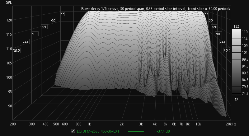

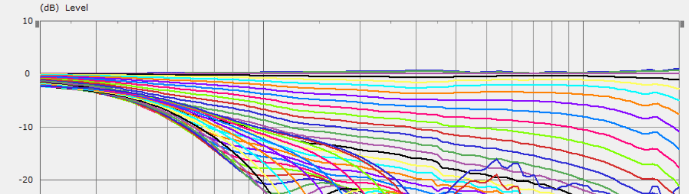

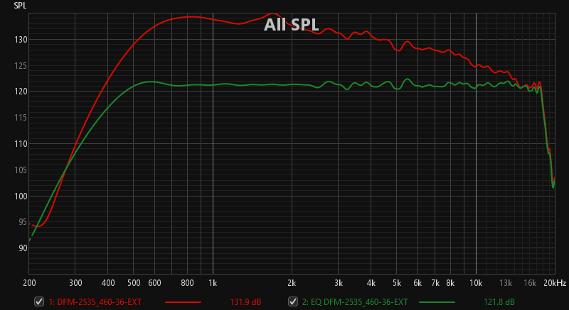

I took the impulse response from the links that @mabat posted, gated it to aprrox. 4.86ms (due to reflections from surroundings coming in after that), equalized it to flat and created a burst decay plot.
Obviously, we have a reduction in the frequency resolution determined by that gate window but I think it is more useful than allowing all the reflections inside and wondering what caused what.
Comparsion of unequalized and equalized responses of the DFM 2535 on the horn
Burst decay showing 40dB of dynamic range on the y-axis
If someone wants anechoic quality waterfall measurements, some can be found at ASR (for some relatively smaller waveguides than the ones being discussed here). For example: https://www.audiosciencereview.com/...jbl-4349-review-studio-monitor-speaker.22686/
