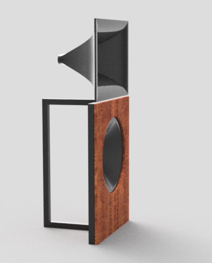

Your horn looks very much the size and proportions that I want, I look forward to see how it turns out.

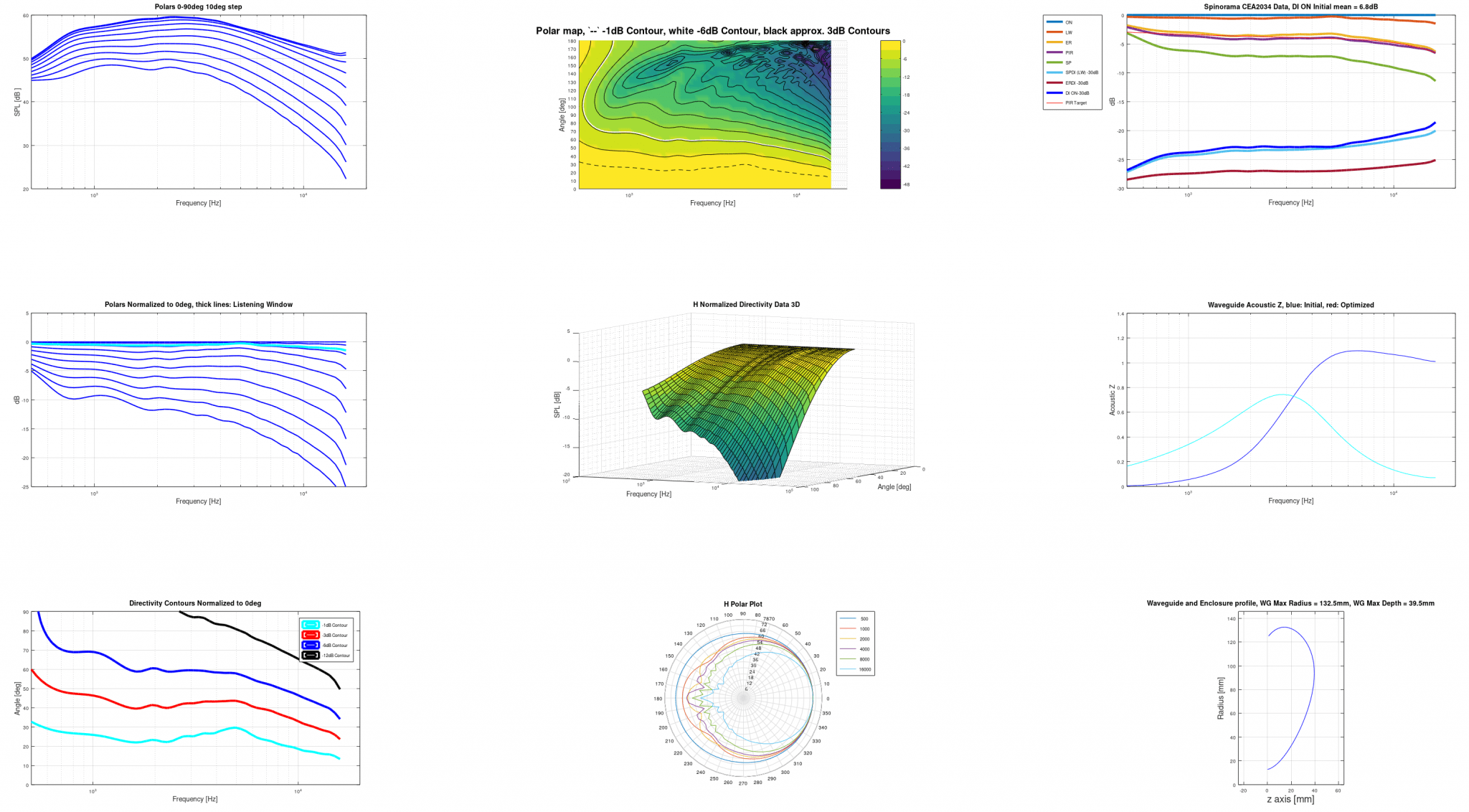

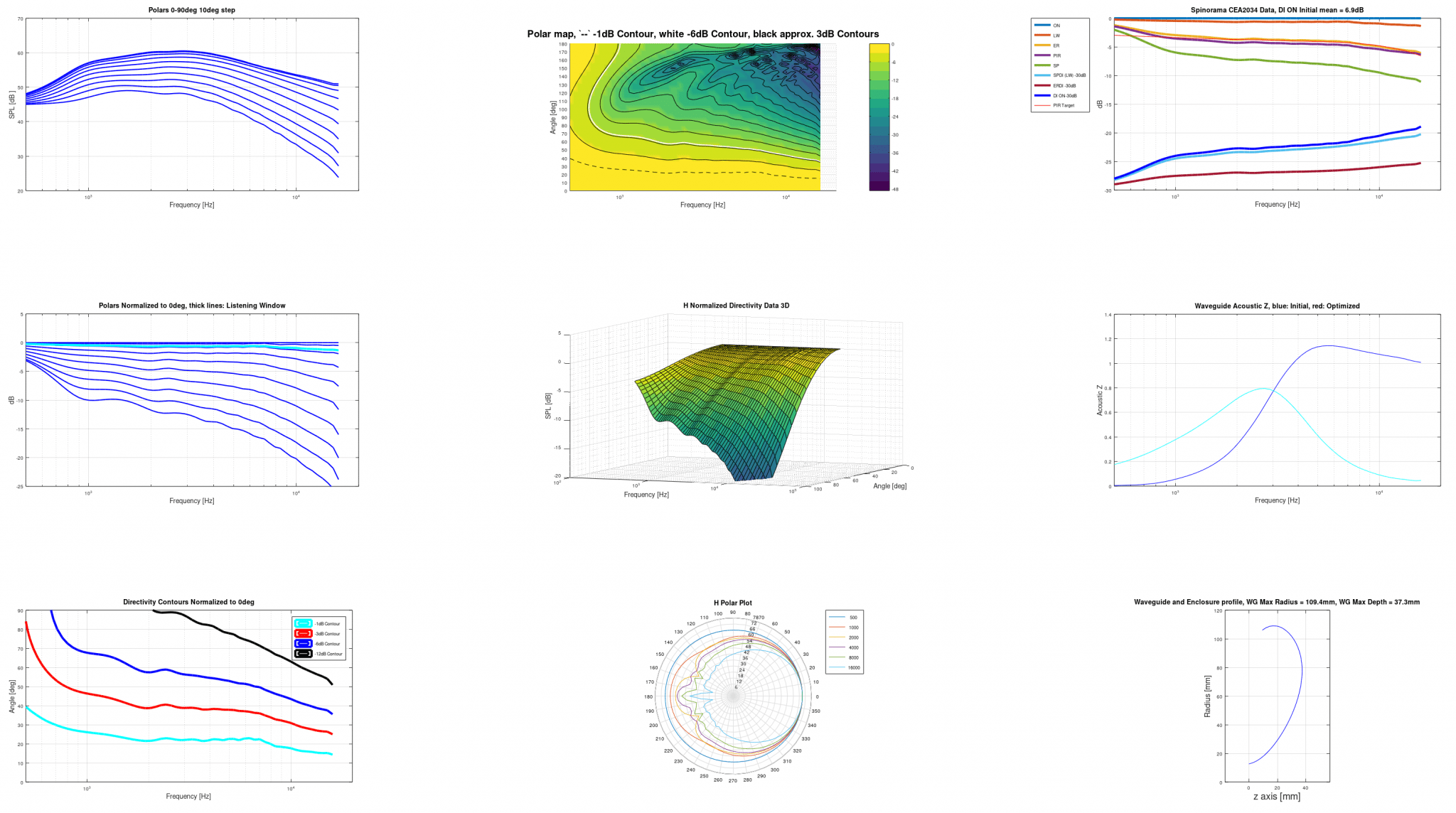

How about that:So what was your optimization goal? My objective when designing the "W" (=wide) version was to find a reasonably well-behaved waveguide with the highest beamwidth possible. What you show has a more narrow coverage, closer to the original ST260.
I don't know, try it. I just tend to avoid using strictly 0° response for normalization in any automated presentations, as it can easily distort the whole picture (10° is a lot safer bet).

ST26Wr3 full report, forgot it yesterday:
Optimized small (I did not specifically design it small just free the parameter for the optimization) full report:

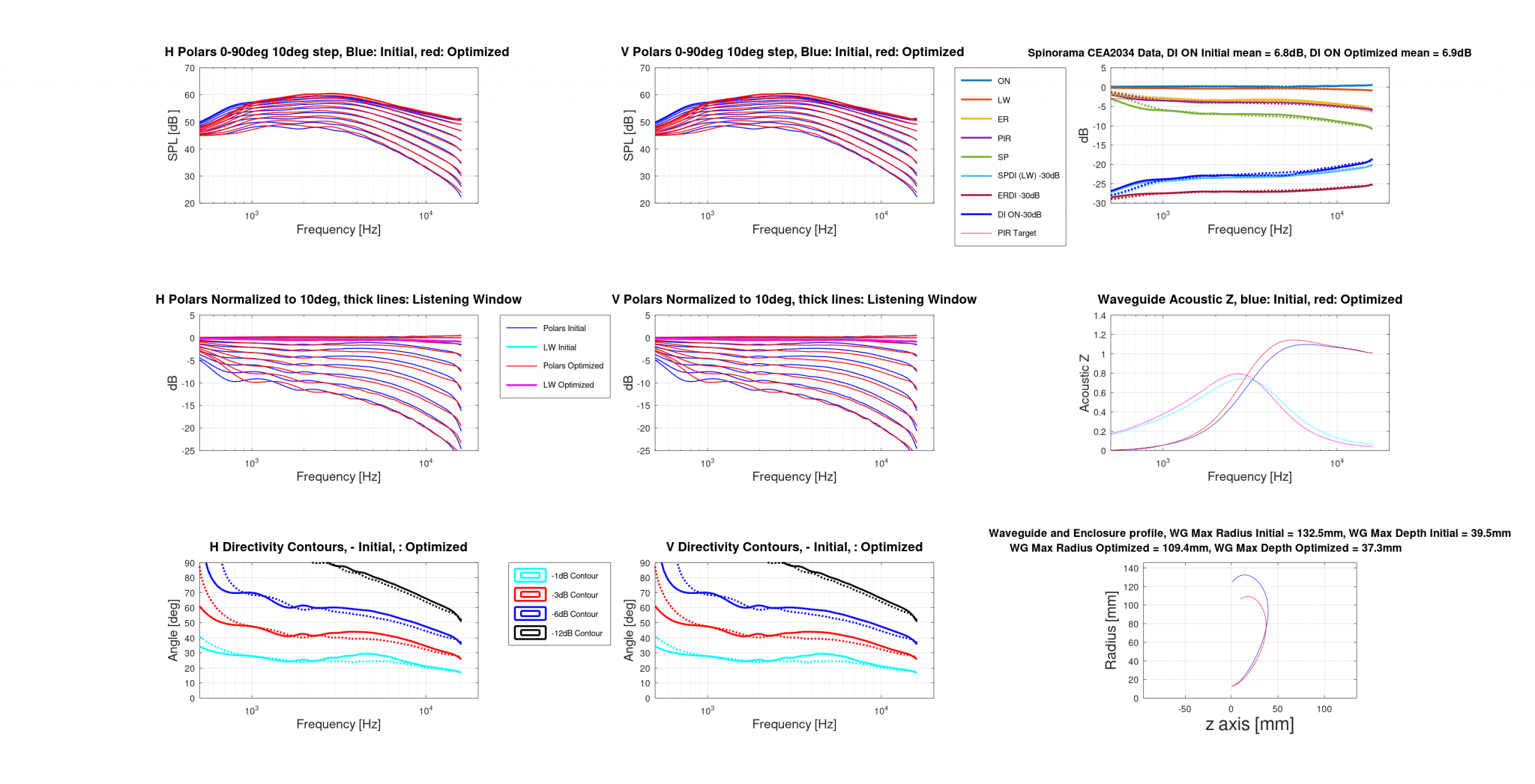

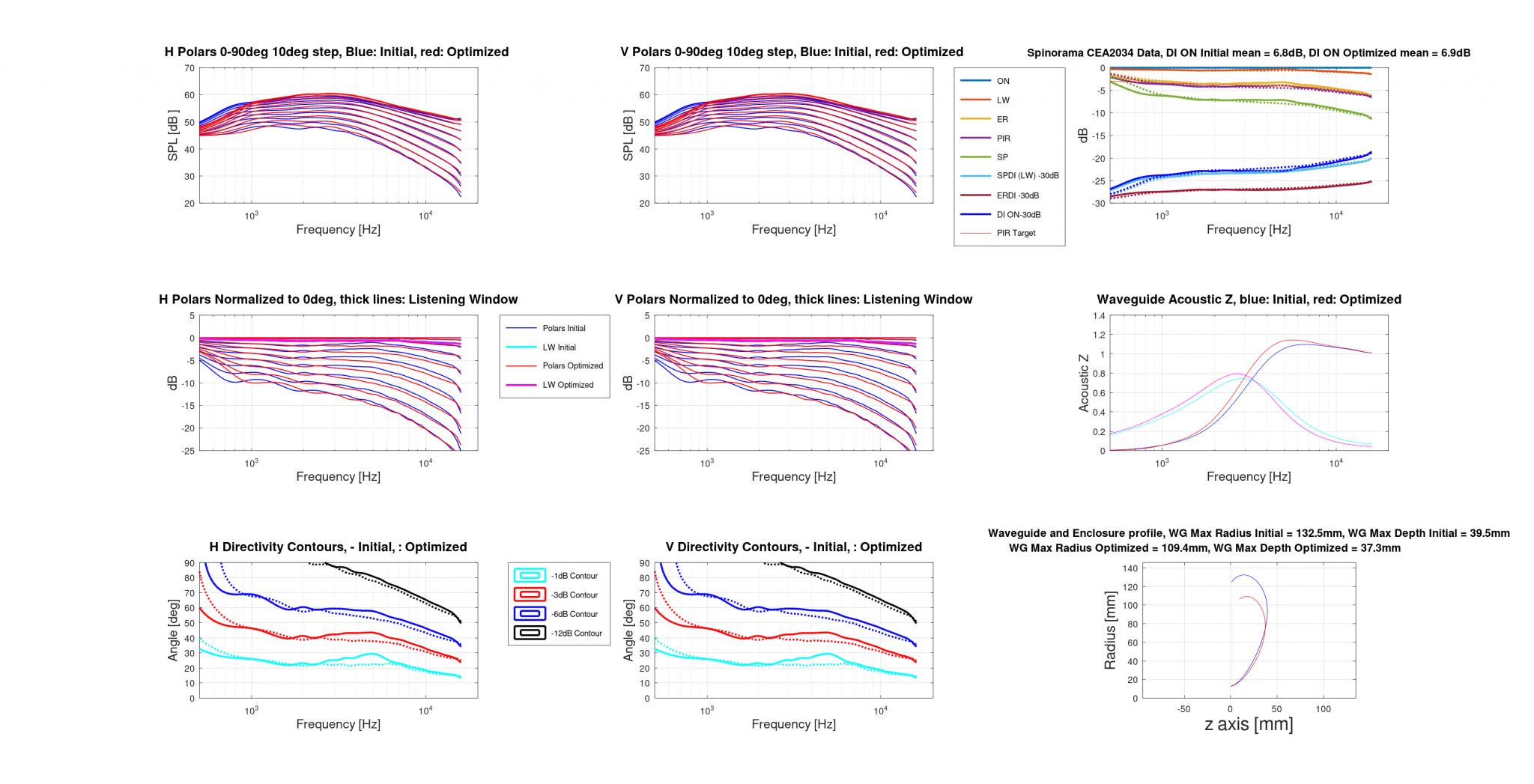

Comparison Normalized at 00deg
Comparison Normalized at 10deg
Do you see this design as an improvement over the ST260Wr3 based on whatever target you had in mind?
The bonus is a smaller size which should not impact the XO point if >1000Hz.
BTW, when one uses the 10Deg for normalization, for an axisymmetric device, one sort of use the LW for normalization (10deg weight is about 45% in the LW).
The CEA2034 shows the DI calculated with the LW (SPDI). The ON axis only accounts for 11%, (20deg and 30deg weights are 22% each) but is "probably" the axis on which a lot of artefacts (diffraction and others) are present.
Therefore, I do think one has to make the ON as smooth as possible and not just ignore it (I am not saying this is what you are doing) so the artefacts are also minimized.
With an optimizer (or without), there is no reason NOT to try to get both the LW (or 10deg) AND the ON as smooth as possible, I suspect that Tom is doing that.

You mean the 18" (or 21") needs off-axis dispersion there to meet the horn's one for constant directivity around 500 hz?But why? Because then they start to beam? That's what we want, right.
No way to cut off below the Schroeder frequency of most of the rooms (150/250 hz ?) where they dominate and use the horn from there with a tri or bi-axial (BMS) or the Axi from Emminence for instance ... well, ok, bigger throat size...dead end if I understood ! Ther are few designs with big horns around 300 hz... I do not remember the one of an australian small hifi business based on JMLH expansion ?!
Did you plan to use a 1" CD exit ? which compression copes with 500 hz (B&C DE550) without too much stress ?
No, the idea behind the ring insert is to use a waveguide that starts as deep into the driver as possible and continues without any extensions, i.e. the ring part is actually a part of this waveguide.Is it done like the External Shaping Plug?
See this Desmos graph - https://www.desmos.com/calculator/xokkqpqu9h
Set r_D0, r_D1, l_D (all the way down in the list) for a specific driver and then simply draw a waveguide that fits into the duct.

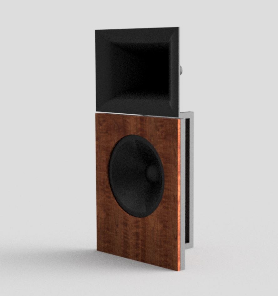

Are you going with an open baffle?
If you should choose a sealed or resistance cab the old trusted BMS 18N862 is hard to beat. It’s fairly light moving mass (260g) and low Fs (25Hz) but not the cheapest on the market.
Just my subjective comment, the measurements are long gone. Using the JBL 2245 18" under a JBL 2360 horn with BMS 4590 crossed at 550-600Hz worked really well. Using Audiolense after my best try of linearizing the system with EQ first, the system left me with little urge to improve anything. Music first!18" to 500 Hz is fine. I more meant that maybe someone would have a bad experience with these drivers so they couldn't recommned them, they are still new. Otherwise SB Audience seems like competent drivers, available for quite competitive prices.
