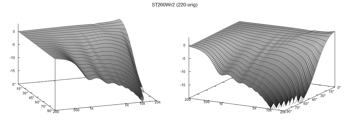

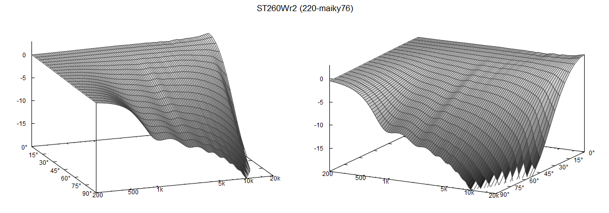

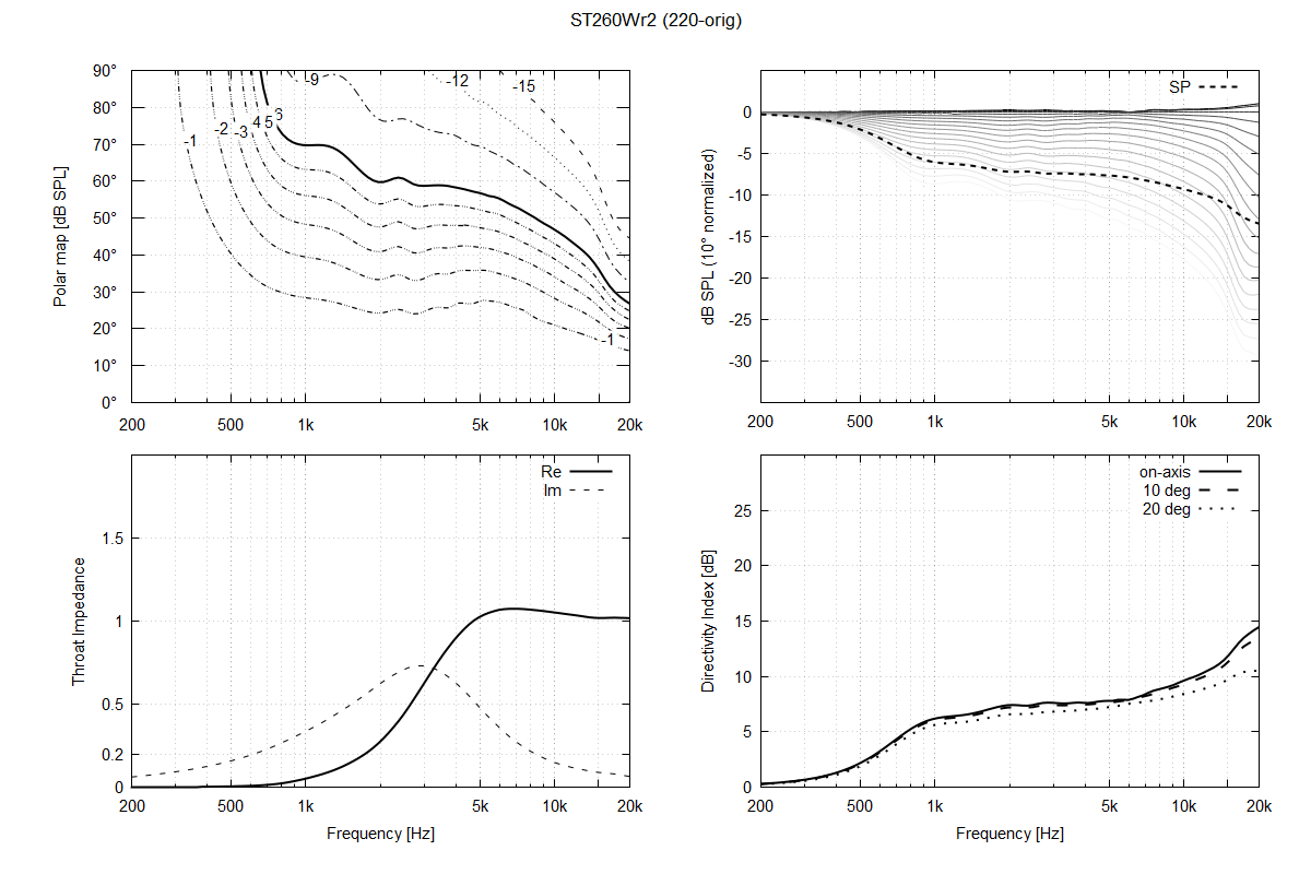

ST260Wr2 - the 220 mm version ("ST260Wr3"), the original vs maiky's:

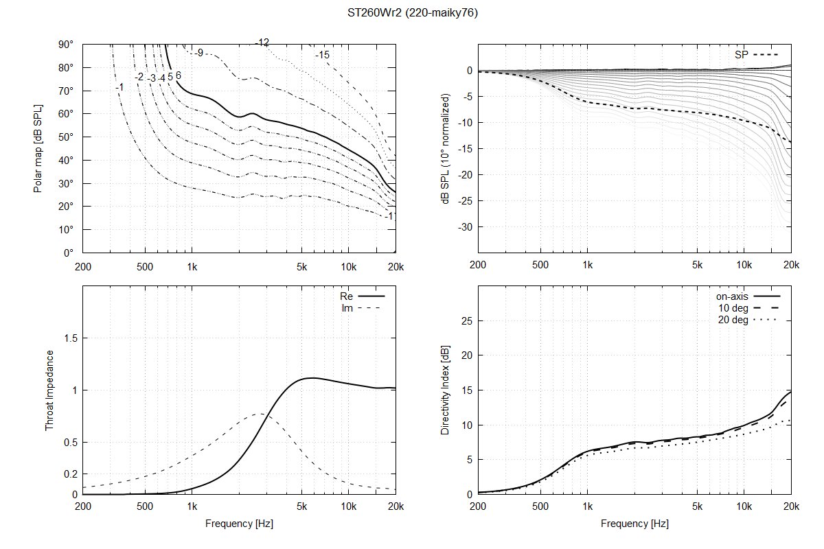

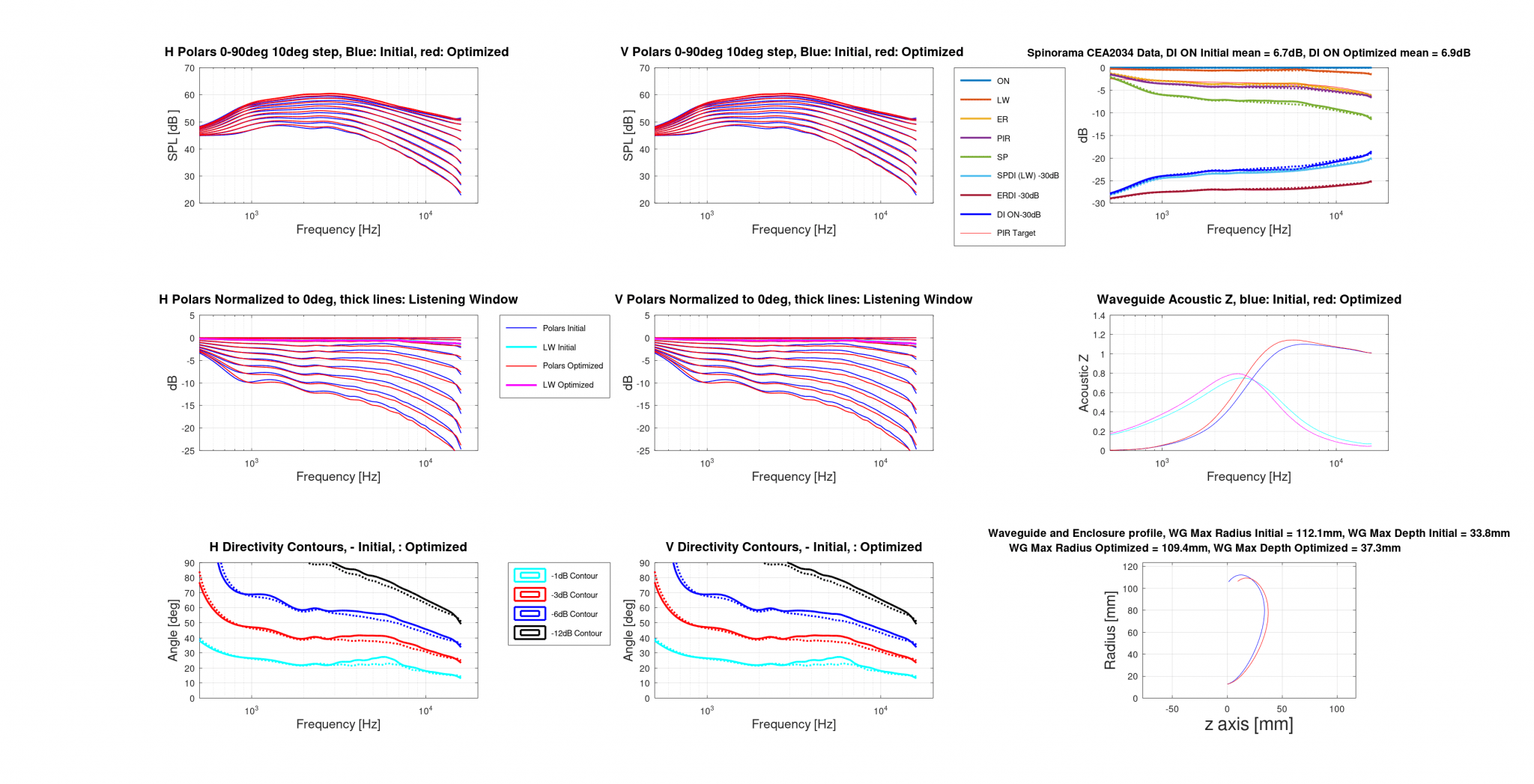

I think you might need a way to overlay the results for comparison purpose, and maybe less than 30dB dynamic range for the DI graph. The r3 220mm still seems to have the bump in the 1dB contour though and maybe marginally rougher.There's really only a minor difference, your numbers leading (again) to a slightly more narrowing response. It really depends on what you are trying to achieve, I don't know of any universal and unique scale. You can generate hundreds of slightly different devices like this and there will be no meaninful way how to order them in terms of quality, IMHO.
ST260Wr2 - the 220 mm version ("ST260Wr3"), the original vs maiky's: View attachment 1126529
View attachment 1126530 View attachment 1126531
When compared to the 260mm version the optimized version looks better to my eyes, when compared to the 220 mm version it’s a lot closer but the point is the optimizer found that the most effective way was to decrease the diameter while improving smoothness. I’ll try to get an even wider pattern but if the goal is to have a flatter DI then it might come at the expense of near axis smoothness.
Another thing, what is the purpose of this W variant? If it is to pair with a smaller woofer having an indication on its diameter may be very helpful to match the directivity.
I do what I'm used to and that it to switch instantly back and forth between the pictures, that works perfectly for me, thanks.I think you might need a way to overlay the results for comparison purpose
Yes, to match to a smaller woofer like 7 - 10" perhaps, that's really not critical with these waveguides.Another thing, what is the purpose of this W variant? If it is to pair with a smaller woofer having an indication on its diameter may be very helpful to match the directivity.
The waveguide size (R) can be changed easily, virtually without affecting the smoothness. It just shifts most of the acoustic features lower or higher in frequency, including the point where the DI starts to fall. So this way it can be also "adjusted" to any particular woofer at hand.When compared to the 260mm version the optimized version looks better to my eyes, when compared to the 220 mm version it’s a lot closer but the point is the optimizer found that the most effective way was to decrease the diameter while improving smoothness.

Well, that -1dB contour bump also means it has a better controlled directivity. As I said, pick your poison (besides, I don't see it as rougher). I don't know what's better - there's simpy no metric for that.The r3 220mm still seems to have the bump in the 1dB contour though and maybe marginally rougher.

That's a bit too much credit. I just try to make the lines in the report of ath smooth/equidistant. That means smooth DI and that seems to make @mabat happy. When he is happy, I am happy.With an optimizer (or without), there is no reason NOT to try to get both the LW (or 10deg) AND the ON as smooth as possible, I suspect that Tom is doing that.
However, I have been thinking and reading a bit more...
The 'fall' plots make ripples more visible. @tmuikku made me think about diffraction with his remarks that seem to have been triggered by the fall plots.
I've reread some stuff by Gedlee (and it will take quite some more to really make sense of it) and my interpretation of that is that diffraction cause HOM and that that is quite audible.Does it really make sense to trade what looks like maybe 0.25 dB of ripple for a lumpier low end response?
The small ripples itself (0.25 dB) are not the problem. However, I find it likely that they are caused by some diffraction somewhere (e.g. the waveguide edge) and the diffraction causes an early reflection and that is the problem.

I respectfully disagree.Well, that -1dB contour bump also means it has a better controlled directivity. As I said, pick your poison (besides, I don't see it as rougher). I don't know what's better - there's simpy no metric for that.
I am not saying that these are the only/best metrics, nor that there is no metric that would yield different results...

Assuming you used 110mm (a bit more or less does not change the relative results) for the smaller WG:
St220Wr3
cost_ON_LW = 4.4898 lower the smoother
cost_ON_LW_std = 0.1574 lower the smoother
ONLW_Smoothness = 0.8061 the higher the smoother
Optimized
cost_ON_LW = 3.4080 lower the smoother
cost_ON_LW_std = 0.1462 lower the smoother
ONLW_Smoothness = 0.9020 the higher the smoother
On this example the results are showing that the optimized version is smoother.
As to why I am focusing on the LW/On, this is because the LW flatness/smoothness is the single most correlated with high preference rating.
A more general remark: you have been advocating for smoothness as paramount and design the DI to be gently rising why has this WG different targets?
ST220Wr3(?) vs optimized small:
Some things to bear in mind and keep some perspective. Simulations like these are always more pessimistic about sources of diffraction than occur in reality. Nothing you physically make will have such a completely reflective boundary as the simulation enforces. There are potentially many other other small sources of diffraction not being modeled. A circular symmetry model with high mesh frequencies allows you to see things a full 3D simulation would not reveal. Does that mean it is more accurate or that more is being asked than can reasonably be expected.I've reread some stuff by Gedlee (and it will take quite some more to really make sense of it) and my interpretation of that is that diffraction cause HOM and that that is quite audible.
Measuring this sort of anomaly in reality will be hard as every other form of diffraction in the test setup will have to be eliminated.
The diffraction from that edge is lower than I have seen from any real waveguide. Getting rid of it in simulation did not come for free and made something else worse, something that may actually be more audible or detrimental to the sound.
I do not want to discourage anyone from attempting to make something better if only just a little bit, but just to keep reality in mind when analysing simulated graphs with the microscope out.
