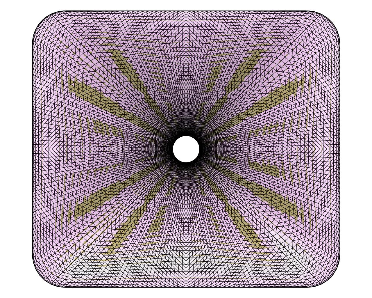

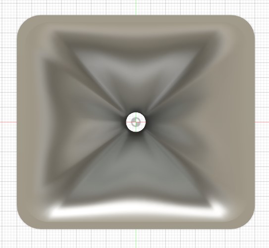

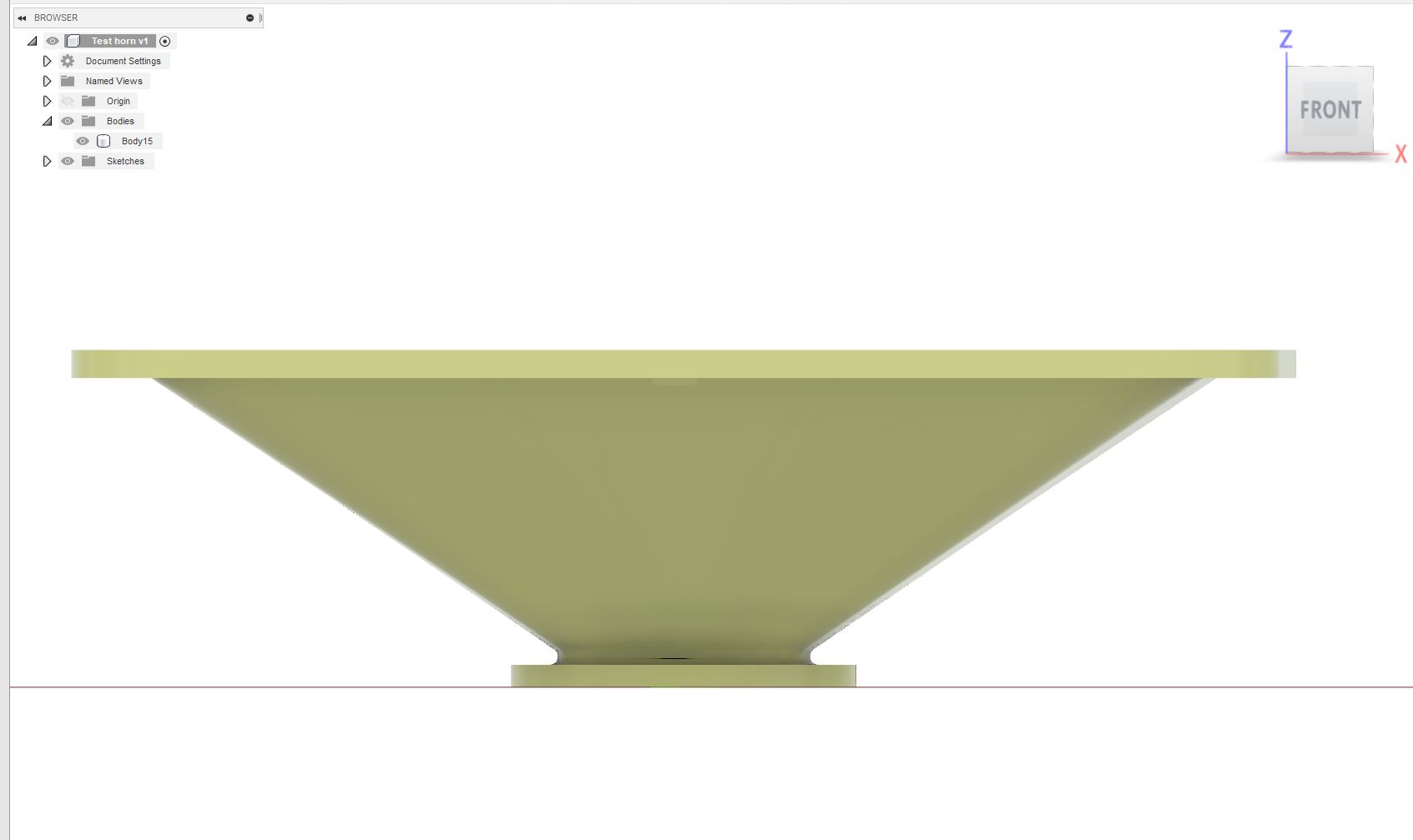

I confirm now that thicken issue, it is caused by the throat profile as the the profile starts to intersect on itself. Work around is to do it in smaller segments and use loft / patch to fix the outside edge as needed. Many ways are now available when we can work with few surfaces rather than mesh. Surfaces can be then later combined to single body.
Outside is lofted from bottom ring to top and is thus straight line giving variable thicknes to walls.

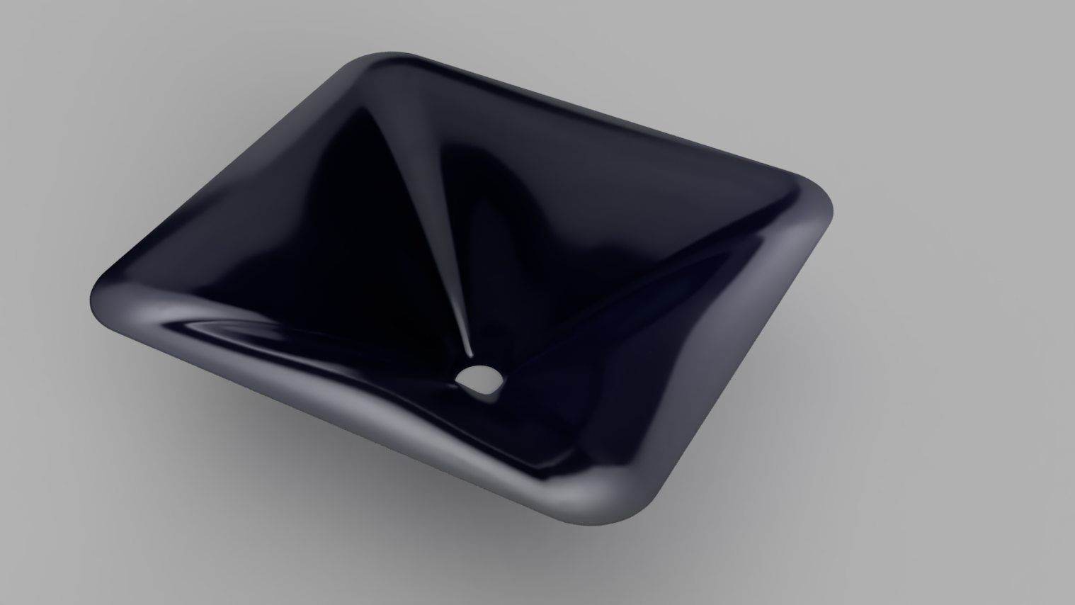

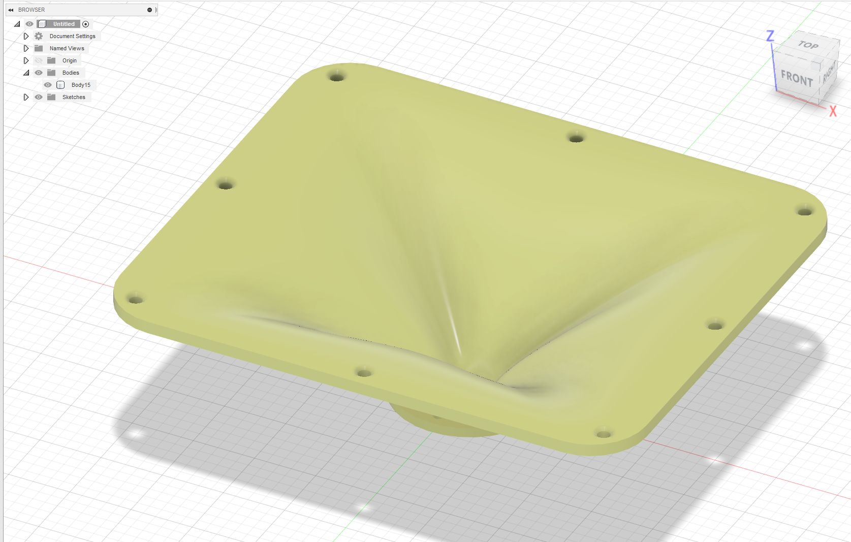

- I have just implemented the loft feature into the Add-In so now it takes just one click of selecting the exported text file to get a smooth surface into Fusion 360. Cool.

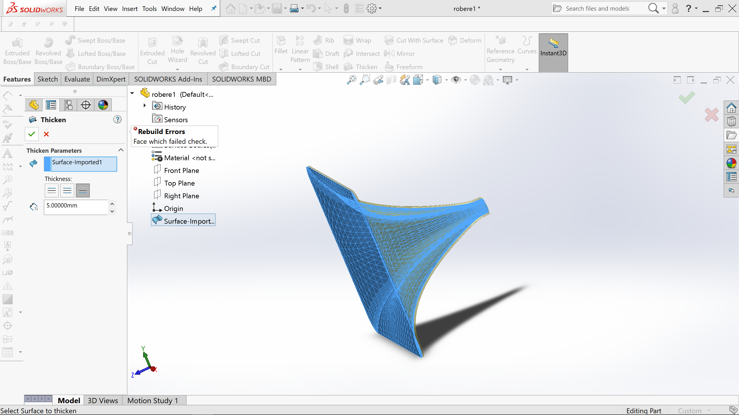

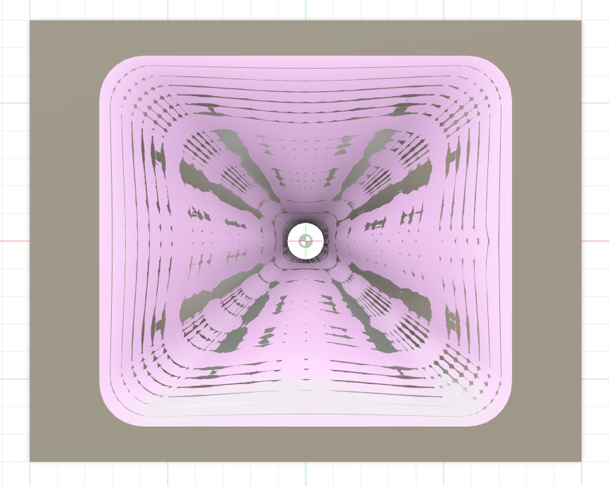

Solidworks doesn't want to thicken.

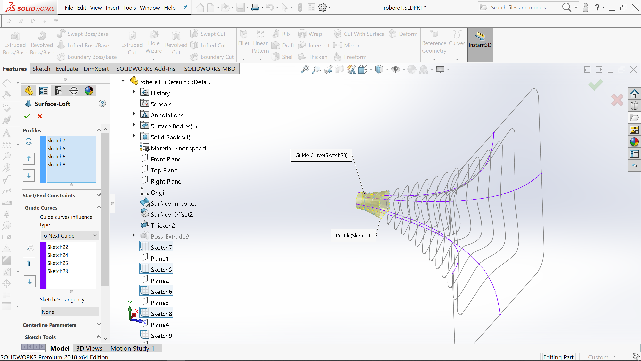

That looks like you have imported the mesh as a surface in solidworks, you have to join all the faces together to get it to thicken. If you merge all those faces together then it changes the geometry. By lofting the splines as shown before you get a single face that can be thickened.
The closest I got with solidworks and a mesh was to get solidworks to slice through the mesh at 5mm increments which gave the same sort of curves as mabat can generate, the problem was they were mesh sketches with a large number of points and it became too unwieldy to use.
The test file mabat posted can be downloaded as igs which should allow you to test it in solidworks.
Im could thicken by ticking option in STL import but then when I extrude driver mouting I can't do up to body or surface (thickened mesh).

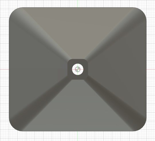

Superimposing the body created with loft with the stl there are no major differences, the spline model is "softer" than the stl due to its triangulation nature. Also when we export it to stl for printing that triangulation will occur again, it will depend on the export parameters to create a surface faithful to the body.
Thanks! That looks quite good to me.

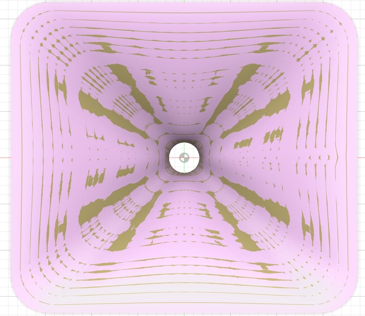

The surafce loft is very close to the mesh I turned off the hidden edges to show it more clearly. Mesh surface is pink.
attachment.php
Patching the surface to make a solid and cutting it out of a bigger block to represent a baffle gives exactly the same result. So it's only when you thicken that care needs to be taken to make sure the profile matches.
