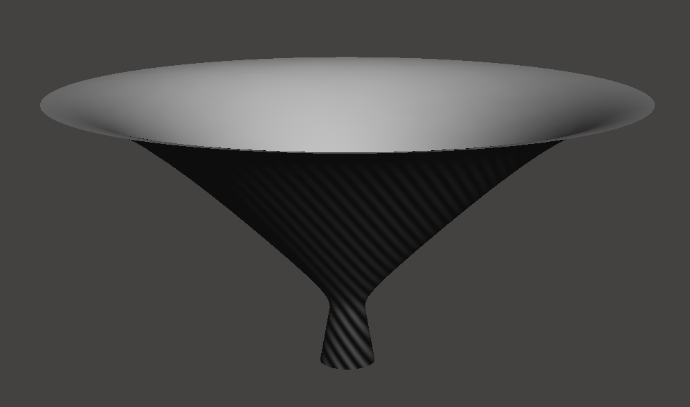

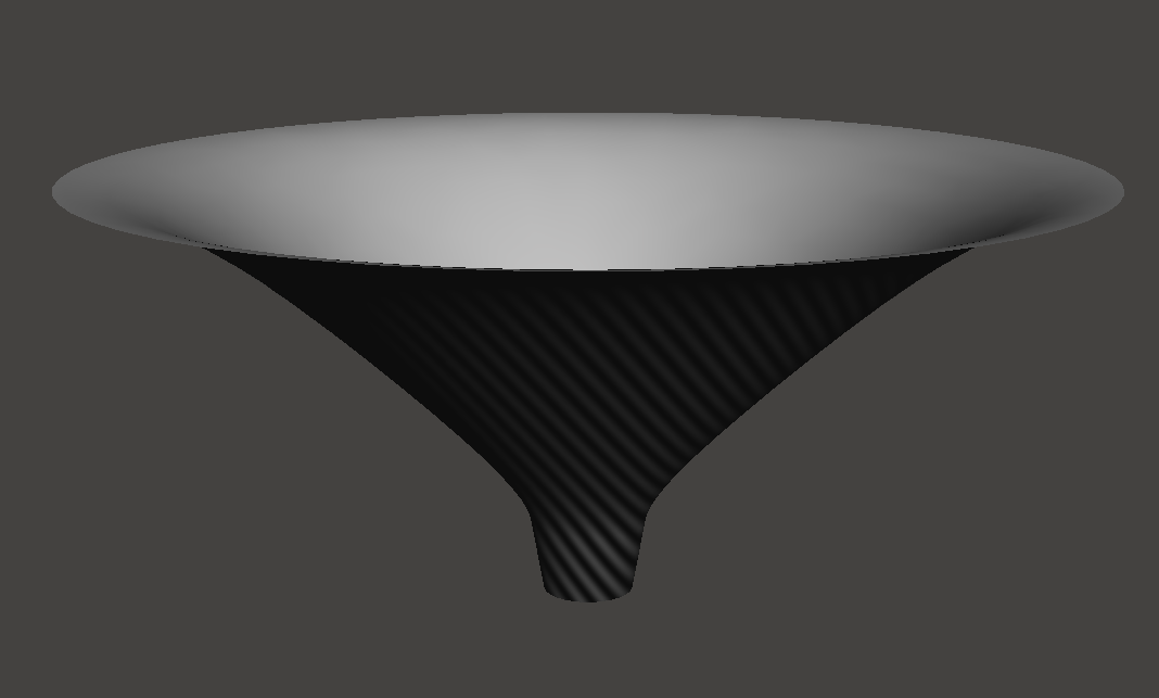

Without rails I could create surf loft and export STEP file to Solidworks. Output files extension for Solidworks is txt.
I tried your project and it's strange - with SurfaceImport it creates only the first 15 sketches (and fails), even though when imported without lofting, it works fine. That may be hard to debug...

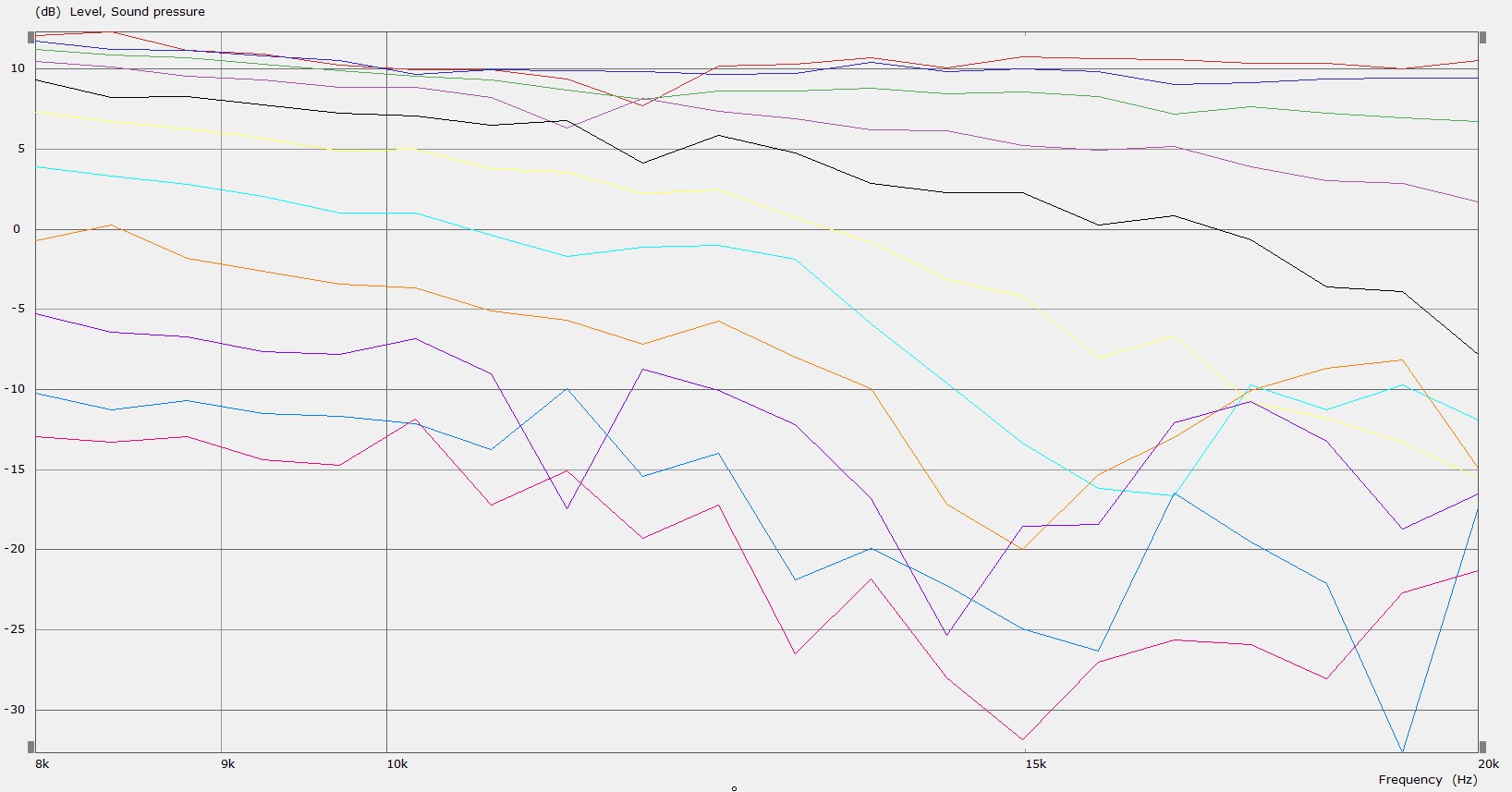

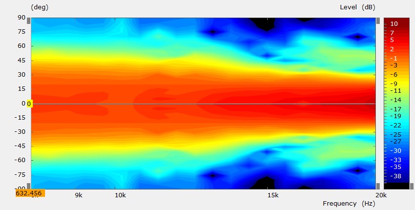

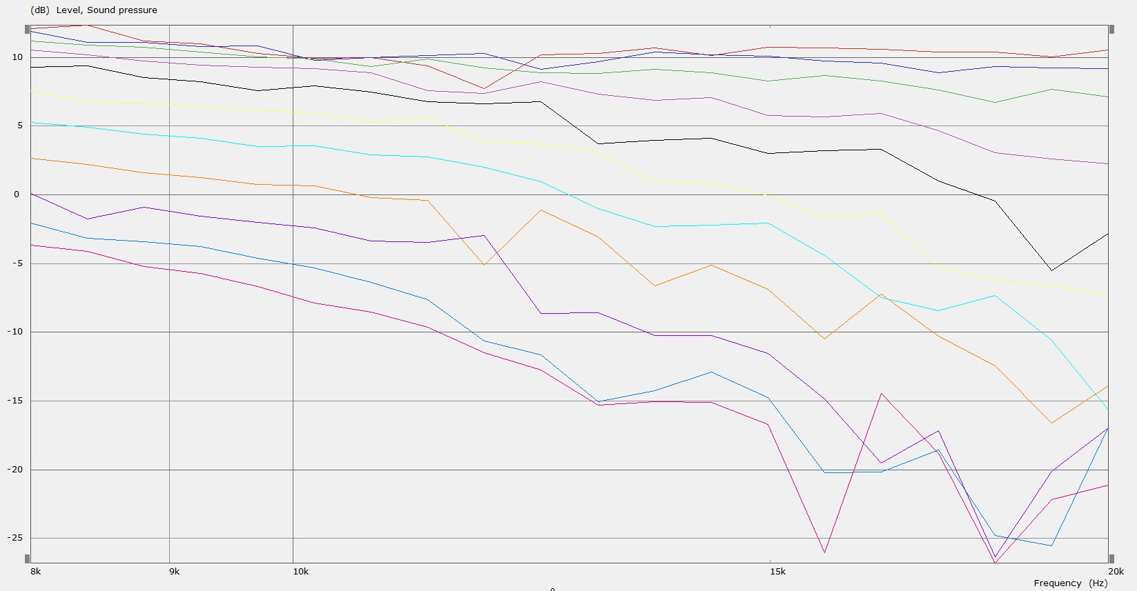

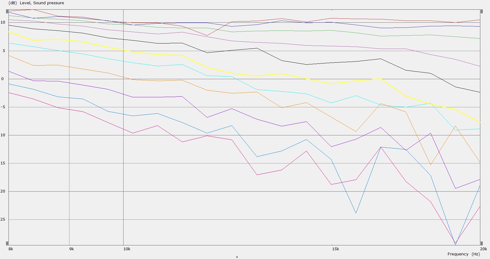

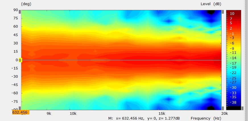

M2 ish 8K to 20K ABEC result

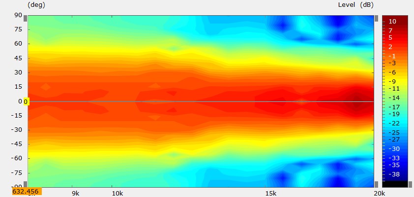

For what it is worth here are the VACS graphs for running the M2 style waveguide between 8K and 20K, looks quite good overall driven by a perfect radiator.

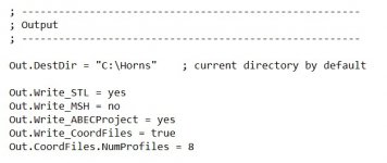

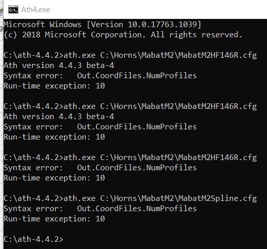

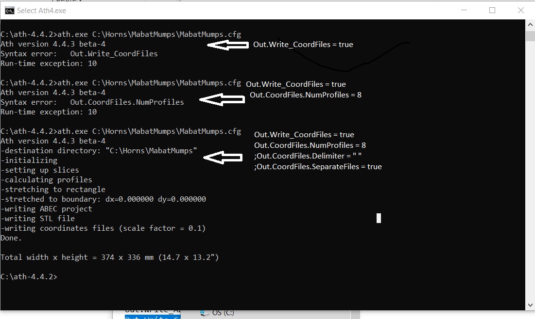

When I try to add the new lines in the configuration files I get a syntax error, I copied the lines from the readme so I'm not sure what I'm doing wrong😕 Tried with both of the betas, I put the exe in the same folder I was using before to run the tool as the betas are called ath.exe so they should be able to coexist?
I tried 8 and 4 as the number of profiles with the same error.
This config worked (not sure why having the other lines in but commented out made it work) but I could not get the separate profiles to work without a syntax error. Surface loft in Fusion then worked
Code:
; Output
Out.DestDir = "C:\Horns" ; current directory by default
Out.Write_STL = yes
Out.Write_MSH = no
Out.Write_ABECProject = yes
Out.Write_CoordFiles = true
Out.CoordFiles.NumProfiles = 8
;Out.CoordFiles.Delimiter = " "
;Out.CoordFiles.SeparateFiles = true

What is weird for me is that I had to specify them commented out for the configuration to run, if I left them out entirely I got a syntax error. The attached cmd screen shows the errors with the code on the right that caused them, the last one went through no problems. Maybe that doesn't happen for anybody else, it works for me with those settings so I just thought I would report it in case anyone else gets the same.
I reproduced the error. It happens when one single empty line is present at the end of the file. I will fix it. For now just enter one more empty line there, or no at all.

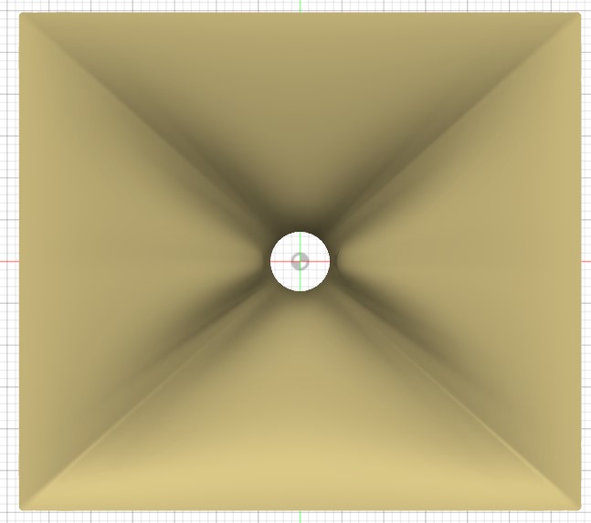

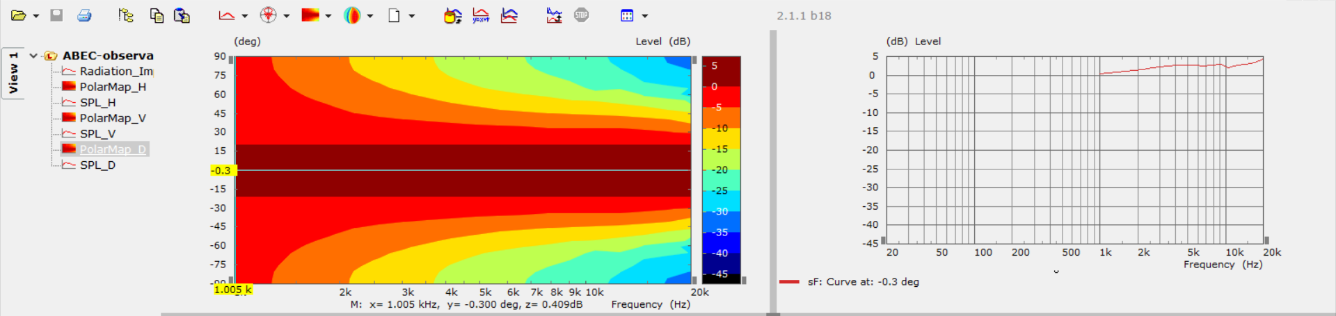

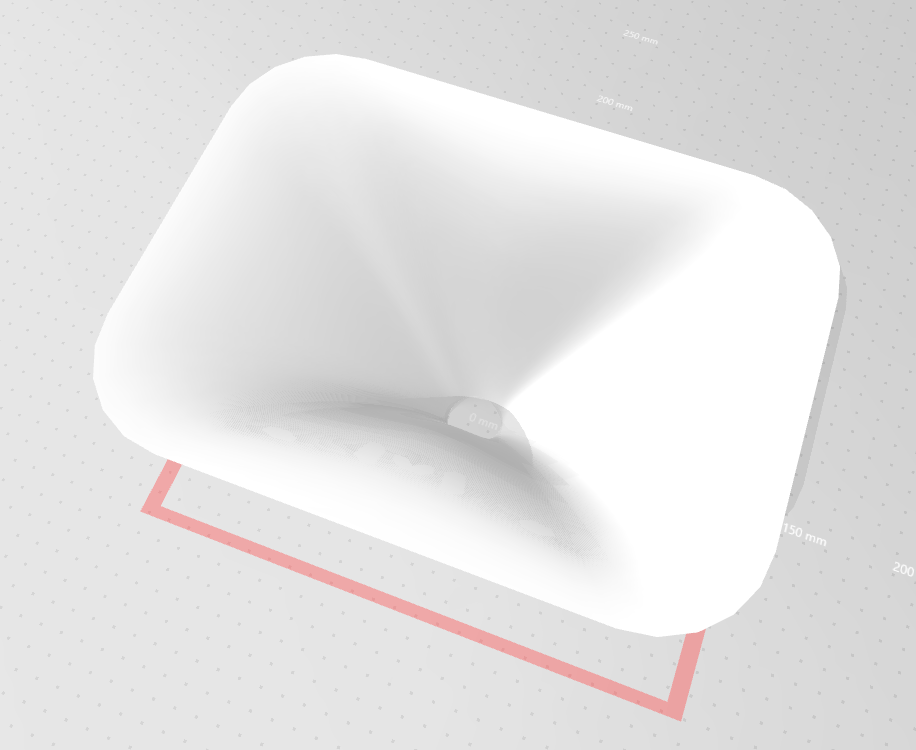

Hi, this is fun tool!

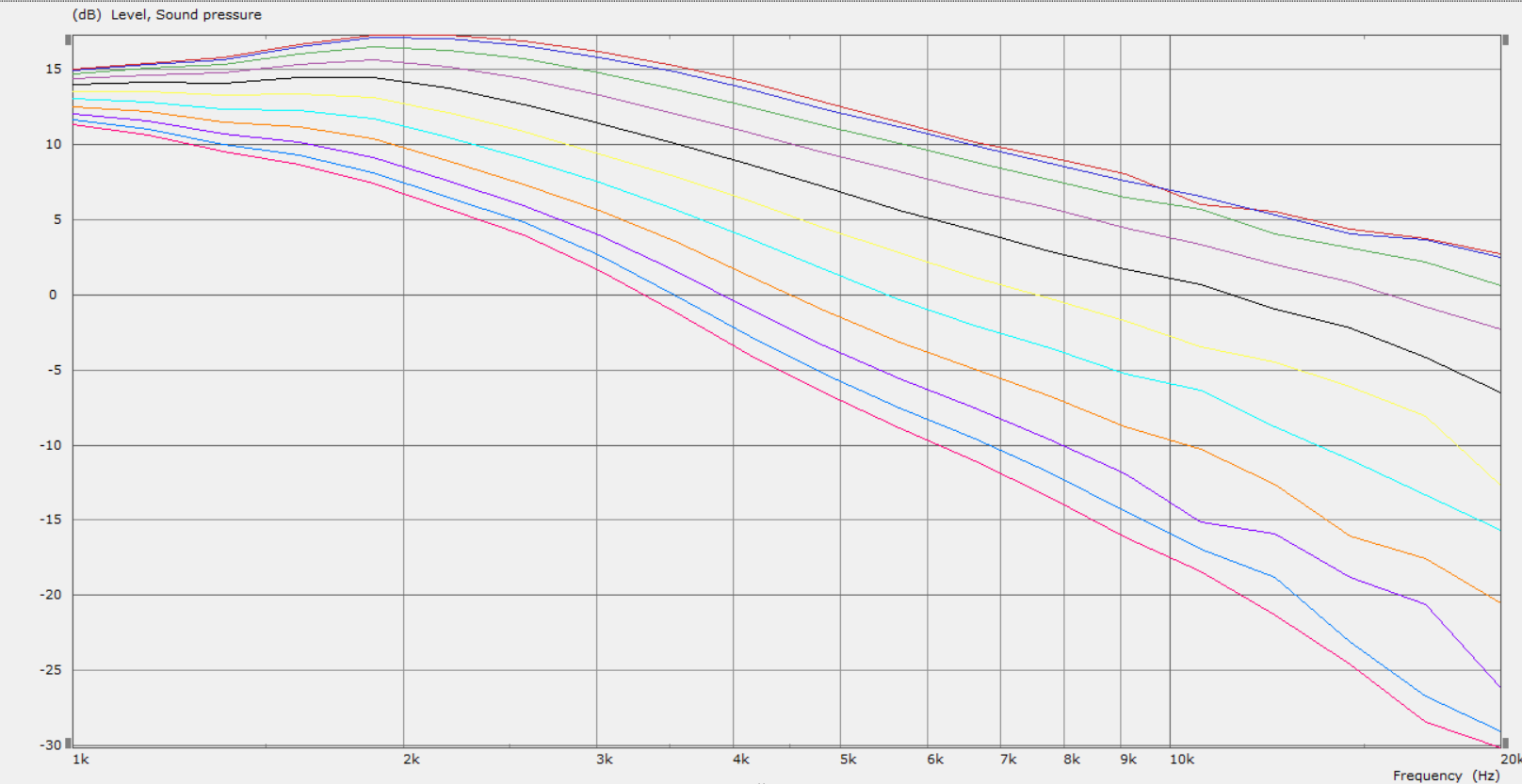

Not sure what I'm after just playing around. Got some smooth looking diagonal response, is there a way to extract the profile from the "corner" or some other tips how to get the performance to the horizontal axis?😀
Also, any tips how to get a wave guide larger? I tried to tune the depth and / or variables of the super formula but the performance gets nowhere near. By good performance I think the lines in the SPL graph should be smooth and not overlap?🙂 Thanks!
Make it round 🙂Got some smooth looking diagonal response, is there a way to extract the profile from the "corner" or some other tips how to get the performance to the horizontal axis?😀
For the corner profile, import the file *_profiles.csv with Ath4_CurvesImport add-in and make sure you set Out.CoordFiles.NumProfiles = 8 (that includes the diagonals).

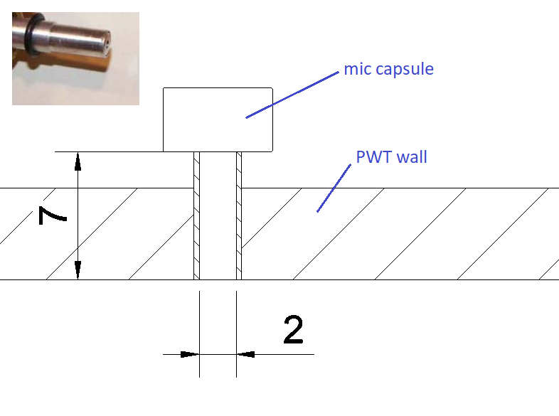

Preparing the PWT mics, there's a possibility to make a very small narrow tube extension as a pressure probe (see the drawing; [mm]). Would that make sense? Wouldn't it disrupt the sound field inside the tube too much? Plenty of such holes could be prepared in various places in the tube, plugged if not used. Some form of mics calibration will be necessary anyway.
I think that not having the microphones flush mounted will cause lots of problems. The tube extensions will act as resonators/filters and any vacant ports must be flush (even if closed.) The extension may not be so bad on a single mic, but still the response would have to be adjusted (just how is a big question.)
OK, I won't complicate it, I suspected it could cause trouble. I'll flush mount all the capsules.
