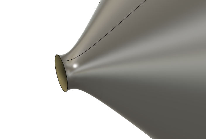

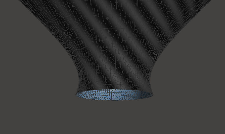

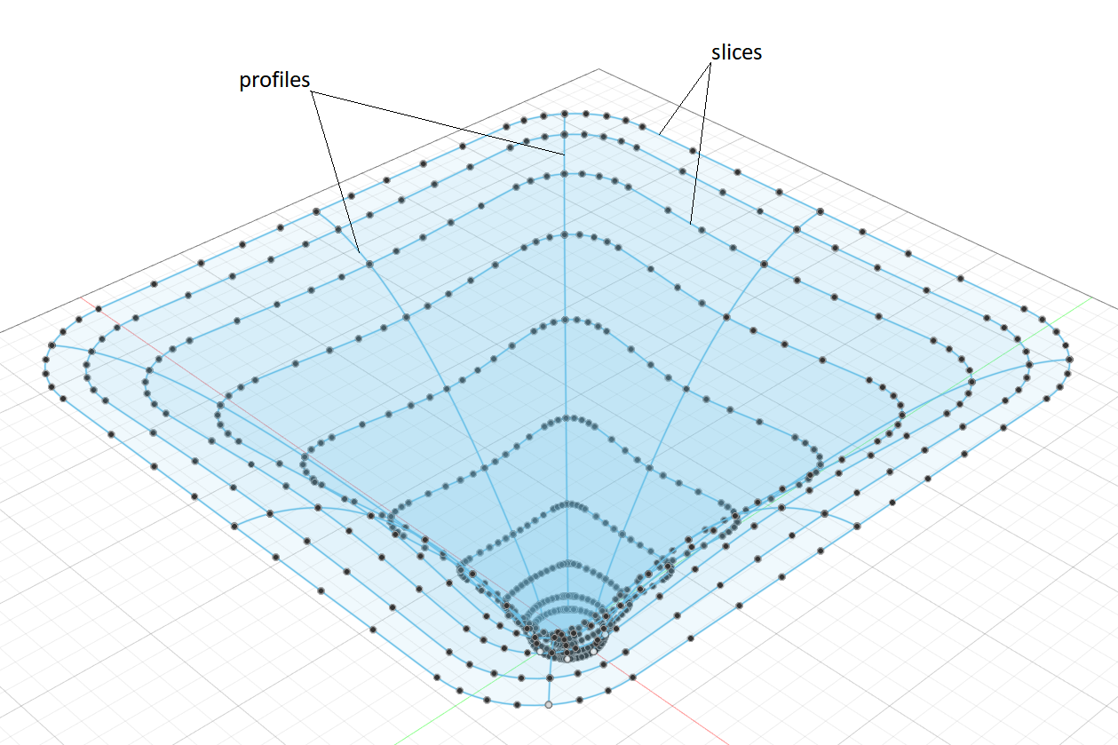

That's right. I think some splines could be used as guiding curves for the contours. These could be calculated externally with the WG formula, saved to a text file and imported the same way by the Add-In as they are now. Then you could get OS profiles with exit flare for the walls - i.e. basically what Ath does....Basically you're "morphing" a circle into a square. But the "key" to this is that the circle is tilted 45 degrees off axis.
Ath 4.4.3 beta
For those impatient, here is a beta version with some quick instructions of how to proceed (see the README file): Ath 4.4.3 beta
It should work. What's still missing is the second surface for adding thickness.
Looking forward to see your renders!
Edit: Oops, the scale of the profiles was still wrong. Please download again, if you already did so.

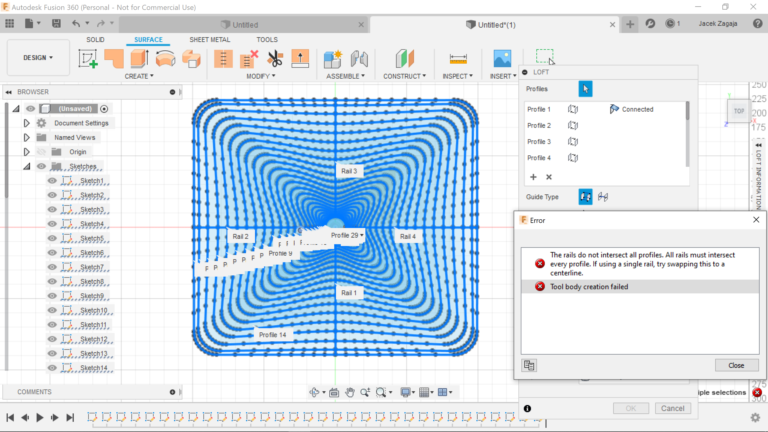

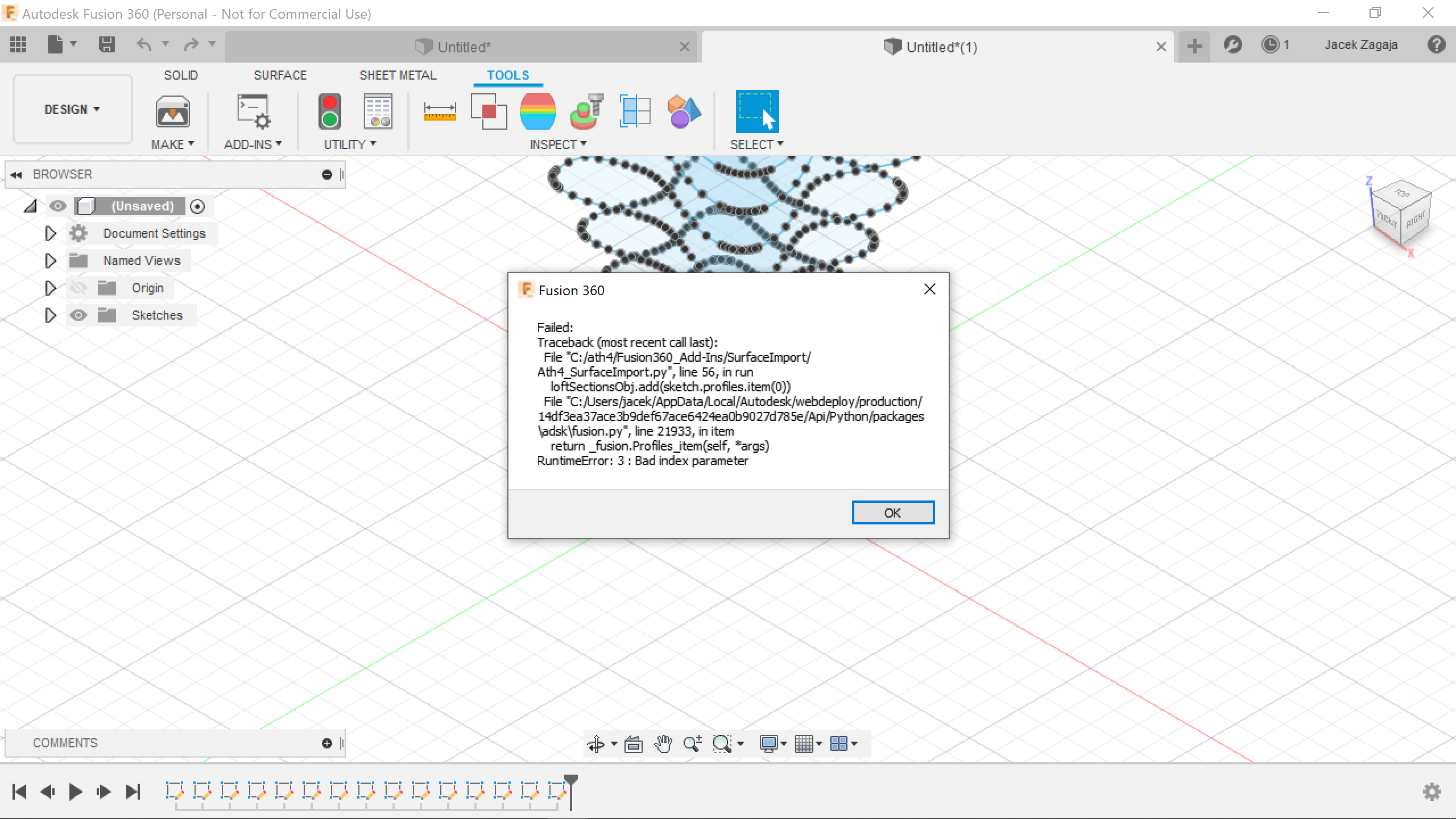

Fusion error (slices):
That doesn't look like a sensible horn 🙂 Try to import the splines alone with CurvesImport add-in. That's without lofting.
