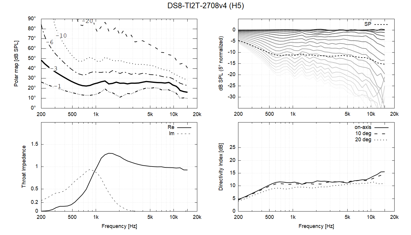

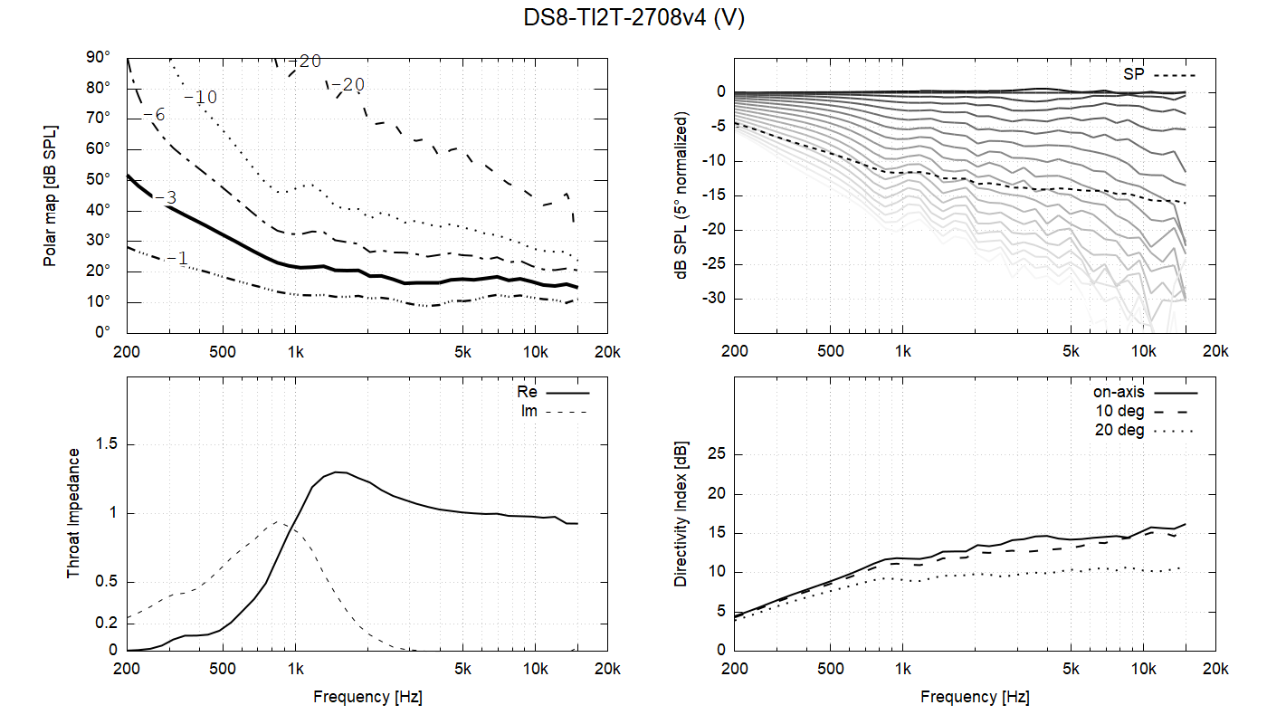

BTW, I'm working on a new design - 18" woofer in an open baffle with a large waveguide with 1.5" driver:
Horizontal, vertical (only):

I would definitely take a couple of these. 😉 As always, very nice work.BTW...with 1.5" driver:
View attachment 1085424 View attachment 1085425
Is the horn proprietary or will you make the parameters available?
What are the dimensions?

I have no intentions at the moment. Some day I may be selling the plans, I don't know - as it is, it's an adapter attached to a bended board construction.I would definitely take a couple of these. 😉 As always, very nice work.
Best wishes
David
I don't recall exactly but it's something like 25" x 18" x 13" (WxHxD).
That was mainly as an example what to expect from a 1.5" throat regarding the HF directivity. There seems to be no way (except a diffraction slot) to avoid the directivity index to reach ~15 dB around 15 kHz. What can be controlled, however, is how to get there and what's below.
