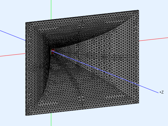

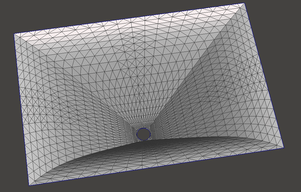

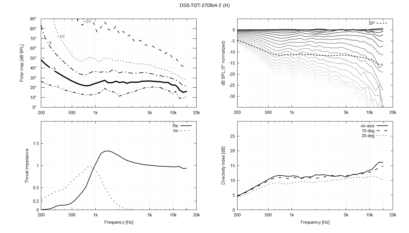

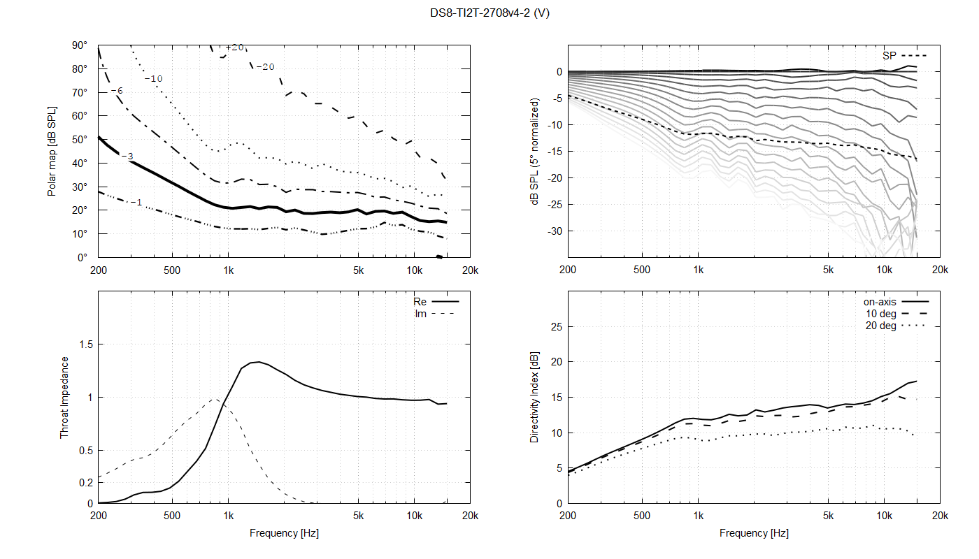

BTW, this is the final "2P" horn I'm going to actually build and test (640 x 476 x 340 mm, 1.5" throat):
So nominally it's around 70 x 60° coverage, somewhat narrowing vertically.
Simulated in free field, no mouth rollback (as pictured).
View attachment 1088887 View attachment 1088888 View attachment 1088889

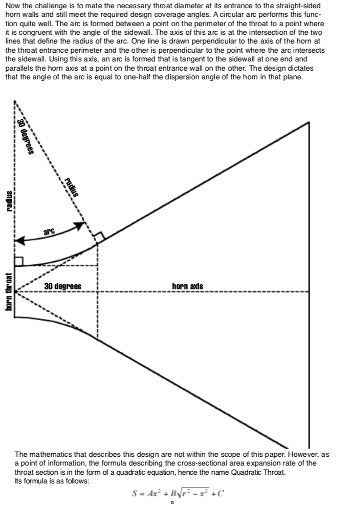

Looks very similar to Hughes "Quadratic Throat", which IIRC, Earl Geddes thought appropriated his work.....a good adapter will at least match the tangent angles of the boards perfectly. I figured out how to do it and implemented this recently but I'm not yet sure I want to make it public domain -

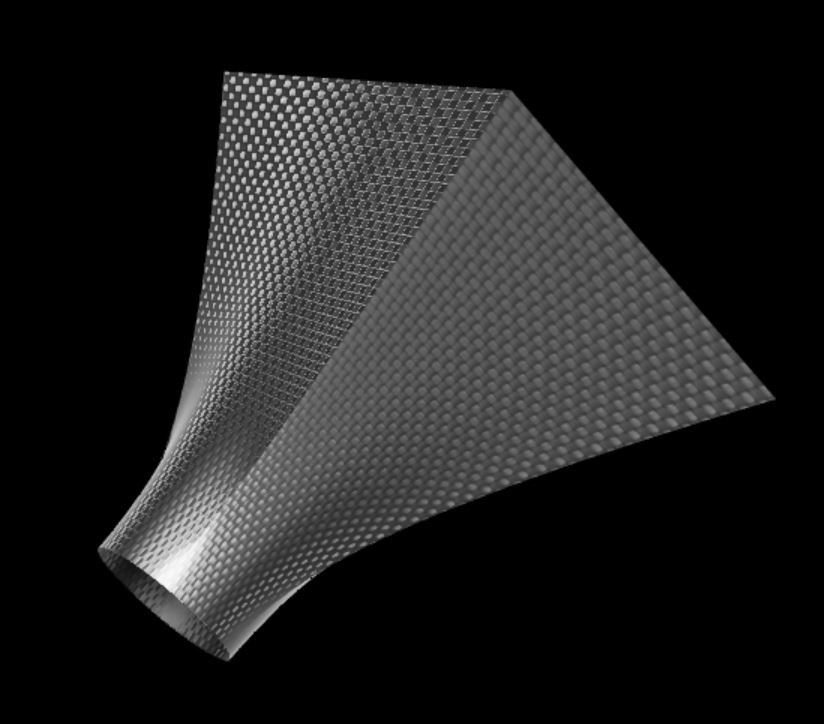

@weltersys I've been using that same methodology to make waveguides for almost ten years now, it's been working really well. Basically it goes like this:
1) You make a flat walled waveguide
2) Once you've joined the walls, it will look like a pyramid with the top chopped off. At this point, the waveguide is fairly useless because the throat is square, not round.
3) But then I smooth out the corners where the square walls meet.
They end up looking a lot like this.
In order to achieve a near-perfect match to the compression driver, one can measure the exit angle of the compression driver and then take a cone that has the same coverage angle, and then "subtract" that from the waveguide from steps 1-3
Making a smooth circle-rectangle transition takes "a bit" more than that...Looks very similar to Hughes "Quadratic Throat", which IIRC, Earl Geddes thought appropriated his work..
